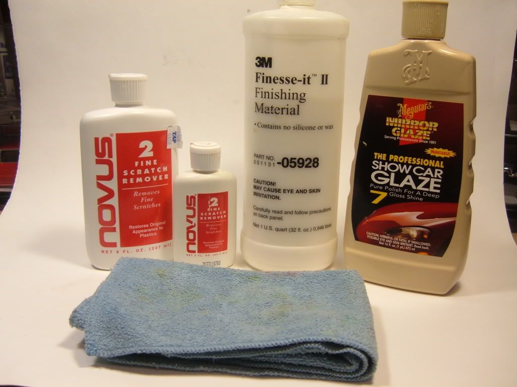

These are what I use in the pic below. Novus Plastic Polish #2, from the plastic finishing industry is what I use first to smooth everything out. Then I use Finessette II Finishing material from the auto paint industry, which is finer, and adds more luster and smoothness.
REMEMBER - NEITHER OF THESE IS A WAX AND HAVE NO WAX IN THEM - MERELY FOR POLISHING.
THE THIRD PRODUCT IS A WAX - THE Meguiar's Show Glaze, used on 1 to 1 show cars, different than Bill Geary uses, but in the same family, is definitly an extremely good wax. A good quality wax is important, because wax seals the paint surface and brings out it's brillance. Again though, it's about your personal choice and what works for you, not always about using what anyone of us say, including me.
Good luck on your choices - dave :lol:

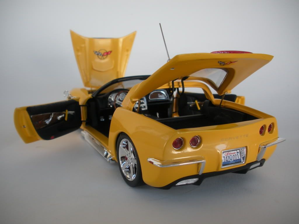

Here's a car I finished recently using this system.
