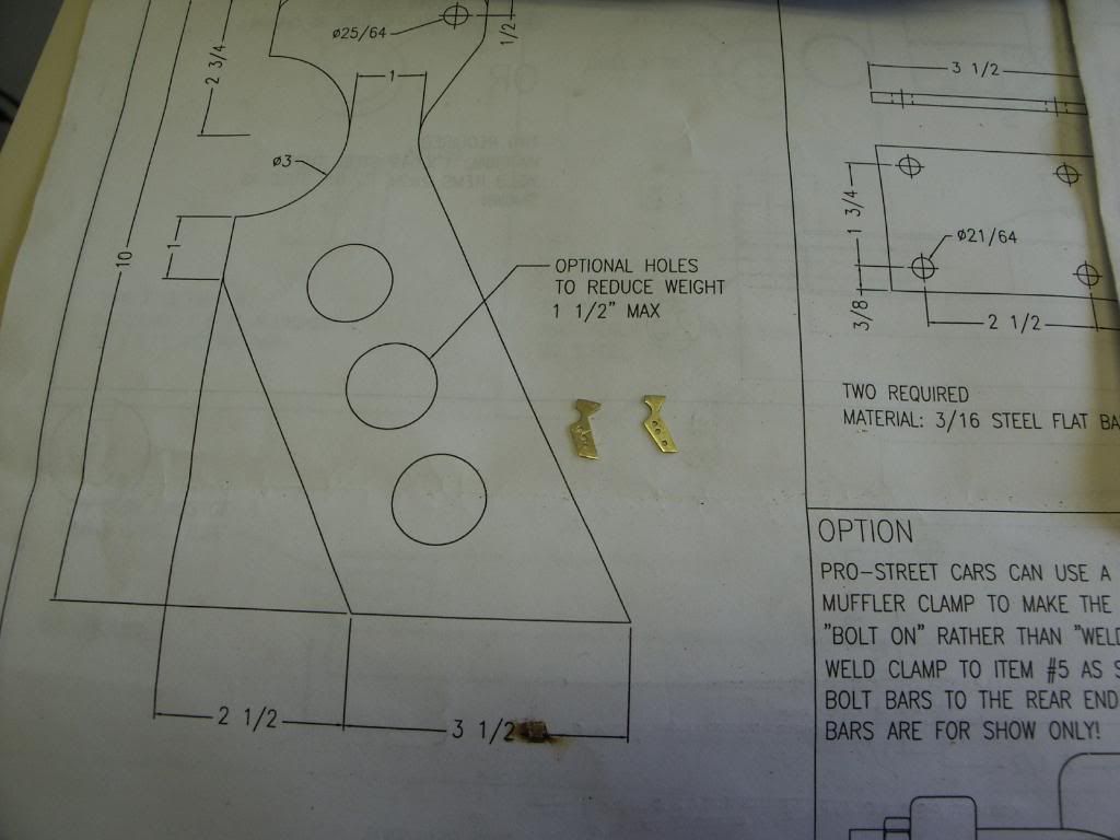

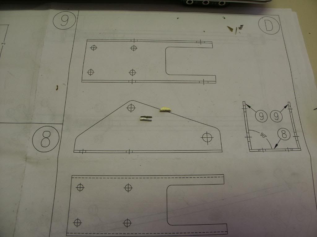

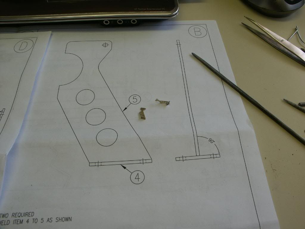

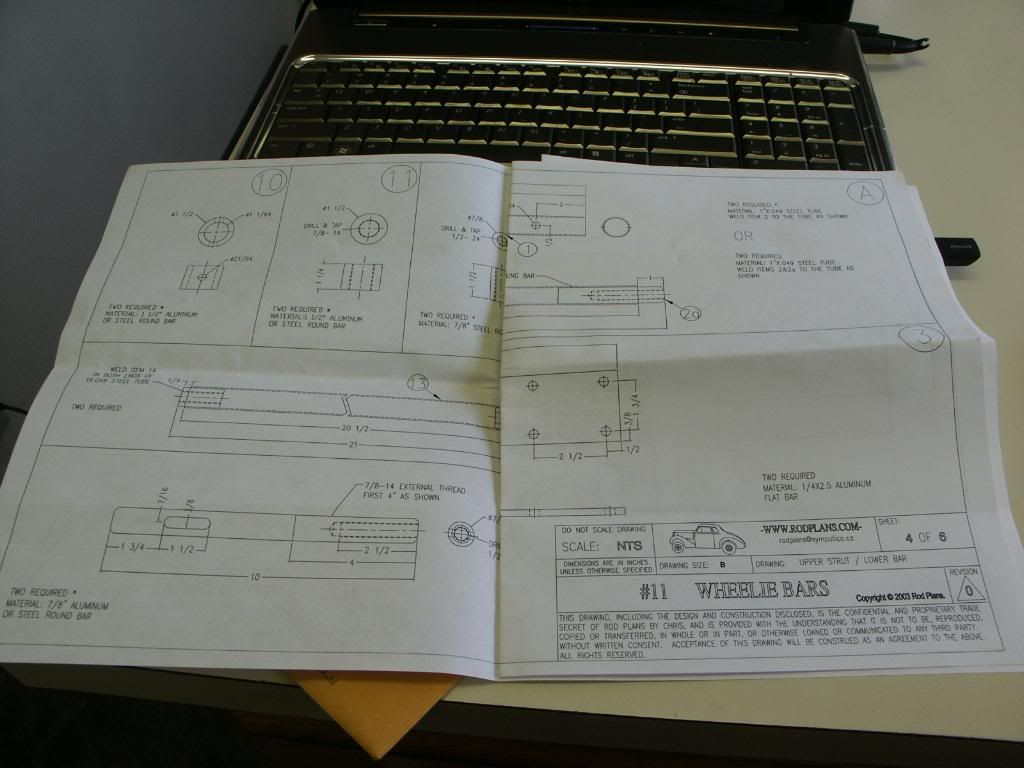

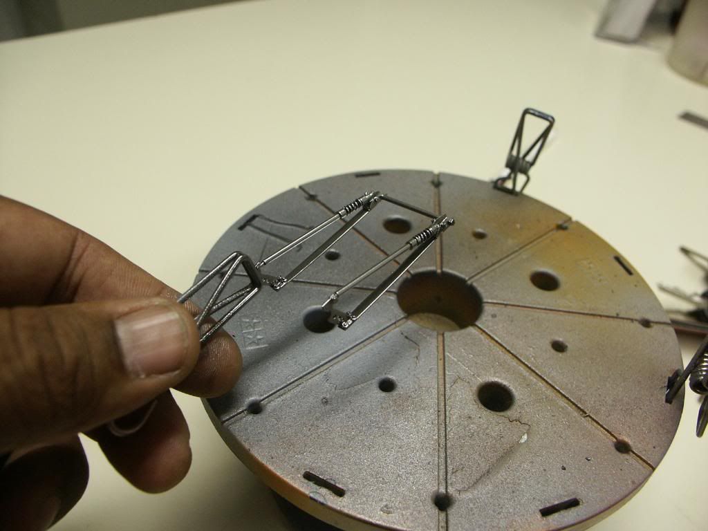

Romell R Posted July 19, 2010 Author Posted July 19, 2010 Hey fellas i wokeup and remebered that my 1:1 will have a set of wheelie bars so I pulled out the plans for em and got busy converting inches to milimeters. heres what I came up with.....

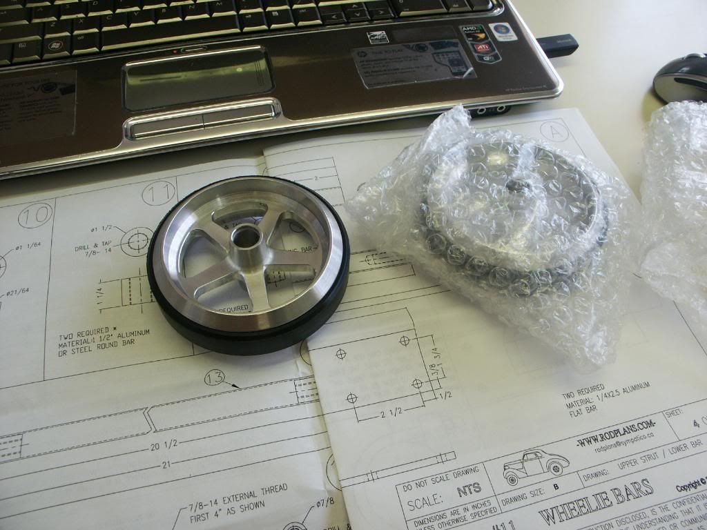

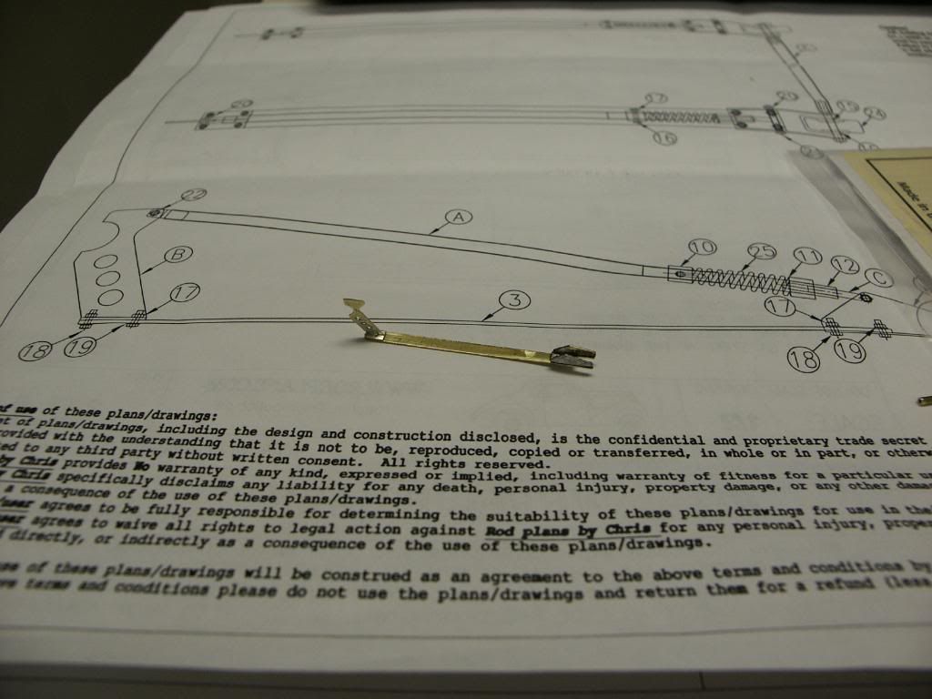

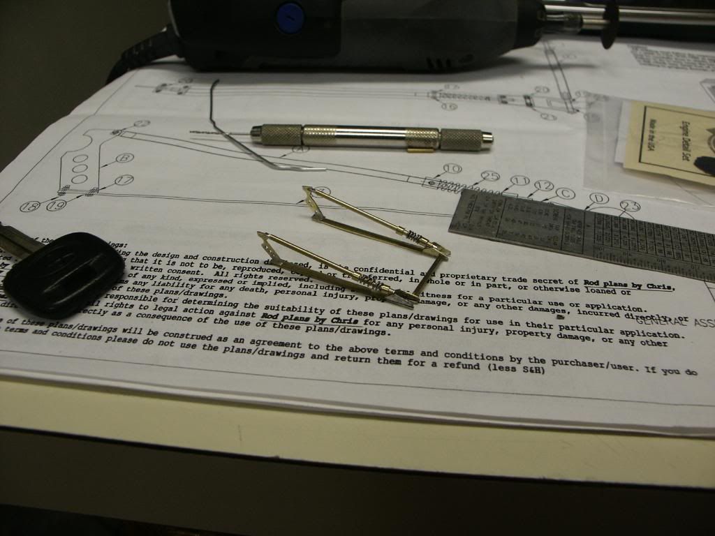

Romell R Posted July 19, 2010 Author Posted July 19, 2010 more assembaly Heres the finished bars done in chrome Alclad I'll be fabricating wheels for them today these are the wheels for my 1:1 wheelie bars I had them made to resemble my rims.

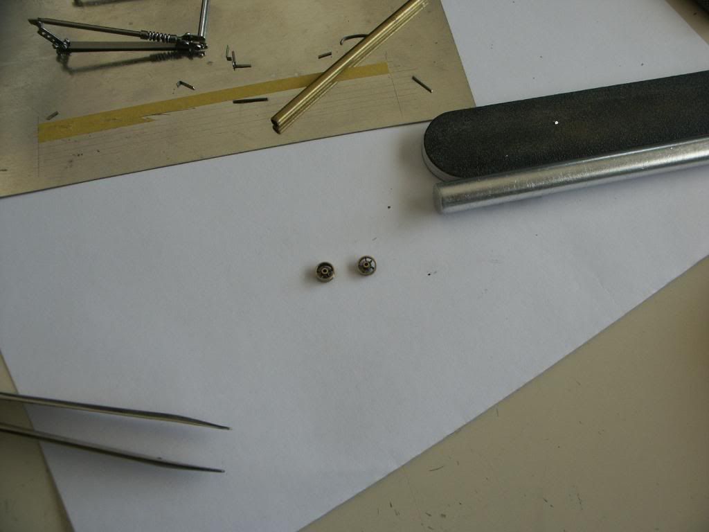

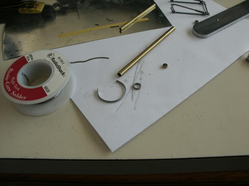

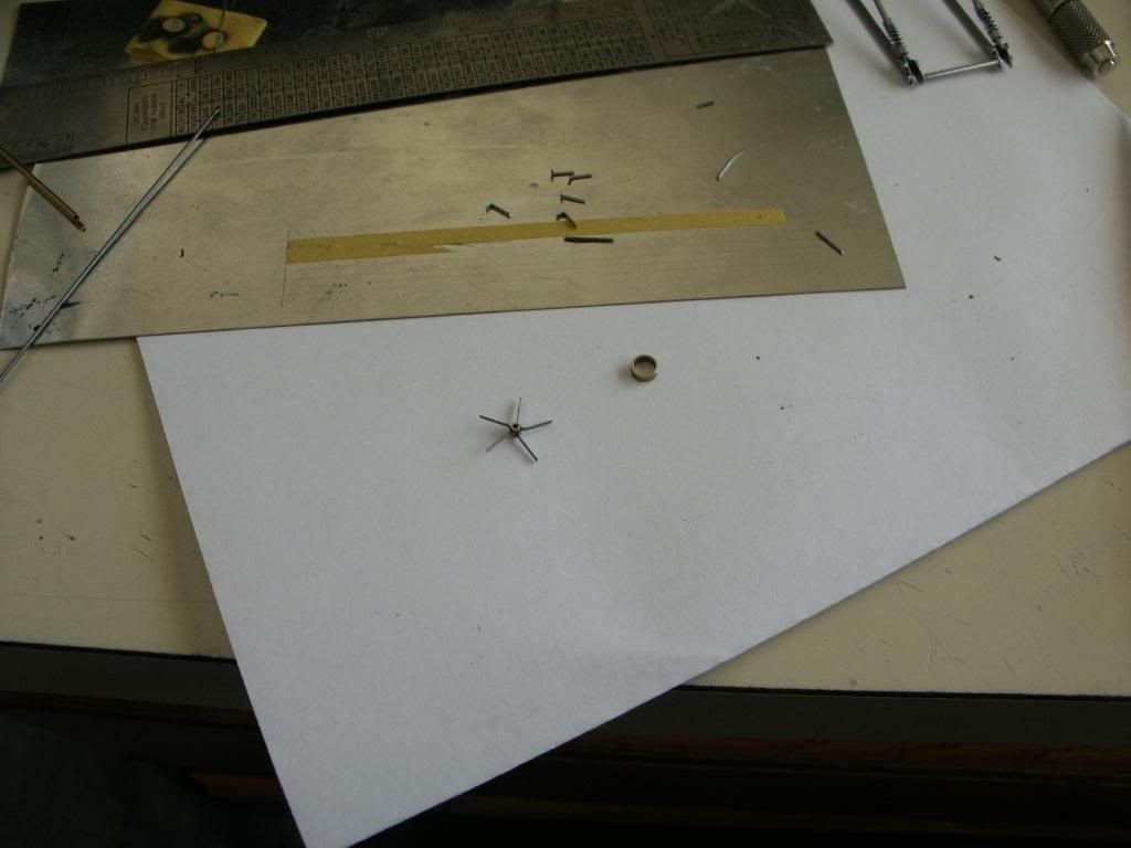

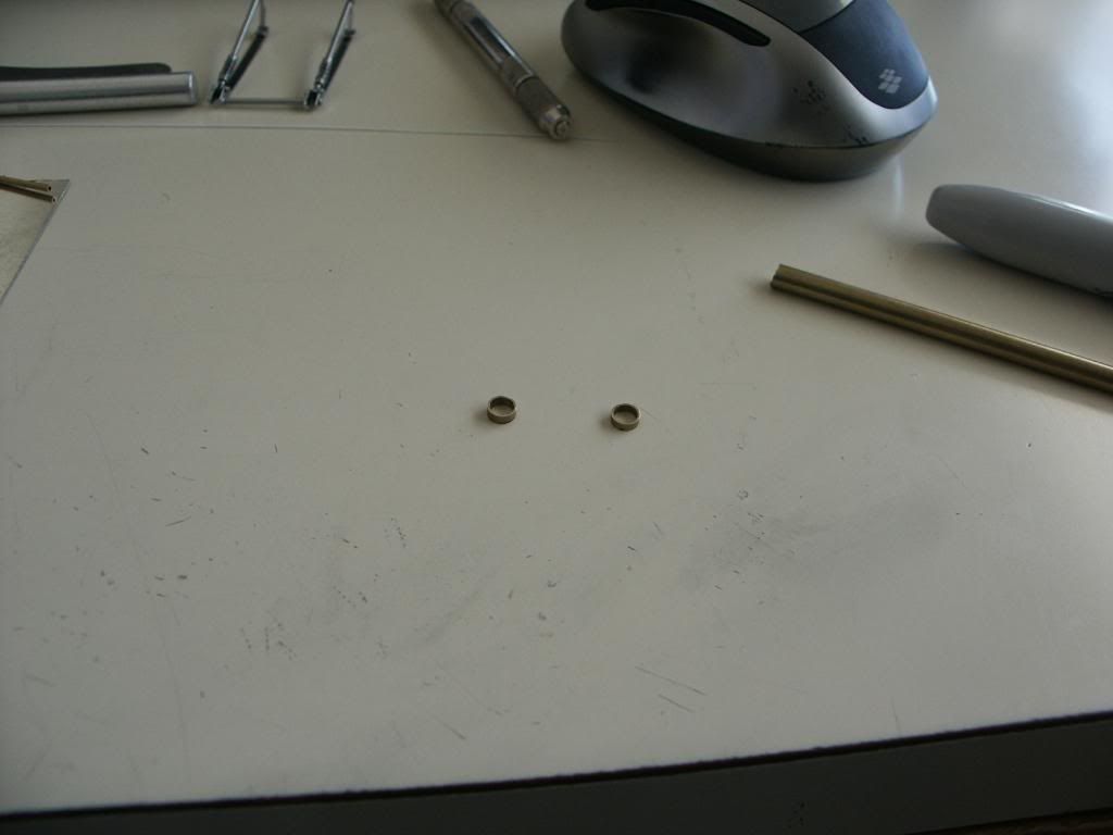

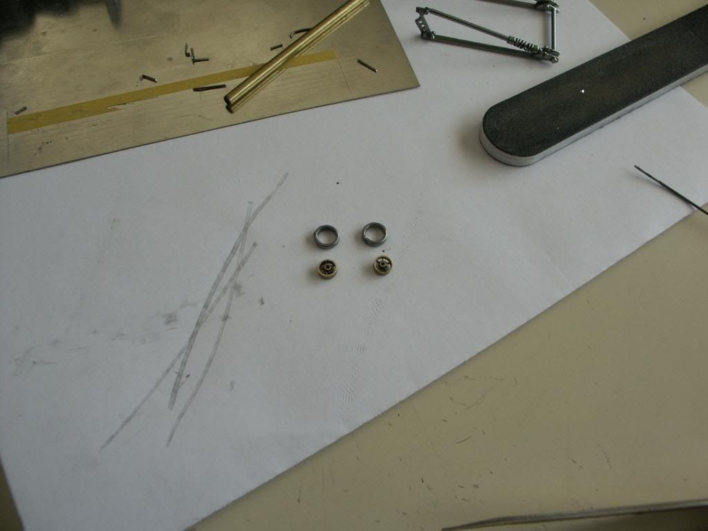

Romell R Posted July 19, 2010 Author Posted July 19, 2010 hey im back again with another update. not a big one just the wheeliebar wheels.... I started with a pices of brass tube and cut two pieces about 2mm thick to use as the rims... next I used a smaller diameter piece of tube (sorry I dont remember the size as these are scrap tubbing) as the hub of the wheels and i flatened out some silver solder to use as the spokes for the rim.... heres the new wheeliebar wheels all i need now is tires.... Once again i used solder to make the tires I flatened it just a little then wrapped it around some tube the same size as the rims and wala! wheeliebar tires. All thats left is paint and they'll be ready to install

Jeff Sauber Posted July 19, 2010 Posted July 19, 2010 Little rubber 0-rings may work better for the wheelie-bar tires...Just a suggestion.

Romell R Posted July 20, 2010 Author Posted July 20, 2010 Little rubber 0-rings may work better for the wheelie-bar tires...Just a suggestion. Thx for the suggestion bro if this doesnt work for me I'll check into the O rings
