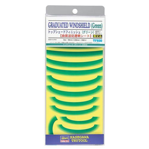

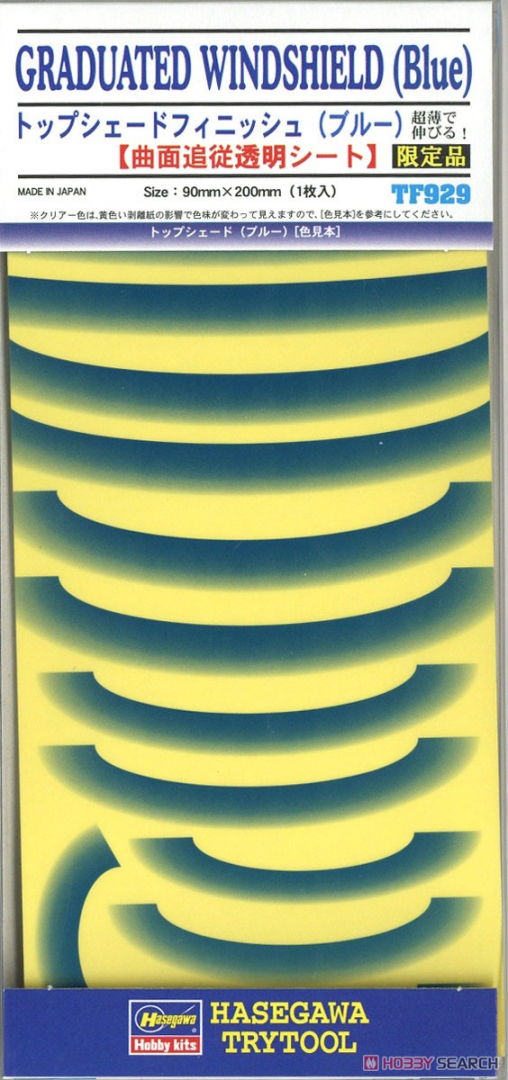

SfanGoch Posted July 15, 2019 Posted July 15, 2019 There's this from Hasegawa No fuss, no muss, no mess.
peteski Posted July 16, 2019 Posted July 16, 2019 (edited) 6 hours ago, SfanGoch said: There's this from Hasegawa No fuss, no muss, no mess. But does it come in blue? Edited July 16, 2019 by peteski
SfanGoch Posted July 16, 2019 Posted July 16, 2019 (edited) What, I gotta look that up too? Edited July 16, 2019 by SfanGoch
Mr mopar Posted July 16, 2019 Posted July 16, 2019 6 hours ago, SfanGoch said: What, I gotta look that up too? Now where do I get this from? and do they still sell it ?
SfanGoch Posted July 16, 2019 Posted July 16, 2019 https://www.google.com/search?client=firefox-b-1-d&channel=tus&biw=1366&bih=604&ei=pK0tXZa5JsrItQaNp4PYBg&q=hasegawa+graduated+windshield+tf929&oq=hasegawa+graduated+windshield+tf929&gs_l=psy-ab.12...0.0..2751...0.0..0.0.0.......0......gws-wiz.Z1MB4NnDy3g

SfanGoch Posted July 20, 2019 Posted July 20, 2019 I prefer to eliminate extra work whenever it is possible. Windshield tint is one of those extra work steps, Steve. It comes in green and smoke, too.
StevenGuthmiller Posted July 20, 2019 Posted July 20, 2019 (edited) 29 minutes ago, SfanGoch said: I prefer to eliminate extra work whenever it is possible. Windshield tint is one of those extra work steps, Steve. It comes in green and smoke, too. Green is perfect for most of the models that I build! The only issue that I see is that the website that you would be ordering from looks a little screwy to me. Everything is in Yen, not really certain what country it is coming from, (I'm guessing China). I'm not really sure that I trust it. You would think that some American on line hobby material provider would carry these. I googled the description of the product and came up empty. Correction. I found these on a few other sites, all European. One of the sites had them marked as a "future release". Steve Edited July 20, 2019 by StevenGuthmiller
SfanGoch Posted July 20, 2019 Posted July 20, 2019 Sakura Japan has all three shades for $16.40 w/free shipping.
StevenGuthmiller Posted July 20, 2019 Posted July 20, 2019 50 minutes ago, SfanGoch said: Sakura Japan has all three shades for $16.40 w/free shipping. Terrific Joe! That makes it a little easier, all be it a little expensive. Guess I should order soon. Takes 2 to 4 weeks for delivery. Steve

SfanGoch Posted July 21, 2019 Posted July 21, 2019 25 minutes ago, StevenGuthmiller said: "Hobby Search" If you look to the right of the item, you'll see the following information: Manufacturer : Hasegawa Series : Hasegawa Trytool Release Date : Early Jul., 2018 List Price : 1,188yenabout11.06USD Sales Price : 1,045yenabout9.73USD Points Acquired : 10pointsOther Currencies JAN code : 4967834719293 Item code : TF929
