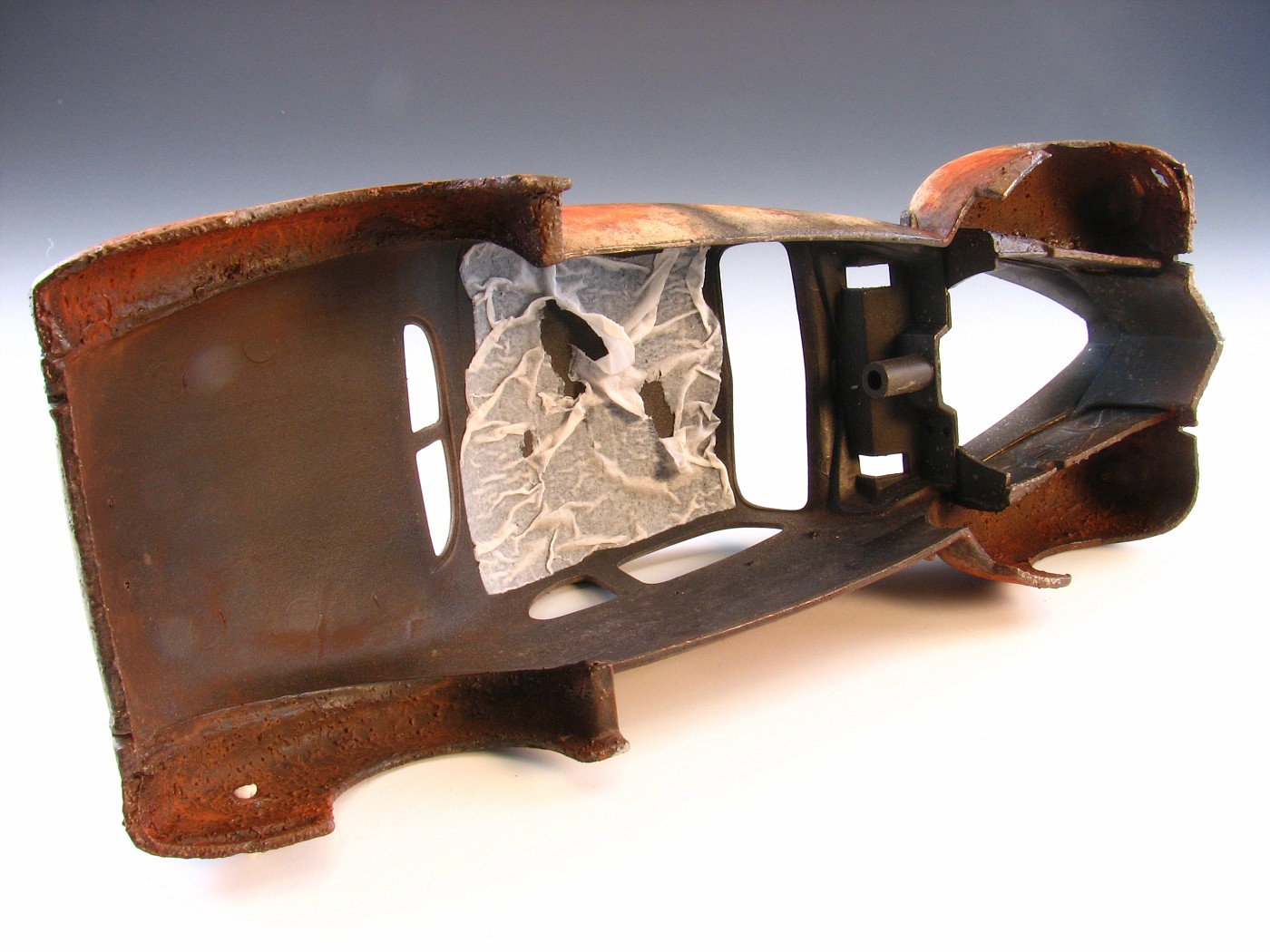

Dr. Cranky Posted July 19, 2010 Posted July 19, 2010 Hello, folks, here's a quick and simple method of bringing more detail out of your ran and junker-clunker interiors. All you need is a box of Kleenex and some white glue. Remember to primer your parts regardless so that the glue has something to grip on to . . . You can also begin with a painted interior foundation as I have done here: The beauty of this technique is that you can build up the wrinkles and this will be a mistake-free process . . . you cant wrinkles in case you really want to tear it up as I have done on the seats. Working carefully with a pair of tweezers, you simply cut the tissue to size (again, you don't have to have perfect measurements) and then use a little bit of diluted glue to begin the process. While everything is still wet, you can move the tissue around until you achieve the look you are after . . . Notice how the headliner has been torn (excessively so since this one is a junkyard jewel! LOL!) The tissue will dry rock-hard over night, which will then offer the perfect canvas for either airbrushing or brush-painting your colors on . . .

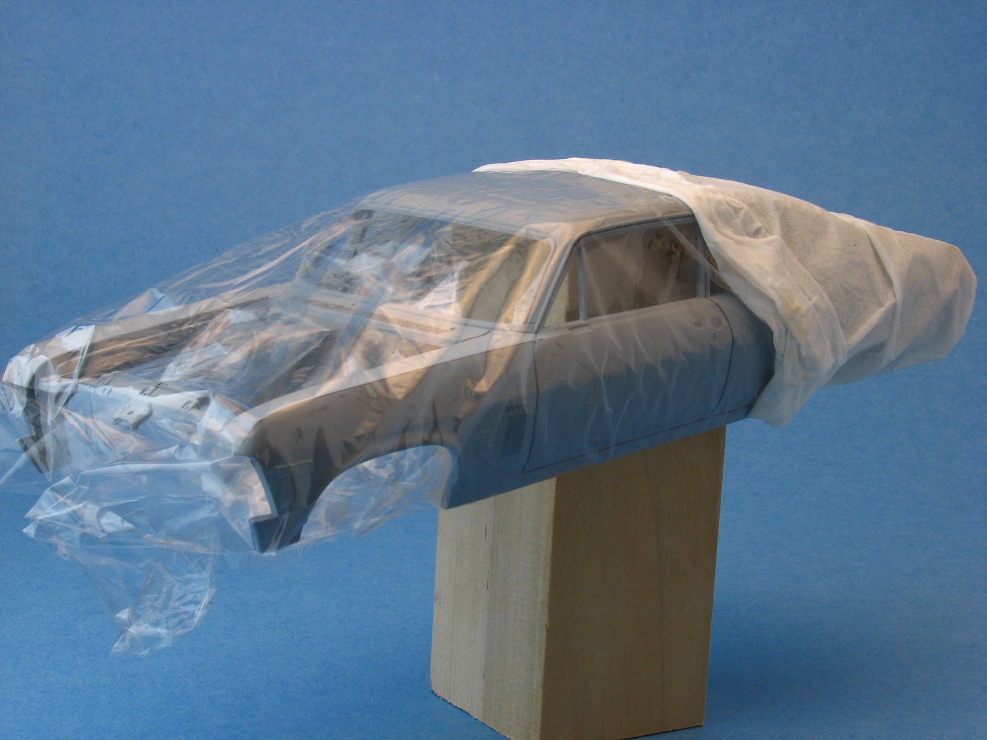

Dr. Cranky Posted July 19, 2010 Author Posted July 19, 2010 You can utilize the same method of Kleenex and white glue to create a realistic looking tarp . . . Before you paint the model, you cover it with Saran wrap, then you take your Kleenex (I keep the two-ply) and you cut it to size and place it over the plastic wrap, then with an eye-dropper begin to wet the paper with diluted white glue . . . Using tweezers, you wrinkle it and set it up in the shape you desire . . . in this case I am using the tarp on a Nova body . . .. Soak the tissue enough, but if it gets drenched, don't worry, it will only dry even harder and better! But it will take a bit more time than just over night . . . Once it is dry, you can trim it to size along the bottom edges, tear it, do whatever you want to it. It will have dried in the form of the body. You can removed the plastic wrap easily and then you can paint the tarp to your liking: The weathering process is simply, just some dirt and dust and other details . . .
