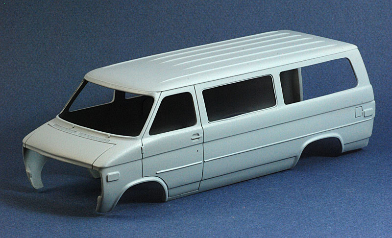

The body is in full primer and only awaits the hinges ....
Body primer DSC 7670
Body primered DSC 7672

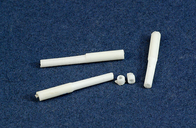

Speaking of hinges, I finally bit the bullet and started cutting the whittled down plastic tube into hinge lengths. While filing down the 3/32" (.0928) tube the inner hole became off center. The tube was chucked in a Dremel and I used a heavy sanding stick to take down the OD. I'm not sure why it ended with one wall thinner on one side using this method, but looking now at the photo I see I must have exerted uneven pressure on the sanding stick end to end along the tube. I had to stop around .073" OD as the wall got thin, but it's much better than the original ... even if 1.75" OD hinges ARE big! I feel good finally about these. :)

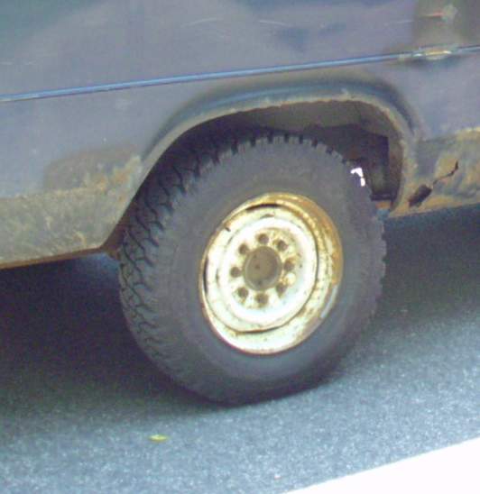

Update on the wheels are, I got the first master in silicone now curing, tomorrow I will see what my copy will look like, then I can fit one of my 8 bolt 3/4ton hub in the center. (stole it from a amt dirt track car)
What do the front wheels look like, just a dust cap conical type center?
Sorry I missed answering this,Ryan .. but I'm not sure what the front rims look like bare. All my photos have the dog dish caps on. I would expect they are as you say.
