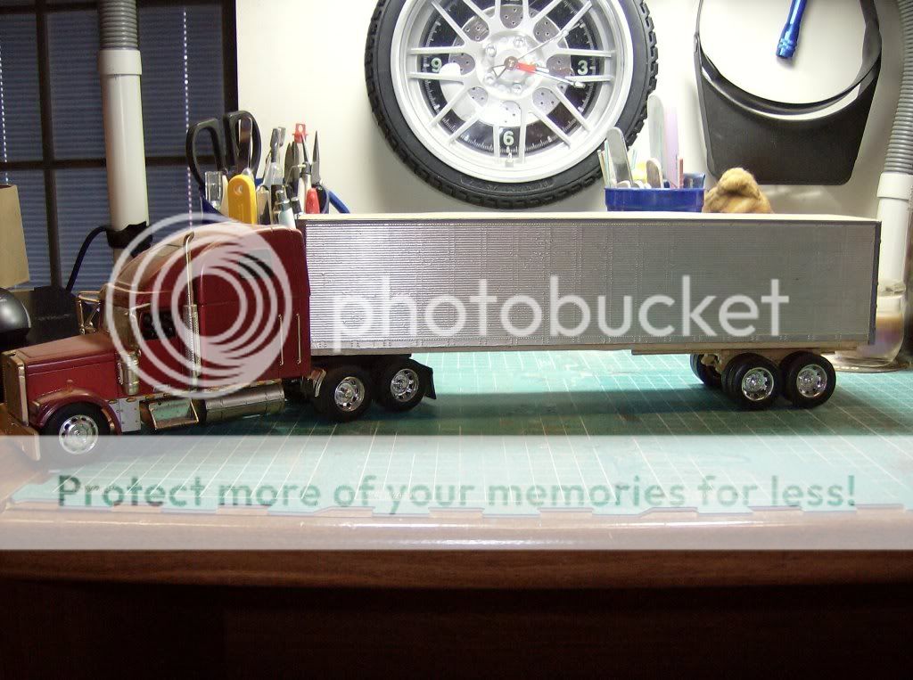

I hope you can win that truck, and if you would want to build the tractor at some point, I would have rear Alcoas from the trailer kit I posted, but if you can find one, I'd suggest finding a New Ray 1/32 scale diecast for it's tractor, it would look much better than the ugly Volvo! ;) That is the manufacture of the Freightliner pulling mine, and I even found a real cheap one to steal wheels for the trailer so they would match. Here's a new pic of the Freightliner with the New Ray wheels on the trailer.
If you would want the wheels from the trailer, you are more than welcome to them, but I didn't find any matching front steer wheels, though. I didn't find any spokes, either.

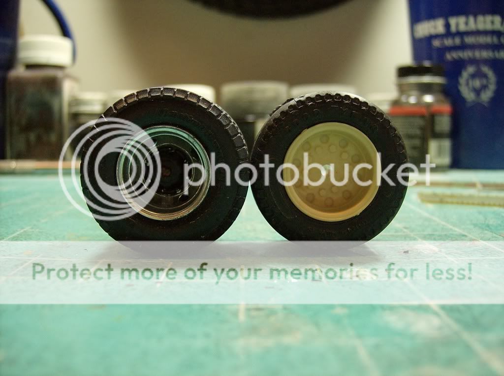

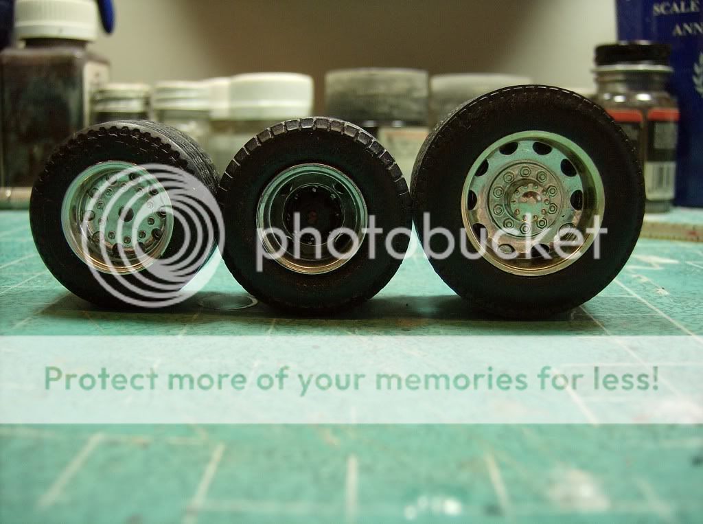

The AMT 1/32 scale wheels come out close to 18 inches in 1/25 scale, and the tires themselves are about 30 inches tall. Here's a pic of them with AMT's Dodge dually wheels as a comparison.

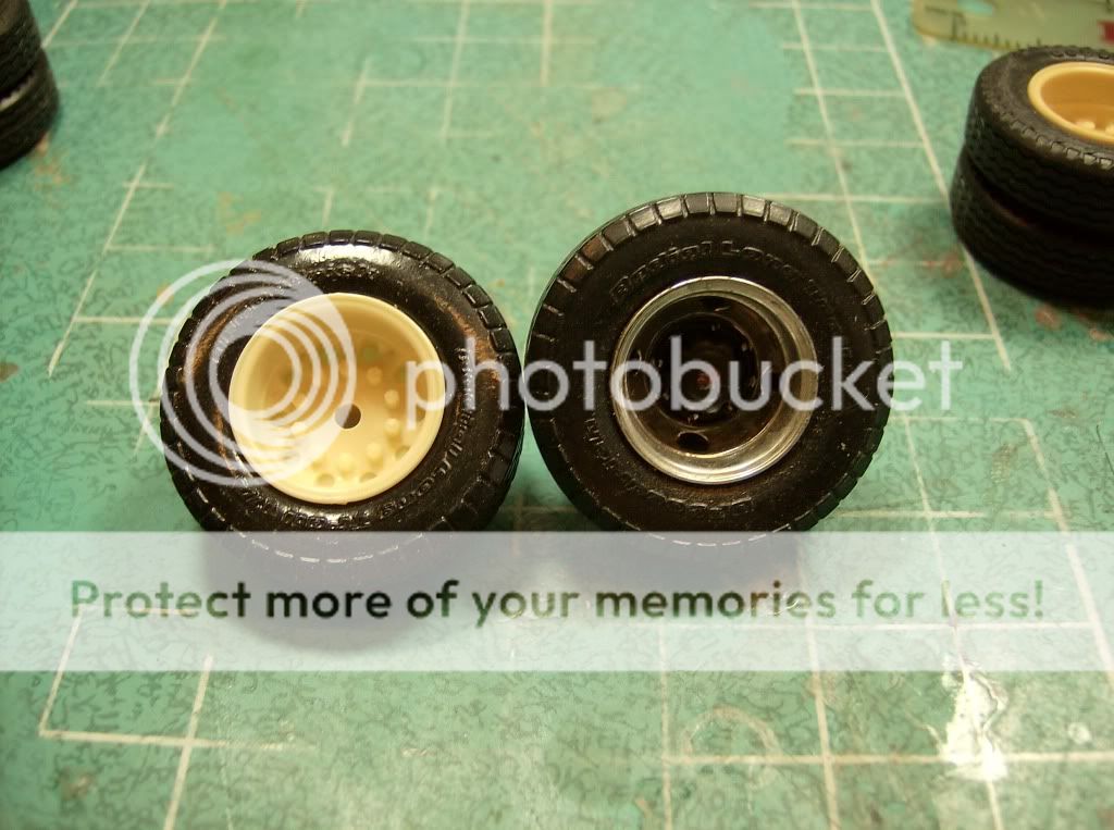

Oddly enough, the tires from the Dodge kit will, with some not so gentle pushing, will fit the AMT 1/32 scale wheels. These are the Dodge tires, the left one on the 1/32 scale truck wheel and the right one on the stock Dodge wheel.

Now back to wheels/tires.The 3 wheels showen are close to what is needed for 1/25,and probably work in most cases.The 1/32 are 18,but should be 19.5.For the old school smaller trailer wheels that were 15,the 1/43 measures 14.Never new the newrays were that much over scale for what they are used for.We realy need some 1/25 lo-pro wheels

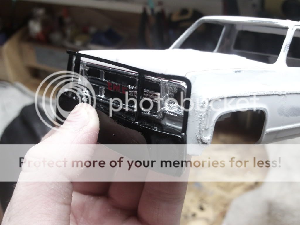

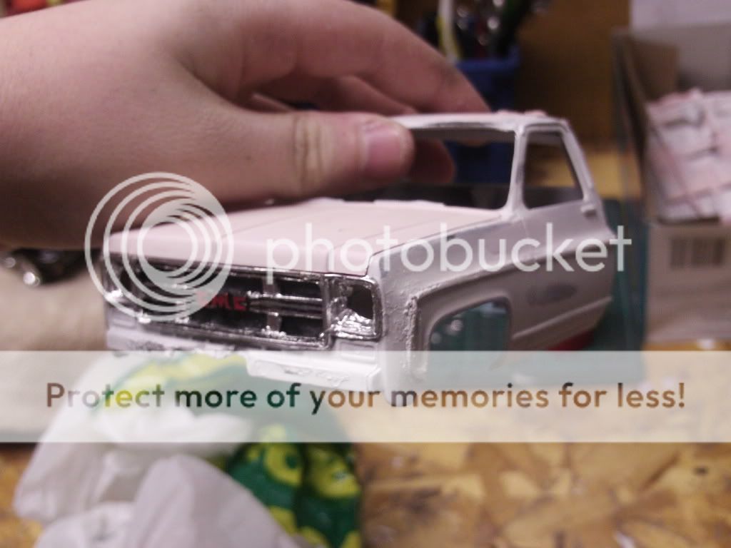

Well thanks to the Fatal error yesterday I have 2 days worth of update.

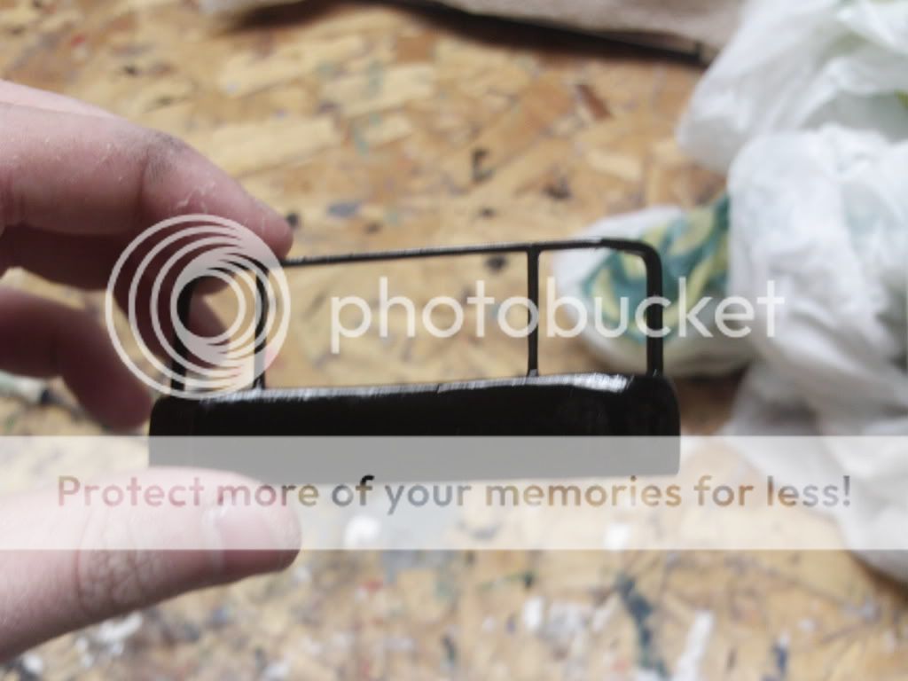

Modified the bumper to acomodate a winch. Still need to Paint Holmes on it.

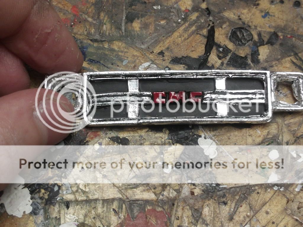

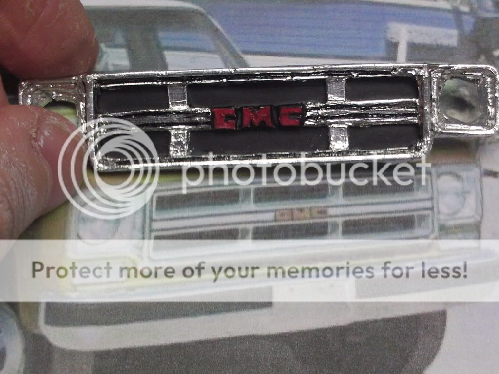

Finished the grille and BMFed it, not perfect but It'll do behind the bumper and winch.

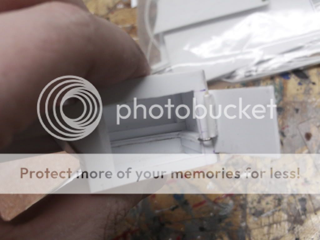

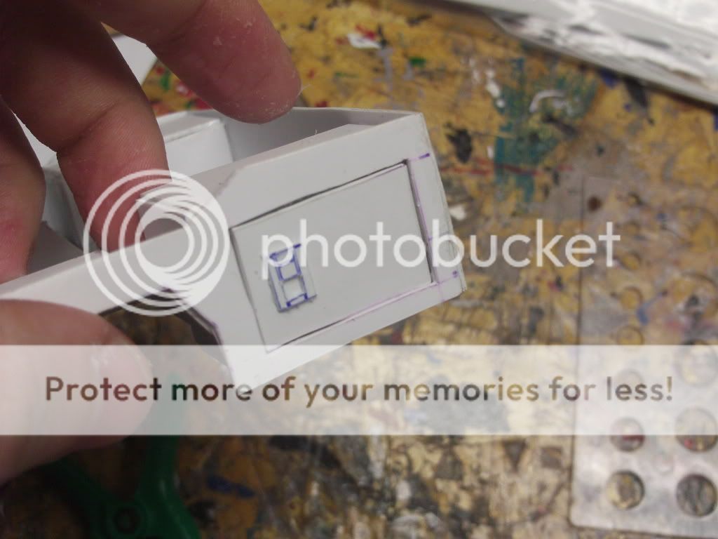

Finished the tool boxes, even added scratch built slam locks, they'll look better BMFed :D I hope :D

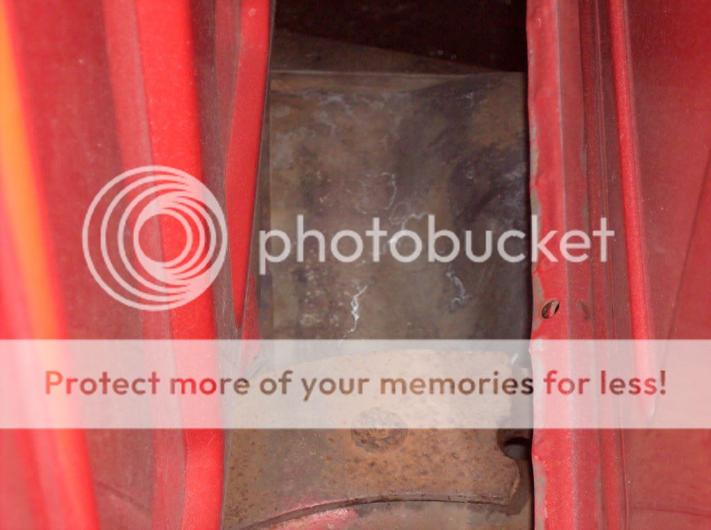

Hey Matt...should that saddle tank be aluminum with black hold down straps? To me it needs some color, or it just might be the trucker in me that thinks all tanks should be brushed aluminum or chrome...figure you have one outside... :)
Well, James, I think it's just the trucker in you! :P Since I do have one outside, though, and even have a few pics, here's a pic of the back tank in all it's rusty glory. :huh:
I'll even be a nice guy and get a pic or two of the front tank and maybe even see if I can knock some rust off it to find out it's true color in a little while. :D
James, it's not the greatest pic in the world, but it's just too cold to lay under the truck! :blink: This is what the front fuel tank looks like, and it appears as if somewhere under all the dirt and rust, it may have been steel colored or painted black at one time.
Thank goodness this thing used to be a chassis cab! B)
Edited by highway
James, it's not the greatest pic in the world, but it's just too cold to lay under the truck! :) This is what the front fuel tank looks like, and it appears as if somewhere under all the dirt and rust, it may have been steel colored or painted black at one time.
Highway, I'm not sure when they changed, but in the '80's they started moving to plastic fuel tanks. I worked for a Ford and Chrysler dealership for a while. WE have a local place that builds ambulances using Ford chassis cabs and van cabs. The vans came in with a big cardboard piece screwed to the back of the cab with a clear tape section for a window. All of these were diesel and used a plastic tank. I think the dually 1 ton trucks on the lot still had the shiny steel tanks under them at that time, but would eventually move to plastic.
Now my '85 Dodge Ram Charger 4x4 has a 30 gallon plastic tank under it un the rear. So maybe this helps or just further confuses. lol.
Yeah I'm gonna re do the bmf, it's making it look cruddy.
Remove it and paint it with metalizer and rub it out. That will look more like the old chrome tape over plastic grill anyways.

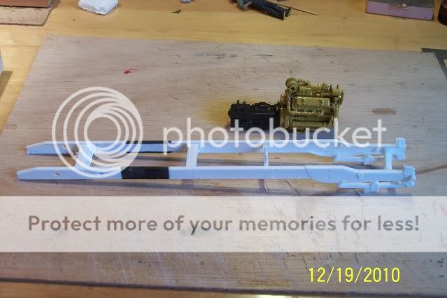

I finally have something to show, engine is built and painted and frame has been stretched.

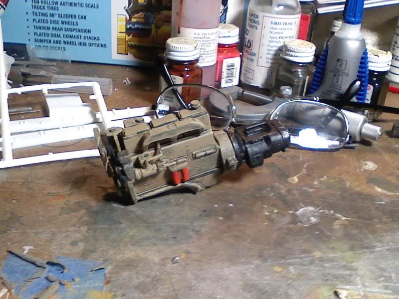

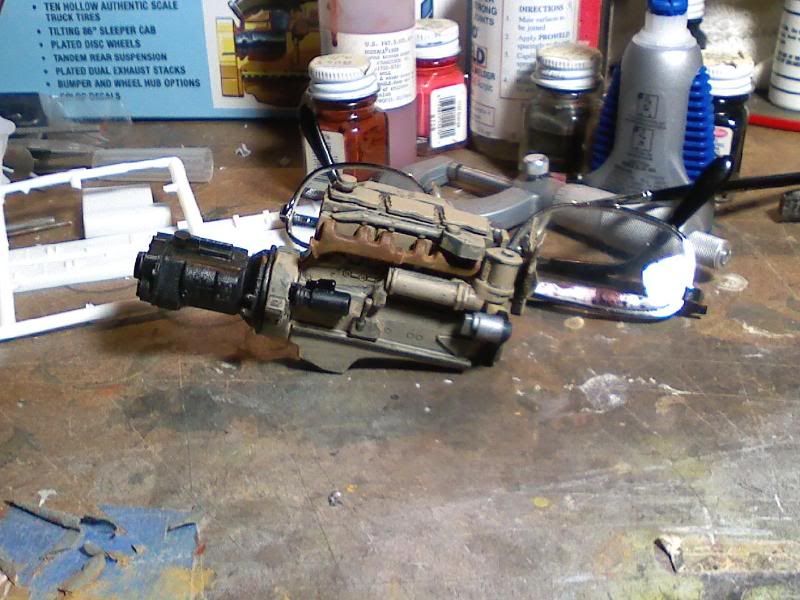

Small update, the engine is done!
I tried to do a little weathering, not sure if I like how it turned out. I also removed those monsterous mounts on the frame for the mudflaps and rear fenders, and sanded the cab mating surfaces flat so they fit together better. Not much I know, but it's a start!! ^_^
Rick
On the box art for the white freightliner which you can see in both of his pics, the engine color is yellow. But I have seen some of the people who have made them colored them tan. Are there different color choices on this style or is it supposed to be a tan color?
I'm not sure why the engine looks the way it does on the box, Justin, but commonly a Cummins engine of that era is a tan color. I think the actual color from Cummins is called Sand Beige. Since the box art on the Freightliner is the original art from the 1970s, maybe printing technology in those days couldn't show a correct shade of tan. :)
Rick, the engine looks great B) i wasn't big on the tan color of that trucks engine but you've made it look good with the weathering.
i just picked up one of the White Freightliner kits too but havent done much more than study the instructions and glue the cab together. i'm kind of dragging my feet a bit with Christmas so close at this point.
Cam/Chris, i'm looking forward to seeing what you do with the 4300. i love the tow truck in your avatar pic, very cool truck!
Thank You, the more I look at the more it grows on me
Well, looks like its time to take apart everything and repaint it........... I definitely dont trust AMT box art anymore. Can I get a pic of what the tan color should look like then?
The picture I just posted shows the color, I used real Cummins engine paint on it....
Rick
Is that something that would have been possible back in the 70's to have a custom painted engine?
Anything is possible. If it was a show truck it could be custom painted, or if it was rebuilt the rebuilder would paint it any color he chooses.... B)
