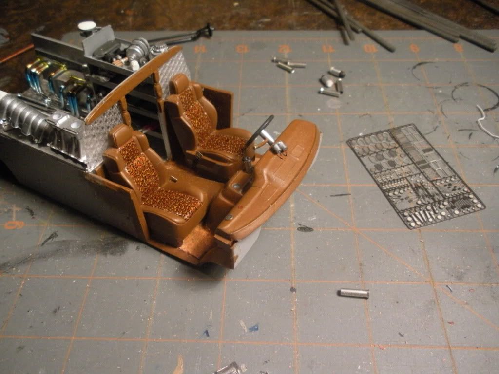

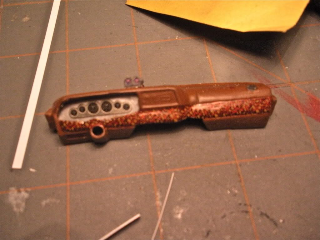

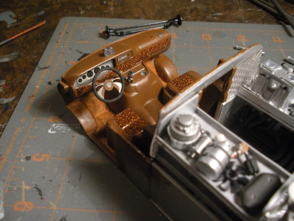

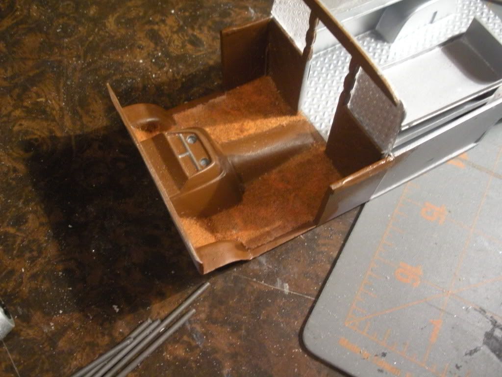

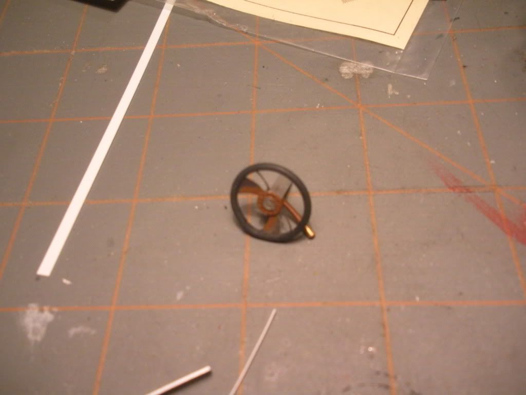

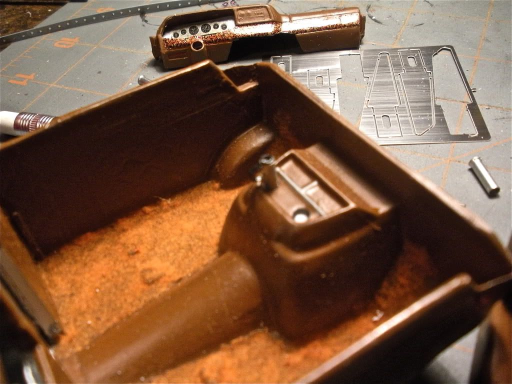

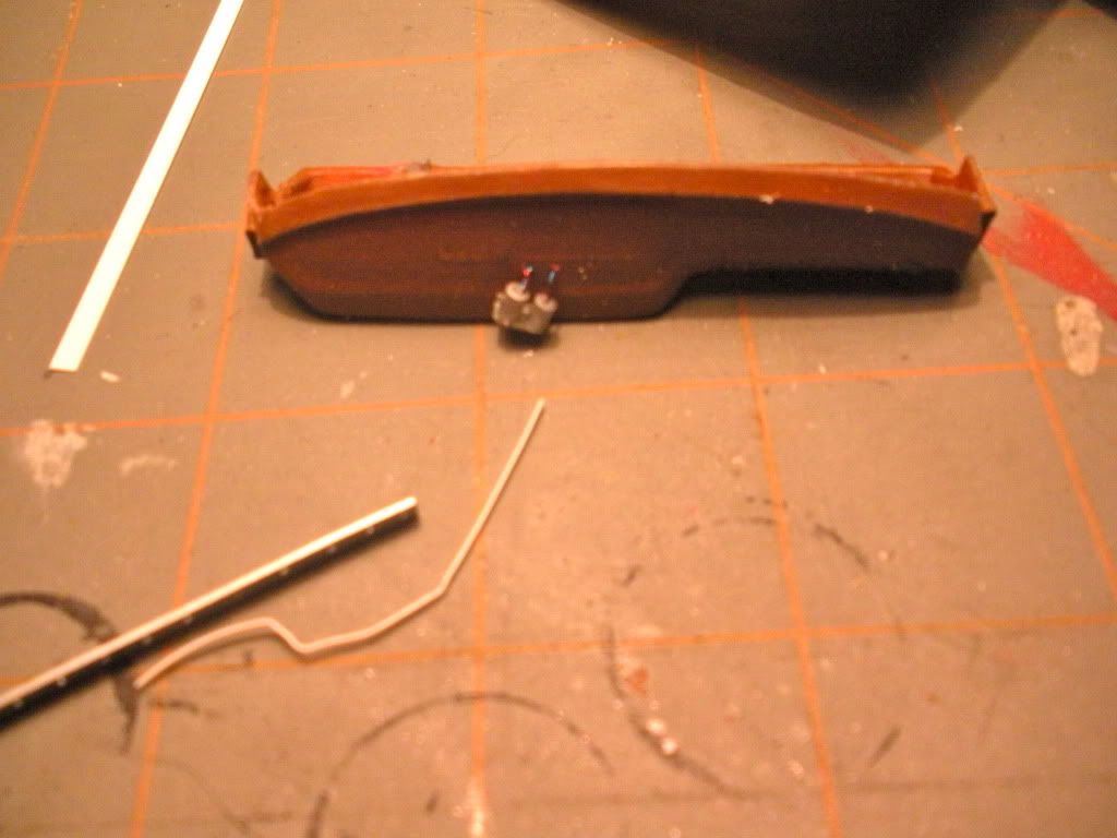

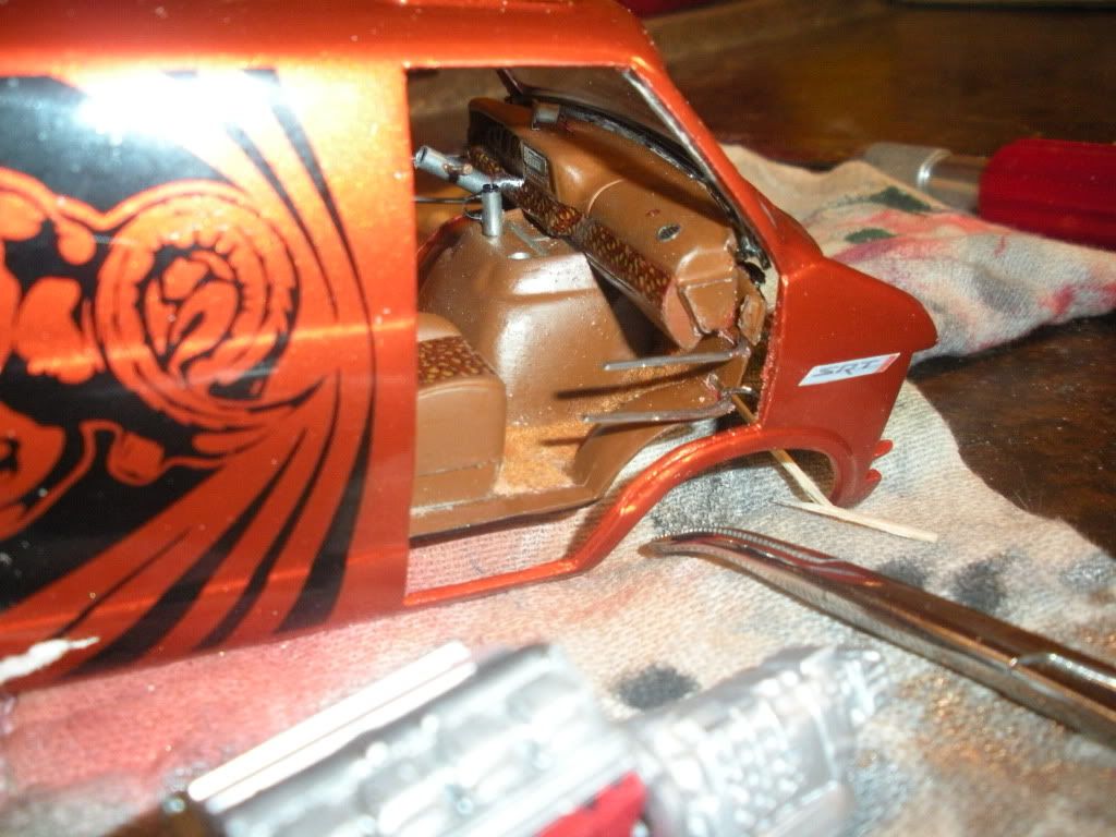

stewart Posted March 17, 2011 Posted March 17, 2011 The interior is nearly complete. I added a strip of the leopard decal to the dash for continuity. I also put a photoetched air vent on, added backs to the dash-top gauges and wired them. Still have to put on photo-etched radio and AC faces. I built up a steering wheel I had from MAS and made my own steering column from aluminum tubing and made a shifter from styrene rod and a little brass tubing. As an extra touch, I made a small coffee thermos from aluminum tubing and plastic and put it in one of the cup-holders. STewart

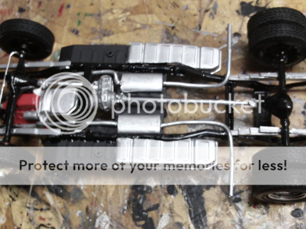

Nick Winter Posted March 20, 2011 Posted March 20, 2011 Rear driveshaft & exhuast has been installed. Nick

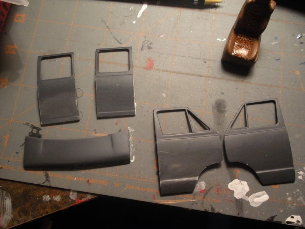

dwc43 Posted March 21, 2011 Posted March 21, 2011 I finally got the photoetch saws by MCG. Detail Master was out and didn't contact me until a couple weeks after my order. Don't know what's with that. So I ordered them from Scale Dreams Friday and got them today. They work very well. All of the doors and the hood have been removed and the body will be ready for paint very soon. I also cut out the moon roof and used one of the moon roof frames from another kit. The old window had sink marks on it so I cut out a new one from clear styrene. I also finished modifying the grille. I added a new surround and as soon as I have stripped the chrome off and painted it with alclad, I am going to install a wire mesh center section. STewart I like the mesh grill. Turned out pretty good.

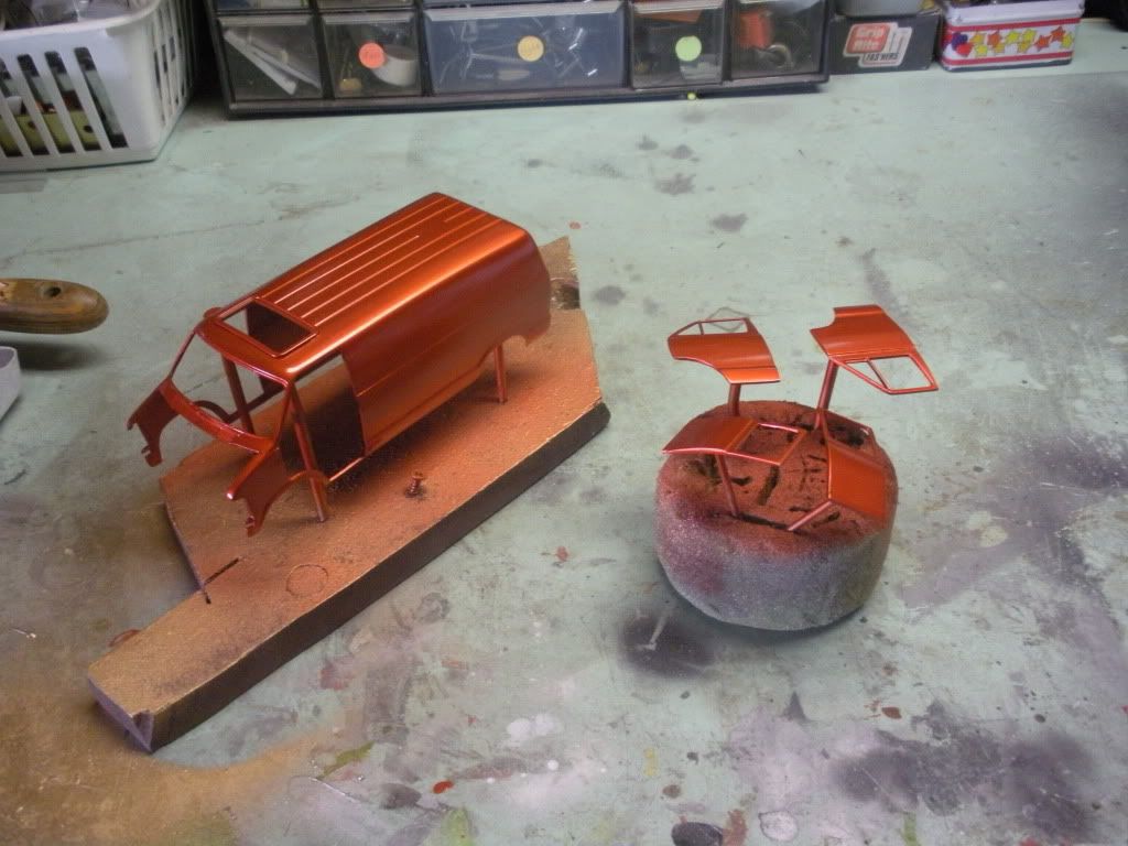

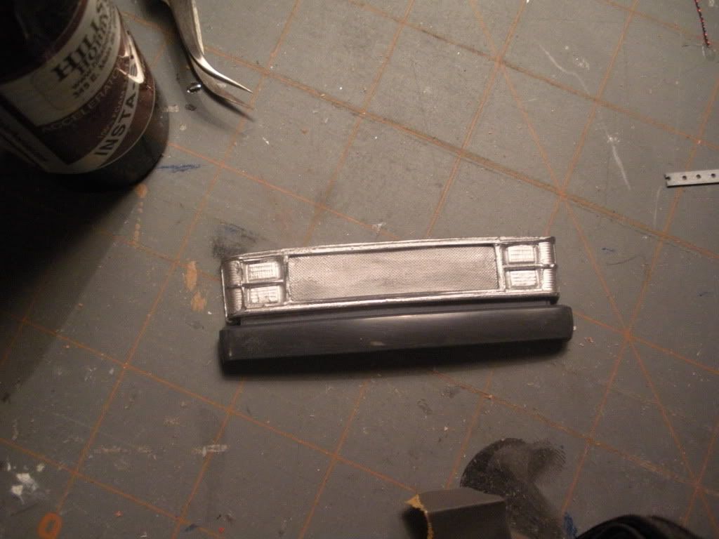

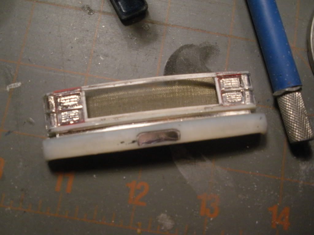

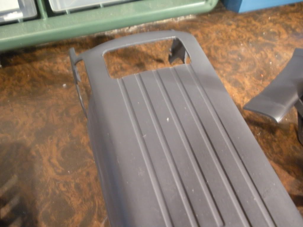

stewart Posted March 22, 2011 Posted March 22, 2011 I have the body mostly painted. It just needs some clear and it will be done. Painted it with Boyd's orange pearl. I have the grille mostly finished but the bumper needs a coat of alclad chrome. Still working on the interior. Going to start putting "goodies" in the back so I can install the bucket once the body work is done. STewart

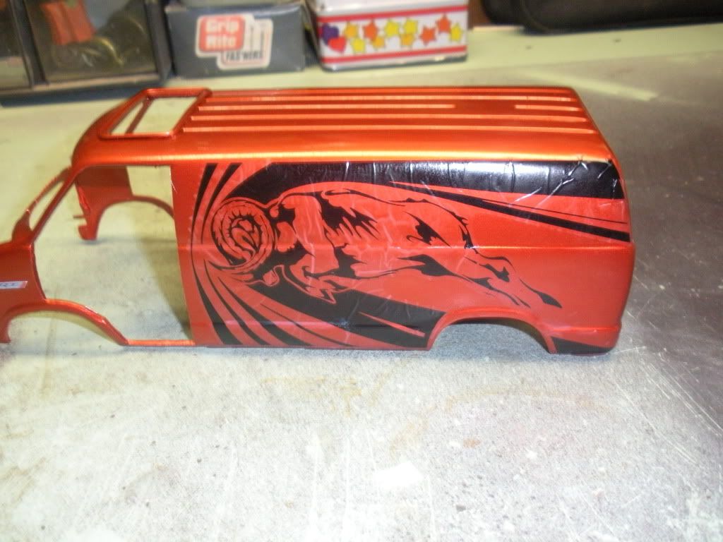

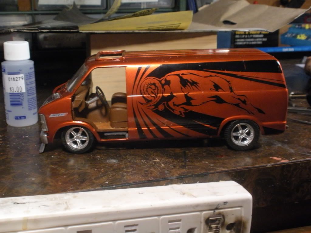

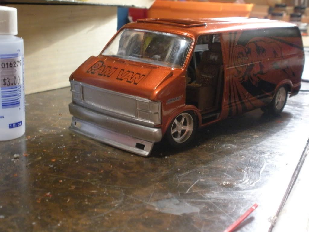

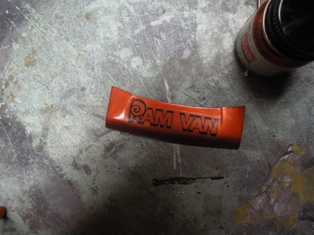

stewart Posted March 22, 2011 Posted March 22, 2011 Have a little more done. I started putting on the decals from the kit and have the interior pretty much complete. However, I ran into a glitch with the decals. They were old and instead of laying down nicely, they wrinkled badly and have areas of slightly opaque white which is the glue I am assuming. Does anyone have any suggestions for fixing this? I would really like to use these decals. The hood decal went on fine. Probably because it is just smaller.

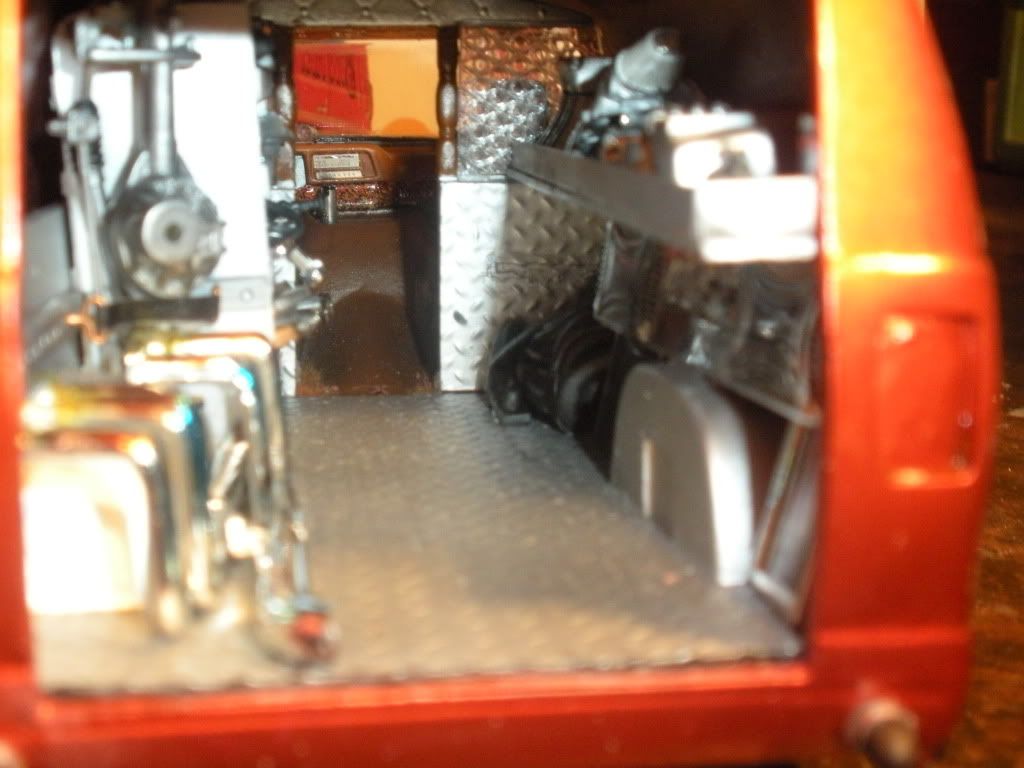

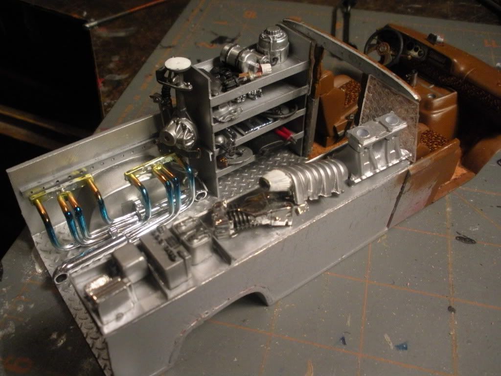

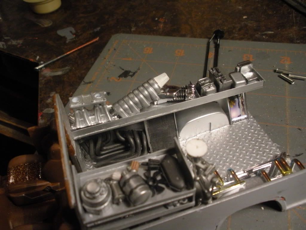

stewart Posted March 22, 2011 Posted March 22, 2011 Almost all of the parts are on the shelves in the back. I made a strapping system with a strip of styrene with holes drilled into it every 1/4" and glued onto the sides of the interior. I made small hooks out of wire and used black masking tape for straps. You can sort of see it holding up the upright axle and steering arm in next to the shelving. Interior basically complete. Have to finish the seat belts but that is all. STewart
highway Posted March 22, 2011 Author Posted March 22, 2011 It might be too late depending on how soon you read this and how long it's already been since you applied the decals, but you might want to try using a damp (not wet, just damp) paper towel to EASILY work the wrinkles out. That might also help work the extra glue out, too. I'm not sure if it will work or not, but it's worth a try. Also, just if it doesn't and the off chance you can find another set of those decals, scan them on your computer and get some decal paper if you don't have some already. I have started to scan all my decals just for this reason, that way if the originals do like they did to you, I can try to make more.
stewart Posted March 22, 2011 Posted March 22, 2011 Thank you Highway. I have already tried working out the wrinkles but they got worse as the decal dried and would not come out. Also, I do have some decal paper and could have shot myself when this happened and I had not scanned them. Thanks so much for the help though. STewart
highway Posted March 22, 2011 Author Posted March 22, 2011 Thank you Highway. I have already tried working out the wrinkles but they got worse as the decal dried and would not come out. Also, I do have some decal paper and could have shot myself when this happened and I had not scanned them. Thanks so much for the help though. STewart I hope your want add can get you some new ones, it looks great with the graphics.

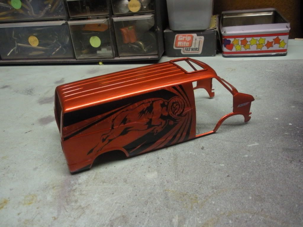

stewart Posted March 23, 2011 Posted March 23, 2011 Very good news. Last night, I put future on the decals because I have heard that it works well for fixing decals that won't set right. After I got home from work today, I went out and looked at the body and it looks much better. Most of the wrinkles were gone and the decals were clear. I just have to work out the few remaining wrinkles. STewart

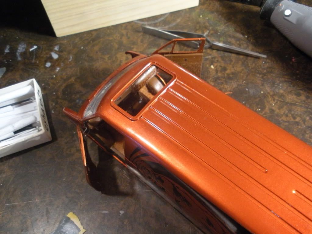

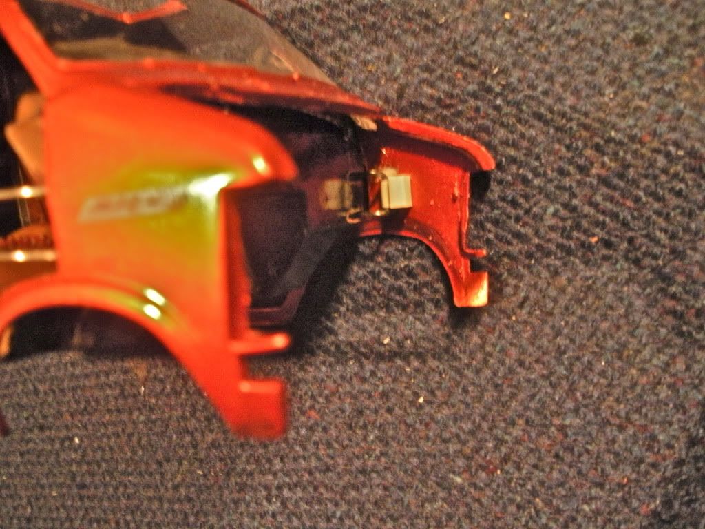

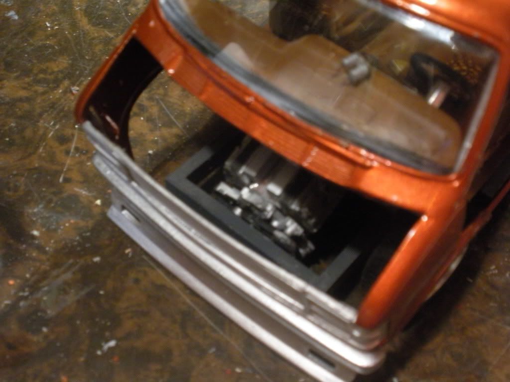

stewart Posted March 26, 2011 Posted March 26, 2011 Have a lot done. The interior bucket is in and I am working on the door hinges. They are glued in and I now need to glue the doors on. This is the first time I have done anything like this so I will see how it turns out. I used a paper clip and plastic tubing to make them. I still have a little to do on the grille but it has been sprayed with alclad. Here is a mockup with the wheels sitting in place. The hood is sitting funny so that it doesn't fall inside. Here is the engine bay. I still need to add details. Fortunately, I have a van of my own to go on and see what I need to put in it. The engine still needs its dual K&N air filters and a few other odds and ends before it is done. STewart

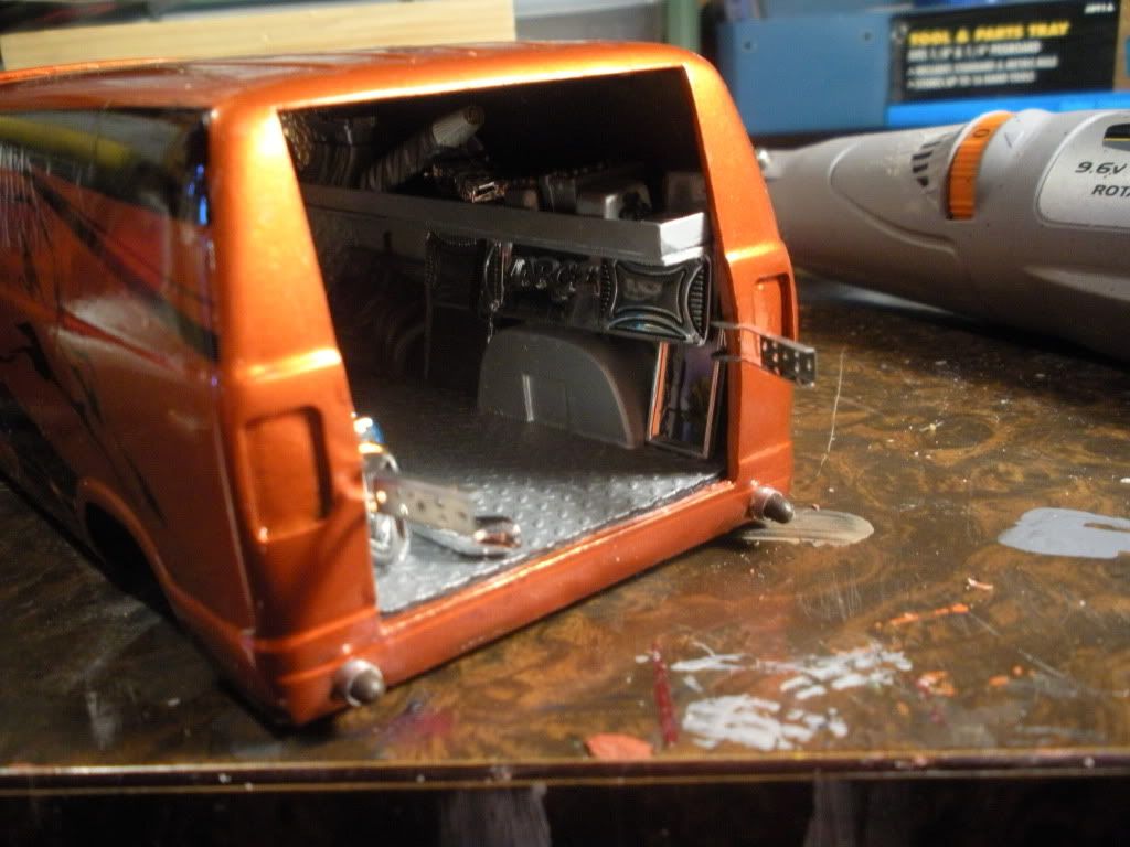

stewart Posted March 27, 2011 Posted March 27, 2011 Still trying to figure out the rear door hinges. I have put the interior panel on one of the doors. Here is a picture of the rear with hinges installed. Instead of a bumper I decided to use old style bumperettes. I put a piece of styrene rod in my dremel and rounded it. I then painted it rubber and put it in a piece of aluminum tubing. STewart
