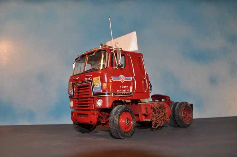

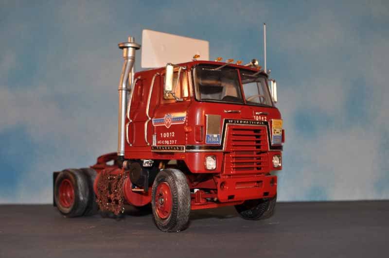

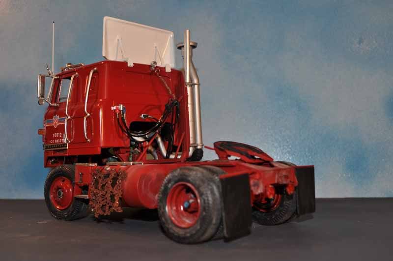

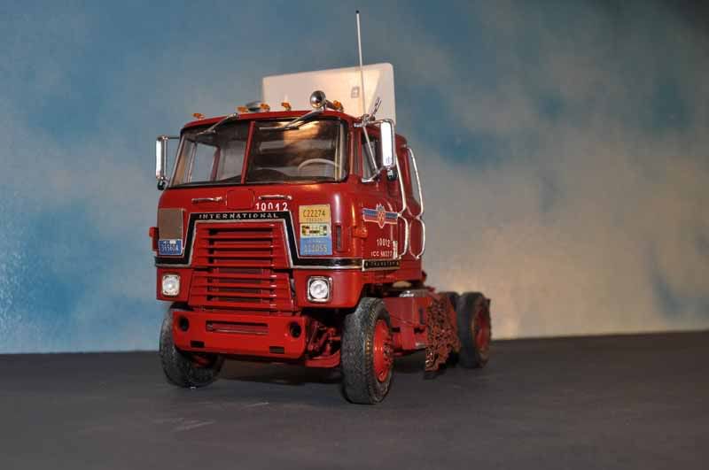

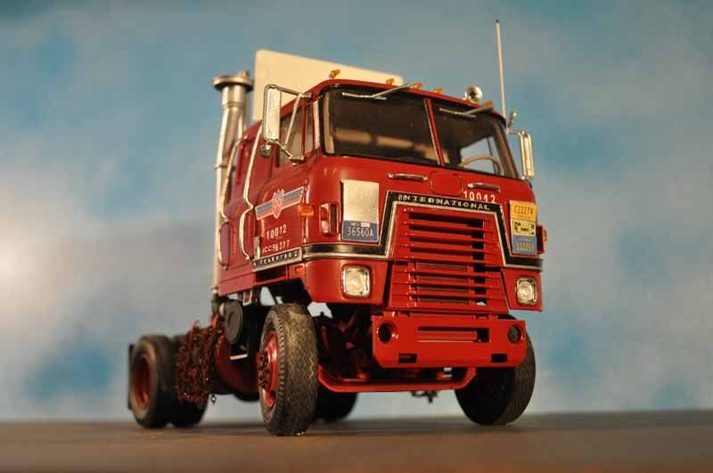

Finished this IH COE this evening. System 99 was an LTL carrier based in Oakland, CA. I remember seeing them a lot as a kid on Highway 99 through the Central Valley. The inspiration for this model came from a picture on Hank's Truck Pictures and from Lance Gregory's CF model.
I used an Ertl International Transtar II Eagle kit. The frame was cut down and I used a rear axle and suspension from a Ford Louisville kit. The wheels are Ben Wicker two hole Budds. Air deflector was from the parts box and was modified slightly. Front bumper was seperated from the grille, then cut down. The cab hoist was removed from the battery box and relocated to behind the cab. Battery box was moved rearward and steps were added. Marker lights were also from the Ford and the horn from the parts box. The modified pintle hitch, gladhands, electrical conector, hubometer, and battery box latch are all detail items from Plaskit. Chain hangars, and a few other detils were made from styrene parts. Colors are Dupli-Color Cherry Red over Dupli-Color Red Sandable Primer. The Detroit is Alpine Green and the air deflector gloss White from Dupli-Color. The decals are from images printed off the computer and dry rub letters and numbers. Several paints and artist pastels were used for weathering.

Well built with great weathering. the chains are killer.
Thanks Chris. The chains are cheap and easy to make, just time consuming. I wish I could mass produce them to hang from more of my trucks.
