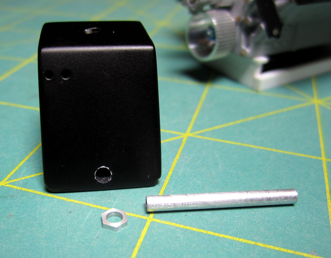

I first started out by reworking the fuel tank and drilling a few holes for the supply port. And by a few holes I mean I started out with a small pilot hole. Then I drilled it with a 1/16" and then with a 3/32" for the size of tubing I was using. I am using a piece of aluminum tubing as well as a nut from an RB Motion A/N fitting to create my supply port on the tank:
So this is a mock up of what it will basically look like. I need to glue the rod in place and then the nut in place. I will be repainting the fuel tank since the supply port was the same color as the tank:

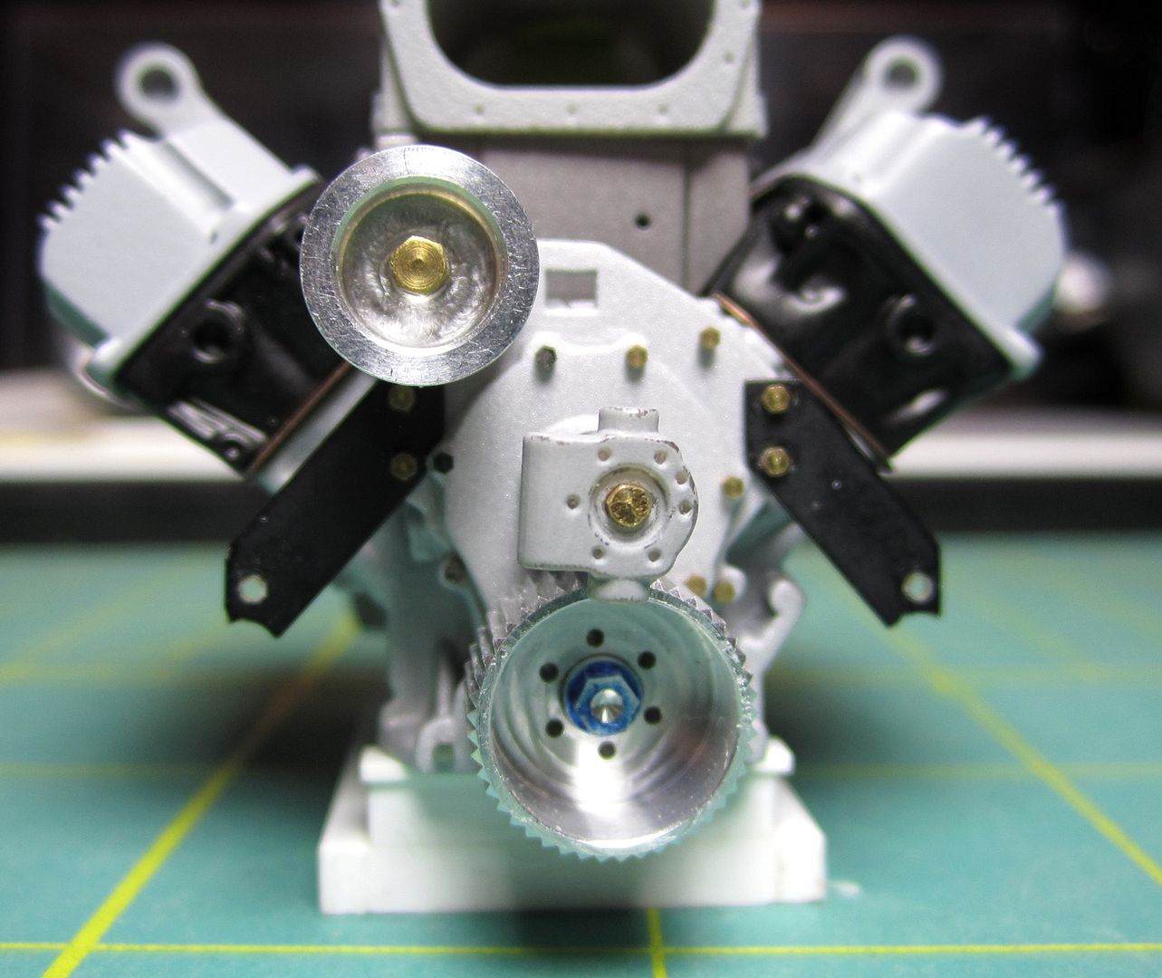

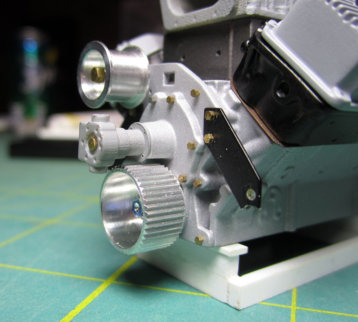

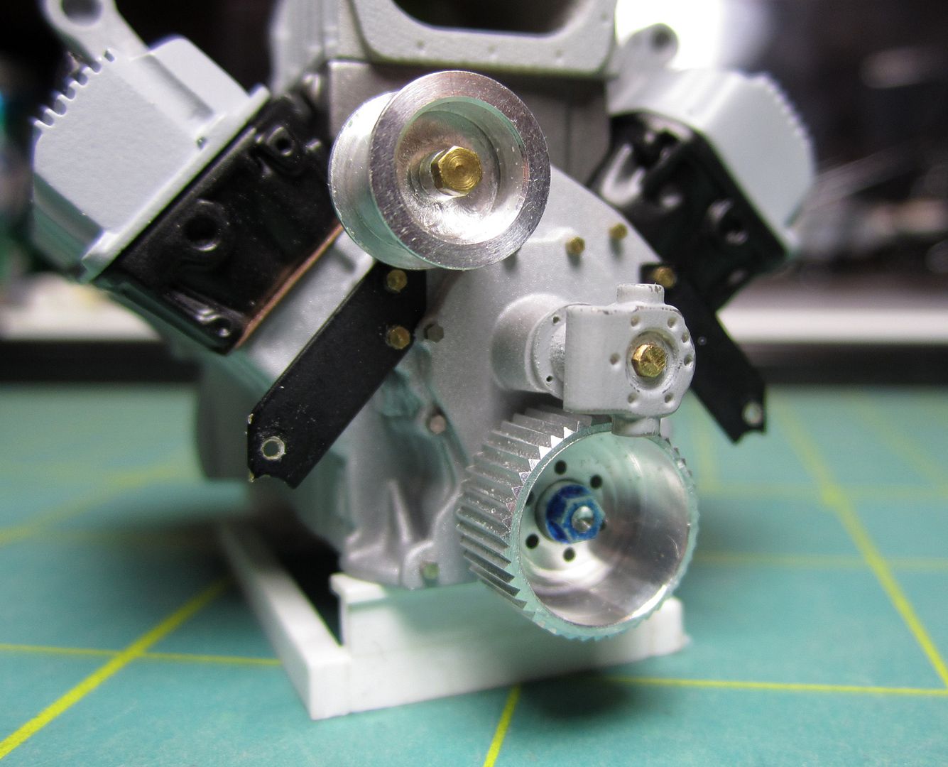

I had gotten the fuel pump mounted to the block. I had designed the fuel pump to where I could use a bolt to bolt it to the block from the center. I will still need to transfer drill the 4 mounting holes on the base for the bolt heads:
Another Angle:
And another view, as you can see in this pic I still need to sand the body down of the fuel pump and then reprimer it:

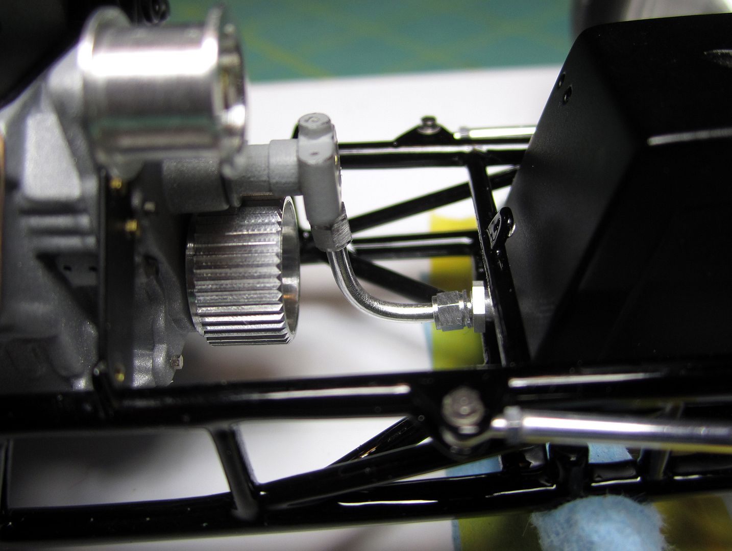

Then I had to do a quick mock up of the line. I am using some soft aluminum rod for the supply line that I will end up adding some heat shrink to it to create the hose. I will also be adding some worm clamps at the ends by the fitting and painting the fittings blue just like they are on the car. I think I will still need to adjust the line a little bit to get everything lined up perfectly but wanted to give you the idea of what I was going for. I should show you the only reference pic I had of the line:
