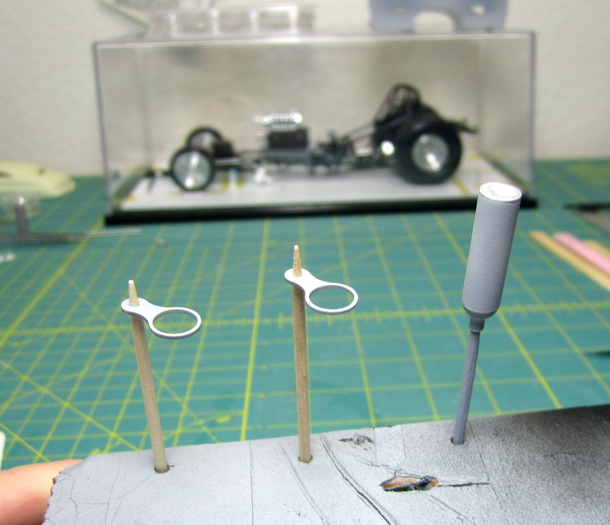

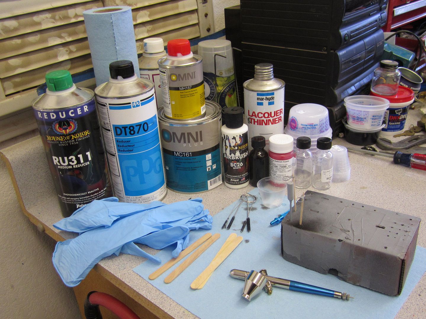

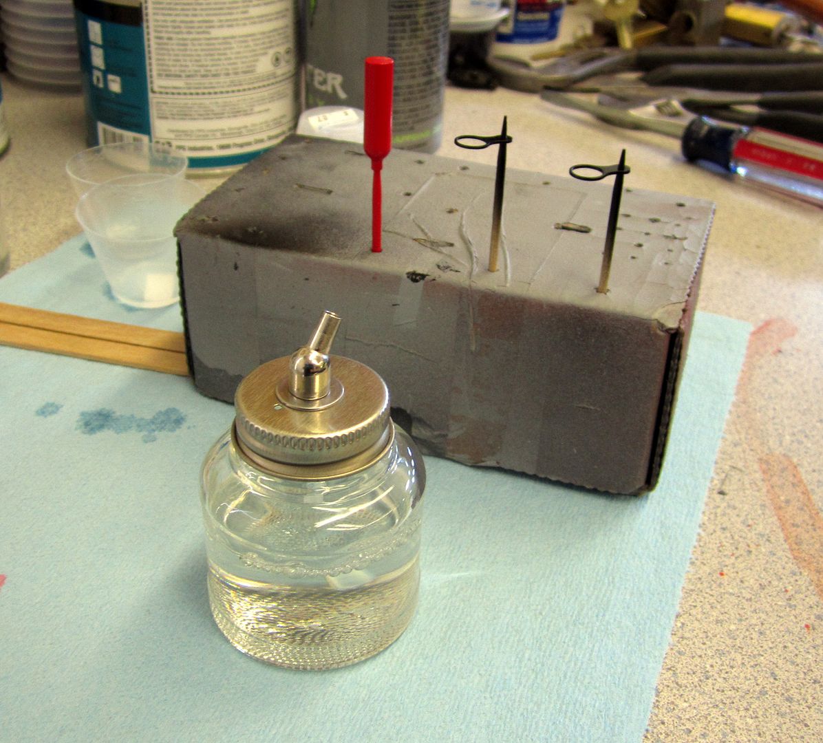

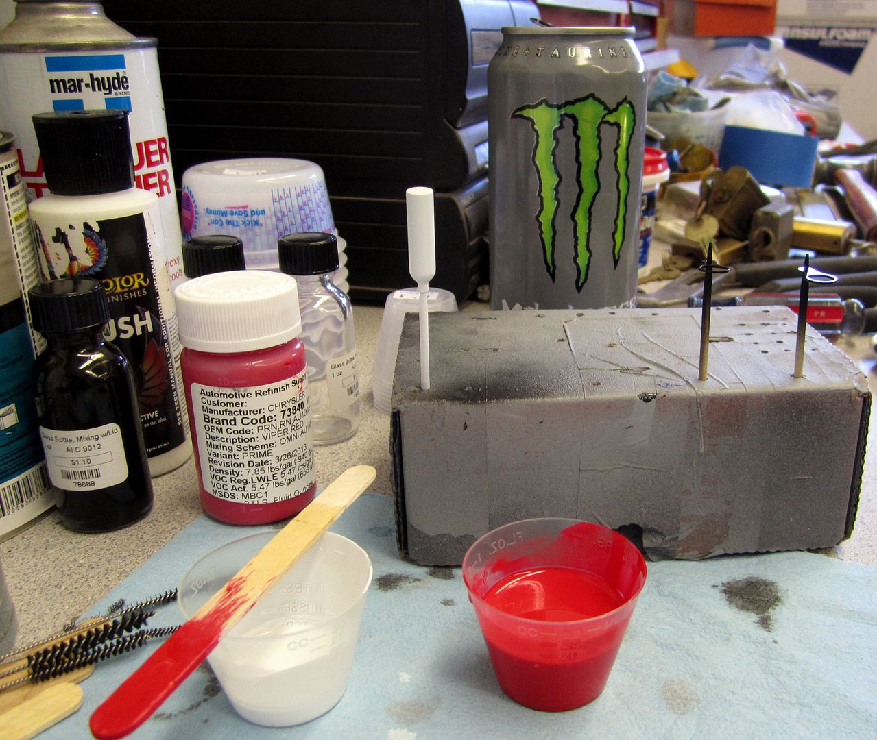

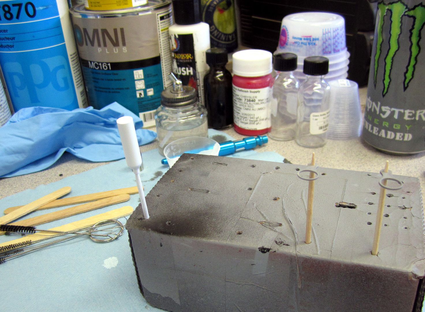

Mooneyzs Posted March 22, 2015 Author Posted March 22, 2015 Alright Fellas... I got some little updates to show. I decided to paint the fire bottle and brackets today. Let me jump right to the pics..... Here is the Fire Bottle and Brackets all wet sanded and ready for paint: Here is the supplies for today's adventure in painting: Here is the fire bottle after it has been based with House of Kolor white base: Here is the bottle mount brackets painted House of Kolor black base along with the PPG Viper Red I am using for the fire bottle all mixed and ready to spray: Here is the FIre Bottle after its been based with the PPG Viper Red and you can see I have the PPG Omni Clear all mixed up, I picked up some of this clear yesterday to try it out. IT sprays pretty much like my PPG Concept 2020 Clear which they don't make anymore so I am trying to save what I have left of it just for bodies. The Concept 2020 was probably one of the best clears that I have ever used:

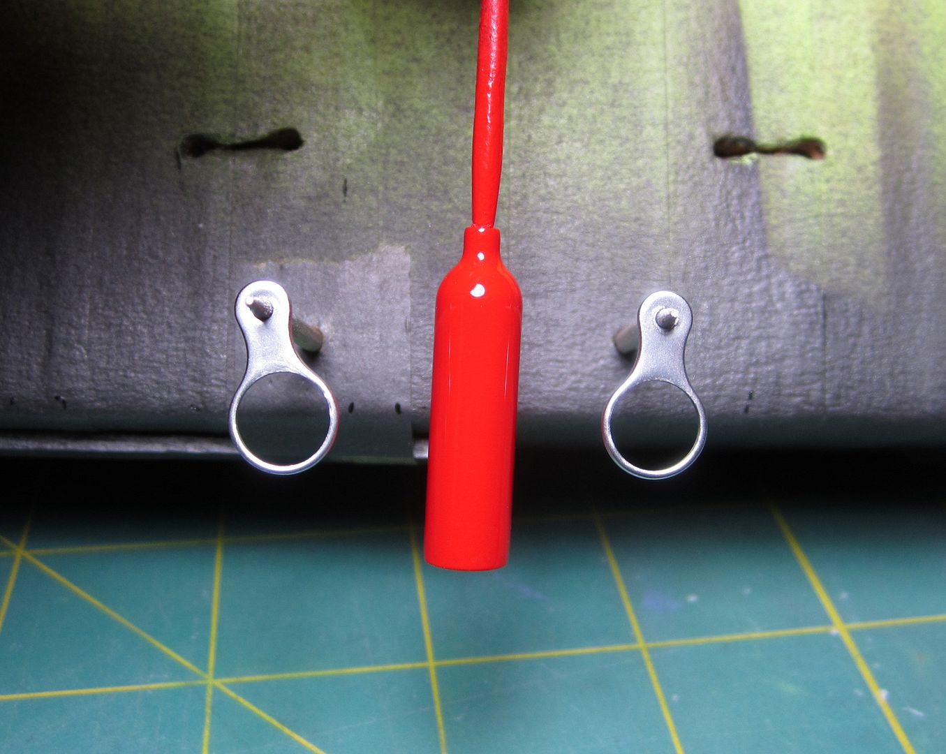

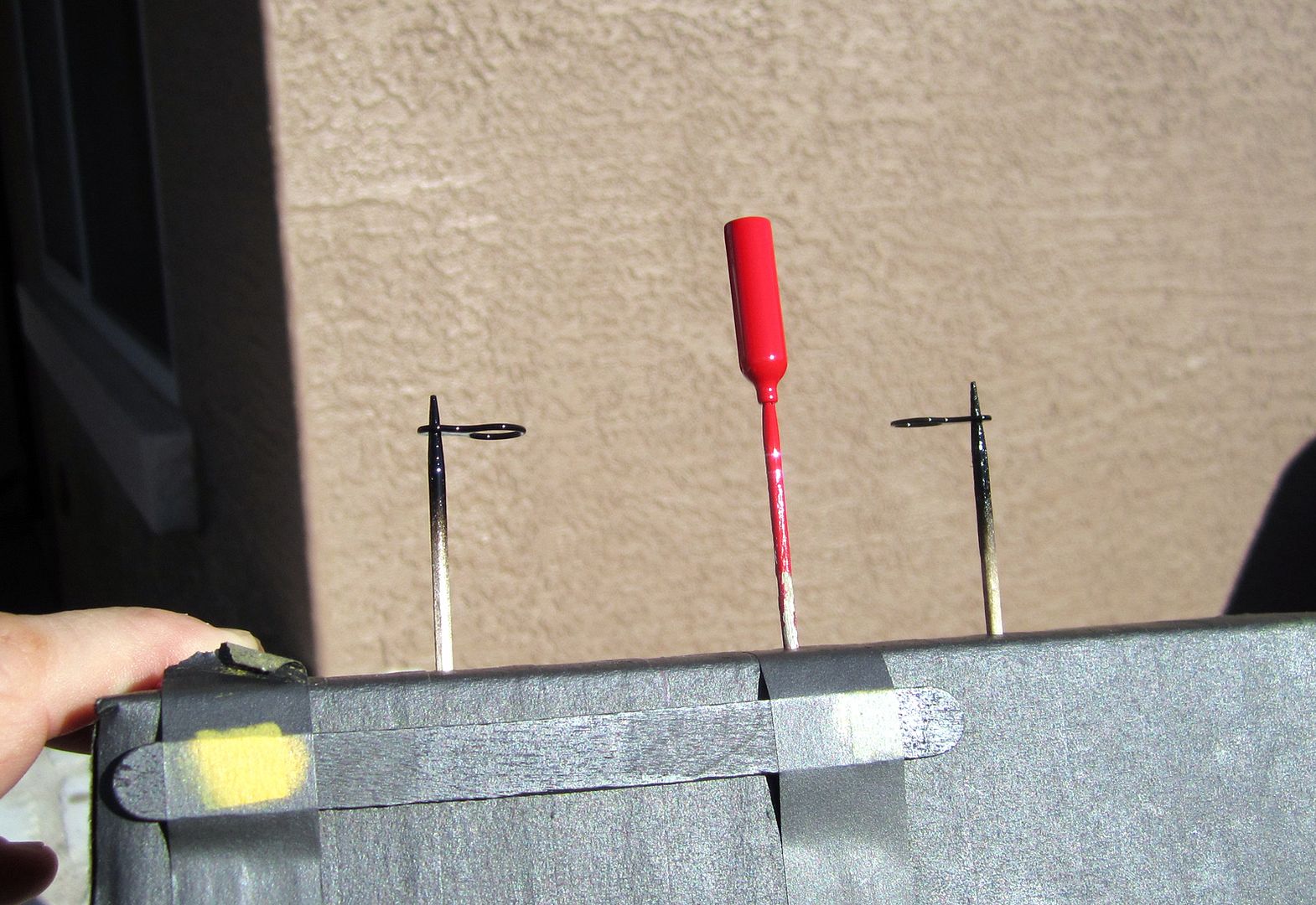

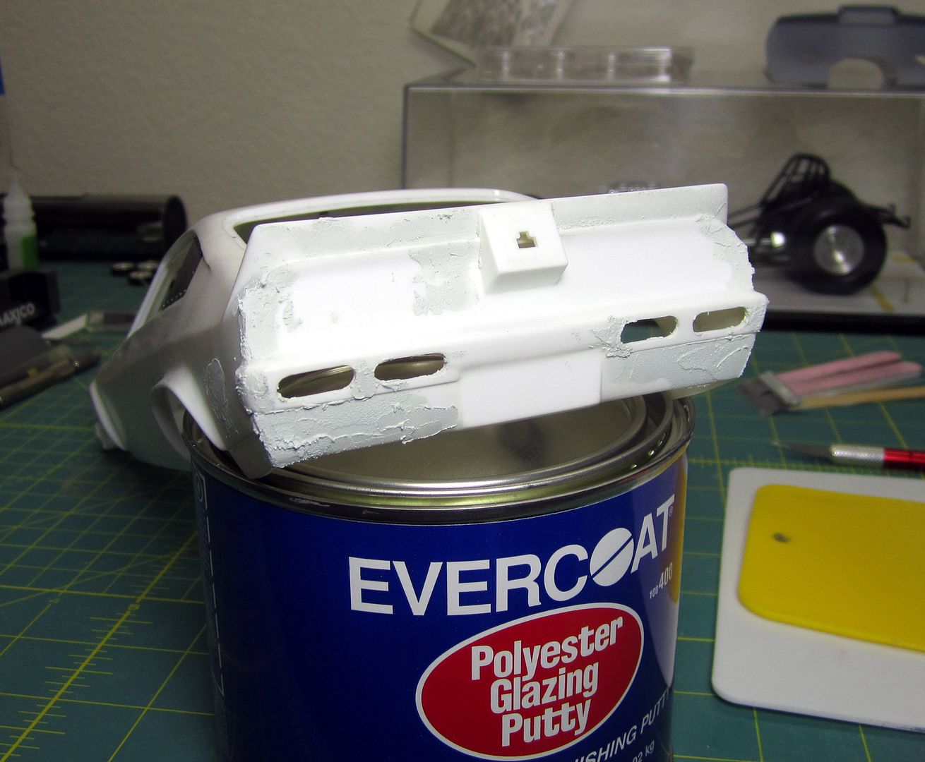

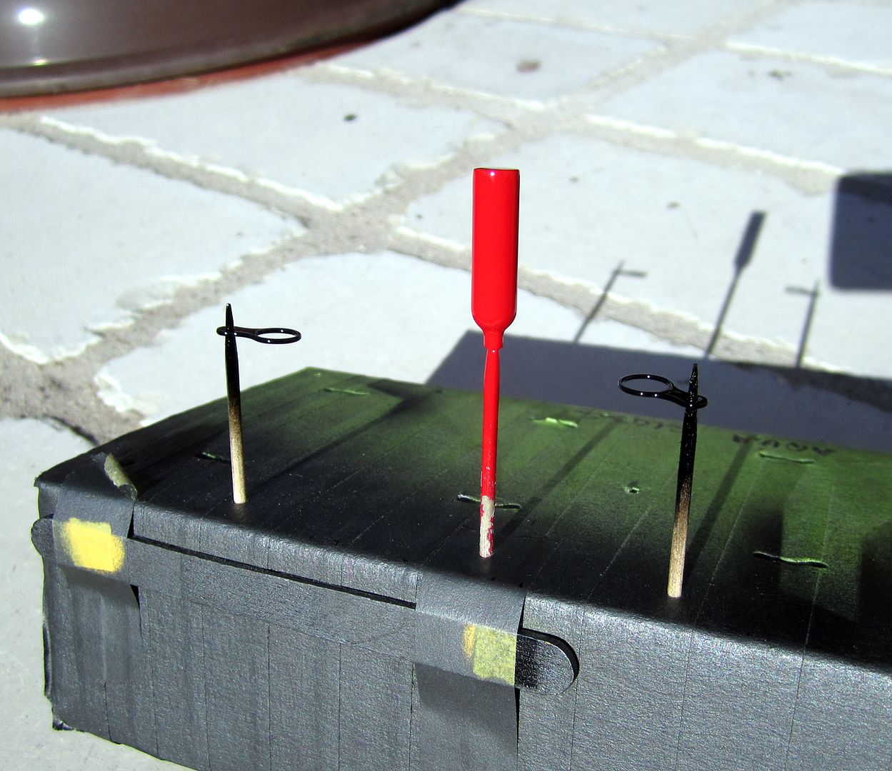

Mooneyzs Posted March 22, 2015 Author Posted March 22, 2015 Now here are a few shots of the bottle and brackets after they have been cleared. The Brackets I spray 2 coats of clear on and the Bottle I sprayed 3 Coats of clear on: Another shot in the sun trying to capture how bright and shinny it turned out: Here you can see the brackets. which will get a coat of Alclad polished aluminum on them next, Well hopefully tomorrow. I want to let the paint dry for 24 hours: Here is the start of the body work on the rear panel, Time to sand and start working on the rest of the body:
Randy D Posted March 22, 2015 Posted March 22, 2015 Hi Chris,New bottle looks great !!! Good to see some work going on with the body.Randy
Petetrucker07 Posted March 22, 2015 Posted March 22, 2015 The paint looks great. It's nice to see the body. Lookin forward to seeing the body in primer. I'll post pics of 2 cars when I finish them, with a few in process of the couple of scratch items.
cobraman Posted March 22, 2015 Posted March 22, 2015 I see you keep your unfinished chassis in a plastic case. I wondered how you kept the Arizona dust off the chassis in your photos. : )
Mooneyzs Posted March 22, 2015 Author Posted March 22, 2015 Randy... Thank you very much. I can't tell you how Happy I am with the fire bottle. now I still need to make the valve that goes on top of it. It also feels great to be working on the body. I am going to fix a couple of my body mount brackets that I broke on the underside of the body and then do more body work tonight. My goal is to have the body in primer for The Desert Scale Classic. and even have the body tins and body support structure's painted. I am even debating on getting the underside of the body painted black too. Clayton... Thank you. I have to admit I am so tired of seeing this body in bare plastic...lol Its going to a huge milestone when I finally have it in primer. Looking forward to seeing your builds when you finish them. Ray... Yep Ever since I got the chassis painted I had to think of a way to keep the dust off it. Although I know its gotten some on it when I have it out but this has worked pretty good for it. That is the one think I dislike about Arizona is how things get so dusty so quick. It was never like that when I grew up in California. I have been thinking about picking up a second or third case. one for the body and a smaller one for the engine..lol

Codi Posted March 22, 2015 Posted March 22, 2015 Chris, that just POPS. The entire bottle assembly is perfect and that red is just fantastic. Time and money...hmmmm....I would describe your build as simple "priceless" ! Looking forward to your next posting. Cheers, Tim
Magic Photos Posted March 22, 2015 Posted March 22, 2015 OK Money bags LOL Chris the fire bottle and brackets look great. The color is right on. will call tonight.
Mooneyzs Posted March 22, 2015 Author Posted March 22, 2015 Tim... Thank you. Yeah I am so glad I decided to go with this red that I got for it because there were a couple other reds the PPG guy was showing and he suggest the Viper red and I love how it Pops like you mentioned. You are right that when you love a build and are having fun the time and money become priceless. I don't think I have ever kept track of how much I put into a build before. Although I don't know the exact amount but I know its over the mount I posted above. Mike.... Thank you. Now I wouldn't say I am money bags.... but I have put a lot into this one...lol. Now if I could just win the lotto so I can finally get that Lathe and End Mill....lol. Talk to you later.

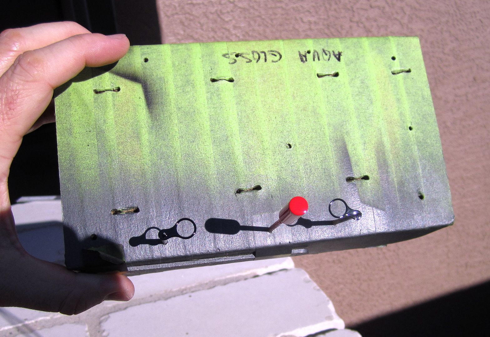

Mooneyzs Posted March 23, 2015 Author Posted March 23, 2015 Alright Fellas... I got a little more work done today. I got some Alclad Polished aluminum sprayed on the fire bottle brackets. and I did some sanding on the rear panel of the car and got the body filler smoothed out but It needs some more filler added. I was also able to get the few body mount tabs that I broke, replaced. Although I am just going to show you a pic of the Brackets that were Alclad and cleared with Alclad Aqua Gloss. I am too tired to edit the rest of the pics and I need to head to bed. Here is a shot for you. Here are the fire bottle brackets after they have been painted with Alclad Polished Aluminum and with 2 coats of Alclad Aqua Gloss. I will show some pics tomorrow of the brackets on the bottle. I wanted to make sure that they were good and dry before I even touched them. I am still considering having the guys at work try and machine me a set of these brackets just to see if they can. I will talk to them about it:
