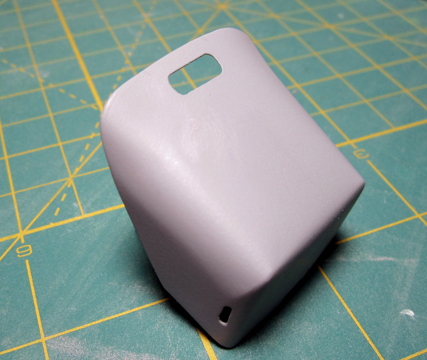

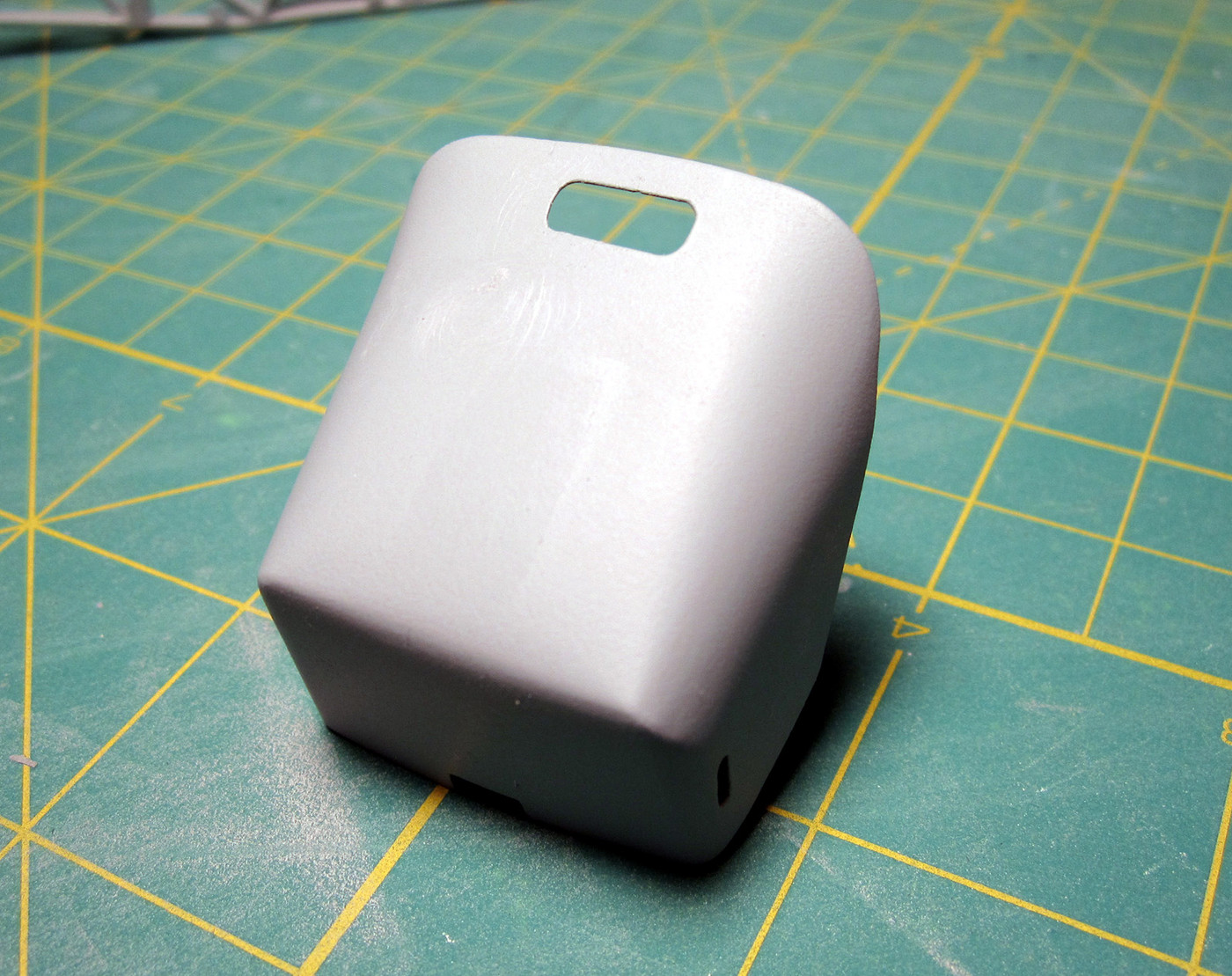

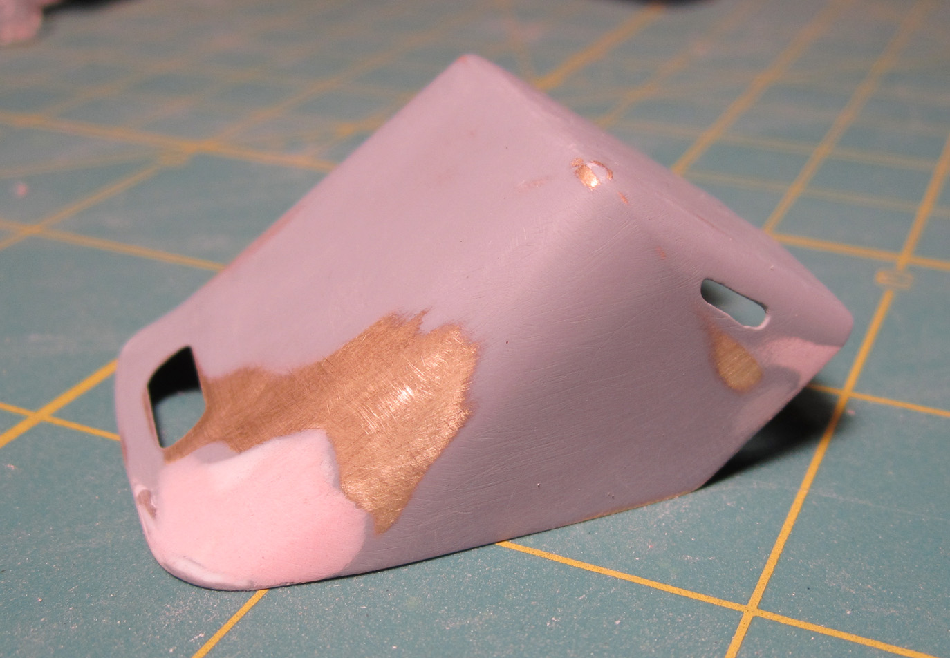

Mooneyzs Posted December 15, 2012 Author Posted December 15, 2012 (edited) Ok guys... as promised here are a few pics of what I have been doing lately with the seat. I have been adding bondo and sanding adding some more. Then broke one of the joints that I had to re-glue and redo some more of the bondo work...lol. Since it seems to be raining here tonight, I won't be able to spray my last coat of primer on the seat but i will get it sanded and ready to hopefully spray tomorrow. But that means tonight I can move onto something else on this build which will be a nice change because I am sorta tired of seeing this seat at the moment Here is the seat. I had to add some bondo on the inside since I noticed a few flaws in it: Here is some more shots of bondo that needed to be added since I made a piece to bridge the gap between the seat and chassis. I then needed to add bondo and feather it in so it was uniform: Here is the other side. which the same process was done: Here is the current condition with the seat after shooting another coat of primer on it: Right Side: Left side: Edited June 19, 2020 by Mooneyzs

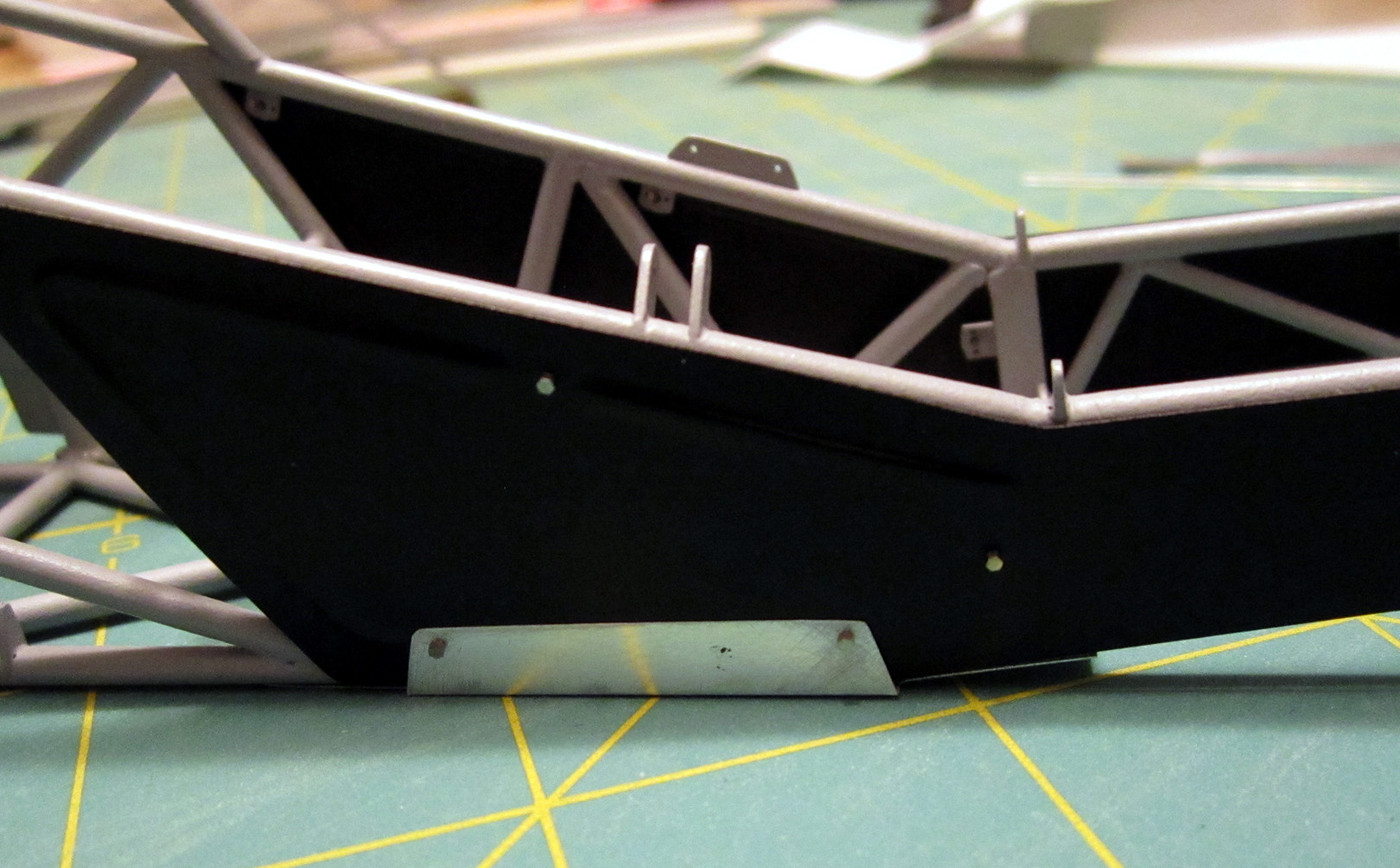

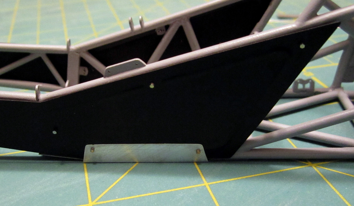

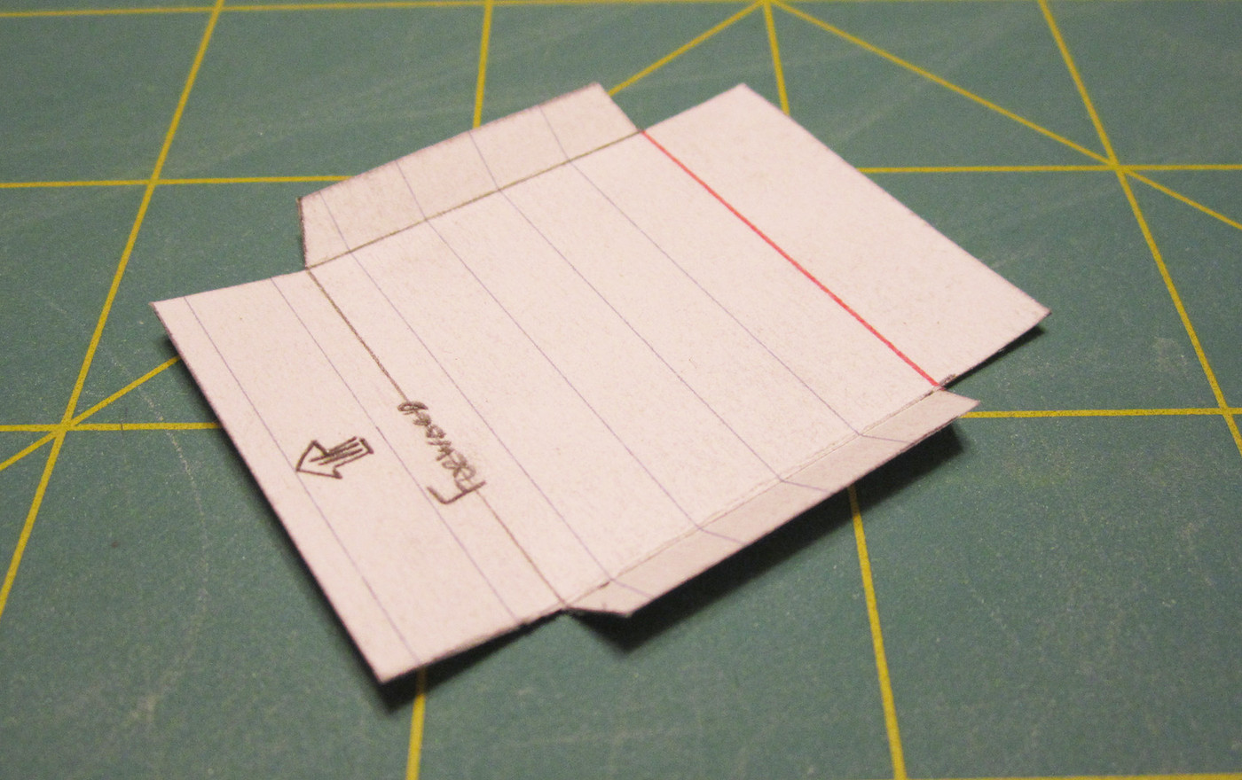

Mooneyzs Posted December 15, 2012 Author Posted December 15, 2012 Thanks guys..... Brad, I have been working on the bottom tin work for the driver area. I realized that after I redid the side tins that I never did the lower piece. So I have been making a template out of 3X5 card and I just cut it out from the Printing Plate you gave me. And now I am getting it all lined up to drill the mounting holes. I will post some pics when I am done with it tonight. So far it has been going good with making this piece. Back to trucking on this part.

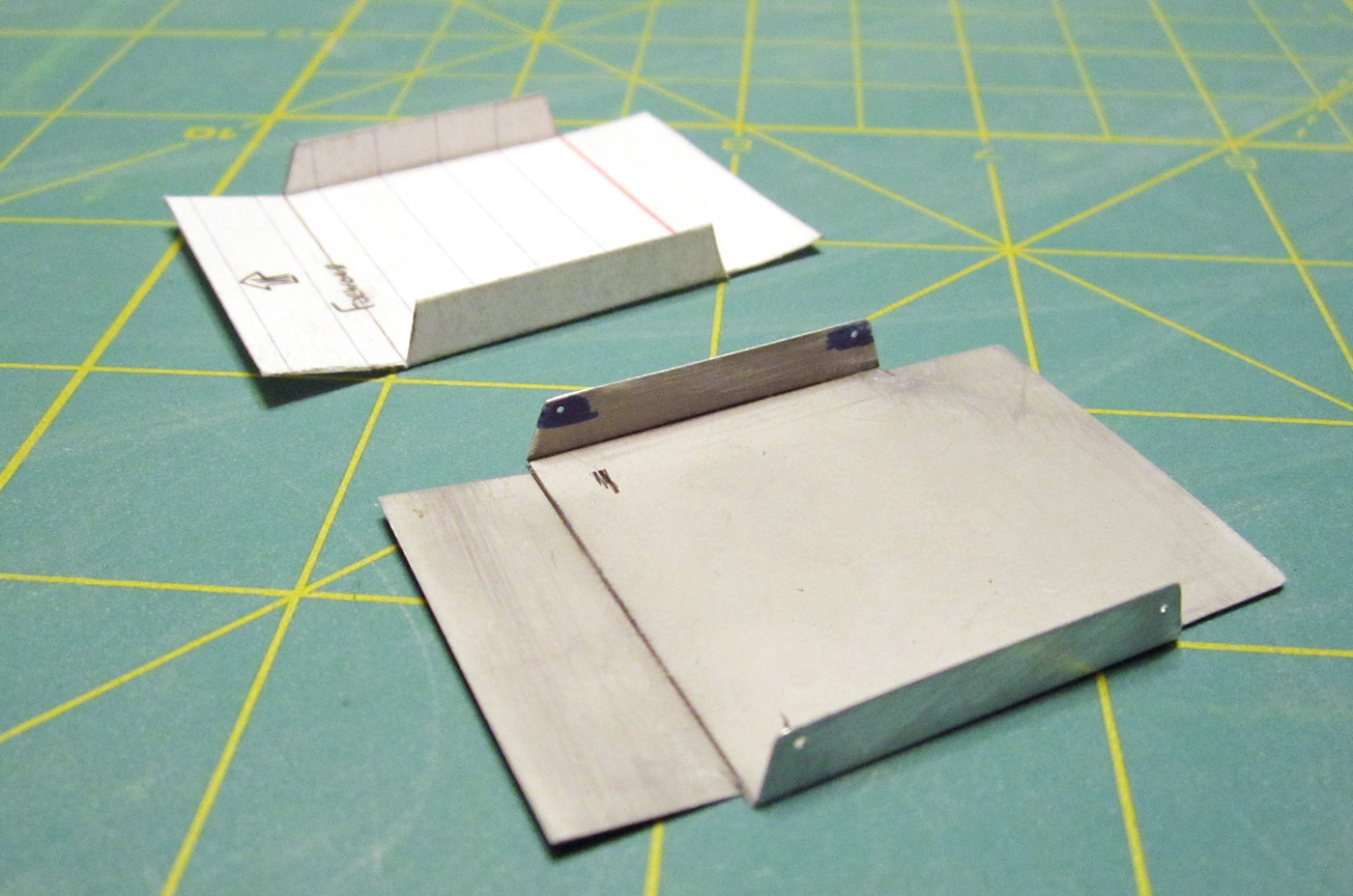

Mooneyzs Posted December 15, 2012 Author Posted December 15, 2012 (edited) Niko... Thanks so much bud! It feels great to be back at the bench again. I sure have missed it. I am trying to do each part the best I can. Ok guys so I got a little more accomplished tonight. Did some more Tin work for the driver floor pan. I started with making a template from a 3X5 card and then transfered the template to aluminum printing plate. I still have a minor work to finish it but it is about ready for primer soon. Here is the template: Here is the floor pan made from aluminum printing plate: Here is the template and the part made up: Then of course I had to mock it up to test fit everything. in these pics I just have some temp bolts holding the tins in place. I will actually be using a different style bolt for the DZUS fastener: The inside: View from the bottom: Edited June 19, 2020 by Mooneyzs
