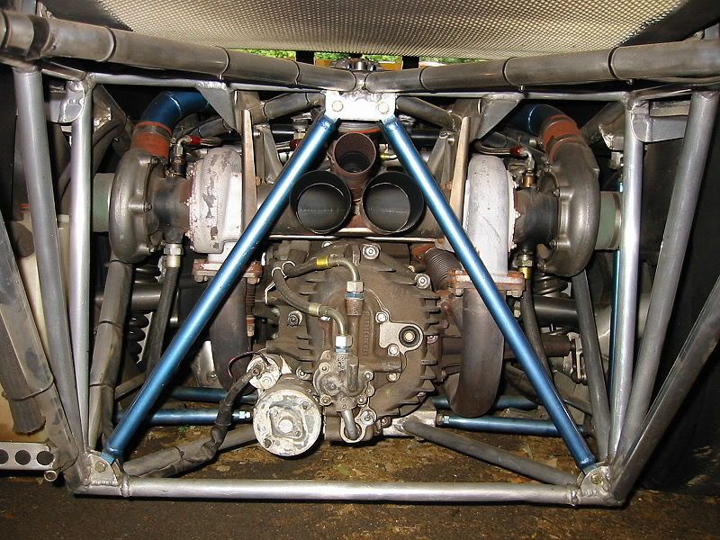

It made some ridiculous 2.9 bar (40psi) of boost
800px-Porsche_917-30_CanAm_Spyder_turboc
The part of the Porsche 917/30 most often seen on the track during the '73 CanAm.
