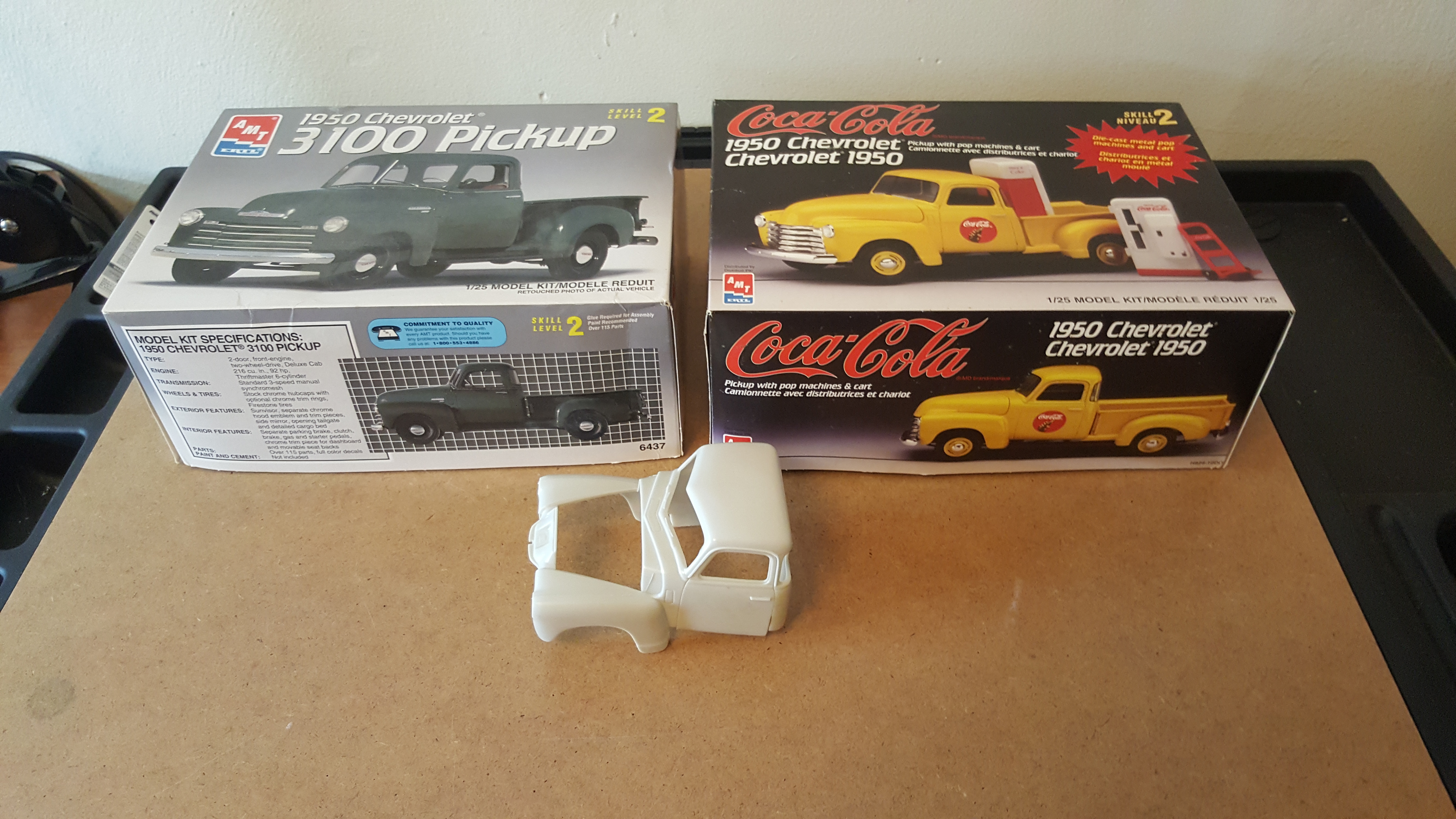

window Posted June 8, 2014 Posted June 8, 2014 how much work would be needed to change this into a 1952 version?
Longbox55 Posted June 8, 2014 Posted June 8, 2014 Most of the differences will be in the doors. You'll have to add vent windows, and the door handles will have to be changed out. The correct door handles can be found in the revel '64/'65 Chevrolet trucks. On the passenger side, the door lock will have to be removed as well. In addition, the cowl vent on the drivers side, located just in front of the door, will also have to be filled in. For a correct stock truck, the grille should also be de-chromed, with the outer bars painted body color, the inner bars painted Thistle Gray. Other than that, there really isn't that much difference.

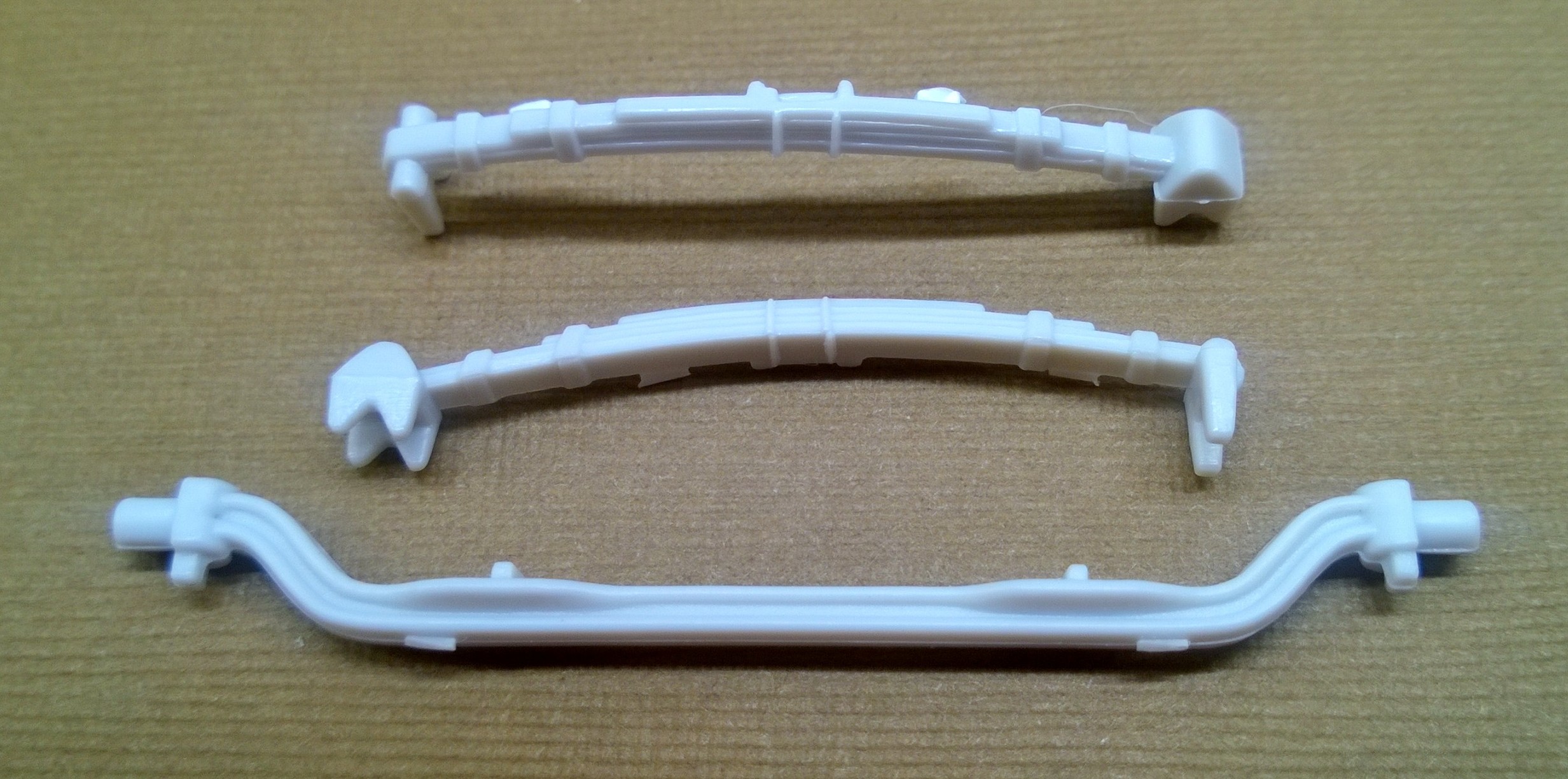

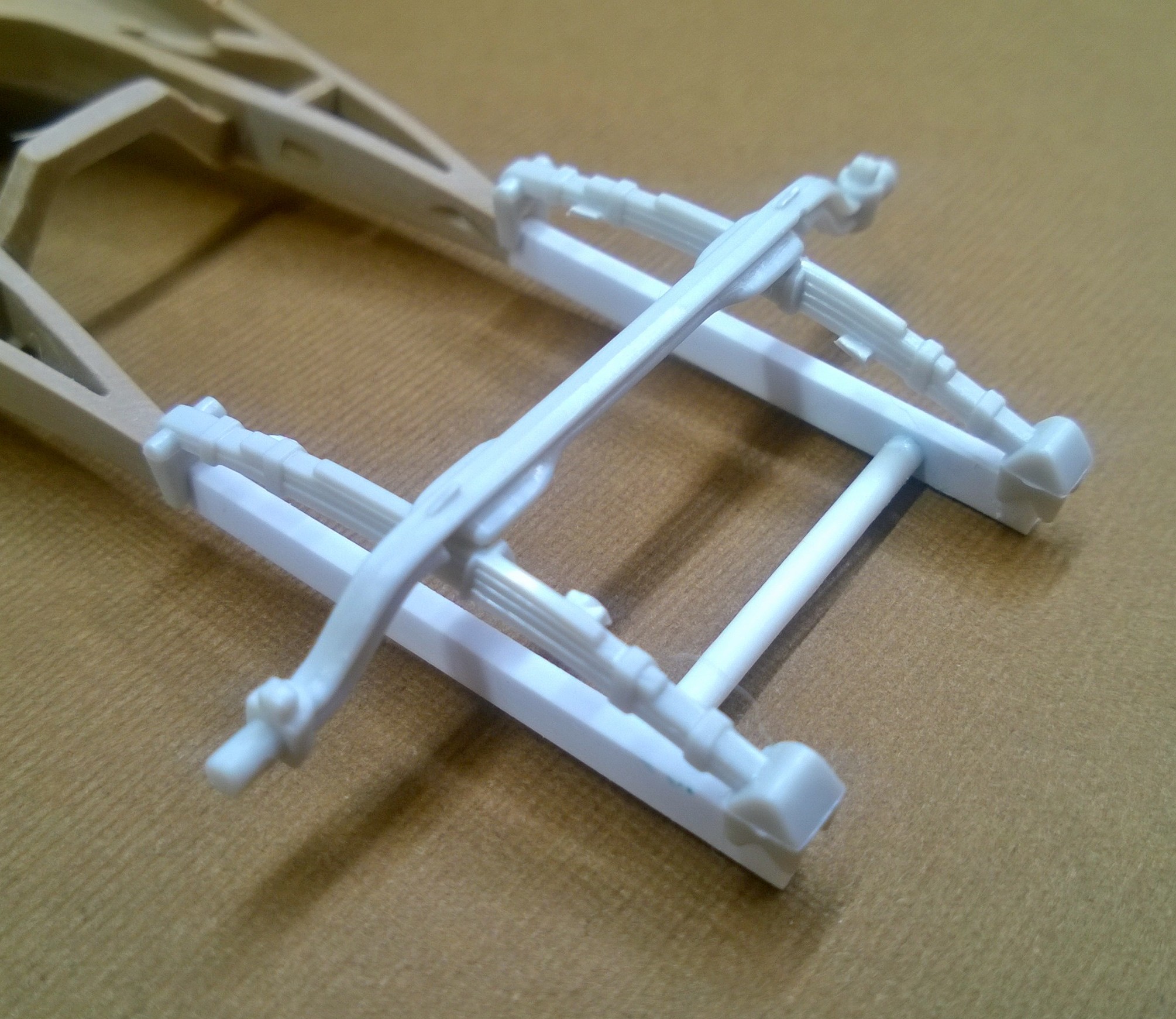

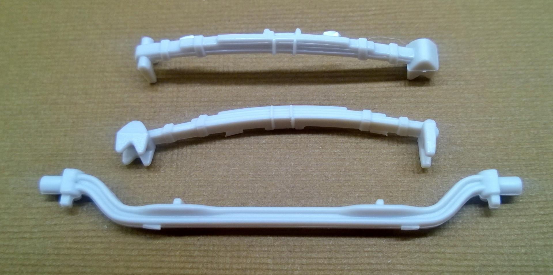

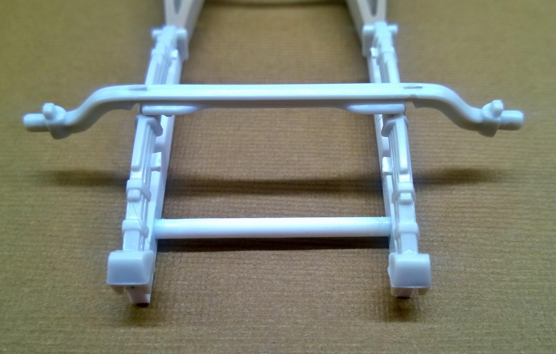

Casey Posted February 11, 2018 Posted February 11, 2018 On 2/9/2018 at 8:36 PM, Daddyfink said: So, what happened to this Dr. Cranky guy? One of his models was on the cover of issue #203 of Model Cars Magazine, so he's still active in the hobby, just not here on the forum. I'm sure most people (myself included) would be loath to spend $29.99 on a kit just for a few parts, but keep in mind this kit contains a nice set of parallel leaf springs and a solid beam front axle, which is just about perfect for use in a "gasser" type build. The leaf springs are nicely detailed and have a realistic arch, and the axle's mounting flanges are wide enough to allow for some side-to-side leeway when mounting them on the donor vehicle's frame rails, too.
Daddyfink Posted February 11, 2018 Posted February 11, 2018 5 hours ago, Casey said: One of his models was on the cover of issue #203 of Model Cars Magazine, so he's still active in the hobby, just not here on the forum. I'm sure most people (myself included) would be loath to spend $29.99 on a kit just for a few parts, but keep in mind this kit contains a nice set of parallel leaf springs and a solid beam front axle, which is just about perfect for use in a "gasser" type build. The leaf springs are nicely detailed and have a realistic arch, and the axle's mounting flanges are wide enough to allow for some side-to-side leeway when mounting them on the donor vehicle's frame rails, too. Thanks for the update. And for the axle and springs, maybe someone could resin cast them as an alternative to buying the kit for them.
crazyjim Posted February 11, 2018 Posted February 11, 2018 Cheaper to scratch build the springs with Evergreen strips. Use aluminum tubing for a straight axle.
Casey Posted February 11, 2018 Posted February 11, 2018 55 minutes ago, Daddyfink said: maybe someone could resin cast them as an alternative to buying the kit for them. Maybe someone already does? I honestly don't know, but it's a popular swap for 1:1 Tri-Five Chevies and other similar era hot rods, so it makes sense in 1/25 scale, too. For those who aren't using the stock front suspension after buying this kit (or an older issue), it's good trade bait at the very least, and also a good group of parts to keep in the stash just in case.
