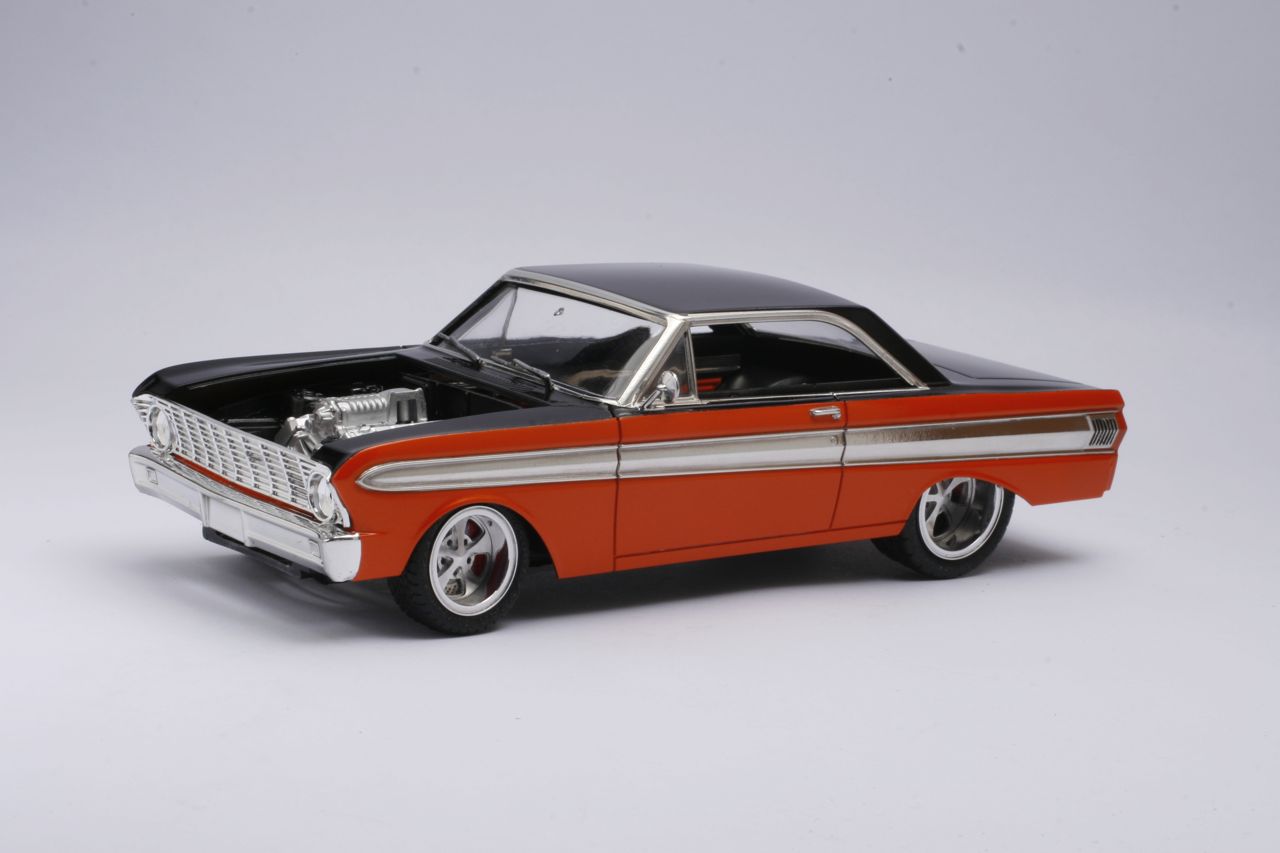

Phildaupho Posted April 26, 2011 Posted April 26, 2011 I was wondering how you would feel about that. I may even go one step further and "Foose" it, where it is roughed up with very very fine sandpaper or polish, to give it a brushed aluminum look, but I can always do that at the end. Okay, I pau for now, maybe even for today.. From one Falcon guy to another, I really like your build and think the brushed affect will look great. I like the brushed panels on the back of the Ford Flex and think it would look good on the sides as well. Sort of the modern equivalent of a country squire. I remember the first model I saw of Gregg's - a 48 Woodie with chrome foil and carbon fibre rather than wood.That's thinking outside the box. It looked awesome. Have a great time at GSL

Gregg Posted April 26, 2011 Author Posted April 26, 2011 From one Falcon guy to another, I really like your build and think the brushed affect will look great. I like the brushed panels on the back of the Ford Flex and think it would look good on the sides as well. Sort of the modern equivalent of a country squire. I remember the first model I saw of Gregg's - a 48 Woodie with chrome foil and carbon fibre rather than wood.That's thinking outside the box. It looked awesome. Have a great time at GSL Phil, I am humbled that you remember that one! I just looked at it's second cousin, one I was going to make into a fully-detailed one, with aluminum and better carbon fiber. I am humbled...

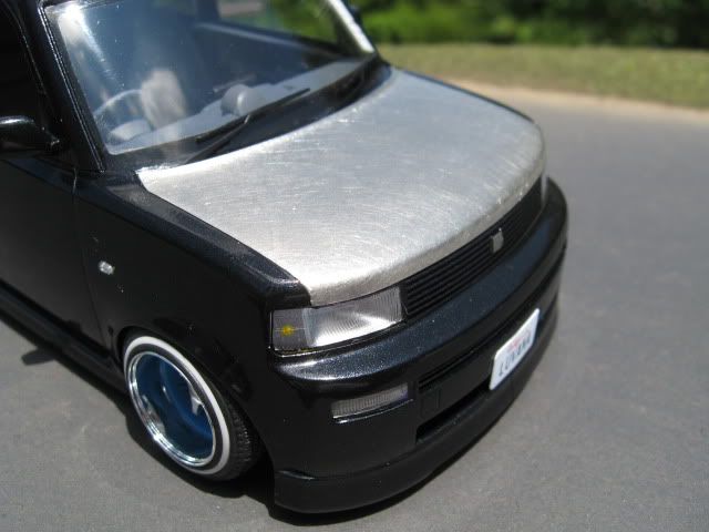

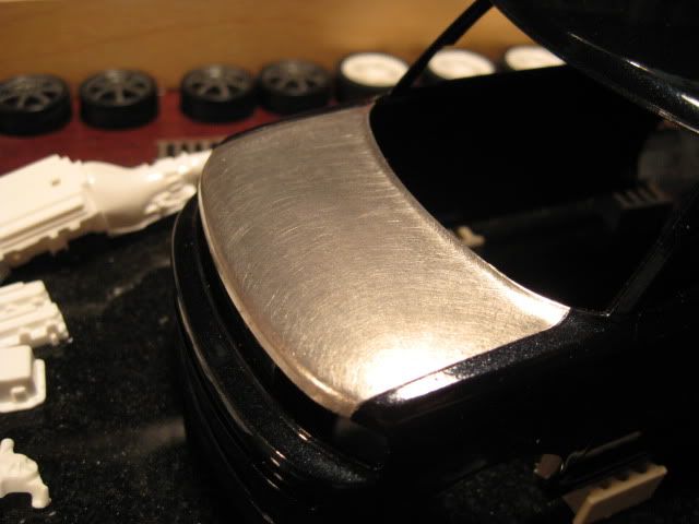

Gregg Posted April 26, 2011 Author Posted April 26, 2011 Fine steel wool also would work well for creating a "brushed" look on those side panels. I'd definitely do that; having that entire area done in bright chrome is bit overwhelming, IMO. Something else you might consider that I think would look cool is painting the "hash mark" trim on the rear quarters black. Just a thought ... I did the black in the Chevrons, didn't reshoot the pics yet. I haven't found the steel wool yet My methods with polish/paper don't work I was going to try the steel wool, or maybe like Chip did, with that green Scotch pad first on a test side/strip
sjordan2 Posted April 26, 2011 Posted April 26, 2011 (edited) I did the black in the Chevrons, didn't reshoot the pics yet. I haven't found the steel wool yet My methods with polish/paper don't work I was going to try the steel wool, or maybe like Chip did, with that green Scotch pad first on a test side/strip Why don't you just shoot semi-gloss or use a brush? Actual brushed metal wouldn't look right at this scale. Edited April 26, 2011 by sjordan2
Kanedge Posted April 26, 2011 Posted April 26, 2011 To me, it looks like a 64 Falcon, and Gregg, I think your build is turning up a treat, look forward to more.
Harry P. Posted April 26, 2011 Posted April 26, 2011 Why don't you just shoot semi-gloss or use a brush? Actual brushed metal wouldn't look right at this scale. There's an idea. Maybe even Testors Dullcote. That would give a nice contrast to the "chrome" outlines. (Although I like the full-chrome look, like you did it in the first place).
Harry P. Posted April 27, 2011 Posted April 27, 2011 the green Scotchbrite pads will work, in my case i rubbed the foil while it was still on the sheet, then transfered it to the model. if you are careful i'm sure you can do it while it's on the model already. make sure you wipe it down afterwards to get rid of the black residue. Sorry, but that looks more like vandalism than brushed aluminum (in scale)...

Guest Posted April 28, 2011 Posted April 28, 2011 (edited) It's looking nice Gregg,but I'm not sure about the chrome panel. I have to say that the more I see of this kit,the better I like it regardless of the flaws. The engine looks really nice setting in there. Which Mustang kit is it from? Something else I see that I like is that the grille looks like it will be easily opened up. Forget the GSL! Finish the Falcon!!! Edited April 28, 2011 by plowboy
Gregg Posted April 28, 2011 Author Posted April 28, 2011 The engine looks really nice setting in there. Which Mustang kit is it from? The motor is from the Revell 08 Shelby GT500 kit. I may just stop and do all the photos for the review, and then build another one. After building this one real quick, I see some areas where it has to be perfected. That's one thing about shooting it with this camera in the mini studio. You really see your flaws! But, it's nice, and I will be doing a couple more of them. I took the whole front clip off the Shelby 500 Mustang, and shot pics of it along the way It's not a drop in fit, but almost. It was a cool conversion, and you could even get away with swapping out a complete new Mustang chassis under the Falcon, it fits, of course. I don't know the two-tone got that bleed through, I sprayed clear over the tape before I shot the black. It may have been the tape, I was trying new pinstriping tape, should have stayed with the Tamiya tape. My goal was to have it pau for GSL, and enter it. I'll just bring it and show it off in progress. Thanks for all the input on this. I may even try later to do that brushed looked again.
