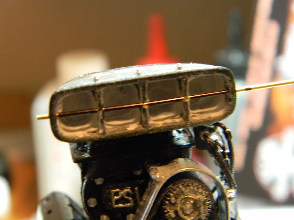

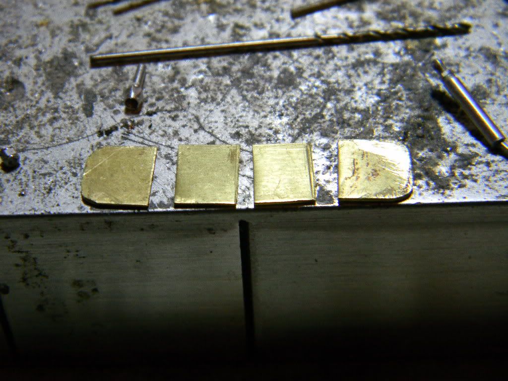

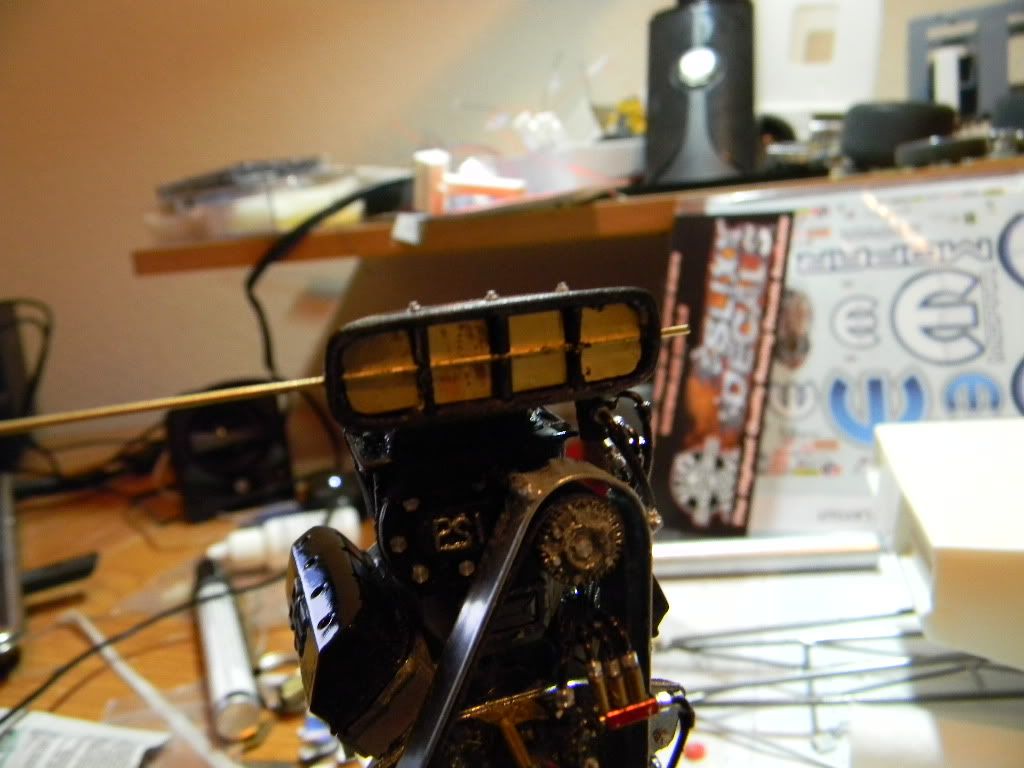

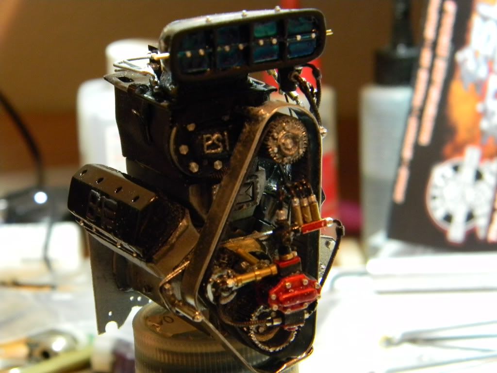

I was able to get the butterfly doors on and they did indeed work, but they are way to fragile I kept breaking the setup so I decided I would just glue them shut other wise it would just been one more thing to worry about when traveling. so with out further ado here's what I came up with. I hope you enjoy. :unsure:
Here's the injector hat drilled out and the hinge wire being fitted
the four separate butter fly doors cut from brass
here's the setup before I broke it the first time.... :huh:
finished and final setup

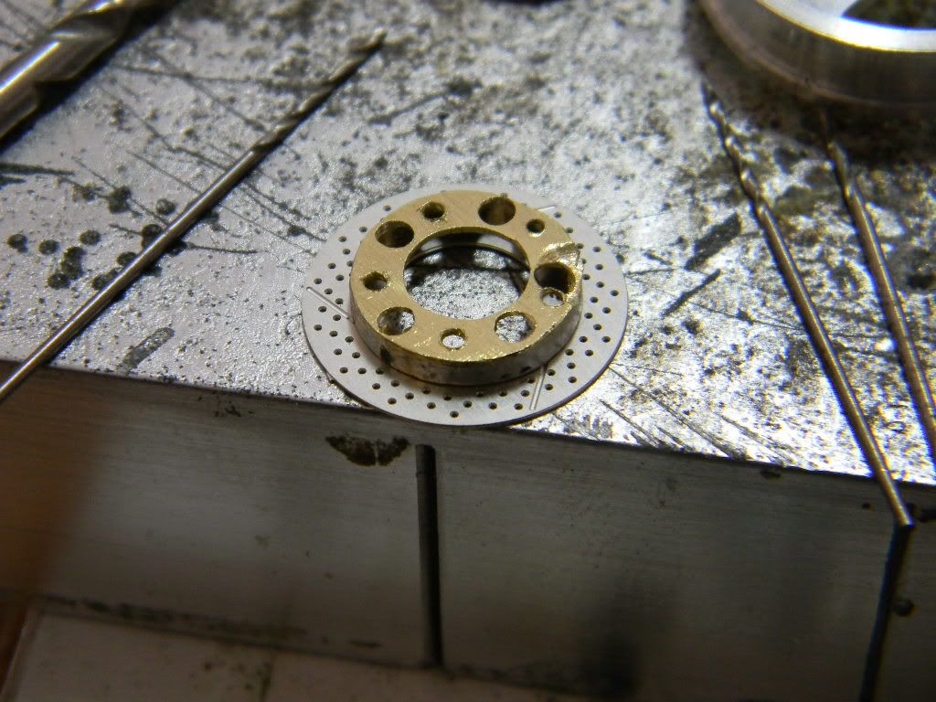

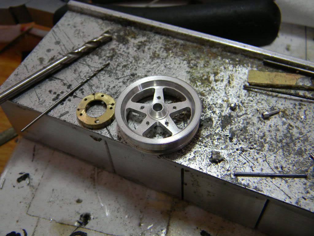

Well fellas I was able to get the front brake assembly started so I thought I'd share what I have so far. Hope you enjoy

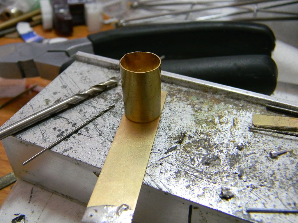

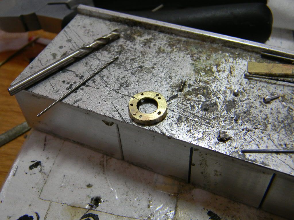

I started by soldering a cap onto this piece of brass tubing

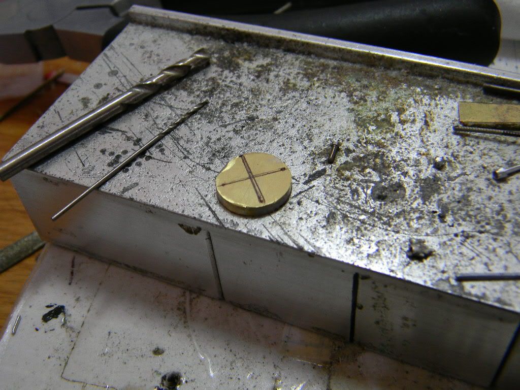

then I cut the tube down to 2mm and marked off the center for later drilling
the piece has been drilled out and marked for the fastener holes
here the rim has been drilled also to mate the brake rotor
finally the rotor is added, all thats left is to paint it and add the lug nuts
of course i'll clean this up before it gets painted. Come back soon for more. B)

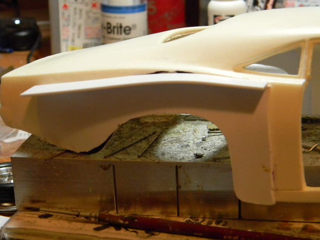

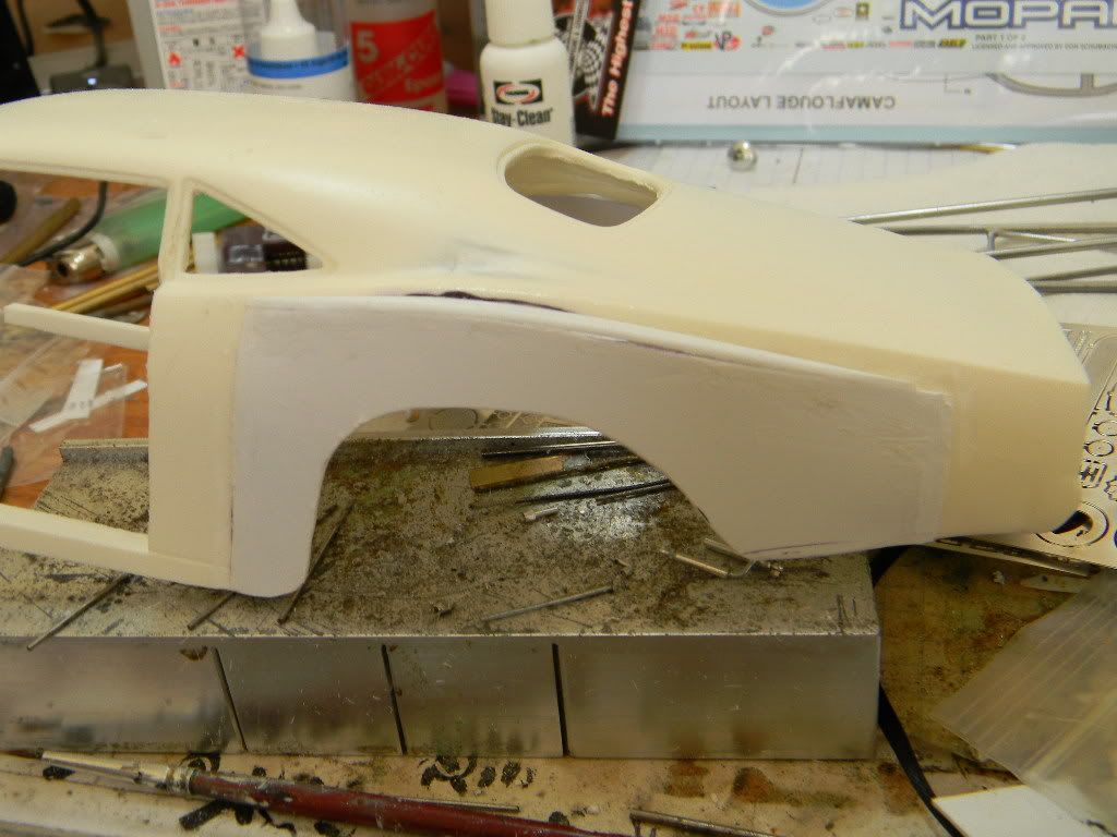

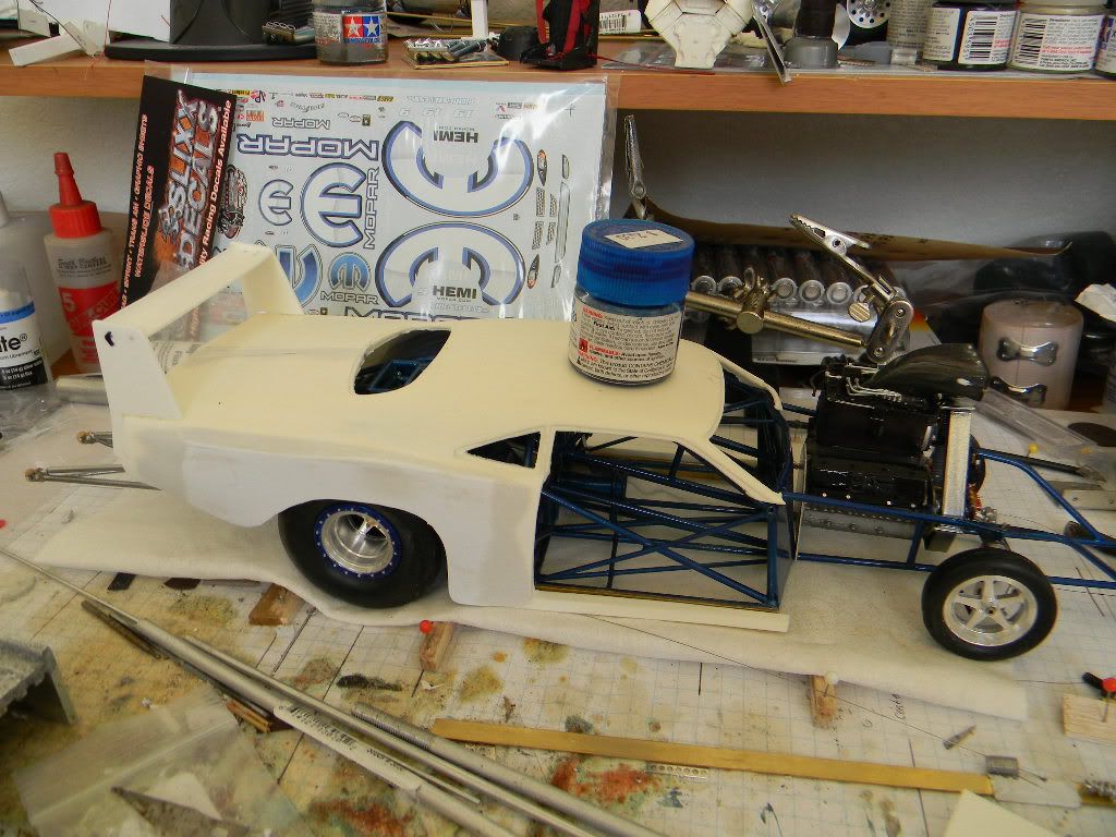

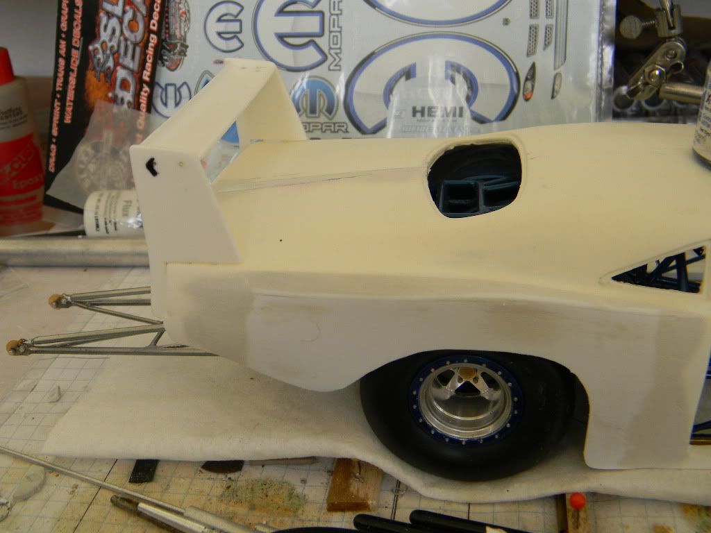

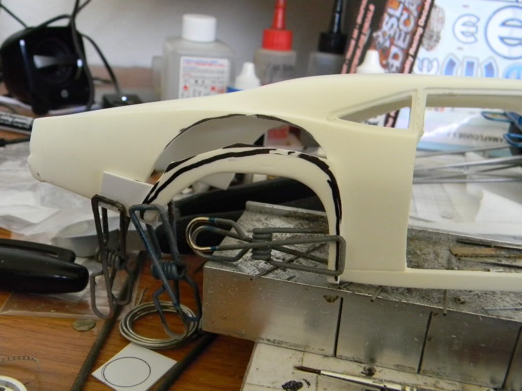

Well fellas I'm into the part of the build that I like the least. Body work! not that i cant do it I just rather not do it :huh: . Any way i had to widen the rear fenders to make room for those huge FlashPoint tires. Here's what I did to get it right.

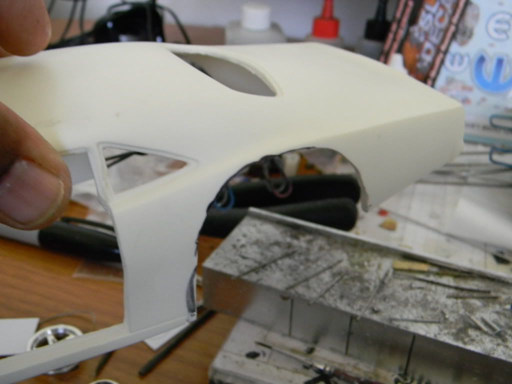

Originally I was gonna cheat and just move the wheel opening out a few mm. but I felt like I was cheating so I went a better route
instead I cut out the wheel opening and made a whole new fender that brings the fenders out 4mm on both side
cut down to size....
see ya on the next post B)

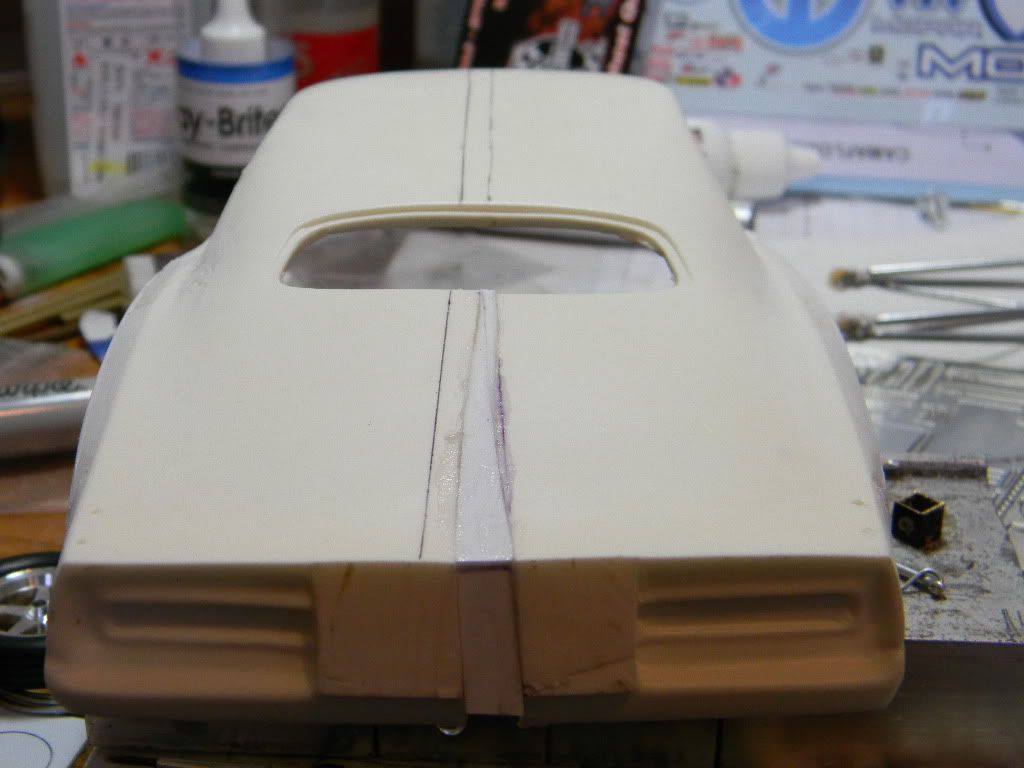

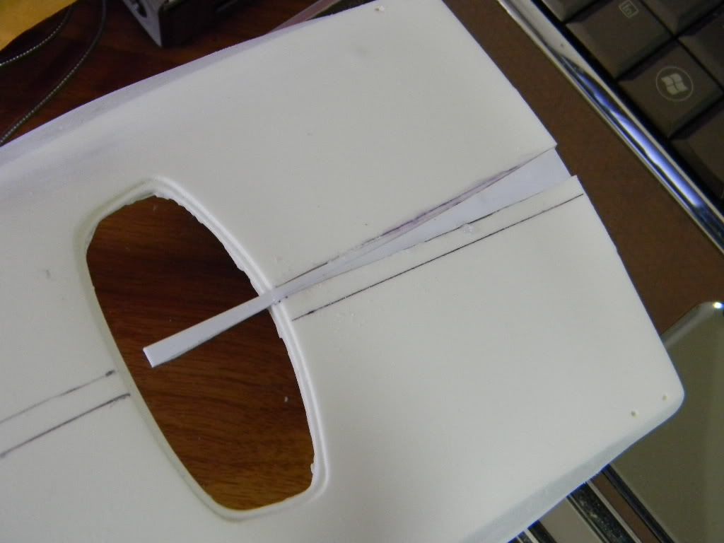

Ok I got the fenders widened but I still need a tab bit more room so I cut the body down the center and install a wedge that will give me 2mm more on the sides
heres the fender with putty on it
Here's the wedge installed now all I have to do is make it all look like its not there. B)
see ya on the next update :D
