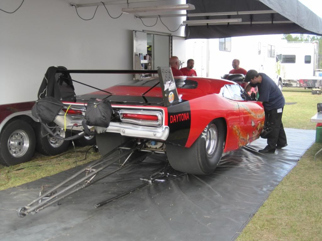

Hey Rom, I thought you might like to see this Daytona that's running Pro Mod at the Gatornationals this weekend.IMG_5821.jpg

Here's another Pro Mod Daytona, driver is Graham Ellis.
