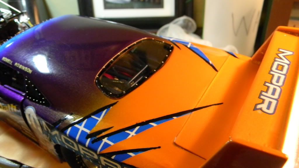

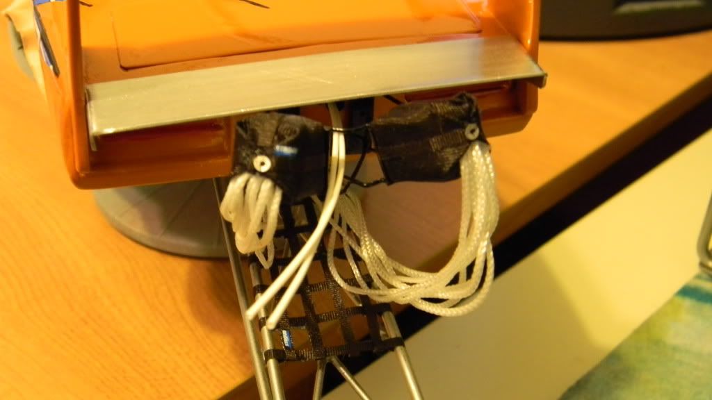

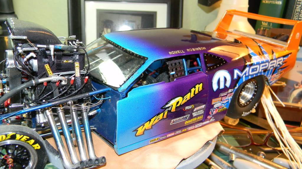

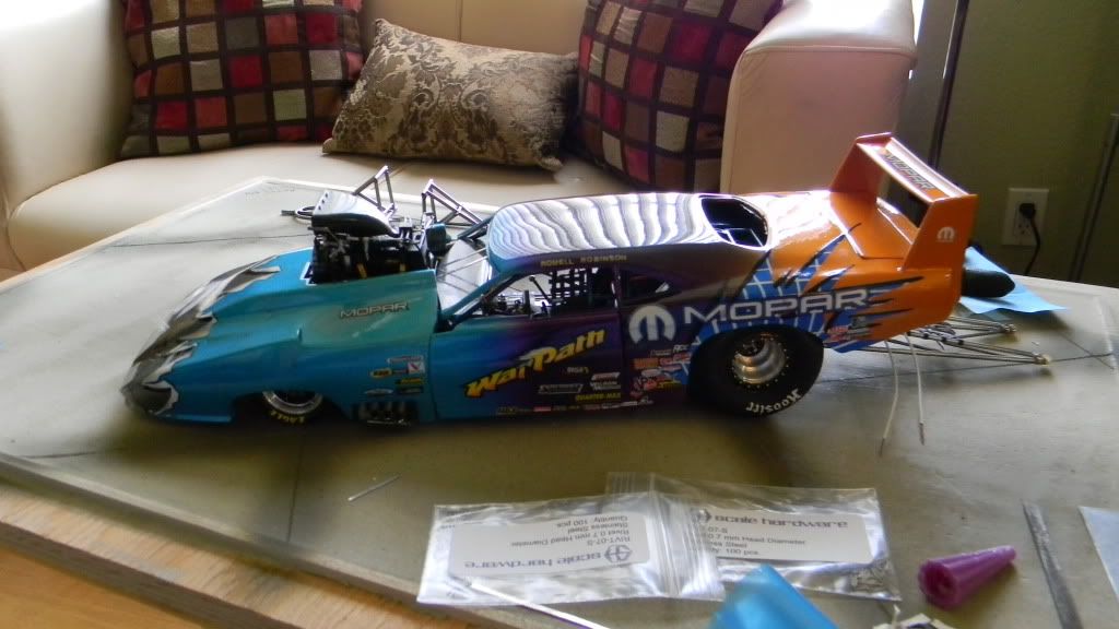

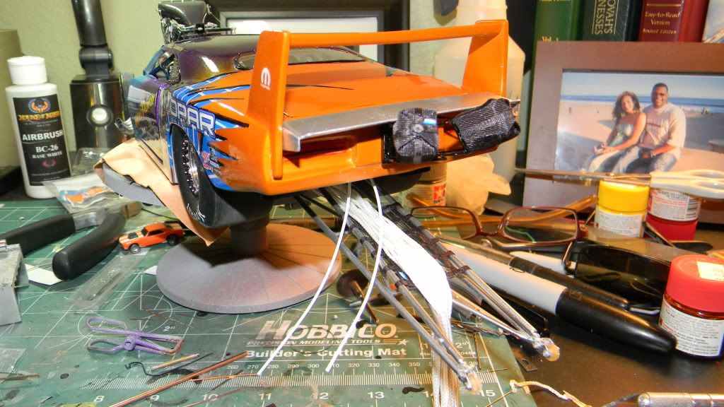

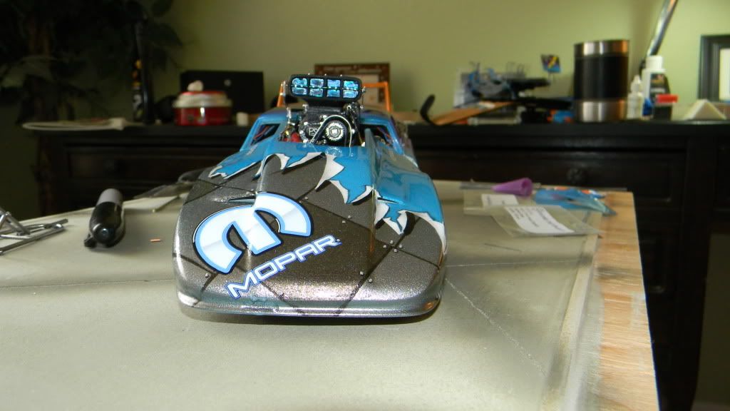

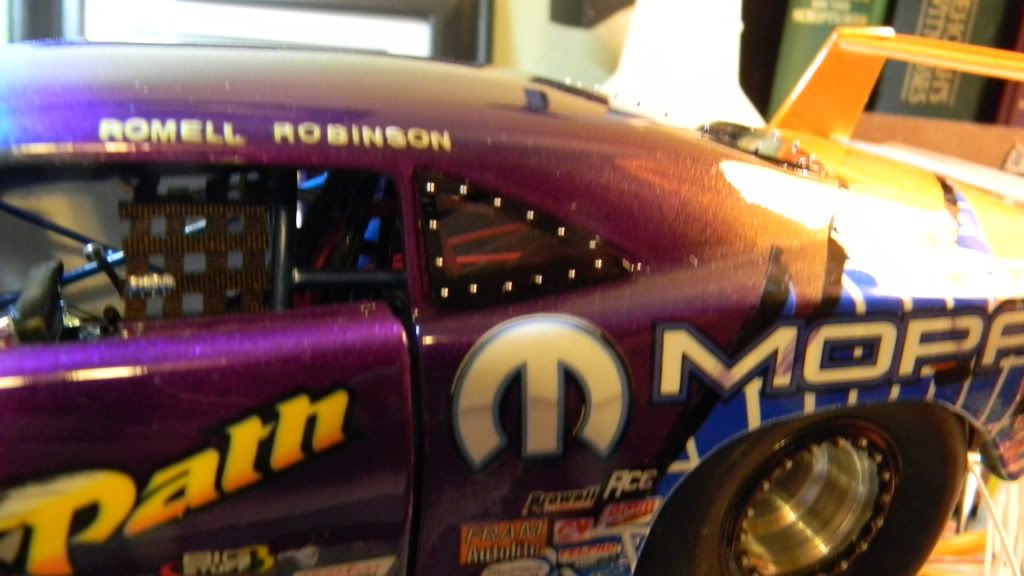

I installed the windows and chutes and cords. the body is on permanantly now and all thats left is to attach the windows to the door frames and install, which i'll be working on tomarrow. Heres what I have for tonight.
front windshield its a bit smuged but its nothing a lil windex cant take care of.....
side rear....
rear window.....
Chutes installed with cords...
almost home........ B)

Rom... what more can I say about this build, it is just down right beautiful. I am super stoked for you that you are just about done with this build. I am also a little sad because I am going to miss seeing progress updates but I am excited to be able to drool over this in person. I am looking forward to seeing what your next Pro Mod or Drag Racing build will be ;) . I did want to ask what did you use to glue the bolts to the windshield??
My next project is a 69 camaro Promod (with the works of course). The bolts are actually rivets with a 4mm stem on them (you can get them from scale hardware), I drilled the windshield, then inserted the rivet into the hole then I used tamiya clear like glue on the back side. Once the clear was dried I cliped of the stem on the back side of the windshield.
