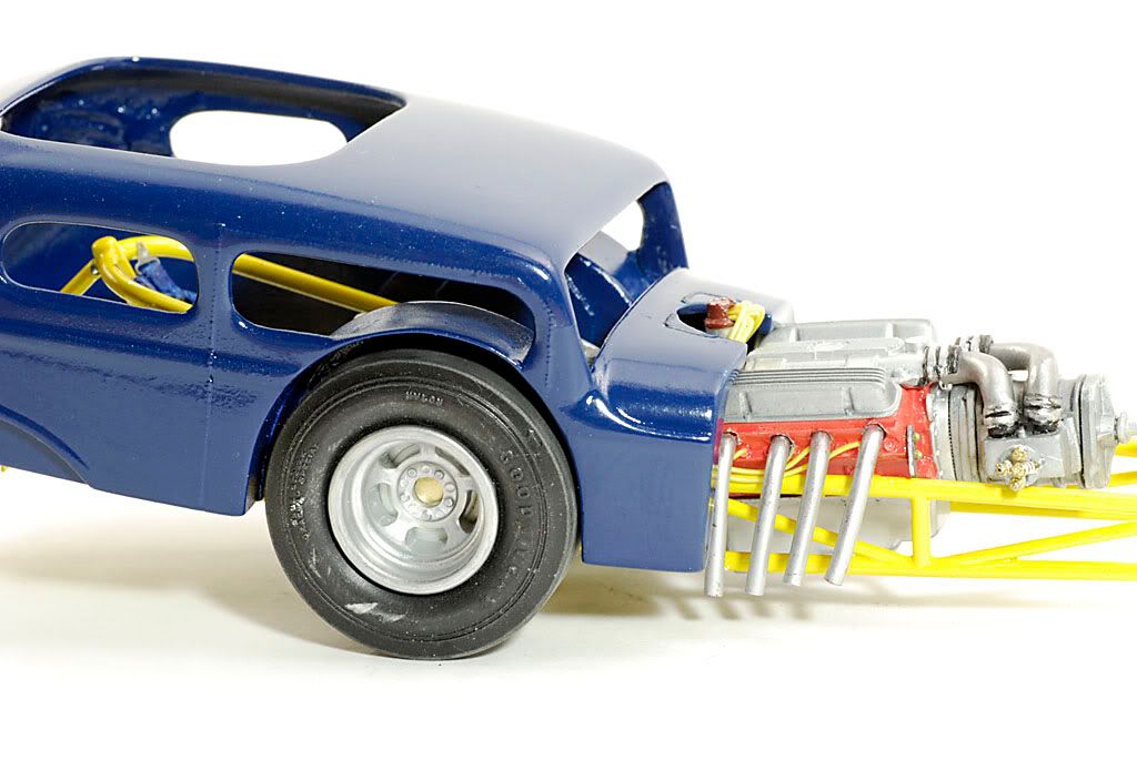

Bernard Kron Posted October 9, 2011 Posted October 9, 2011 I've been using the louvers from Archer's for quite some time now. I use the O scale (1/48) item # 37 to equate to approx. 3" louvers in 1/24 or 1/25 scales. I like them a lot and have used them on several builds. Here is a link to my product review last year: http://www.modelcars...rs&fromsearch=1 . The review spells out some of the limitations and benefits of this approach. My most recent use has been on a replica of The Challenger's A-V8 from Deuce of Spades. The w.i.p. on that build (see http://www.modelcars...showtopic=39392 ) spells out some additional details on how to get the best results from them. Here are some pics: Another great use of Archer products was on Curt Raitz's incredible Bugatti Type 32 "Tank" which made liberal use of Archer Rivets to great effect. Here's link to the Under Glass post ( http://www.modelcarsmag.com/forums/index.php?showtopic=25634&hl=bugatti&fromsearch=1 )and here are some pics:
