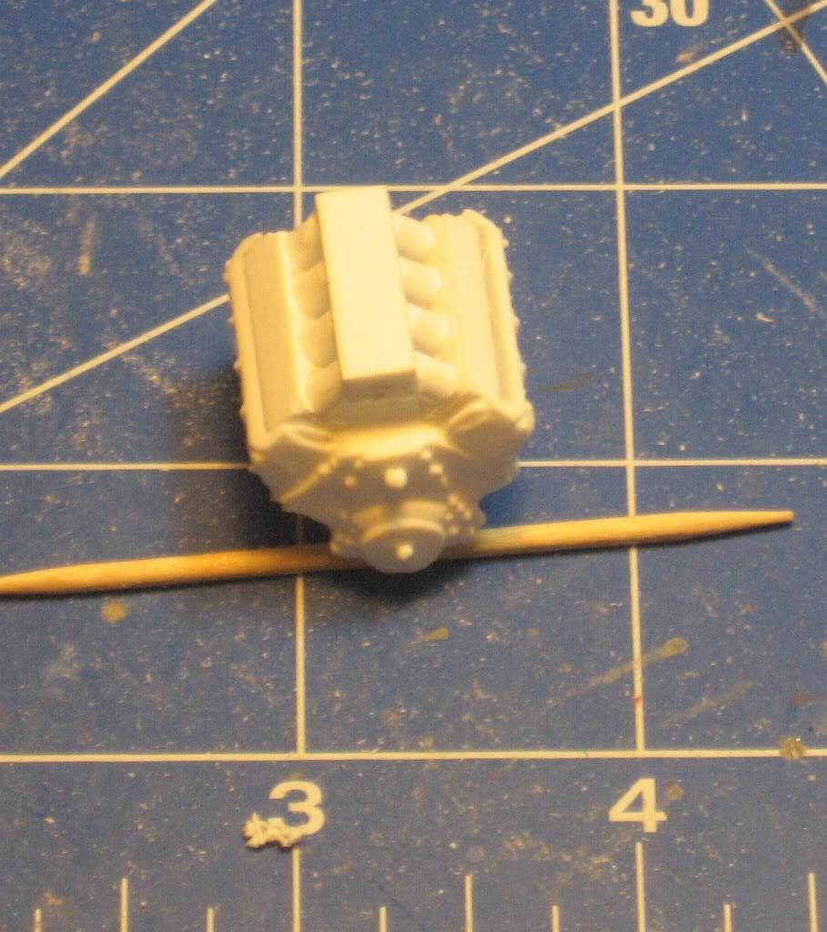

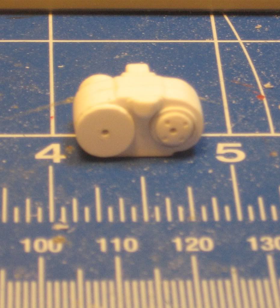

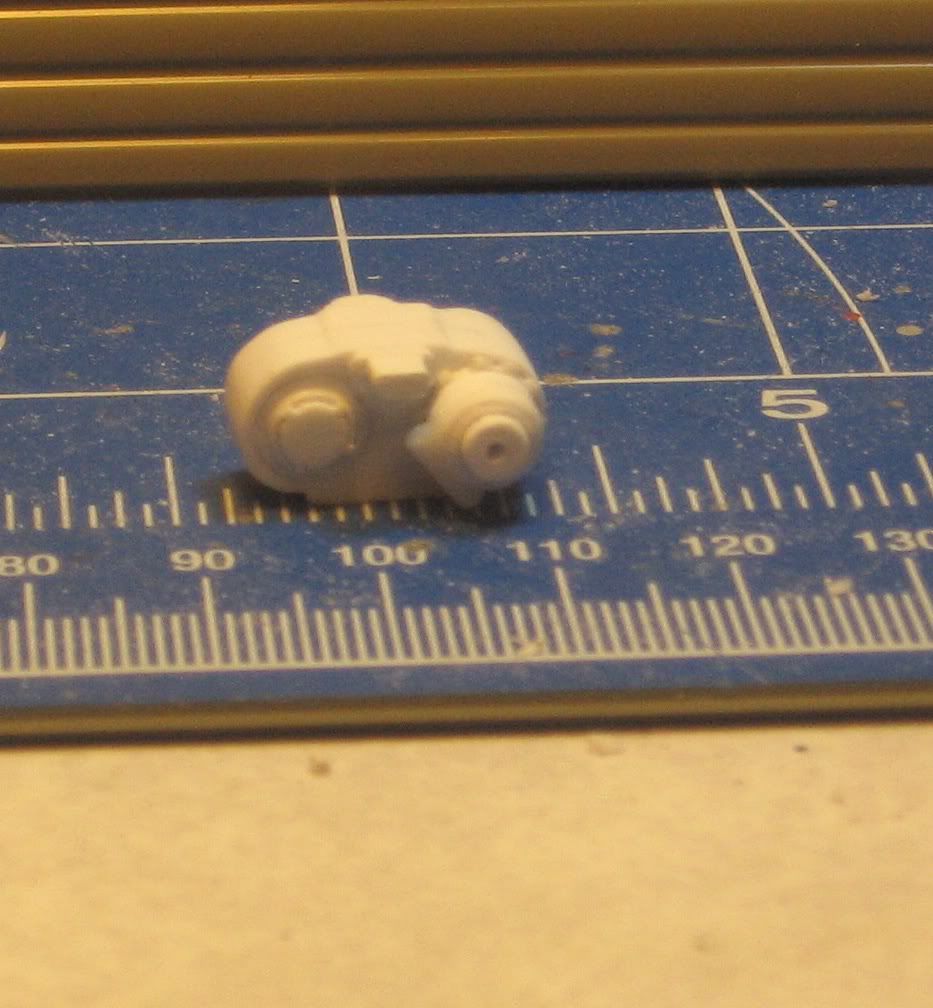

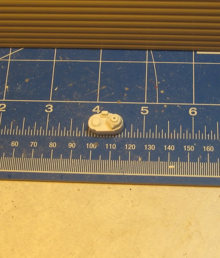

steve7119 Posted February 6, 2012 Posted February 6, 2012 I guess my philosophy would be that any part that isn't a kit part or resin part would involve some degree of scratchbuilding. Either modifying a kit part or starting with nothing would qualify. I have to thank the builders on this forum for pushing me to try new things. I have done some modification of kit parts and made some parts of my own in the past either to replace a part that got lost or broken or to make something work the way I wanted. They were crude but functional for the most part. After seeing some of the work here, it prompted me to carry my own work further! Case in point. with the "48 jeep pick up, I found that there wasn't a transmission available to replicate what I wanted to do with the LS engine and the LS intake wasn't what I wanted. in addition, the transfer case I wanted wasn't available in kit or resin either. So I set about making what I needed. With the transfer case, i laminated sheet plastic for the main case and set on it with files, and knives until I got the shape right. Then broke down the other parts into basic shapes that I could cut, file and sand into the correct form. Took a couple tries while I found out what didn't work so well, but overall I am plased with the finished product. No photos of the transmission yet, but the main case is almost done and I have started on the tailstock housing. Here is the intake so far, I wanted a mainfold that looked like an old tri-power but with fuel injection instead. Again it took a couple tries, but I came out with what I wanted. Now just need to make the throttle bodies, injectors and fuel rails. Thanks agian to the builders on this forum for the inspiration!! Steve
steve7119 Posted February 6, 2012 Posted February 6, 2012 I tried to edit the previous post and ran into an issue. Sorry fot he fuzzy photos of the transfer case. I do have better ones and I have made some improvements to the final product since i took them.

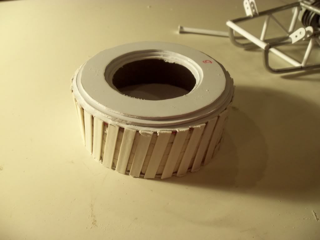

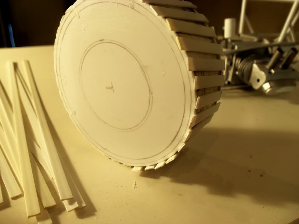

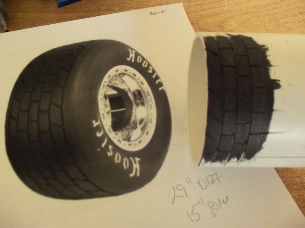

Old Sprinter Posted February 6, 2012 Posted February 6, 2012 Because I scratch build evrything, tires have been my biggest headache, especially dirt tires for my race cars. I use PVC water pipe and lay strips of styrene around it. The I cut the cross grooves with a Dremel tool but usually they get too deep. Today I tried something that I'm sure I can make look like the real thing. I laid out a pattern on cardboard strips and glued them to the pipe. Then I cut out the cross grooves with an X knife. This little test piece took only about 15 minutes to complete.I'm sure that I can now make most any pattern of dirt tires. The PVC comes in sizes that are the right size for the 1/8 scale cars I do. I know there are a bunch of ways and maybe better but I'm using this method on my Dirt Late Model and I thought I'd share.
Dr. Cranky Posted February 6, 2012 Author Posted February 6, 2012 (edited) Okay, Ken, you win the prize for a scratch-built item Doctor Cranky has never seen done before! Wow, really, wheels out of PVC pipe? That's amazing. Do you have any of them finished that we can look at or this is your first attempt? Edited February 6, 2012 by Dr. Cranky
Old Sprinter Posted February 6, 2012 Posted February 6, 2012 Thanks; here's some I have done earlier for a midget I was building. This was using styrene strips and cutting the cross grooves with a dremel tool. I laminate styrene sheets on the sides to give it the bulge. These turned out OK but this new way will be much better. I will be building some tires using this method sometime this week.
