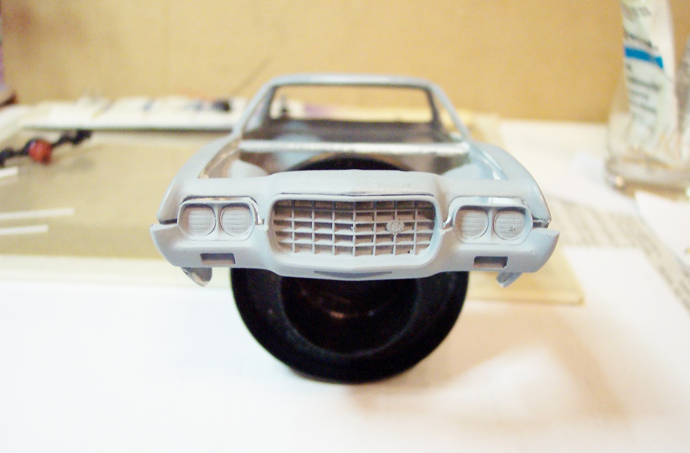

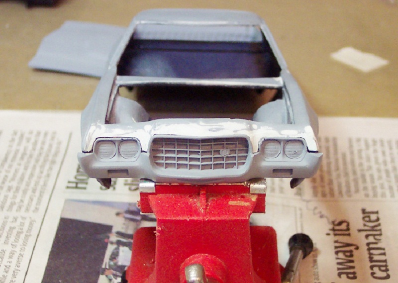

TooOld Posted July 17, 2012 Author Posted July 17, 2012 (edited) No paint yet , but I have managed to get some stuff accomplished . The chassis is finished and so are the wheels and tires . Mainly I've been doing body work . The interior and the windows have been fit to the body , so has the rear bumper and taillights . The hood and front bumper / grille really didn't fit very well at all , so most of my time has been spent working on them . I've added strips to the edges of the hood so it fits the opening better , it still needs some work so it fits flush with the body . The bumper / grille is getting there , alot of filling and sanding on the body to get it this close ! The rest of the body is really straight , just a couple of minor imperfections . This is my first try at a resin body and I'm pretty pleased with it so far . I hope you like what I've got so far , and your comments and suggestions are welcome . BOB . Â Edited March 2, 2020 by TooOld

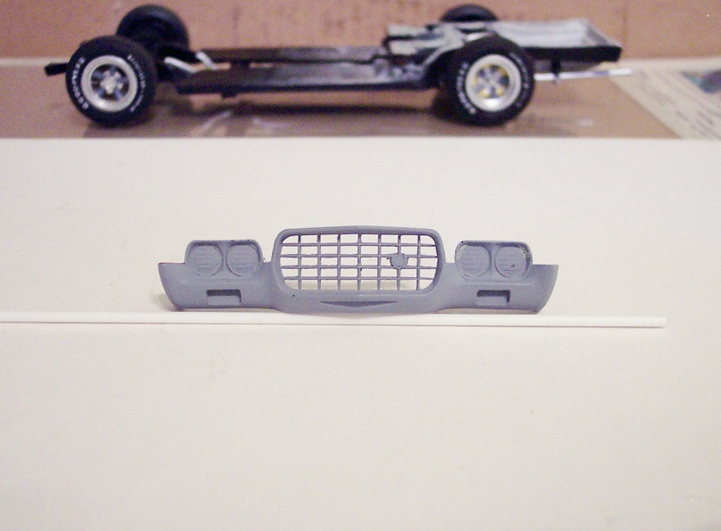

TooOld Posted July 18, 2012 Author Posted July 18, 2012 (edited) Thanks Ray . I spent about an hour last night carefully sanding the back of the grille to open it up . This resin is flexible and when it gets thin , like around the grille , it bends when you don't want it to ! It still needs to be cleaned up a bit . I need some suggestions on what to do with the headlights . I would like to use clear lenses , but am afraid of ruining it by trying to drill out the resin . Any ideas ? Thanks for looking . BOB. Edited March 2, 2020 by TooOld
Casey Posted July 18, 2012 Posted July 18, 2012 I need some suggestions on what to do with the headlights . I would like to use clear lenses , but am afraid of ruining it by trying to drill out the resin . Any ideas? Drill 'em out. Molded in headlights never look good IMHO. Start with a 1/8" bit and enlarge the holes with a round needle file. It'll be a lot of work with four headlights to do, but the results will be worth it.
Bartster Posted July 19, 2012 Posted July 19, 2012 That's exactly the way l did away with the headlights on a '63 Fury grille recently. lt worked out great! Bart.
TooOld Posted July 22, 2012 Author Posted July 22, 2012 (edited) Thanks Casey and Bart . I drilled them out with no problems and am going to use the lenses from the Chevelle wagon kit . The body got it's final coat of primer this morning and will sit for a couple of days before I prep it for paint . In the mean time I finished the interior last night . I've never spent much time on interiors because they just can't be seen unless it's a convertible . This resin interior is lacking any detail so I added a few things . I made arm rests and window cranks , used embossing powder for the carpet , and added floor mats and seatbelts . The shifter is from the Mach I kit . It's not the cleanest looking , but like I said , it will never be seen anyway . Any comments and suggestions will be appreciated . Edited March 2, 2020 by TooOld
