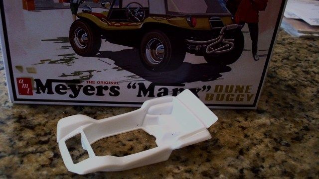

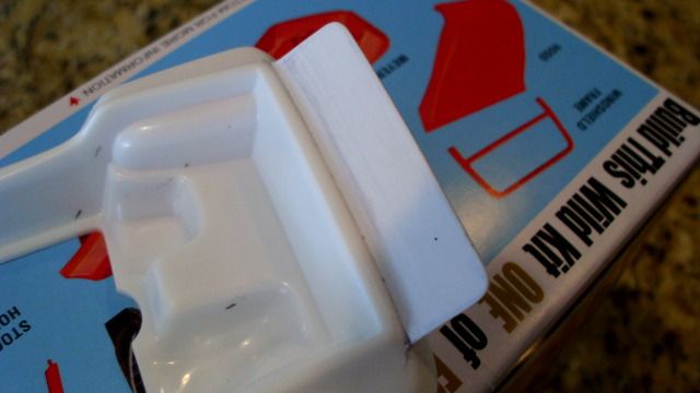

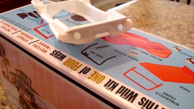

cobraman Posted July 17, 2012 Posted July 17, 2012 (edited) My next build will be this Meyers Manx kit. I want to do it as a street buggy. So far I cut a slit in the back for a rear spoiler/small wing ? It will not end up sticking up as much as the photos show. I also drilled holes in the rear of the body for different taillights. I cut off and smoothed the posts in front where the headlights would normally mount. I just don't care much for the "Bug Eyed" look with the stock headlights. Edited July 27, 2012 by cobraman

cobraman Posted July 18, 2012 Author Posted July 18, 2012 Having a bit of trouble figuring out what or how to do the headlights. Maybe I shouldn't have removed the posts. : ) I will figure out something. Nothing good in my parts box.
91blaze Posted July 18, 2012 Posted July 18, 2012 Don't give up on the headlights. Maybe you can make molded in headlights like the Manx on this page. http://www.meyersmanx.com/kick-out-manx-ss.shtml
cobraman Posted July 18, 2012 Author Posted July 18, 2012 Thats an idea. Those look pretty cool. I wonder if I could pull that off. (?)
crazyjim Posted July 19, 2012 Posted July 19, 2012 Those headlights look EXCELLENT, Ray. Go for it. Please report in detail how you pulled it off. I like those vented side pods on the website 91blaze suggested. You have to construct those too! Wish I could tell you how - I have no idea. No wonder my buggy kit is still sitting unopened.
91blaze Posted July 19, 2012 Posted July 19, 2012 There are probably better ways to do it, but this is how I would make the headlights. First use putty (I use milliput) to make the hump for the headlight and smooth it out real nice. Then drill out the holes for the headlights. Should be pretty easy to do, just give it a shot.
cobraman Posted July 19, 2012 Author Posted July 19, 2012 I was thinking maybe plastic tube the right size could be cut and molded into the body. Maybe ?
91blaze Posted July 19, 2012 Posted July 19, 2012 (edited) That could work too and probably be a little better looking. Edited July 19, 2012 by 91blaze
Jantrix Posted July 19, 2012 Posted July 19, 2012 How about some headlights from the Revell '39 Chevys?
1930fordpickup Posted July 19, 2012 Posted July 19, 2012 (edited) I was thinking maybe plastic tube the right size could be cut and molded into the body. Maybe ? Find a piece of tube the right size diameter . Then figure the length that you will need for one side .Mark the tube on an angle to cut your first piece off , When that piece is cut the angle for the second piece is already cut , so just cut that piece to length. The angle will be what you sand to fit the hood leaving just the right amount of straight diameter for the light . Just a thought . Edited July 19, 2012 by 1930fordpickup

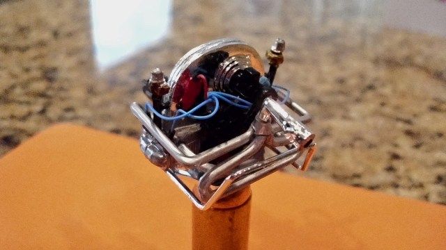

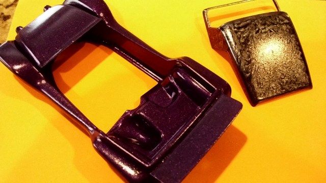

cobraman Posted July 23, 2012 Author Posted July 23, 2012 Got more done on the buggy. I was all gung-ho on this build when I started but for some reason loss my drive about half way through the engine. Not sure why. Anyway forging ahead I have the body painted but still needs to be cleared. The wheels and tires are assembled. I sanded off the molded in gauges on the dash and then cut a new panel from sheet plastic and drilled the holes and put gauge decals on the back side. The roof was painted gloss black and then I used HOK Marblizer over that. That also still needs to be cleared. The engine is finished for the most part. I wired it up although I must admit the wiring job is a bit messy. I guess this won't be my perfect model either. Better luck next time. : ) Comments welcome as always good or bad.
