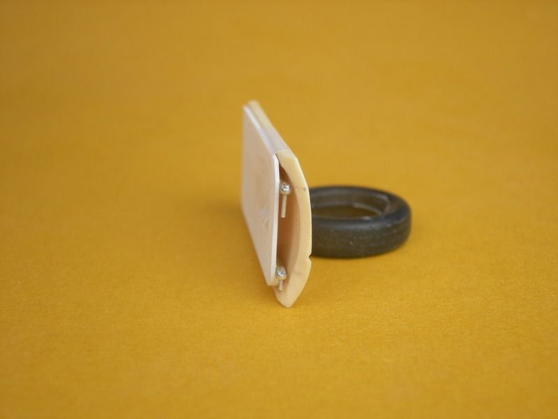

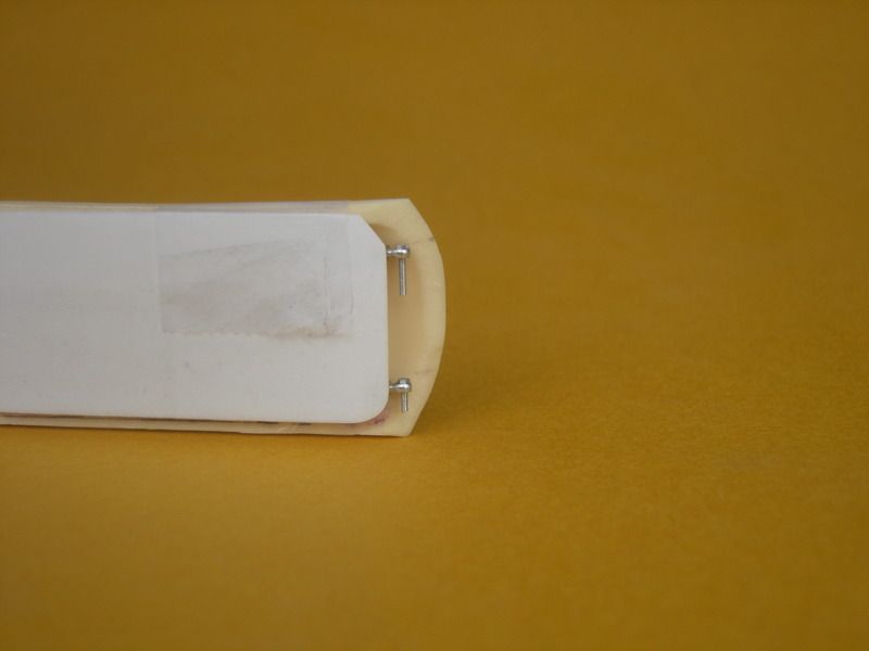

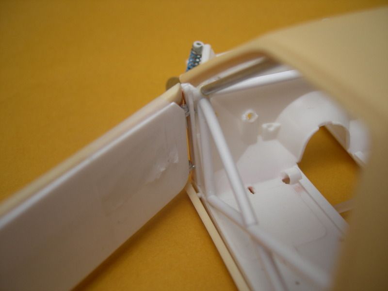

Some WIP pics of how I'm going about hanging the doors.  I cut some 1/16th inch brass tubing and attached it to the interior door panel.  The interior panel is patterned off a 1:1 panel so is to scale.  I am using RB Motion #1504 rod ends, which telescope inside the tubing.  I used a pliers and deformed the shank end of the rod ends so they interference fit the tubing.  I made sure the upper and lower tubes were parallel.  This setup allows me fore-aft adjustment within the fender-body opening and also allows me to adjust the gap at the rocker panel to some degree.
This view shows the leading edge of the door and interior panel with the rod ends CA's in place.

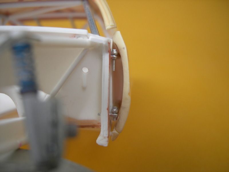

Here you can see the door hung on the bulkhead-mounted rod ends.  The top one is CA'd in solid.  The bottom one is still floating at this point, but probably not for too much longer.  Using the rod ends and tubing allows the door to be adjusted in and out at the top and bottom as well as what I mentioned above.  I'm hoping/trusting that by having the body pinned to the chassis I can get door lines fitted pretty closely and I won't run into a bunch of misalignment issues later.

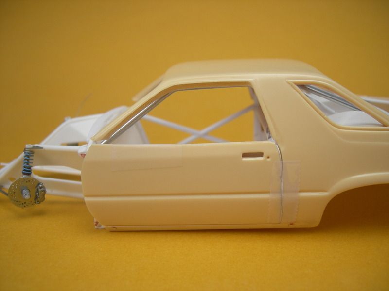

Plain old 9 o'clock level shot of the door hung and in the body.  It has a tendency to swing open, so is taped for the time being.  I know some of you guys have used micro magnets to keep doors closed.  What is the smallest those are available?  Anybody know off-hand?

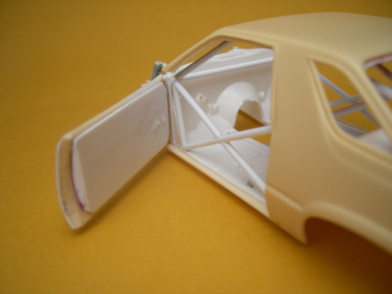

A couple of shots of the door swung open.
This one closeup shot shows the hinges more clearly.

Scott, excellent hinging on the doors so far! Still nervous about those A pillars though, but I see your point. ;)
As far as magnets for latching, you might want to check out here. I've used the smallest size they have, and they work quite well, and won't be intrusive looking for what you're trying to do.

Bill - I really appreciate your providing the info about those micro magnets.  Those look like just the ticket for what I had in mind.

Scott... Nice work on those door hinges. Man it sure looks killer. This build is coming out great. I have some of those magnets that Bill mentioned that I got from my local hobby store. I have them in 1/16" Dia and 1/8" Dia. If you want pics of them I will take some for you since I think they are a different brand that what Bill showed But the same thing. Keep up the great work and I look forward to your next update.
Thanks Chris.  I appreciate your offer and encouragement.  What hobby store did you get yours from?  Depending on where you sourced yours, I may be able to find something here local.  A pic would be appreciated! :)

Great idea for the hinges and the unit looks very good.  Also really good though, it appears the door can be easily removed as well for further building chores, this is a really important aspect for scratch-building and eventual maintenance or correction necessities.

Thank you very much, Michael.  Using the rod ends and tubing that can be telescoped certainly offers flexibility in fitting the door to the opening and the way mine is configured, it does, as you say, offer the capability to remove the doors, which is a cinch when the front end is off.
