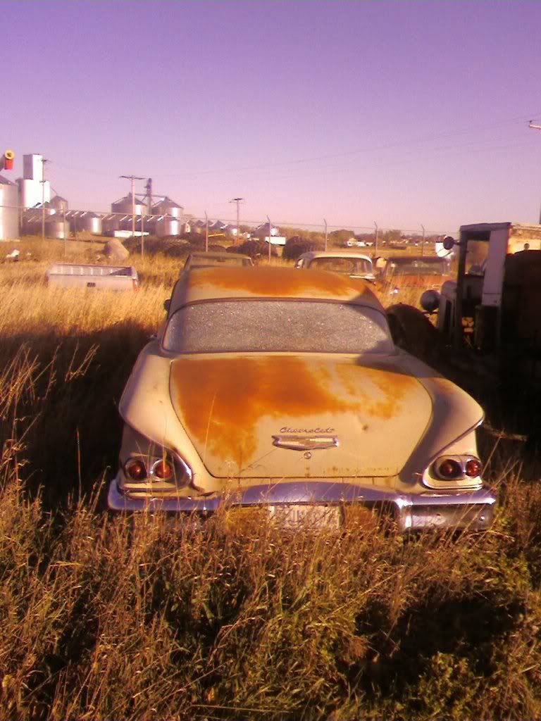

Nice find or should I say save. What are the plans for it? Post some photos when you get it pulled outa there and start tearing into it.
I've loved 58's since my dad had one when I was a little kid. Never had one myself. Good luck with your plans to to fix her up. Show us some pictures of your progress. :)
That is a beautiful car. Great to see another one saved. This is great body for Old School Style Custom or Race Car look. :D

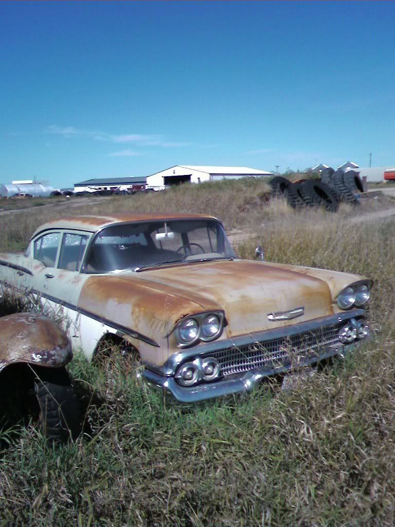

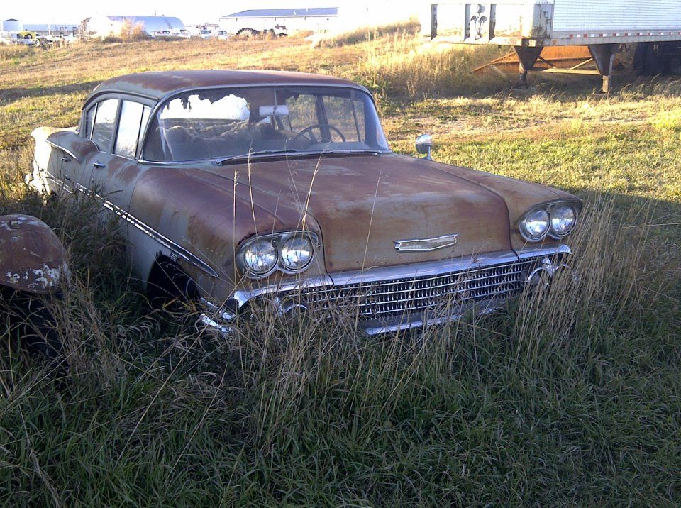

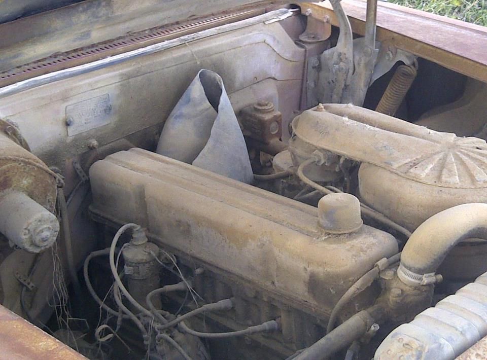

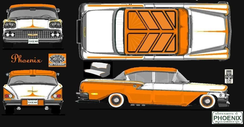

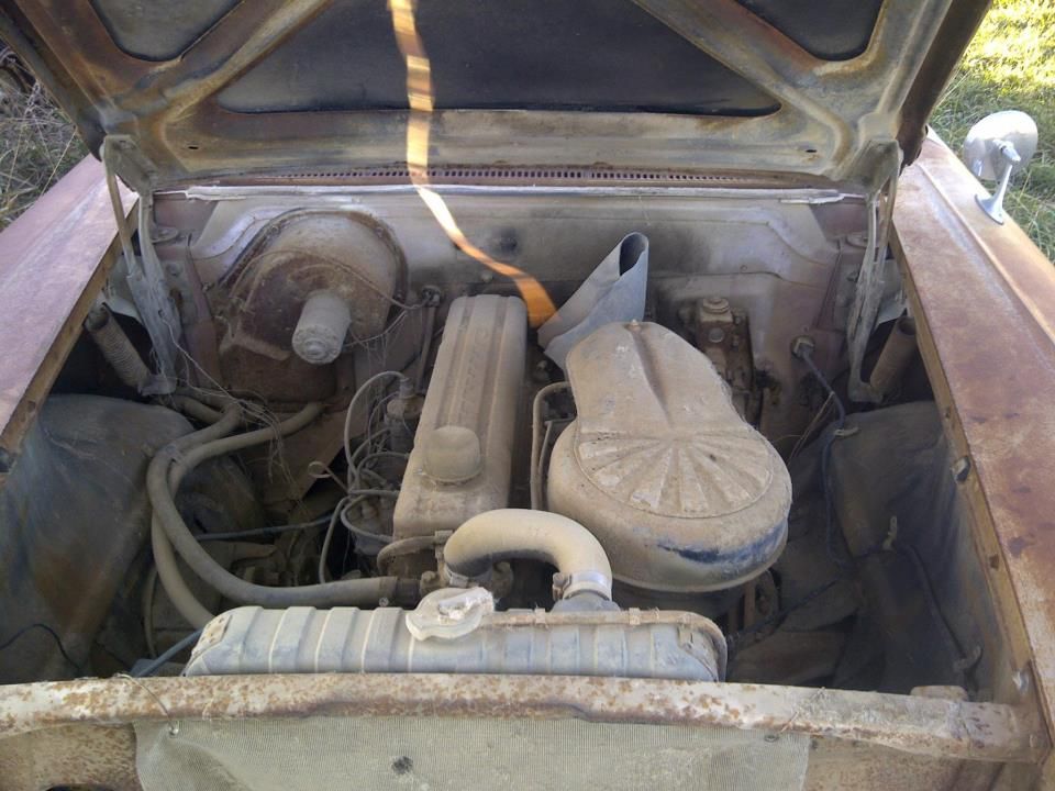

Well, my fellow forum members, the plans are KISS but it will still have the needed kustom touches to make it a late 50s early 60s kustom. First things first is to see if I can get the blue flame to fire, not sure if it is stuck, but it did run when parked in '79. If the pistons are stuck I am going to use ATF in the boores since my uncle just did that on an old ford 6 recently. Then all mechanicals will be replaced or restored initially and replace the back window and maybe a blanket over the seats and run it like that for a while. But that is where it takes it's turn into the kustom field. The car is as follows 235 Blueflame; 3 speed with 3:55s; radio delete; dog dish caps; coral and white paint and the floors and rockers look good. Not sure on the trunk yet. SO plans are building a 261 I6 with twin super 97s; kustom built 2x2 intake and headers; finned accessories; B52 Jet Pipes exhaust tips.

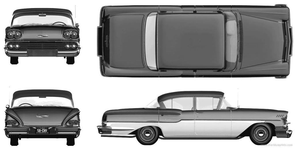

This is a stock 58 Delray:

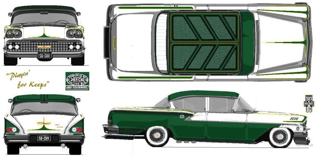

This was the original design in Kandy Jade Green and Ivory White and called it "Playin' for Keeps". These next to were done on MS Paint:
It then evolved into the "Phenix" which is Kandy Tangerine Orange and Ivory White:

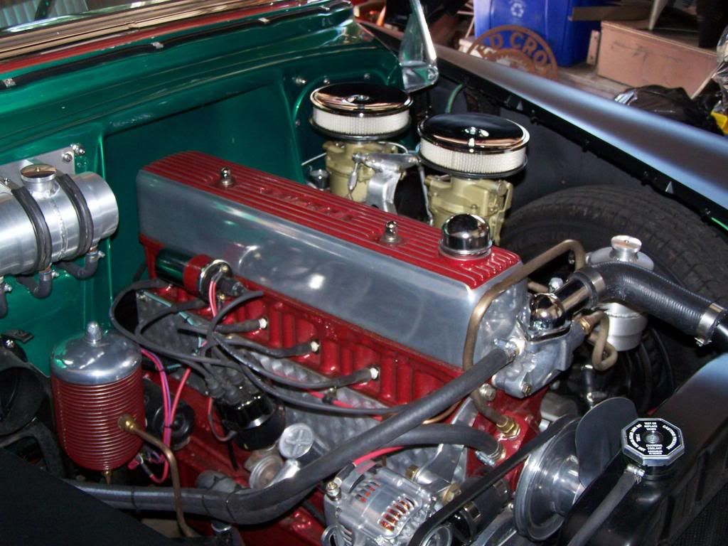

Engine will be similar to this but with the Tangerine accents and Hudson Hornet Twin H Air Cleaners:

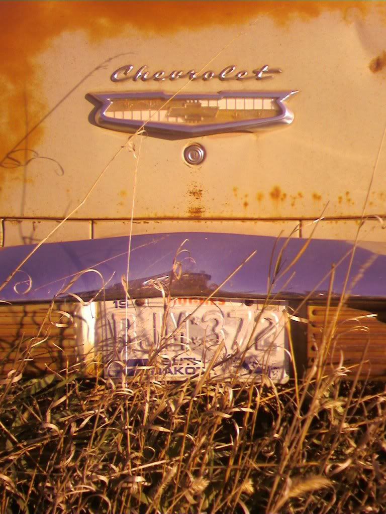

Only real damage other then surface rust and a rust hole in the headlight brow:
Oh trust me, I have. I got this whole car built on paper. Every part. The wheels will be painted caddy wires with chrome spokes and kustom caps.

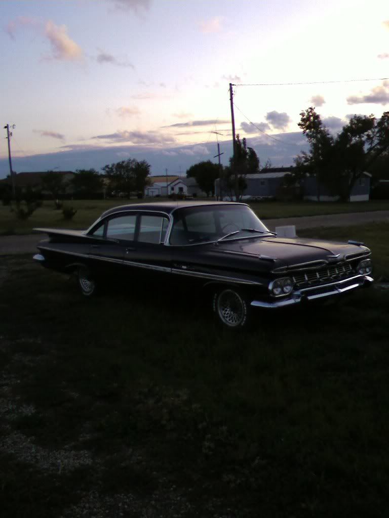

0913081926.jpg Link to the rest of the pics on this car:
http://s275.photobucket.com/albums/jj291/ARTEMIS1759/1959%20Chevrolet%20Bel%20Air%204%20door/
Edited by ARTEMIS1759
The Del Ray looks like a great project. having seen what you did with your dad's '59, I have no doubts that the '58 will turn out at least as well. As it is, you just showed me pics of two of my favorite years of full-size Chevy. Love 'em both!
