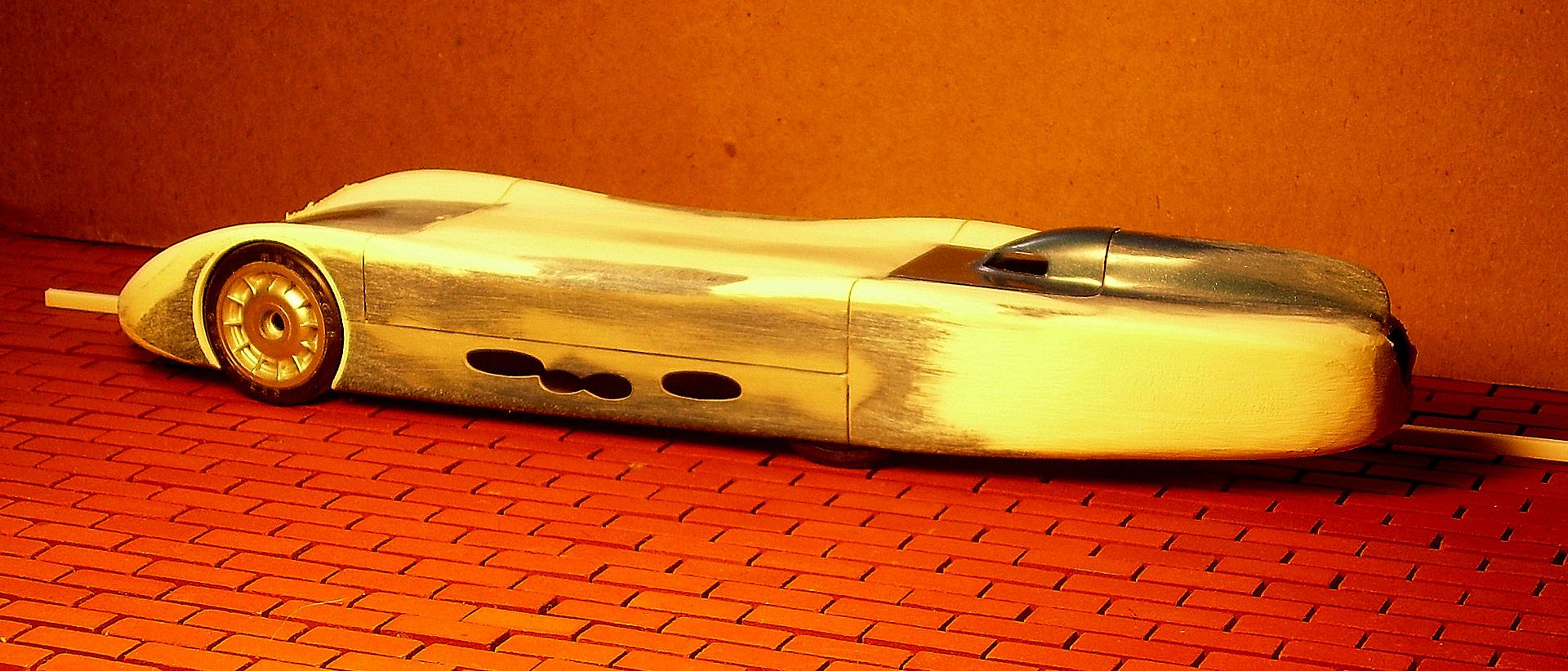

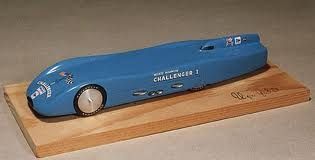

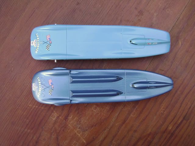

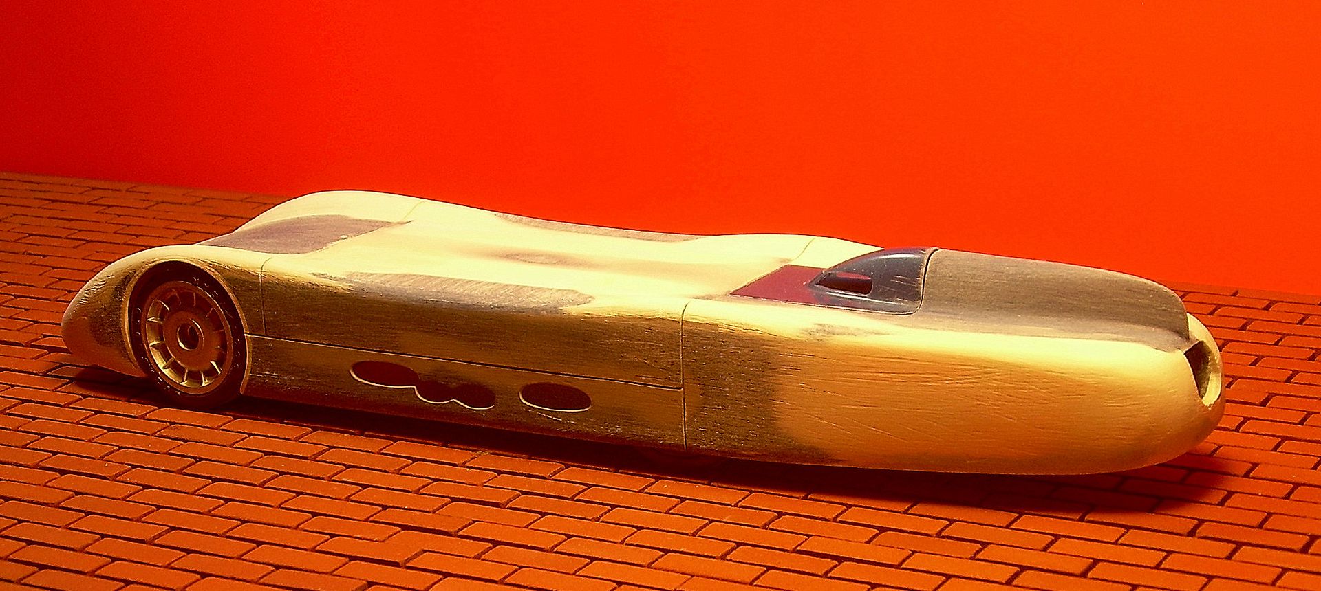

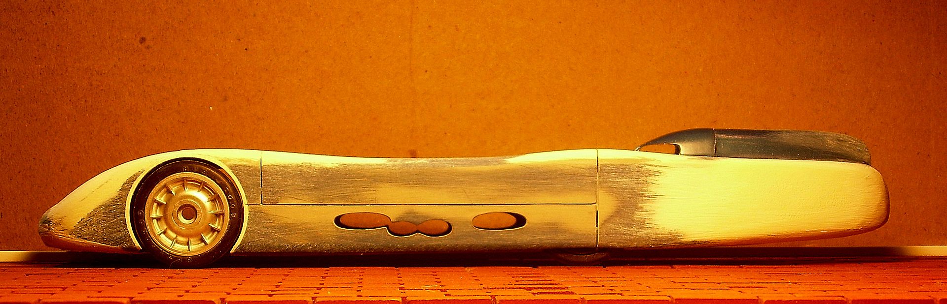

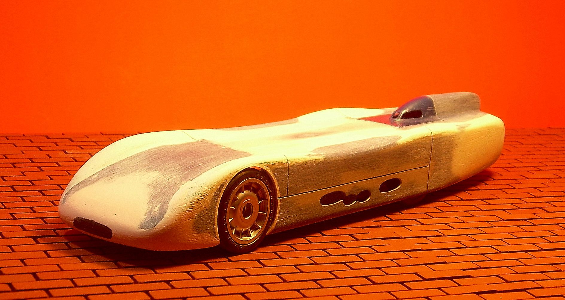

Ace-Garageguy Posted October 20, 2013 Author Posted October 20, 2013 (edited) My sincere thanks for everyone's interest and comments !! For some reason, this one's really got me motivated to at least get it to the 'bare metal' stage, so between moving the house and shop (and re-habbing a badly vandalized house), I've been trying to snatch a few minutes here and there to sneak up on the correct profile. This shot shows a little of how different the plan view of the early tail is compared to the supercharged version. T And this gives a little idea of how the nose plan views differ...early car on the right. This is the profile as she sits today, with a total of .040" of styrene added to the insides of the front wheel openings, which has allowed me to lower the fender tops and make that pretty curve...(which still isn't quite right). The tail of the car will be lower still in the rear, and more squared. The underside of the later car rises much more behind the rear wheels. This front 3/4 shot begins to capture the subtle voluptuousness of the original design... ...but I think this may be my favorite angle. Edited October 20, 2013 by Ace-Garageguy

Ace-Garageguy Posted October 20, 2013 Author Posted October 20, 2013 This looks better every picture Bill. I was just thinking if you only changed one side you could have both cars in one build . Thanks. And I would like to show both versions of the car together, to better illustrate the differences. I don't know if I'll have the patience to build another one though...just doing one side and putting it on a turntable could be my lazy-way-out.
Ace-Garageguy Posted October 21, 2013 Author Posted October 21, 2013 As to the rear section ; have you considered taking a tiny sliver of a pie-cut out of it ? The wider part of the pie piece would be from the top . This would elevate the rear slightly .This might get rid of the models "droopy"look in the rear and perhaps be closer to your reference photo. I'm not sure whether this is even possible without creating some kind of interference with the rearmost frame section(or requiring unrealistic frame alterations). I always appreciate thoughtful suggestions, but I think the majority of the "droopy" look is coming from the angle the car is viewed from in that photo. The lower rear surface of the early body is actually LOWER than the later bodywork, closer to the ground, and more squared off. Compare the latest photos to the reference profile and you'll see that the tail on my model is STILL too high. As for interfering with the frame, the bondo is getting mighty thick and heavy in some areas, but that's okay, as this body is only being used to display once, and then it will be the plug for a set of molds to make a complete set of skins in .020" thick fiberglass. I'm sure some of you guys have seen he almost-scale-thickness parts I've done for other builds, and these skins will utilize the same techniques.

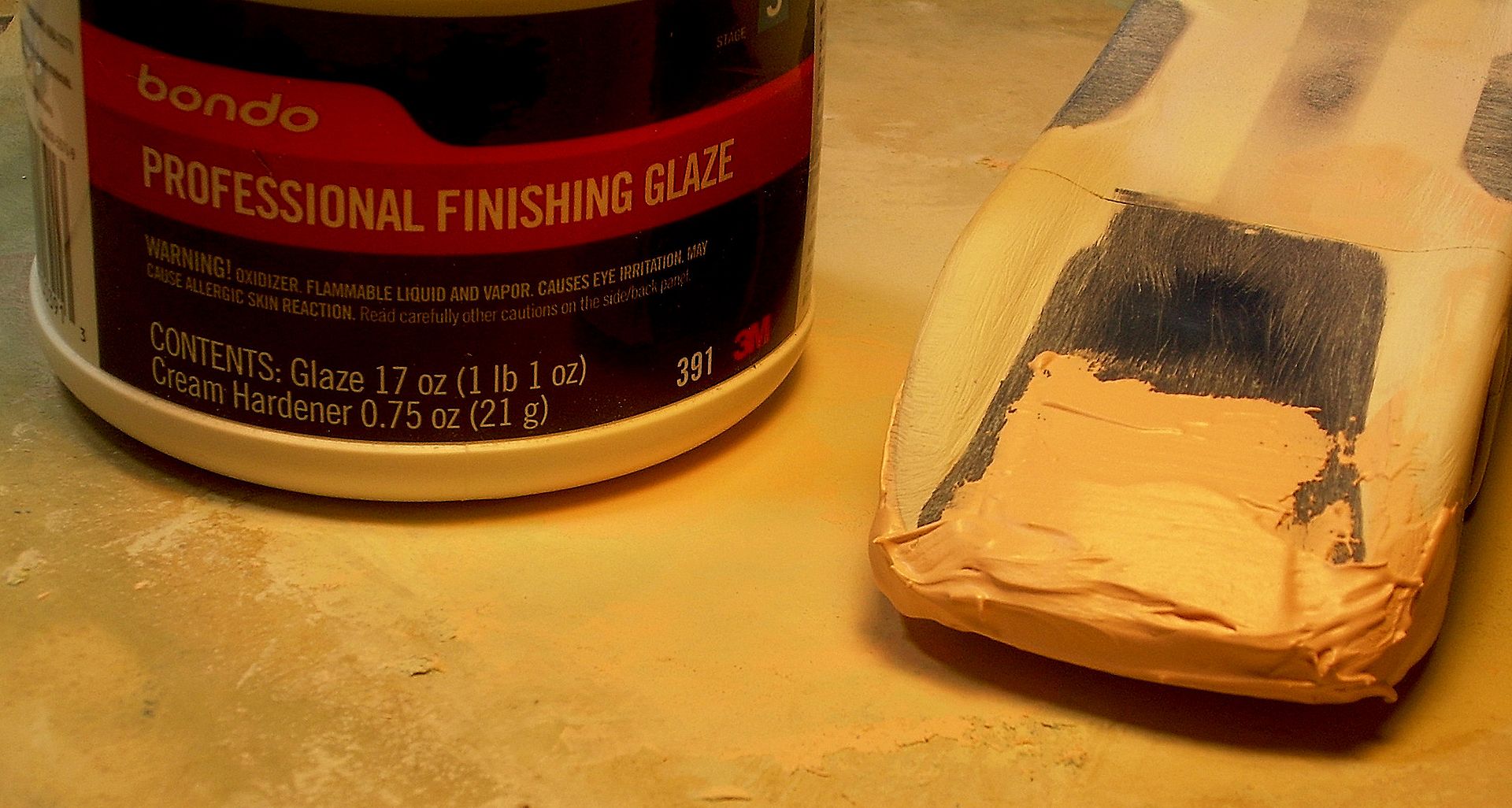

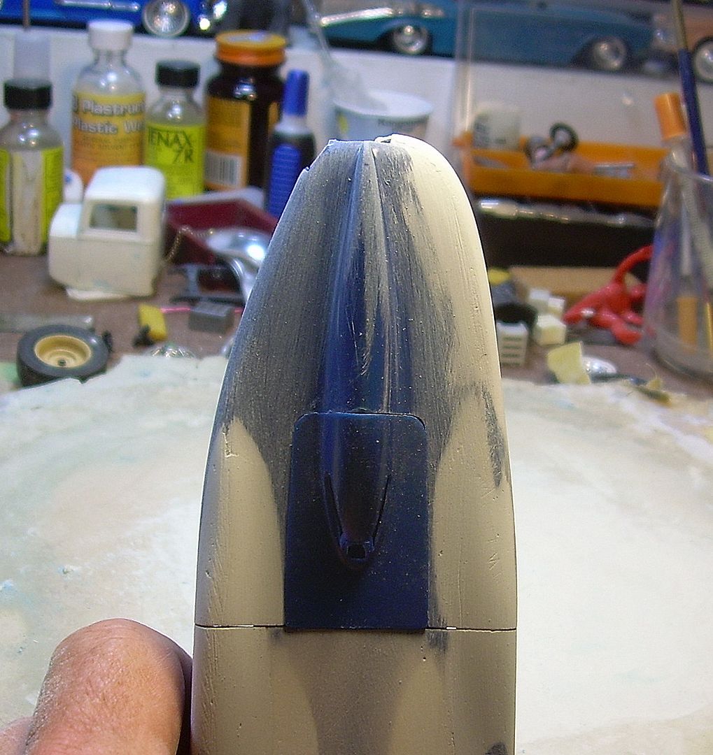

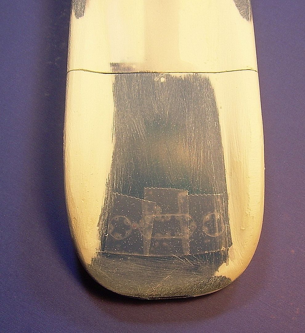

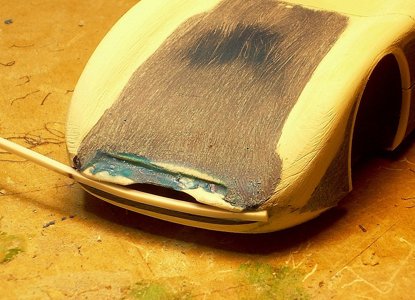

Ace-Garageguy Posted October 30, 2013 Author Posted October 30, 2013 (edited) Thank you all again for the interest and encouragement. I had forgotten my cardinal rule for working on things...FIRST: Pretend you're smarter than what you're working on. So, I had to hack into the nose to shorten and re-shape it, and there wasn't anything to support putty. Hence, some styrene stock got added in... UNPAID PRODUCT ENDORSEMENT : I had run out of my usual glazing-putty favorite USC Icing, I had a motorcycle tank to finish up here, and the guy at NAPA suggested trying a small container of Bondo brand "Professional" two-part glazing putty ($14). I'm in the midst of moving, so I won't be doing any 1:1 bodywork for a while, and I didn't want a regular, expensive tube of Icing sitting around going bad. I used it on the tank, and liked it so much I used it to finish roughing the Challenger model. This stuff is great. It's the finest-grained putty I've ever seen, it mixes easily, spreads like butter, and fills even the most minor scratches beautifully. It even sticks to properly prepared (sanded 180 grit) styrene better than anything I've used so far (darn near all of them). The nose continues to progress, and I found a nice, period reference shot of the car in bare metal to supplement the other pix I've got. Edited October 30, 2013 by Ace-Garageguy

Ace-Garageguy Posted October 31, 2013 Author Posted October 31, 2013 (edited) Just about got it, close enough for primer. [/ Edited October 31, 2013 by Ace-Garageguy
