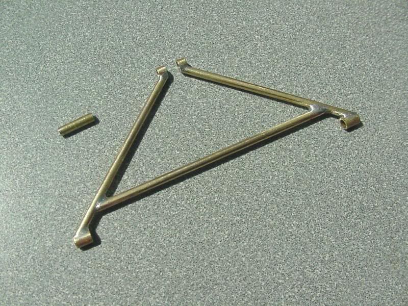

This is the rear end cover. All brass, soldered together.
Here are some of the parts partially assembled.

What's your method for cleaning up the soldered joints, Mark? Please tell me there's a quick and easy method which has escaped me. ^_^
I must admit, after all the bending, filing and sawing on that header over the last two days, my fingers are really sore. Something plastic doesn't cause... It's still worth the effort.

As far as cleaning up the joints, it’s just a little filing or Emory cloth and a brass wire brush. Then a wash under the faucet with some liquid detergent and a toothbrush to remove the caustic leftovers from the paste and rosin.

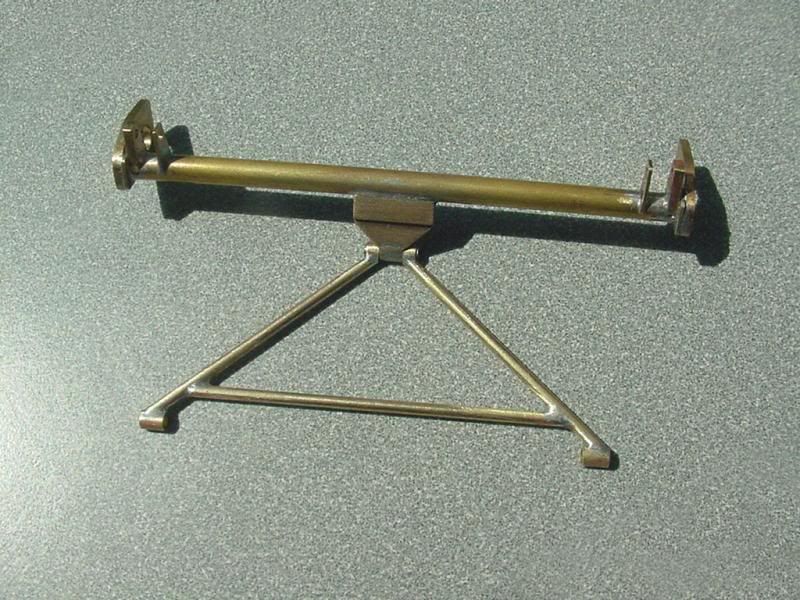

More progress on the differential. Still needs more bracing, plenty of cleanup, and other parts/details…
Funny you ask, held a class yesterday in my shop, (honestly!). Others have asked and I have explained the way i do it. If you have a specific question, I'll be glad to answer it. But I am no Samurai, just someone enjoying the building.

I finished adding the bracing, cleaned it up and textured it. The texture photographs a bit coarser than it looks to me in person. I also machined a few parts for it and dry assembled it.
Mark - What did you texture it with? Looks very nice.
Thanks guys. Just threw some baby powder at it like I used on the transmission parts. The key is finding powder made from fresh babies...
