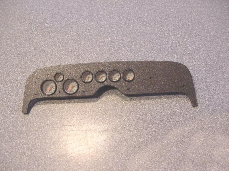

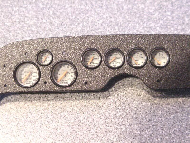

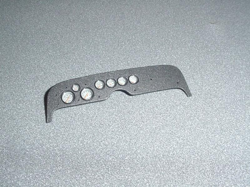

The gauges are assembled and installed into the dash. Each gauge is made up of six pieces plus a decal.
Speedo and Tach are the large ones, a small Vacuum gauge is positioned between them.
The Water temp and Oil press gauges are mechanical units, the Volts and Fuel level are electrical. Looks like the lenses mess with the focus on a couple of them
Trying to get a better shot of the gauge, the camera flash really glitters up the textured matte charcoal dash
Really? That's all? No other magnification, like a magnifier lamp? Wow... it's amazing that you can do such fine detail work without "help." I know I can't! :lol:
Oh, I have lights.
But just regular fluorescent fixtures, plus little incandescent desk type lights for the lathe/mill and other shop machines.
Never got into using a magnifier or light loops.

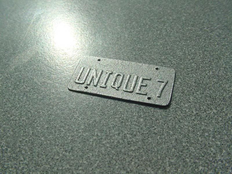

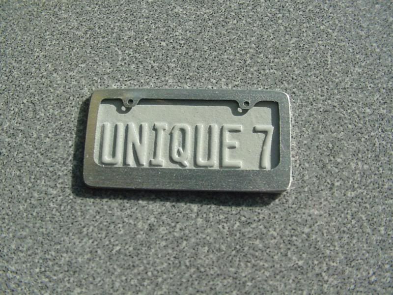

I finally decided on a personalized license plate. Like my last two Sevens, the plate will have raised “stamped” characters. I already put a coat of primer on the face.

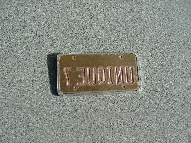

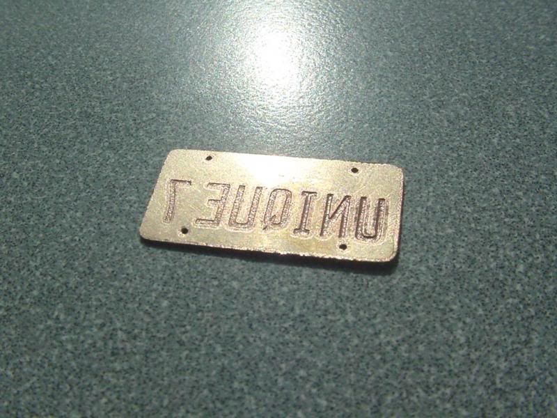

But in addition to raised characters, I decided to make the backside detailed too and made the characters in reverse and depressed. Shown here in the raw brass.
Incredible work so far.... I've been watching this one for a while now but I couldn't stop from commenting now. As soon as I saw the first pic of the license plate, I KNEW you would go and do something crazy and awesome like do the reverse stamp on the back of it.... I'm amazed at the quality and detail of this build. Well done!
Thanks guys! Art, bring a wad of cash to the next meeting and then we can discuss payment options...

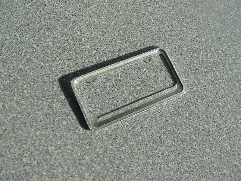

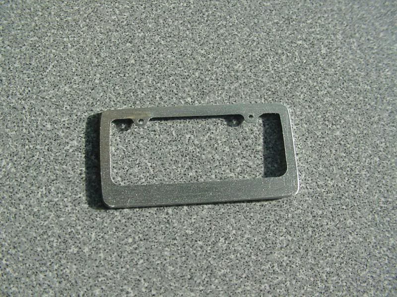

I machined the frame for the license plate from aluminum.
The back side has more work in it…
To allow the plate to fit inside flush, like a real car.

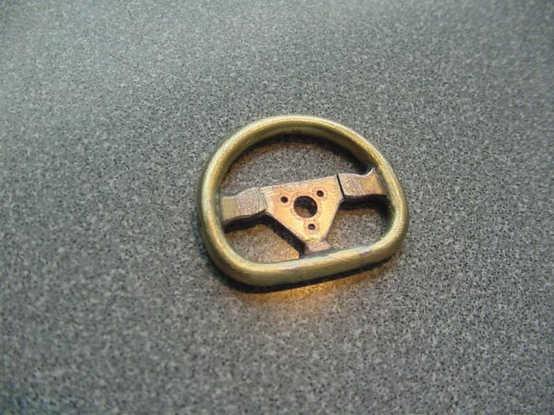

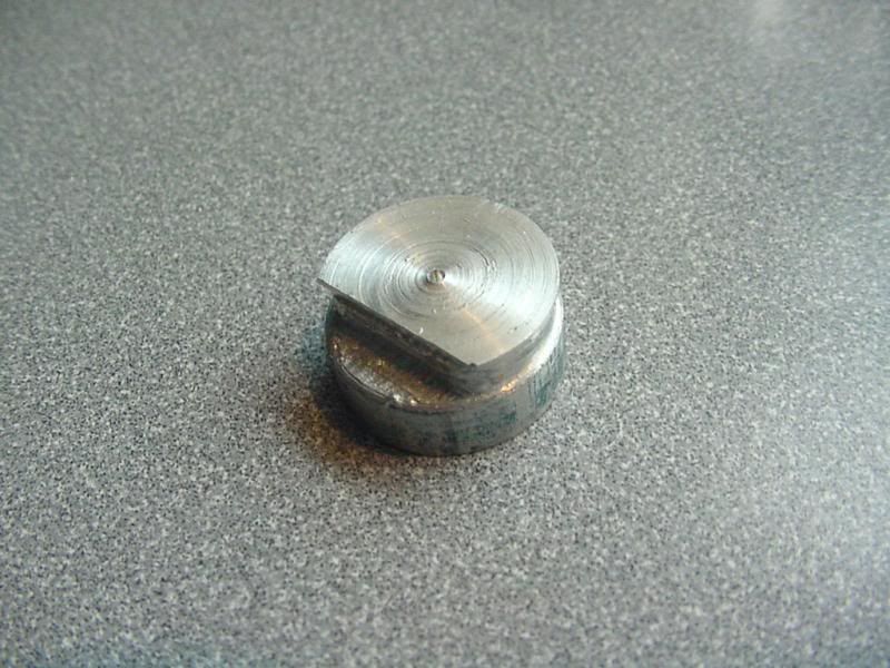

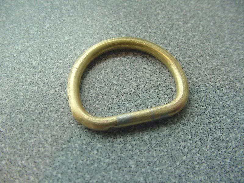

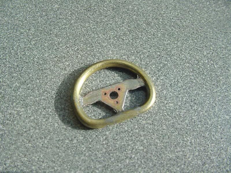

The steering wheel will be another Momo unit. I started by annealing some brass rod and forming it around an aluminum buck I machined then soldering the joint.

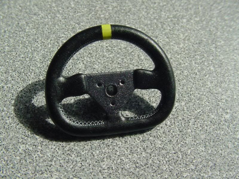

I acid cut the spoke section and soldered it into the wheel.
I also acid cut parts to use for the wrapping where it goes over the outer edges of the spokes.

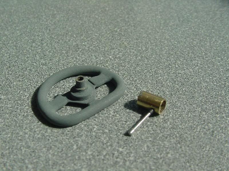

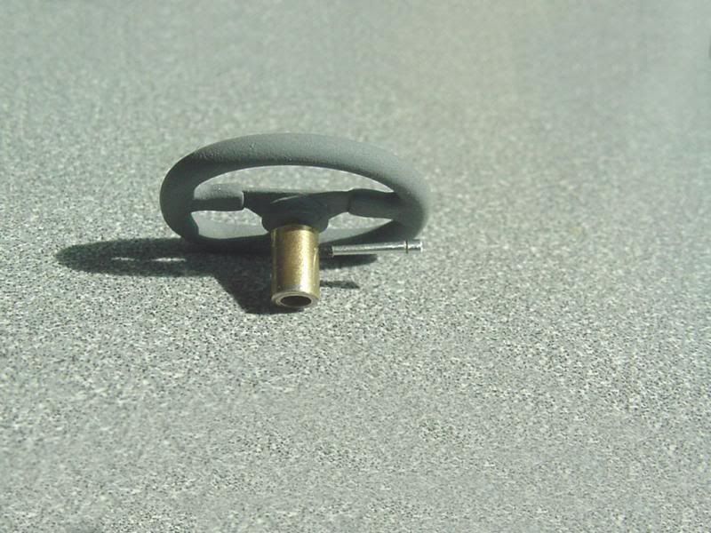

I made the hub (mounted to the wheel) and steering column from various sizes of brass tubing and turned a turn signal lever from aluminum.

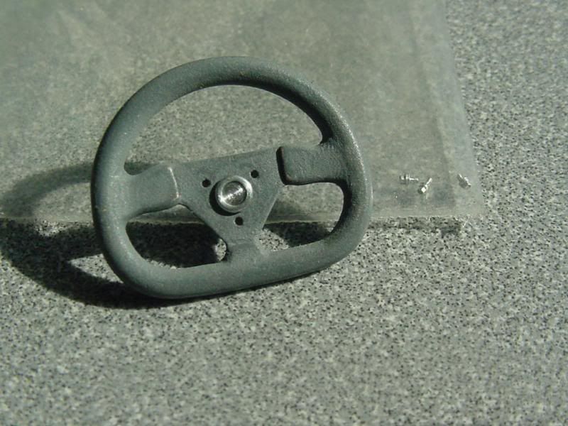

The horn button and mounting hardware (in the bag) were also machined from aluminum.
The three bolts are scaled down versions of 9/32 heads with 5/16 diameter washers. I’ve started to texture the grip of the wheel; I’ll sand the texture off of the spokes later.
Originally I had thought about making the grip in suede, but with the suede versions they bond the material to the wheel, they aren’t not sewn. I wanted to add stitching too, so I went with the standard leather wrap.
