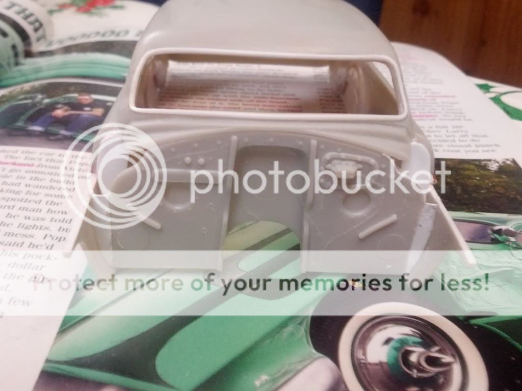

Modlbldr Posted April 24, 2013 Author Posted April 24, 2013 Here's some shots of this week's work. I've been working on molding in the firewall last night and today. The background is the magazine photo of the area that I am "approximating". Next up is the boxing in of the rear floor and the airbag suspension. It's coming along. Thanks for stopping in. Later-

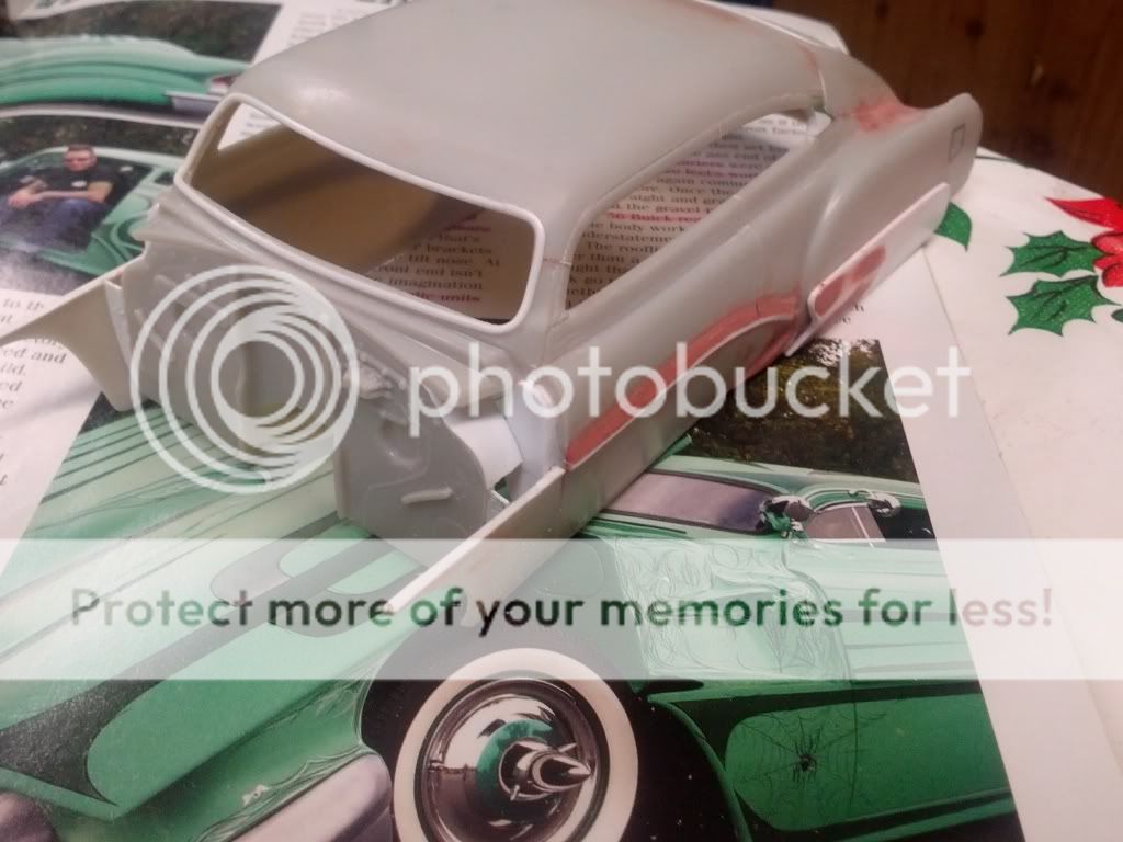

maltsr Posted April 25, 2013 Posted April 25, 2013 Just found this thread - the work so far is awesome, Tom, especially the roof chop, very neat. Did you simply lay down the rear window to bridge the gap?
Modlbldr Posted April 25, 2013 Author Posted April 25, 2013 Maltsr- This pic is about the best to show where I made my cuts. http://i486.photobucket.com/albums/rr225/Modlbldr/IMG_20130407_102753.jpg If you look at where the putty is it should give you an idea. I cut across the top above the back window and then took out a pie shaped cut from the bottom corner of each rear side window to right about where the trunk begins to curve downward to the rear bumper. That allowed me to push the rear section down into place. I can't guarantee this was the right way to do it, but it worked for me. Later-
maltsr Posted April 25, 2013 Posted April 25, 2013 Maltsr- This pic is about the best to show where I made my cuts. http://i486.photobucket.com/albums/rr225/Modlbldr/IMG_20130407_102753.jpg If you look at where the putty is it should give you an idea. I cut across the top above the back window and then took out a pie shaped cut from the bottom corner of each rear side window to right about where the trunk begins to curve downward to the rear bumper. That allowed me to push the rear section down into place. I can't guarantee this was the right way to do it, but it worked for me. Later- It worked very well, Tom

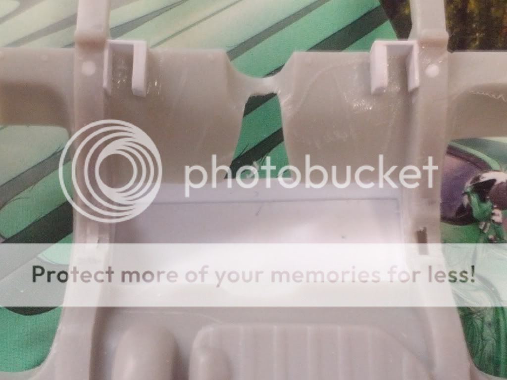

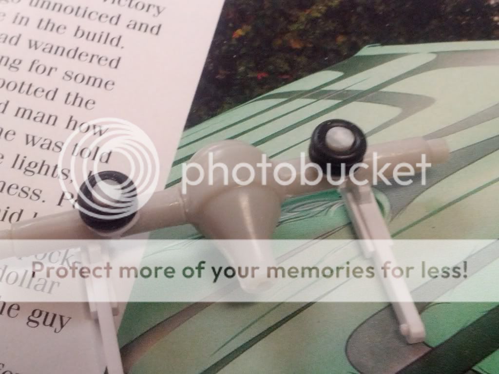

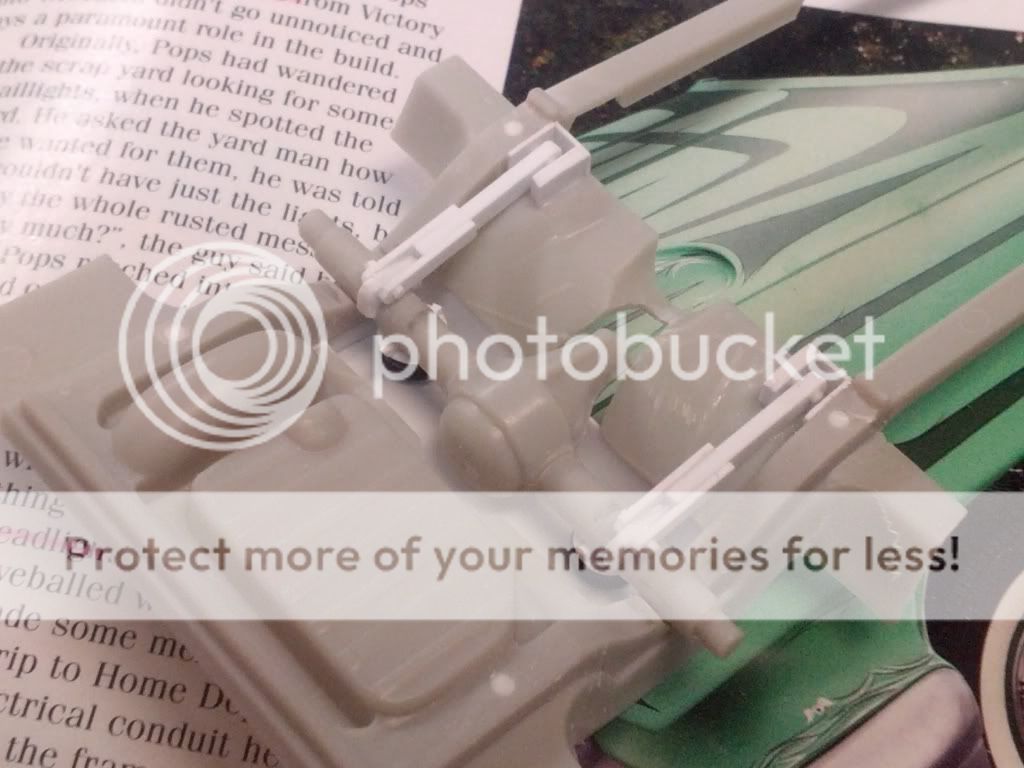

Modlbldr Posted May 2, 2013 Author Posted May 2, 2013 (edited) OK, here is what I have so far on lowering the front. I started with cutting off and raising the upper spring pockets. Before: After: Then I cut out the center cross member and raised it up. This brought the lower A frame assembly up tight to the frame and gave me about 1/8 inch of lowering which, along with the lowered spindles should tuck the front wheels up nicely into the fender well. Now that I have done this I am debating on whether to convert the front suspension from springs to airbags. I may go to bags. Later- Edited May 2, 2013 by Modlbldr
