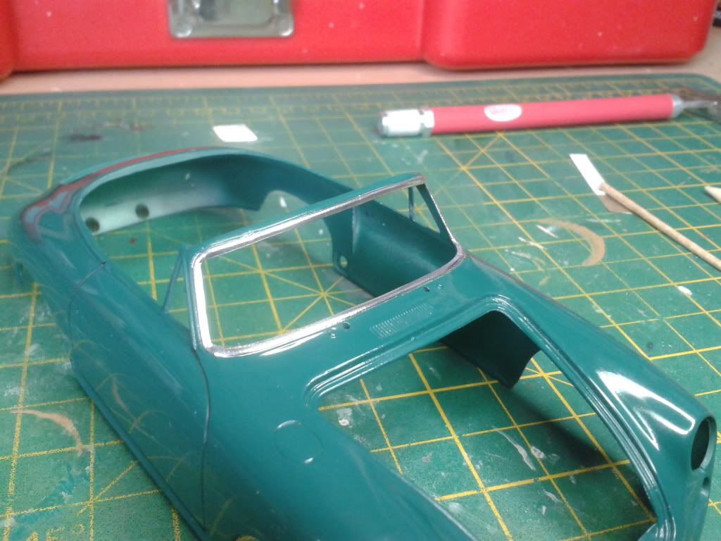

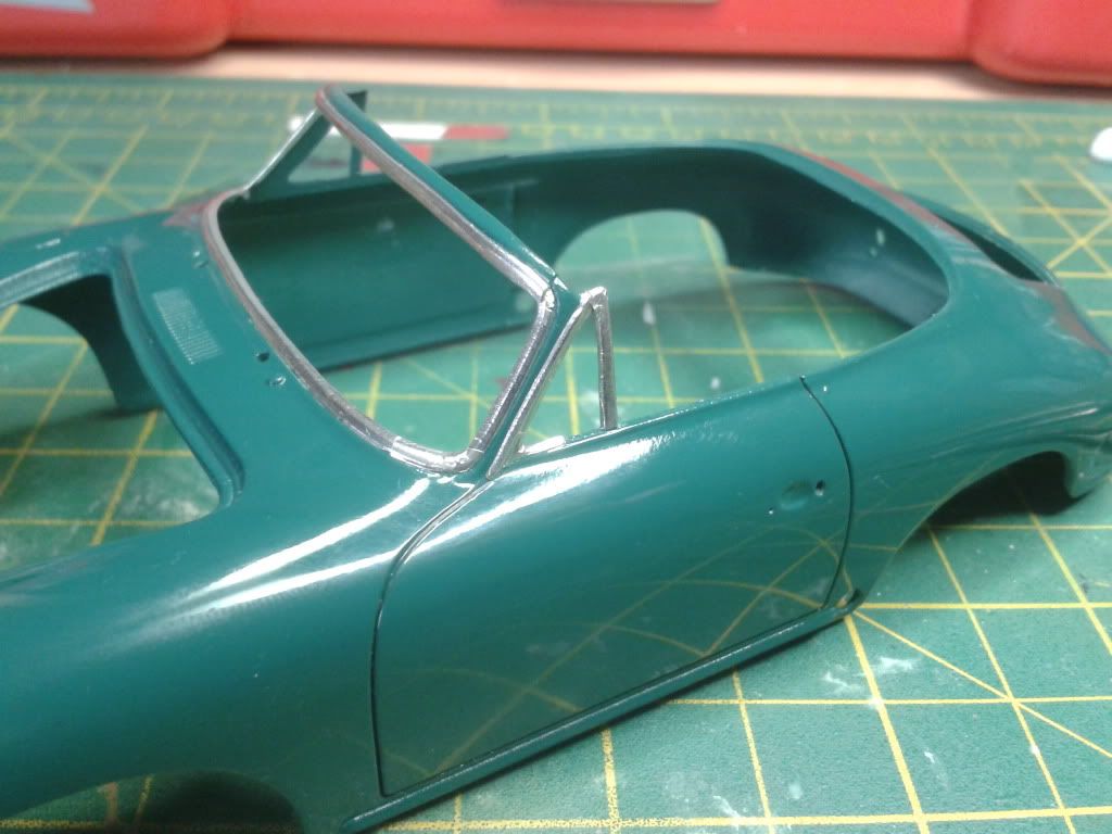

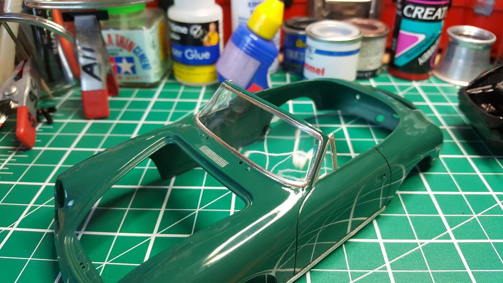

I can't believe I haven't been in the hooby room since May to do any work, decided to get the Porsche out and see what my next move would be, didn't spend a lot of time in there, but managed to get the front windscreen frame covered in BMF, as the frame was originally broken I wasn't looking forward to doing the BMF incase any pressure burnishing down the BMF would have broke the frame again, luckily it came through o.k .....

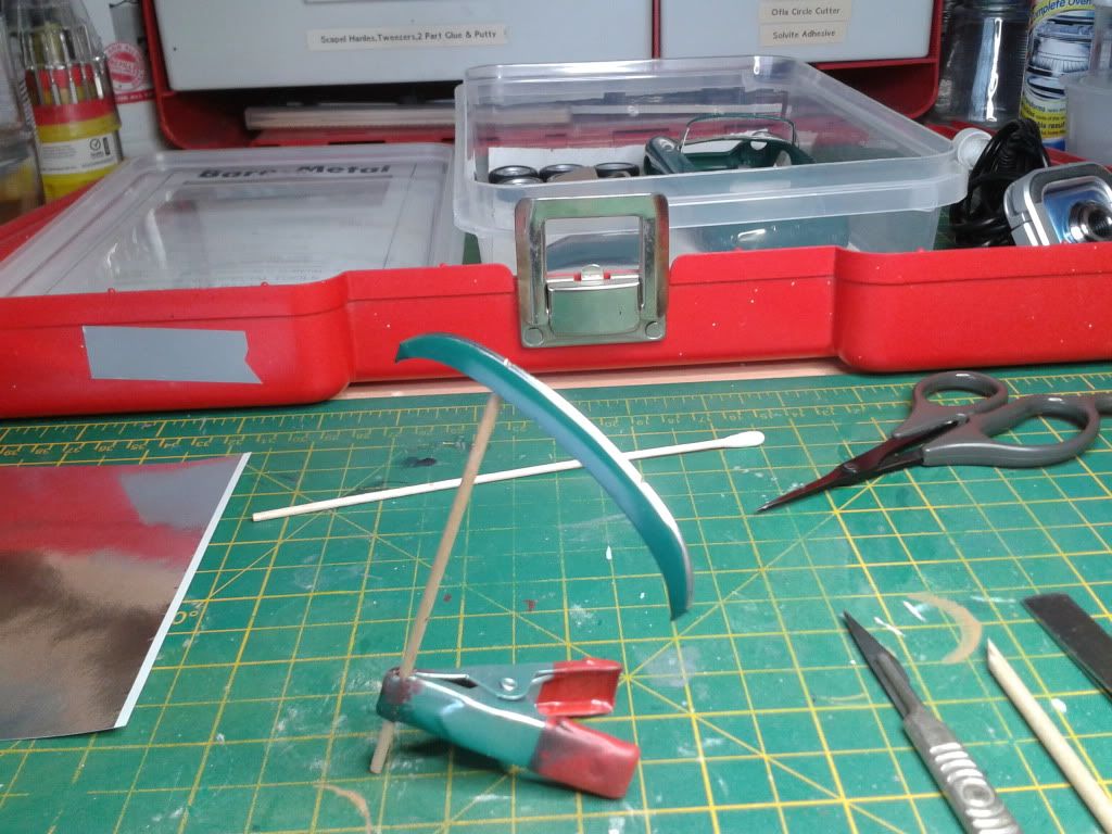

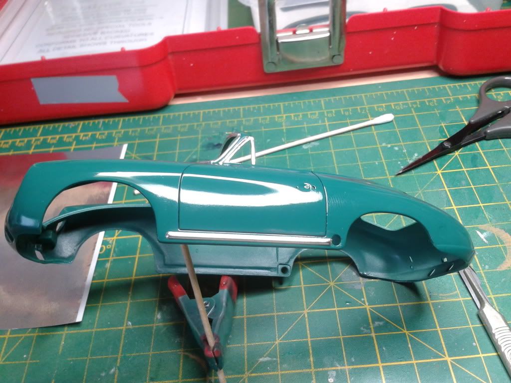

Did a little more before before closing the door for the night, not a lot of BMF to do on it, side strips under the door and some chrome trim on the bumpers, but they still need to be done,

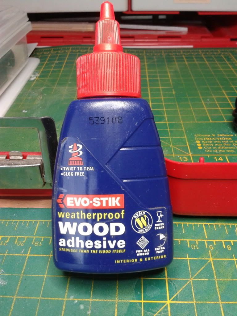

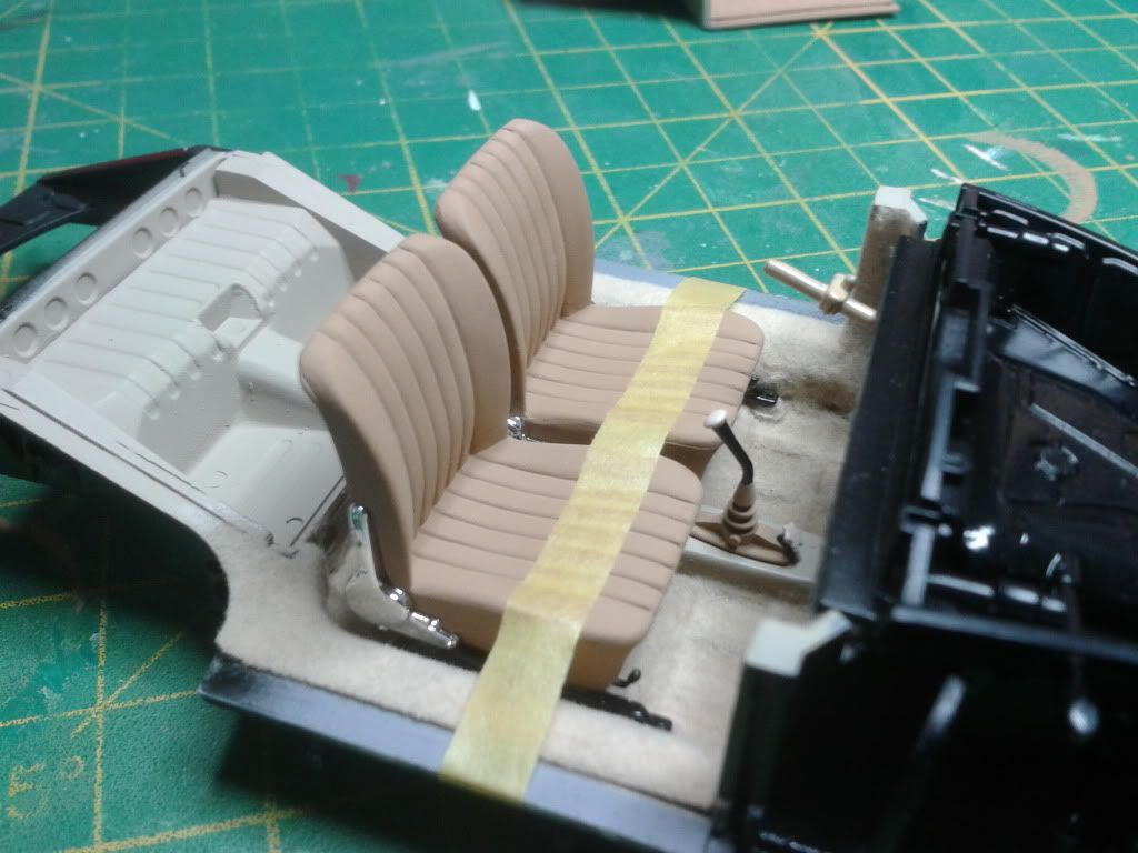

Hi,
Nice work with the flocking :-) what glue did you use and where from having a nightmare flocking using normal white glue ? Please explain as very frustrated car modeller at the moment :-)
Thanks
Dave
I used to use Solvite repair adhesive for flocking, but they have changed the formula, and it now more wallpaper paste in texture than a PVA glue, so for this one I found a bottle of Evostick PVA woodwork glue thinned out slightly with distilled water,
I find working on small sections at a time instead of trying to do the whole floorpan makes for a better finish, brush the glue on, sprinkle on the flocking using a mesh sieve, press down into the corners etc using your finger, and leave to dry, I usually let is sit on the side for around an hour before I touch it again to work on another section, the flocking I'm using for this build is a lot finer than I have previously used on other builds and I'm finding that two coats of the flocking fibres are needed.

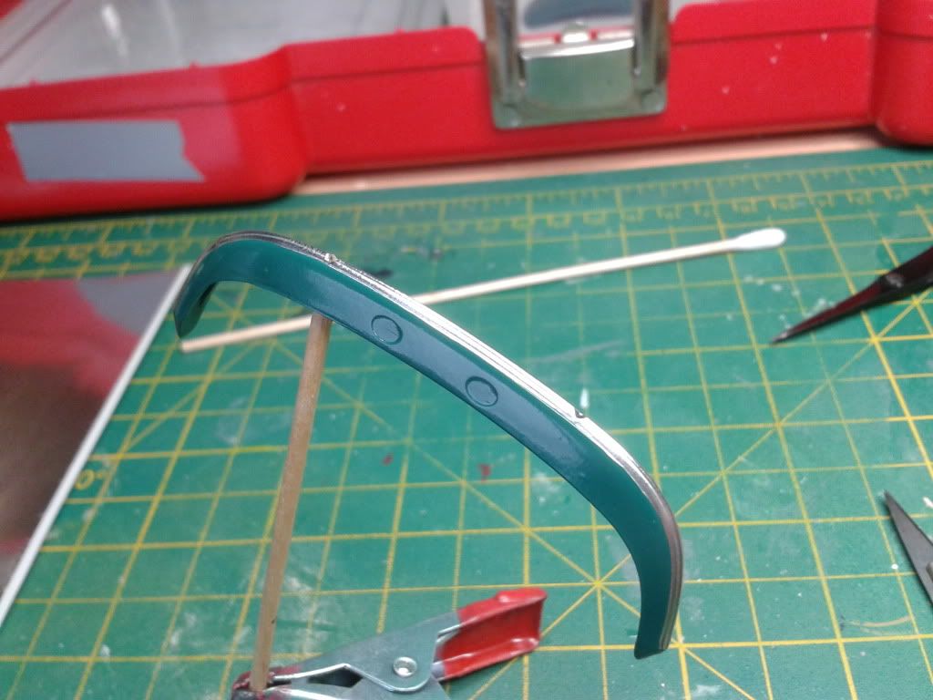

I need to airbrush a few small parts before I can any further with the build, but today I did a little more BMF on it ....

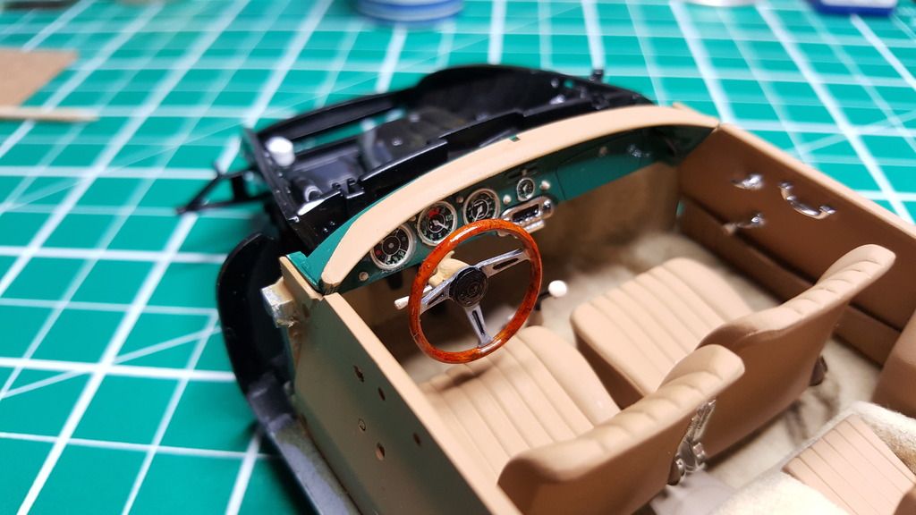

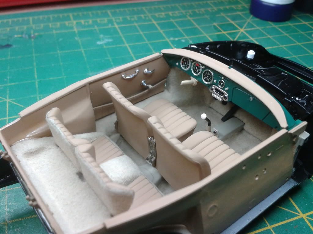

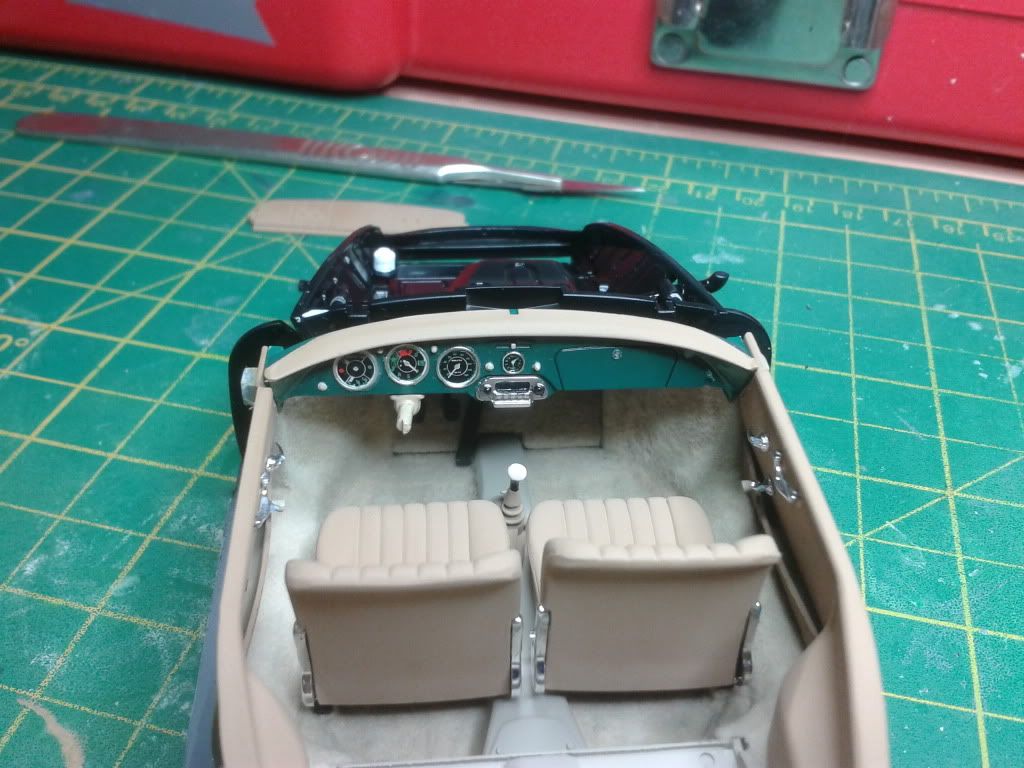

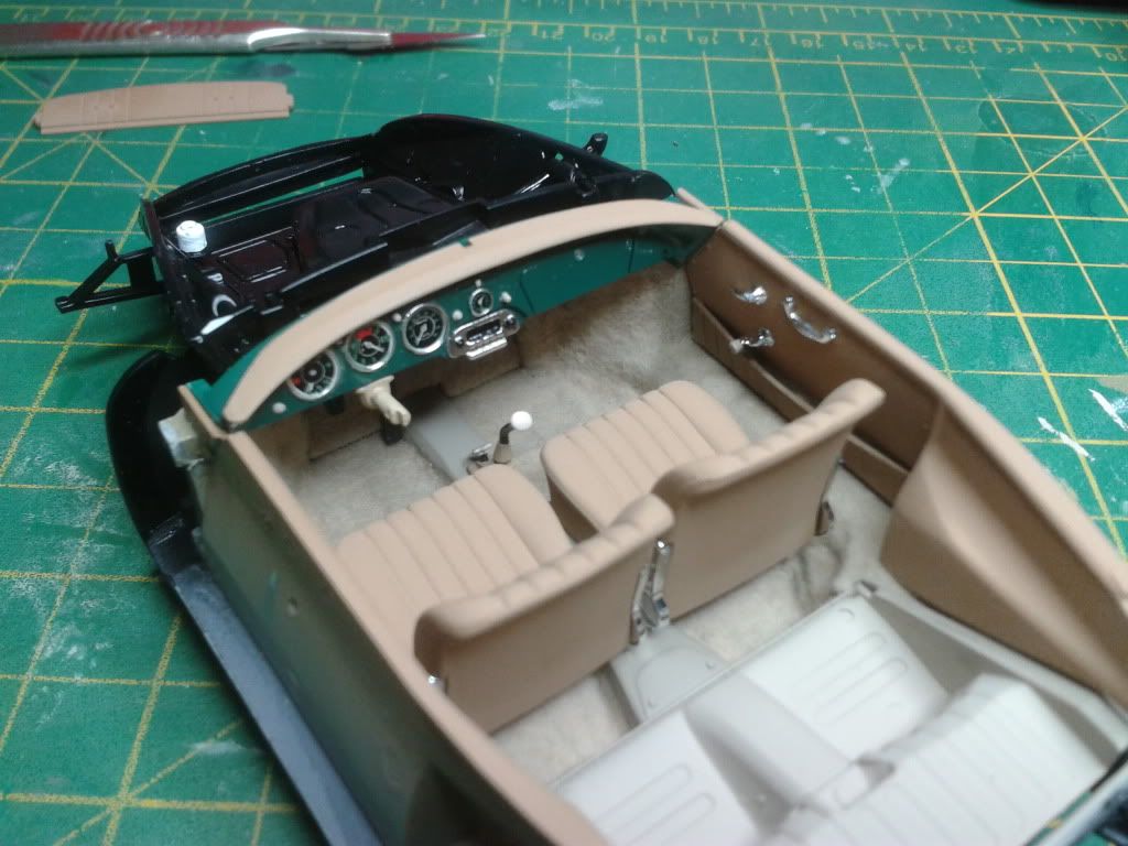

Well as the weather is on the turn over here, it's time to crank on the heating and spending more time in the hobby room, got the seats put together, side panels all fitted out and fitted into place, plus the dashboard, some parts are a little tricky to get to fit, but nothing too hard, a bit of touching up to hide a few marks on the side panels, but once dry won't be noticed.
Absolutely stunning work ! The interior color is very realistic , what color is it or is it a mix ? Notice in previous threads the paints you used ???????
Dave H
That interior is mind blowing! Are the gauge bezels BMF or paint ?
BMF .....
Dave H
The seats and side panels are a mix of Humbrol enamels, mixed to replicate the photo's of the full size 356 I'm working on.

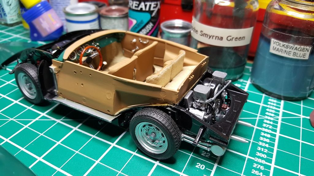

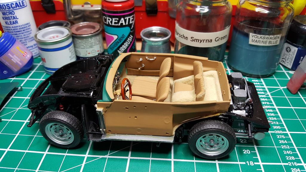

It's been so long since I've touched this model, I totally forgot about it, the wheels are now on and it's ready for the body and chassis to become one
I'm glad you got back to this one, it looks Outstanding!!!!!!  Thanks for sharing, I have one of these in my stash to do some day too. Keep up the Great work!!!
