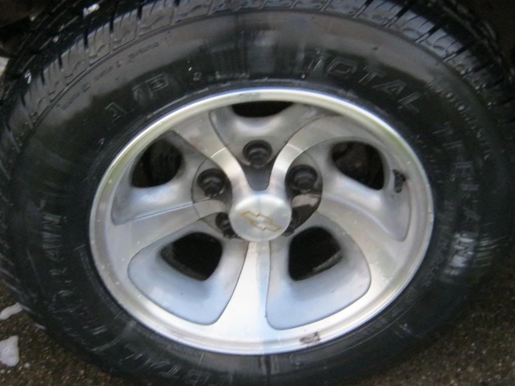

MAGNUM4342 Posted May 29, 2013 Posted May 29, 2013 Somebody popped two of my tires while I was out the other night, so I had to buy a pair. The left front looked like this when I got home. I went back to the tire shop, and was told don't worry it will wear off. Should I be concerned?
disabled modeler Posted May 29, 2013 Posted May 29, 2013 Hi Kevin... It looks like ether bead sealer or just the soap mixture they used to mount the tire to me and is nothing to worry about in my opinion...I mounted tires for 20 years seen a lot of stuff before. You can probably remove the stuff with a wet SOS pad or wire brush with bleach white tire cleaner...hose off the tire afterwards with a garden hose. Hope this helps some. Mark

1930fordpickup Posted May 30, 2013 Posted May 30, 2013 Purple power will clean it off. just be careful how long you let sit on the rims( it will eat the coating off ). Dunk the brush in the cleaner would be best . Do a small spots at a time with good rinsing of the rims.
MAGNUM4342 Posted May 30, 2013 Author Posted May 30, 2013 It came off with some Dawn and a scrub brush.

my80malibu Posted May 30, 2013 Posted May 30, 2013 I was looking at your original post, Did they even Balance the wheels with the new tires? Just curious, the pictures before, and after the cleaning. Shows where the wheel weight used to be.
Longbox55 Posted May 30, 2013 Posted May 30, 2013 That's most likely where the old weight was from the original tire. It's not uncommon to see tires these days only need a small amount of weight to balance them, and not necessarily need weights on both sides. This is especially true with the current balancers in use these days, which are far more accurate that what was used even just a few years ago. As far as what happened with the tire, definitely rubber lube. Looks like they used too much of it, and it was most likely straight out of the bottle and not cut 5:1 like it should have been. Lots of shops do that to make tires go on easier, especially low profile tires, but it does make a mess.
