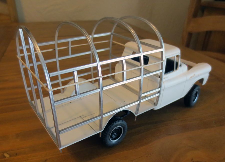

gasser59 Posted February 15, 2015 Author Posted February 15, 2015 More of the ribs have been made and the camper is starting to look like a wild animal cage. LOL Still a few more to do along the top, one on each side then the outer skin can be fabricated. I made a template out of card stock and haven't done one for either end just yet. Those will go on after the interior is put in. Thanks for following along and comments always welcome.

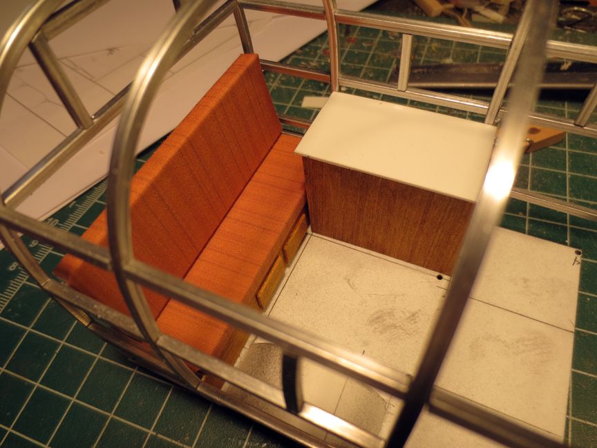

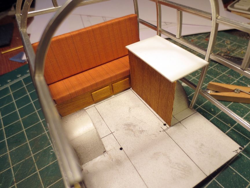

gasser59 Posted February 19, 2015 Author Posted February 19, 2015 (edited) A bit of work done last night and a bit more this morning before work. Cabinetry has started along with the printing of the couch cushions. The cushions were cut from basswood and then sprayed with Elmer's Spray adhesive. The fabric was applied and folded over the back side. I wasn't sure of the colors but in speaking with PeeWee, he told me they were brown and a black and white picture I have showing the bunk in the done position showed the striped pattern. The back couch cushion flipped up by hinging in the back and became the top bunk which was a catch-all. The interior aluminum printing plate 'skin' will need to be applied before attaching any cabinetry but its so much easier to build and test fit by being able to see through and work through the ribs. The countertop will get a small sink and a two burner cooktop. Here's a couple of progress pictures. Thanks for following along and comments welcome. Edited February 25, 2015 by gasser59

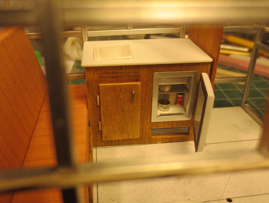

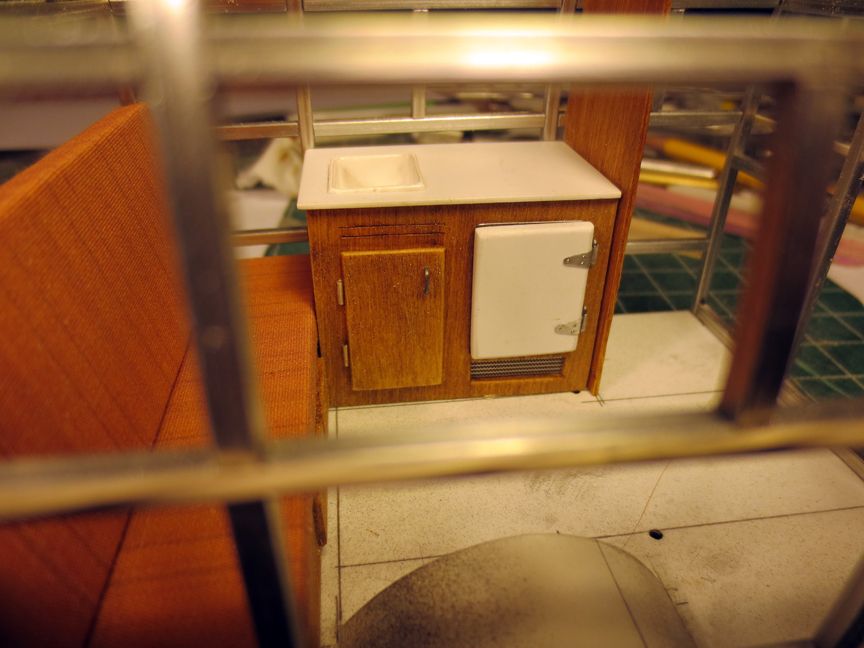

gasser59 Posted February 23, 2015 Author Posted February 23, 2015 Spent a good portion of yesterday at the bench after doing some serious yardwork. Glad to have the fridge done. The door is made from unpainted evergreen as is the inside box. I made the freezer door out of printing plate with a few embossed lines pressed in from the back. I happened to have a piece of P/E that I could use as the metal rack. A few items are 'chillin'. The hinges were made from printing plate and attached with rivets from Scale Hardware. I still have to finish up the handle, then it will be done. I put a fridge vent under the door and used more P/E for the grill. The sink still needs another coat of white paint. It is a resin piece from the cabover camper kit that had to be shortened about 1/8th inch. Its really tough to sand in there. LOL Here's a couple pictures. Next up is a funky looking instant water heater which goes on the right side wall above the counter. Thanks for your interest and comments welcome.
