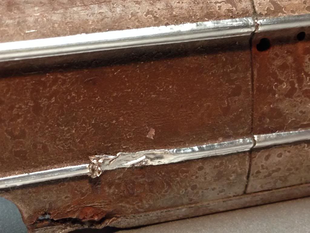

Baugher Garage Posted February 18, 2014 Author Posted February 18, 2014 Finally got some foil added to the stainless trim. I cheated and used 3M metal repair foil tape instead of the *official* Bare Metal Foil. Seems to work pretty good for the straight trim. Body damage... Fins turned out nice! Front end has seen better days...

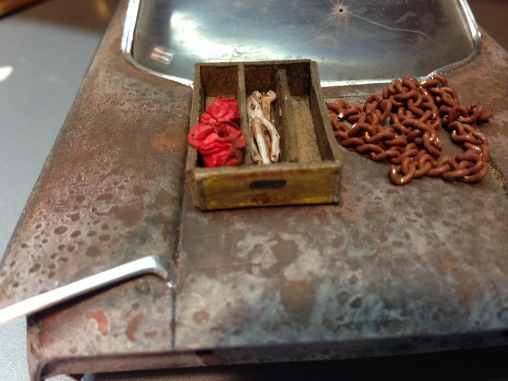

Baugher Garage Posted February 19, 2014 Author Posted February 19, 2014 (edited) Thanks! I got the rear glass installed (with a couple of bullet holes and cracks. Excuse the crate of junk on the trunk... Also have inspiration pics gathered for the seats. http://s1295.photobucket.com/user/BaugherGarage/slideshow/Seat%20examples Edited February 19, 2014 by Baugher Garage

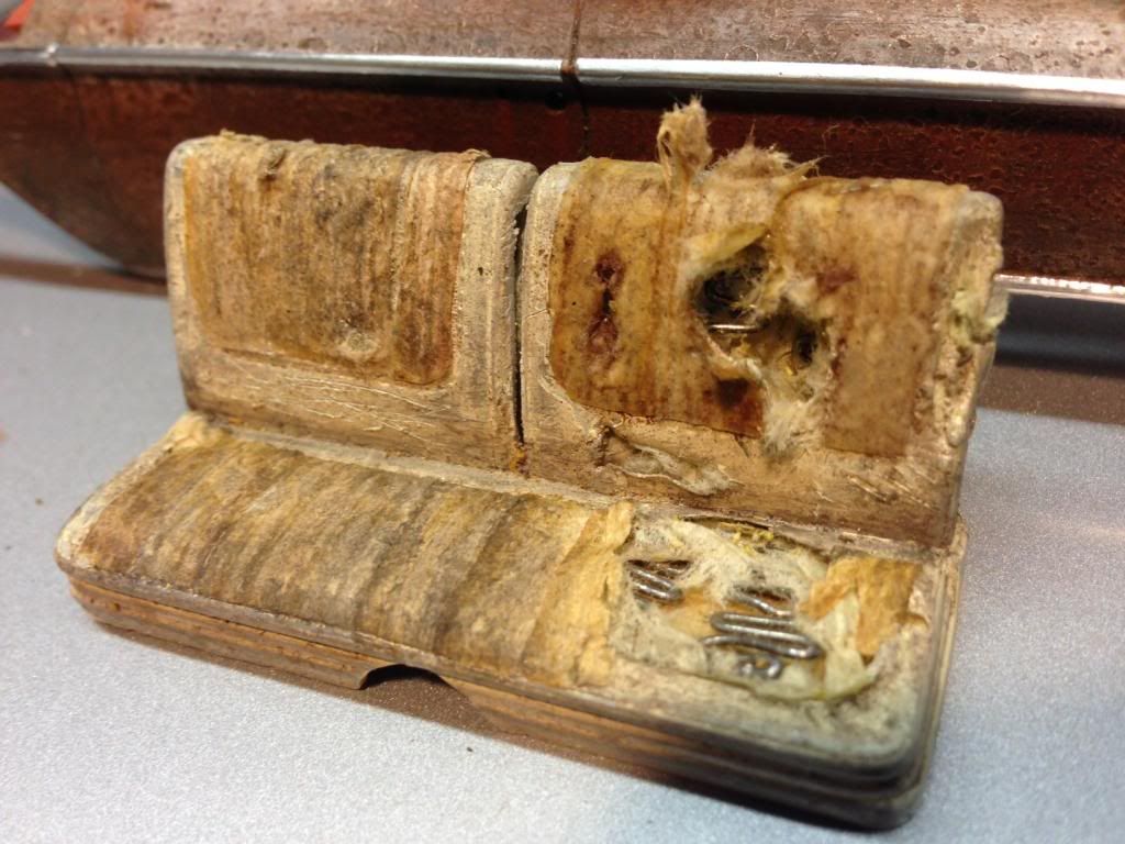

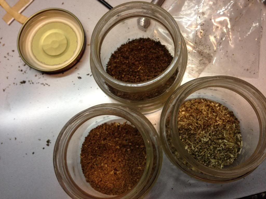

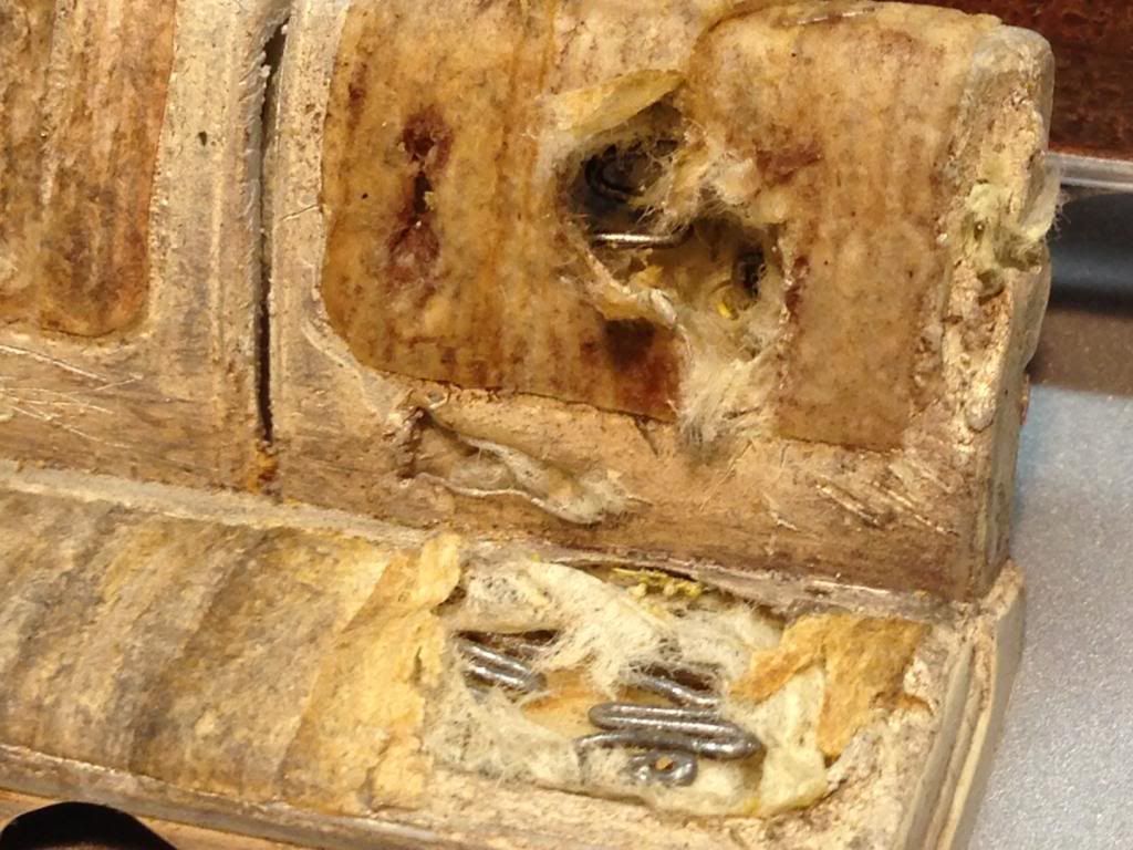

Baugher Garage Posted February 21, 2014 Author Posted February 21, 2014 Front bench seat is finished. This is my first attempt and making a ratty old seat. I continued to utilize the used tea bags from the kitchen. I have found that this material is ideal for the seat fabric and the seat stuffing, as it's fibers look right at 1:24/25 scale. The seat turned out a little grungier than I hoped, but I don't always know when enough is enough... the seat springs, visible in the holes, are a little too large for scale, but again, my first attempt... just bent some small gauge wire with tweezers. *I'm also keeping all the tea leaves from my wife's various herbal teas - she's saving all her tea bags for me! The various ground up leaves make great dirt, saw dust, etc.
