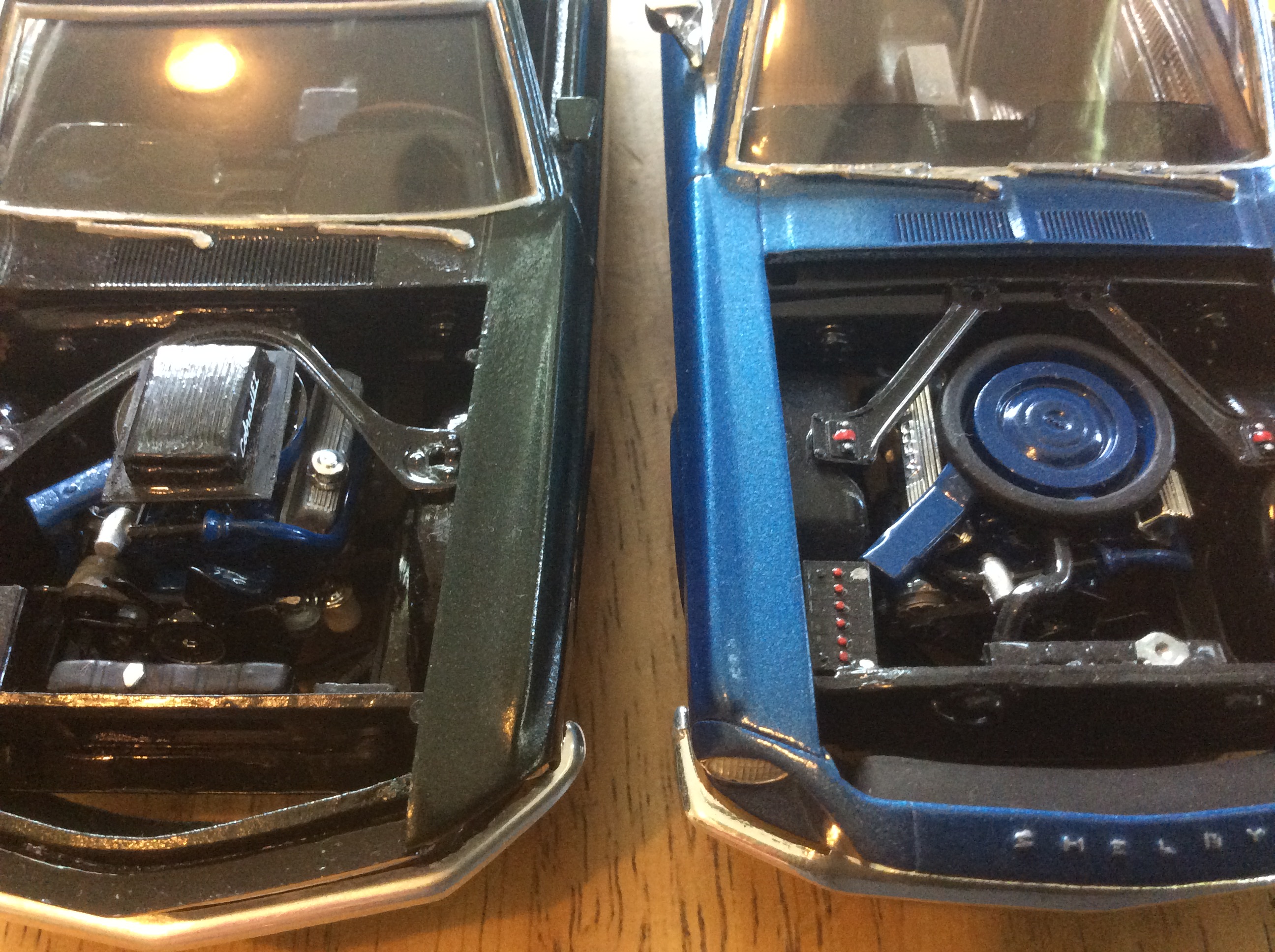

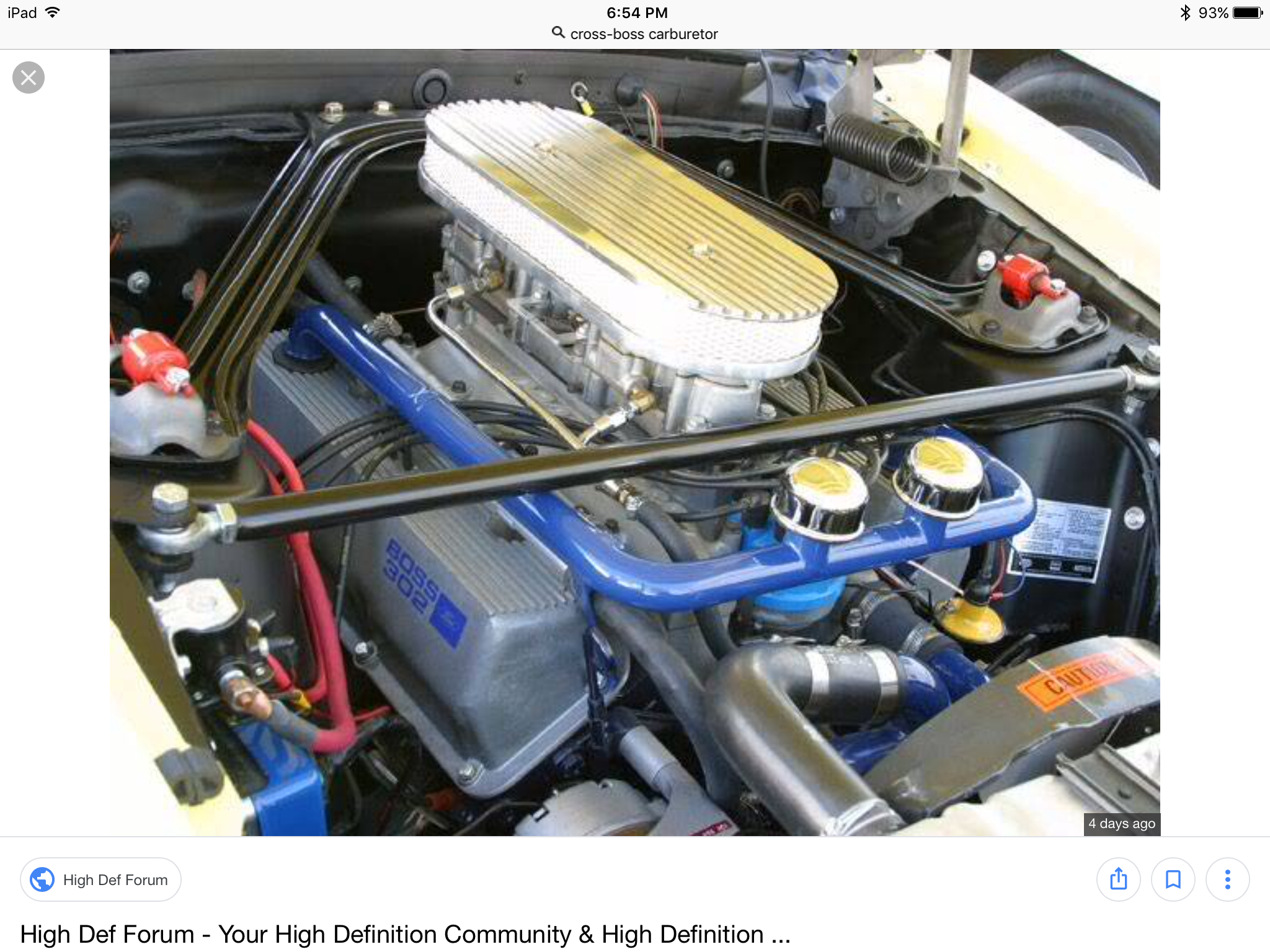

Styrofoam04 Posted August 15, 2018 Author Posted August 15, 2018 (edited) Haha Thanks guys! this engine was my practice engine as I'm building the Mach1 @vamach1 I saw this reference pic as well, but I have no idea how to make the blue pipe thingy with the shinys!? Also how does everyone make the ignition coil? you guys are very helpful cant thank you enough Edited August 15, 2018 by Styrofoam04
blunc Posted August 15, 2018 Posted August 15, 2018 (edited) the blue pipe thingy is a tube installed to control where internal engine pressure is vented (in regular passenger cars it is directed back into the air cleaner to be burned by the motor since it usually has fumes and is also an emission control feature). the shinys (breather caps) are vent caps which have screens in them, on most performance engines they are attached to the valve covers where you see the blue pipe connected in this photo. the ignition coil and blue pipe can be made from rod (plastic or metal), sprue or any other material you have on hand, the breather caps can be made or robbed from other kit motors. the ignition coil can be as simple as a short piece of sprue with a hole in one end to insert a coil wire from the distributor cap, paint detail will do the rest. Edited August 15, 2018 by blunc fix
Force Posted August 15, 2018 Posted August 15, 2018 (edited) 21 hours ago, mustang1989 said: Thanks for the added info there Hakan. I'm assuming that the added smaller line is for a pressure gauge or fuel return line? Yes that's right. The blue pipe "thingy" with the breathers were mostly used in circle and road track cars like NASCAR and Trans Am to prevent oil from the valve covers leaking out through the breather caps due to the centrifugal force in the turns, that can happen if the breathers are in the usual place on the valve covers and the long tube helps. Edited August 15, 2018 by Force

vamach1 Posted August 28, 2018 Posted August 28, 2018 On 8/14/2018 at 6:57 PM, vamach1 said: This picture may be helpful. The MPC 69 Mustang kit includes a 428 with those breather tubes and caps. A coil can be found in many kits including the AMT 67 Mustang or GT350.

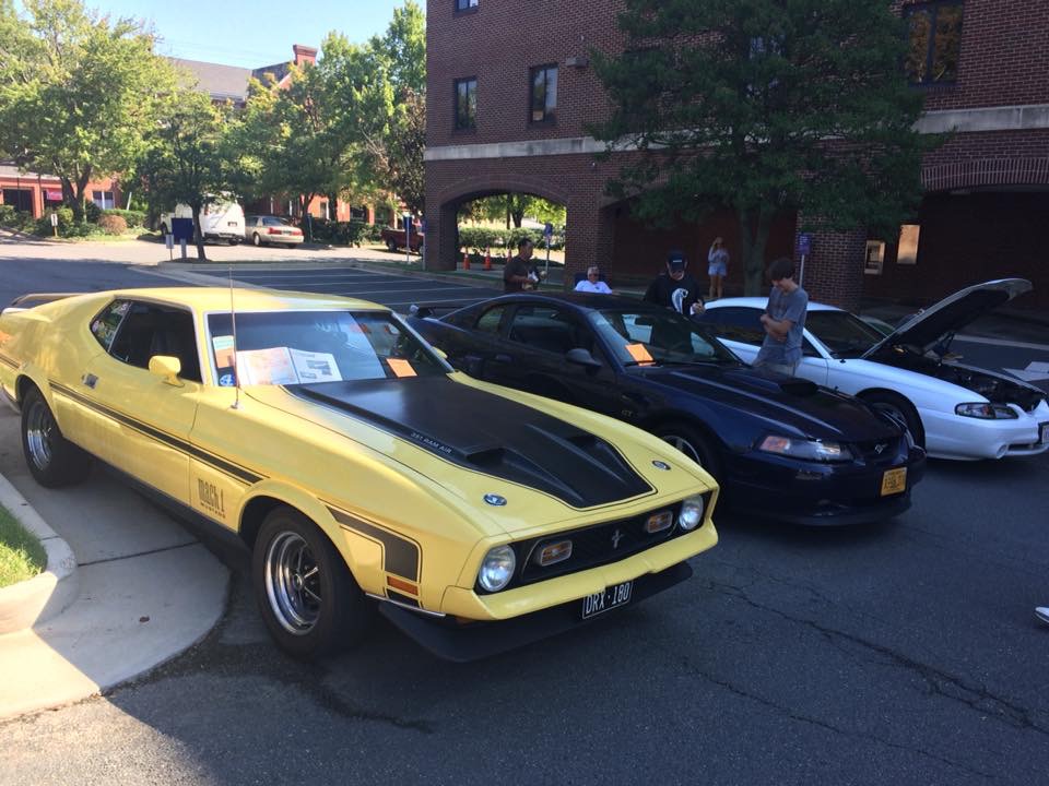

vamach1 Posted September 4, 2018 Posted September 4, 2018 On 8/30/2018 at 2:14 PM, ThatMustangGuy said: What about the 67 Shelby GT500 from AMT? My son has a 2001 trublue GT. My Mach1 on the left and a Cobra with a 5.0 Coyote transplant on the right.
ThatMustangGuy Posted September 5, 2018 Posted September 5, 2018 20 hours ago, vamach1 said: My son has a 2001 trublue GT. My Mach1 on the left and a Cobra with a 5.0 Coyote transplant on the right. That’s awesome

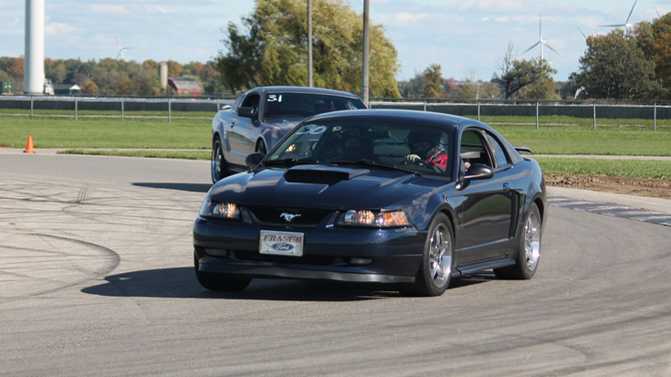

Styrofoam04 Posted September 5, 2018 Author Posted September 5, 2018 (edited) Nice mustang family! I love the true blue! I have only seen one in the wild besides mine. Mine at Toronto Motorsports Park Cayuga Edited September 5, 2018 by Styrofoam04
vamach1 Posted September 5, 2018 Posted September 5, 2018 1 hour ago, Styrofoam04 said: Nice mustang family! I love the true blue! I have only seen one in the wild besides mine. Mine at Toronto Motorsports Park Cayuga Nice. I see you and raise you one. LOL
Styrofoam04 Posted September 6, 2018 Author Posted September 6, 2018 (edited) 20 hours ago, vamach1 said: Nice. I see you and raise you one. LOL haha nice!! My hat's off to you! Most people would be too scared to drive a beaut like that, never mind track it kudos Edited September 6, 2018 by Styrofoam04
