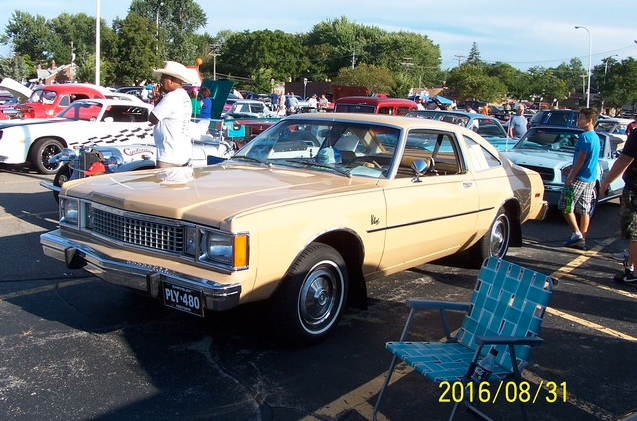

While this RR is a '79, it's wearing the 14" aluminum wheels you mention:
Now that is interesting!!
Are those original option wheels?
I got a set of 14" wheels in my stash that I have tried to find out where they came from.
Mine are made by british GKN and I think they look similar but not identical to the ones ones on your car.
The bolt pattern in 5-4,5" and fit a mopar.
