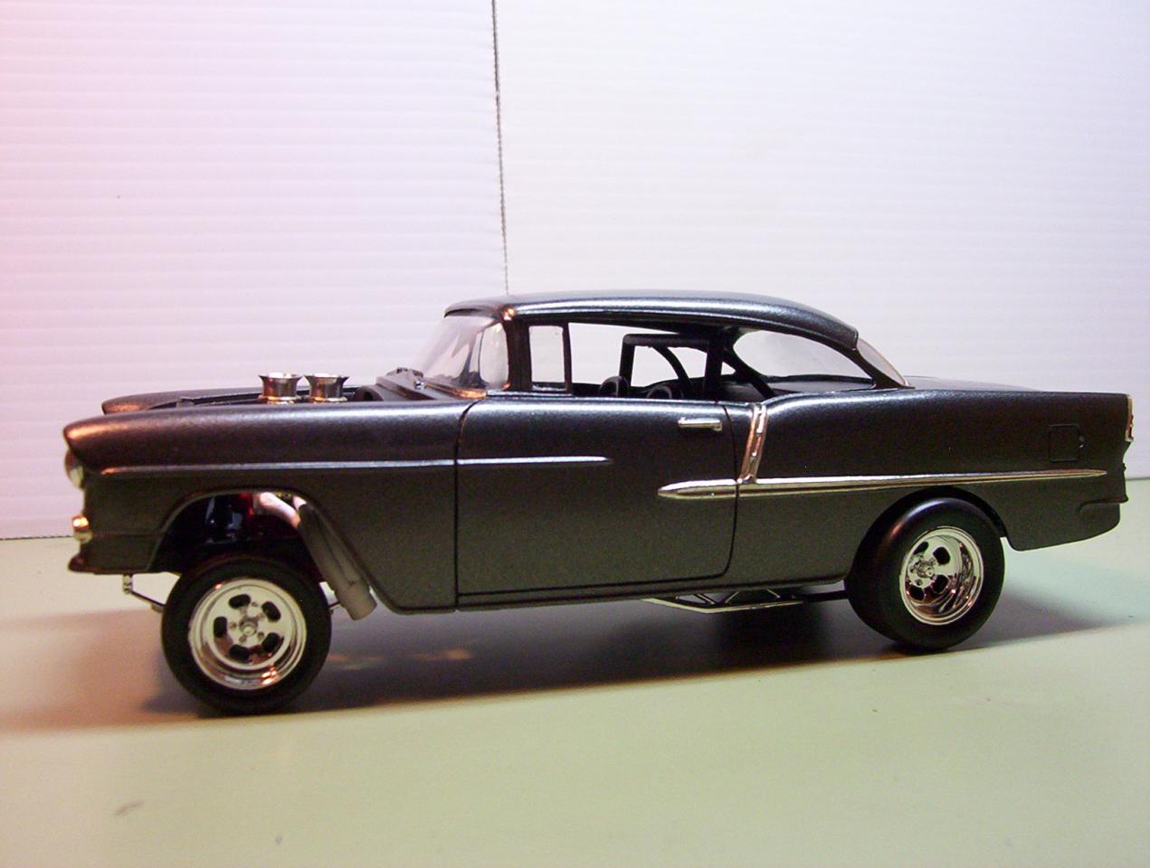

slusher Posted June 4, 2014 Posted June 4, 2014 I built that kit a few months ago and my body was in much better shape. I used semi gloss black and semi gloss clear. I like how you removed the molded in exhaust Niko...
