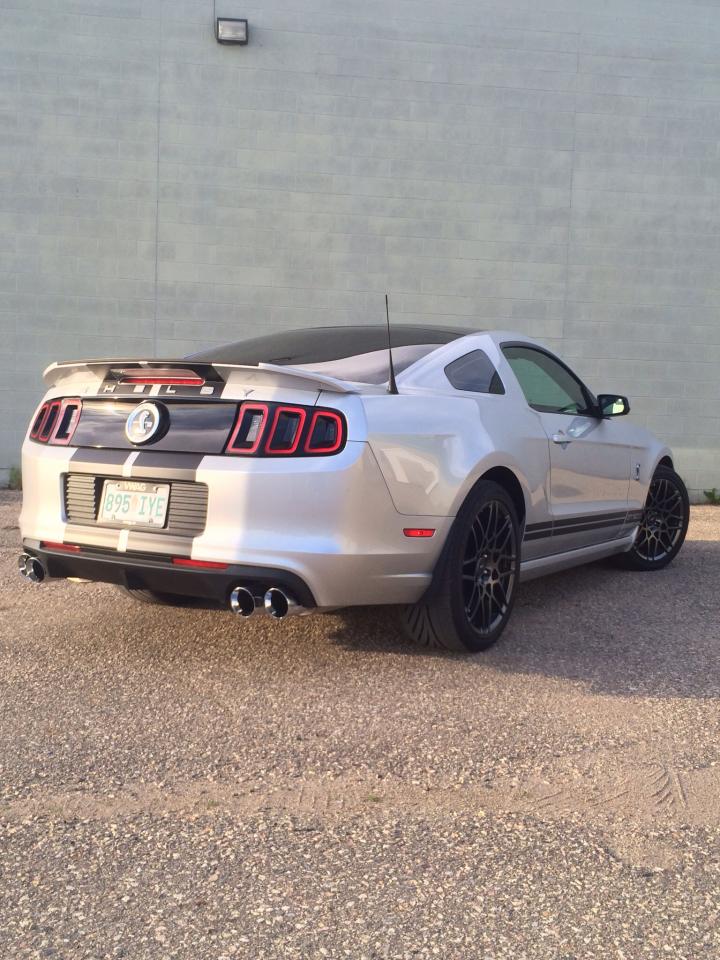

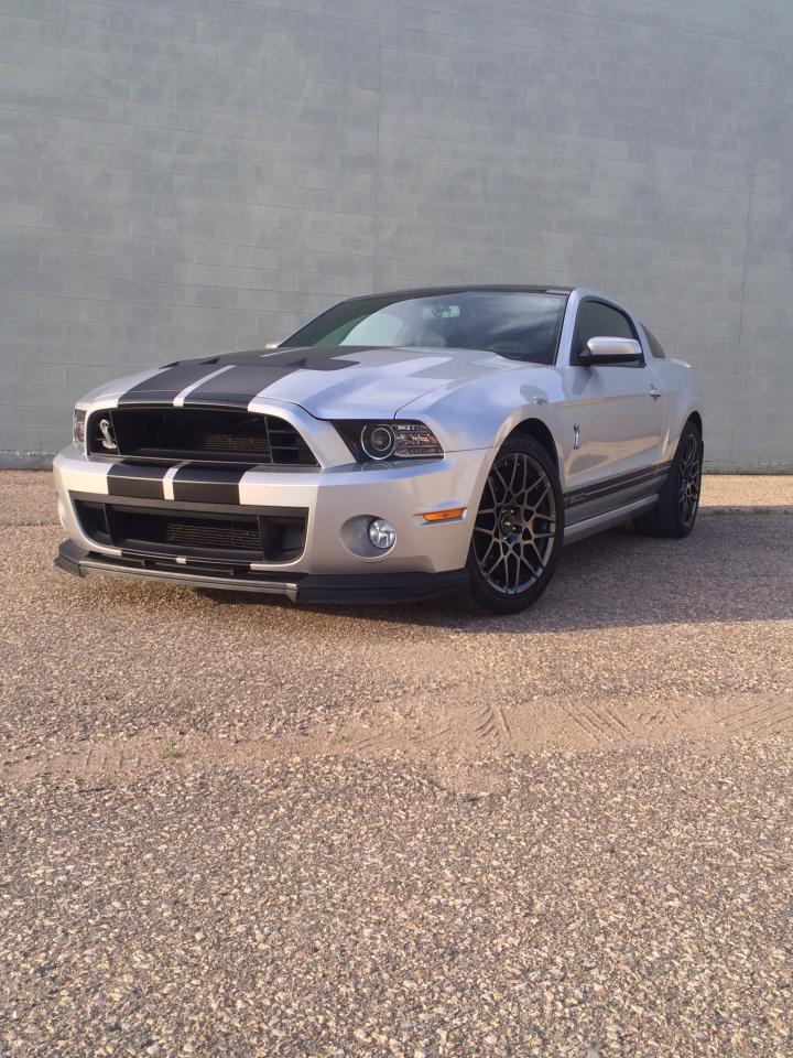

That turned out great. As you can see, every car and color is different. On my own car the gaps are pretty black.
You're comparing a full size car with a model! Now take that seam and make it 25 times smaller and what do you get? A seam that should be barely visible on a 1/25 scale model... which is what Randy's model now (correctly) has. Look at his "before" and "after" versions and you'll see how much more realistic the model looks with those huge black canyons gone. The seams are still there, still visible... but look much more "in scale" and realistic. The "toylike" look is gone. A huge improvement.

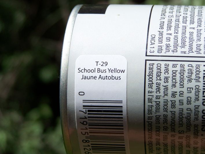

What paint specifically did you use for the body color?

Dave here is a pic of the paint I used. I bought it at Carquest auto parts up here in Canada. Not sure if you have Carquest outlets in the U.S. I used Dupli-Color gray primer with this paint. Tamiya primer would not work as I tested it on several pieces of styrene with different primers before painting the body. Even though it is an enamel you will still need the primer or it will attack the styrene.
