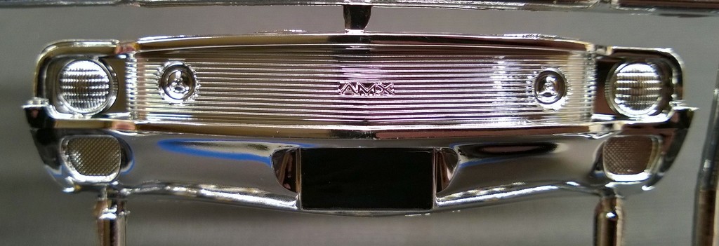

Casey Posted December 20, 2017 Posted December 20, 2017 (edited) On 7/12/2014 at 2:39 AM, ChrisBcritter said: The grille with inner headlights is molded in; there's an insert to make the stock grille. I blacked-out the outer headlights to make them look like intakes for cold-air induction, or brake cooling, or something... *snip* Edit: Forgot to mention - those tires have slots for plastic whitewall inserts that will start melting into the vinyl the moment you insert them, as usual, so I just reversed the tires. Expand Just as an FYI, Chris' model shown above is a '69, which has different grille/headlights/bumper piece than the '70, so while the stock '69 grille insert is still include in the reissued '70 kit, it doesn't work with the '70 grille-- see second attached image of the '70 grille/bumper, please. Also, the tires were updated as Mark mentioned above, and the separate styrene whitewall (and matching tire sidewall grooves) were eliminated, so the tires now have a slightly raised ring where the insert previously resided: I took lots of pics which can be viewed here: http://modelkitreviews.proboards.com/thread/783/1-20-mpc-1970-amx My thoughts and opinion of this kit-- it's okay, but nothing great. Lots of flash to remove, the kit has a lot of "soft" details (which was always why most MPC kits turned me off) and a few notable inaccuracies (the valve covers mentioned earlier for one), a few disappointments (the molded in headlight lenses), but is the only available AMC model for ~$30, so keep that in mind when tempering your expectations. I too wish this kit could've been backdated to a '69, but my guess is that wouldn't have been a good financial choice for Round2, and perhaps not even possible. At any rate, prepare to put more than the usual amount of prep work into this kit if you decide to take the plunge, but in the end, I think your effort will be rewarded with a nice looking model. There is room for additional detailing and overall improvement of this kit, so the end result could be pretty spectacular if the desire is there. Edited December 20, 2017 by Casey
