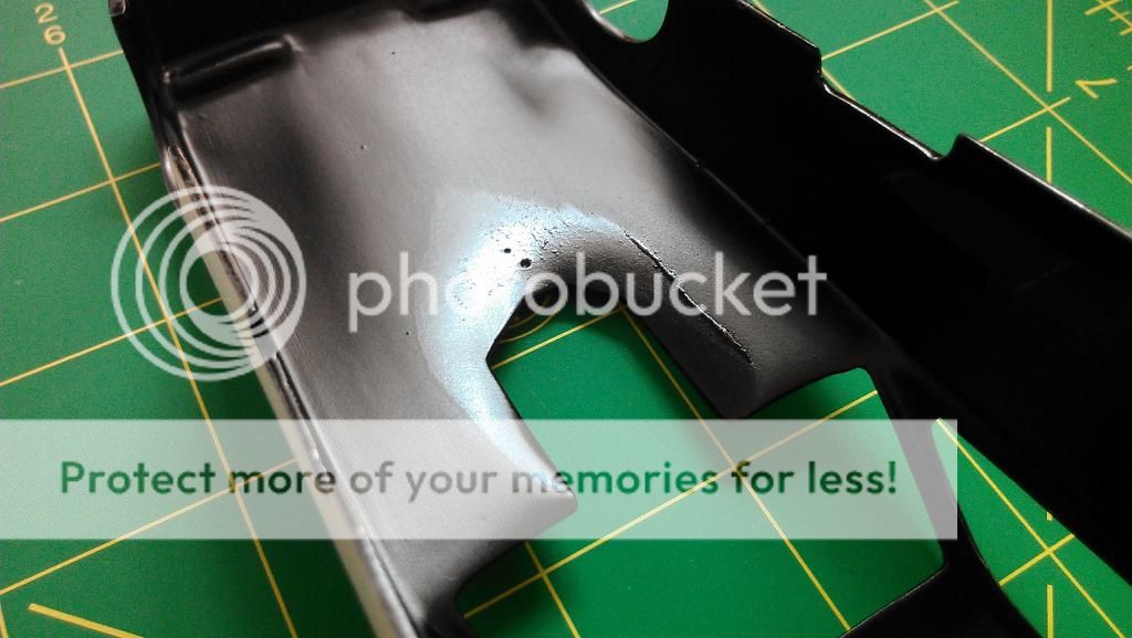

NJJeff Posted July 13, 2014 Posted July 13, 2014 Soaked, scrubbed and sanded the underside of a resin funny car body. Painted it with Tamiya semi-gloss black. All was fine except where I had agressively removed material to thin it for a more scale appearance and thickness.In those areas the paint remained tacky even after several hours....(sigh) Sooooo, I sanded it all down until the paint was gone, then re-scrubbed everything, then applied two medium coats of Tamiya fine surface primer. Waited an hour or so.....great! No stickiness... Then applied 3 light coats of Tamiya semi-gloss black and.....it's WORSE. I'm assuming that in the areas where I removed a lot of material, its weeping resin residue or something... Anyone seen this before and more importantly, how the heck do I get it to stop????? The shiny spot arount the blower opening is still VERY tacky after several hours....HELP!

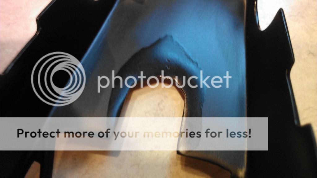

NJJeff Posted July 15, 2014 Author Posted July 15, 2014 It's a Competition Resins body. I've used rwo others in the past with no issues like this. Here's where it gets really ugly. After my success with the underside, I masked it off, primered and painted the topside. It came out great. There's a pic on thworkbench forum under War Eagle WIP. I went to bed a happy camper. This morning when I checked it, all the gooey spots had returned on both sides.....so after briefly contemplating stomping on it, I left it on the porch to cure when I went to work. When I got home, there was no change. Still tacky (like masking tape) everywhere I had agressively removed material. I sighed, gave it a swim in lacquer thinner, removed all the paint, scrubbed it , dried it and threw it overboard in fresh Bleche-White. Four hours later, I removed it, scrubbed it, wet sanded it with 2000 grit sandpaper, and dumped it back in the cleaner where it will remain until tomorrow night. I'll scrub it again, primer it and wait another day. If the issue returns, well, thats it, I'm done with it. I've already got about 20 hours into this body and that's too much. I sent Roger (Comp Resins) a note about my issue but havent heard back yet. I could put a firecracker under it, set it off, and glue what remains of the front clip on the chassis and viola', a blower explosion diorama... And thanks for the notes, its nice to have the support and help.
NJJeff Posted July 15, 2014 Author Posted July 15, 2014 Ok folks, thats it. I quit. 24 hour soak in Bleche-White, rinsed, scrubbed with dish detergent, then a 2 hour soak in Spray-Nine, rinsed, scrubbed, rinsed, and an isopropanol alcohol rinse. Primed, and painted. 2 hours later, the leaching returned in all the same spots. This body is unusable. I am extremely frustrated. I've absolutely wasted 20 plus hours on this body, plus the chassis was painted and detailed for this specific car..... I expect challenges and issues on every build but this is too much.

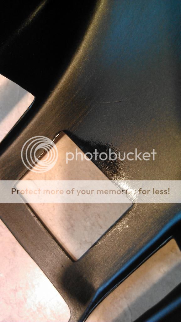

Chief Joseph Posted July 15, 2014 Posted July 15, 2014 When a resin part oozes or leaches, it's usually due to the two resin components not being mixed thoroughly or very out-of-date components. There's not a whole lot you can do about it. Sometimes... just sometimes... you can bake the piece in an oven at around 125-150 degrees F for a few hours and it will help the un-cured resin to solidify. If you ever get a part that is leaching an oily residue, don't bother trying to "fix" it. Immediately contact the maker and ask for a replacement part. If they are reputable, they'll replace the part or at least give you a refund. There really should be a "resin-caster seal of approval" or something because casting resin pieces isn't terribly difficult, but it does require attention to detail and a certain level of competency. Anybody who trades resin parts for money should at least know what they are doing and be willing to quickly resolve problems.
NJJeff Posted July 15, 2014 Author Posted July 15, 2014 Thanks Joe, I appreciate the info. Because I'm a glutton for punishment, I even restripped it, recleaned it and shot it with enamel. Same result. I'll try contacting the manufacturer again. My first note went unanswered.
robertburns Posted July 29, 2014 Posted July 29, 2014 When a resin part oozes or leaches, it's usually due to the two resin components not being mixed thoroughly or very out-of-date components. There's not a whole lot you can do about it. Sometimes... just sometimes... you can bake the piece in an oven at around 125-150 degrees F for a few hours and it will help the un-cured resin to solidify. If you ever get a part that is leaching an oily residue, don't bother trying to "fix" it. Immediately contact the maker and ask for a replacement part. If they are reputable, they'll replace the part or at least give you a refund. There really should be a "resin-caster seal of approval" or something because casting resin pieces isn't terribly difficult, but it does require attention to detail and a certain level of competency. Anybody who trades resin parts for money should at least know what they are doing and be willing to quickly resolve problems Joseph is correct, this happens when part A and B are not throughly mixed. The only way I have been able to stop it is by spraying it with automotive sealer. I can't remember the brand, since I don't do a whole lot of building any more. If you have an auto paint shop in your area, I recommend asking for the best sealer they have. If you can't use an airgun, then have them can it for you.
James2 Posted July 29, 2014 Posted July 29, 2014 Thanks Joe, I appreciate the info. Because I'm a glutton for punishment, I even restripped it, recleaned it and shot it with enamel. Same result. I'll try contacting the manufacturer again. My first note went unanswered. Trying to fix the problem is a waste of time and material, the source is defective resin. It just happens some times! Any good supplier would understand this and replace the piece in question upon request.
935k3 Posted July 29, 2014 Posted July 29, 2014 Before you give up try BIN Sealer as base/primer. Get at Home Depot
jbwelda Posted July 29, 2014 Posted July 29, 2014 if you could really and truly seal it off from any contact with air, it might arrest the problem. might being the key word. more likely it will act fine for a while, a few years maybe, but eventually it is going to show up again and/or the resin is going to get soft again. Unfortunately I don't think I would put any time into it at this point, anything you do is liable to get ruined later as it ages. Kind of a total waste probably. I am sure any reputable resin caster would replace it, or if that were not possible, refund your money or ask you to choose something else from their stock. jb
NJJeff Posted July 31, 2014 Author Posted July 31, 2014 Update 7/30: Kudos to Roger at Competition Resins who promptly responded to my email regarding the issues I was having with the resin body. He shipped a replacement at no cost to me which arrived in less than a week. I cleaned, prepped, primed and painted it with no issues. I think James is correct. I don't think a bad casting can be salvaged. I tried everything I could think of but nothing helped. All I did was waste time and a lot of paint. Thanks to all for your thoughts and suggestions. Another lesson learnedalong the way.
