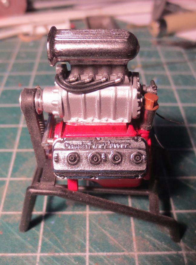

A bit more done this weekend and the major holdup was the Reath fuel pump which mounts to the back of the blower. Made one out of a piece of spruce and shaped on my Dremel. Added Scale Hardware rivets for the detail. Also prepared the magneto. Had one ready for install but I'll be danged if I can find it. Had to source another one from the parts box.
Here's the magneto and fuel pump.
Also got the injector plumbing done by using RB Motion stainless steel tubing, piano wire and some thin black wire insulation.

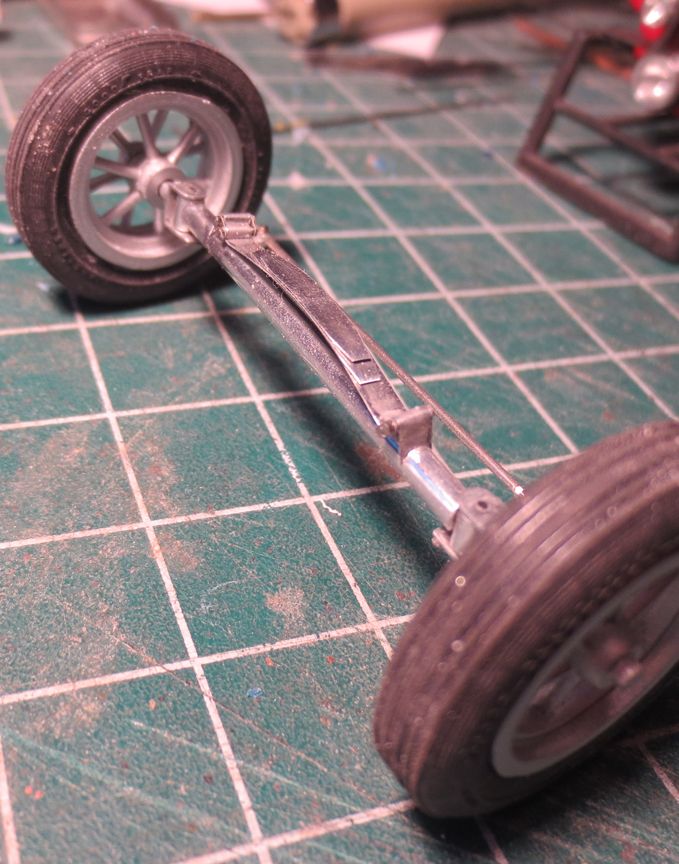

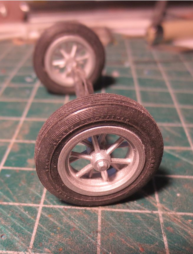

Also had to flatten the front leaf spring since the car sat too high. Got the rims painted and mounted the tires so the front end is complete. The radius arms will be fun.
Here's a couple of pics.

Thanks Gene. The front wheels are from the parts box and I'm not certain where they're from. I DO know they are not from the DDragster kit as those have thicker spokes and larger diameter hubs. I think they're from the '57 Ford gasser kit but not certain.
Thanks Chris. Yes, I'm glad I've been able to get some bench time in and glad I'm getting closer to the finish line.

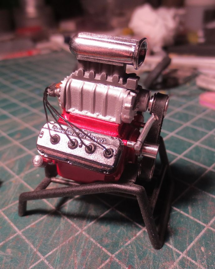

The chassis got its final coat of Tamiya SemiGloss Black this morning before work. Wired up the right side plugs last night although nothing's glued yet. I inserted a piece of black wire insulation in the plug holes in the valve covers then inserted the actual plug wires.

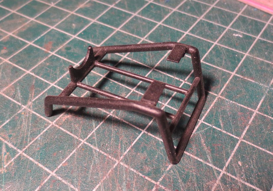

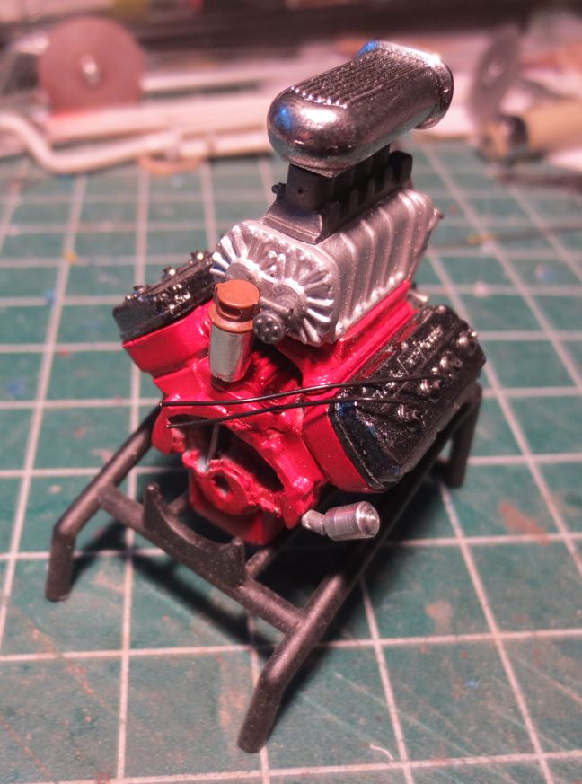

Here's a pic of the enhanced engine stand. It was in a couple of pieces when I got it so it needed some strengthening. I used aluminum tubing and also lengthened the tabs that hold the front part of the engine block.

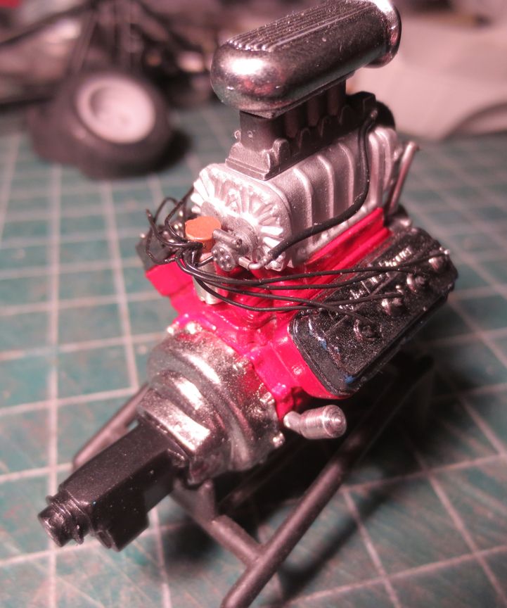

A bit more work done on the engine with the bell housing shot with Alclad. So now the bell housing and the tranny are glued on. Finished wiring up the plugs and added a fuel line to the injector distribution block from the rear mounted Reath fuel pump. Just had to put a mock up together for a picture.
Here's one of the engine showing the rear mounted fuel pump. It was scratch built and the 'rivets' are actually Scale Hardware rivets that were shortened.

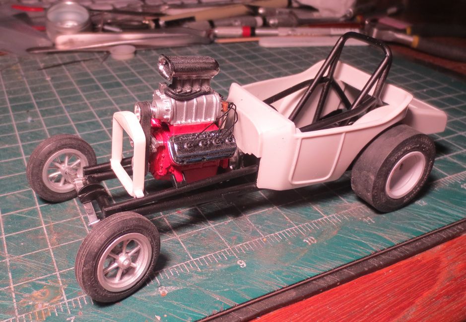

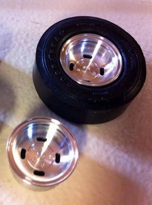

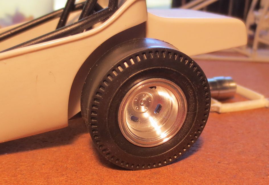

Thanks for the comments Gene, Chris and Russ. I really need to get back to work on this. A few of the posts are missing since the last time I worked on this. I ordered some turned aluminum rims from Jim at MicroNitro since I had an order in with him for rims for my sprint car. The rim have come in an here's a few pictures.
This first one is from Jim. The second one shows them in place.
I had to switch slicks since the new rims are a bit smaller in diameter. Still need scuffing up.

Now that the holidays are over, I finally put this back on my work bench. Worked a bit on the front axle by taking the twist out of the leaf spring. Much better. Now I need to make the radius arms and thankfully, my wife got me a new soldering gun for Christmas. If you noticed, the arms have the letter 'W' in them and I've thought along I need to make these out of brass. I need to get some practice time in with the soldering gun. Stay tuned.
