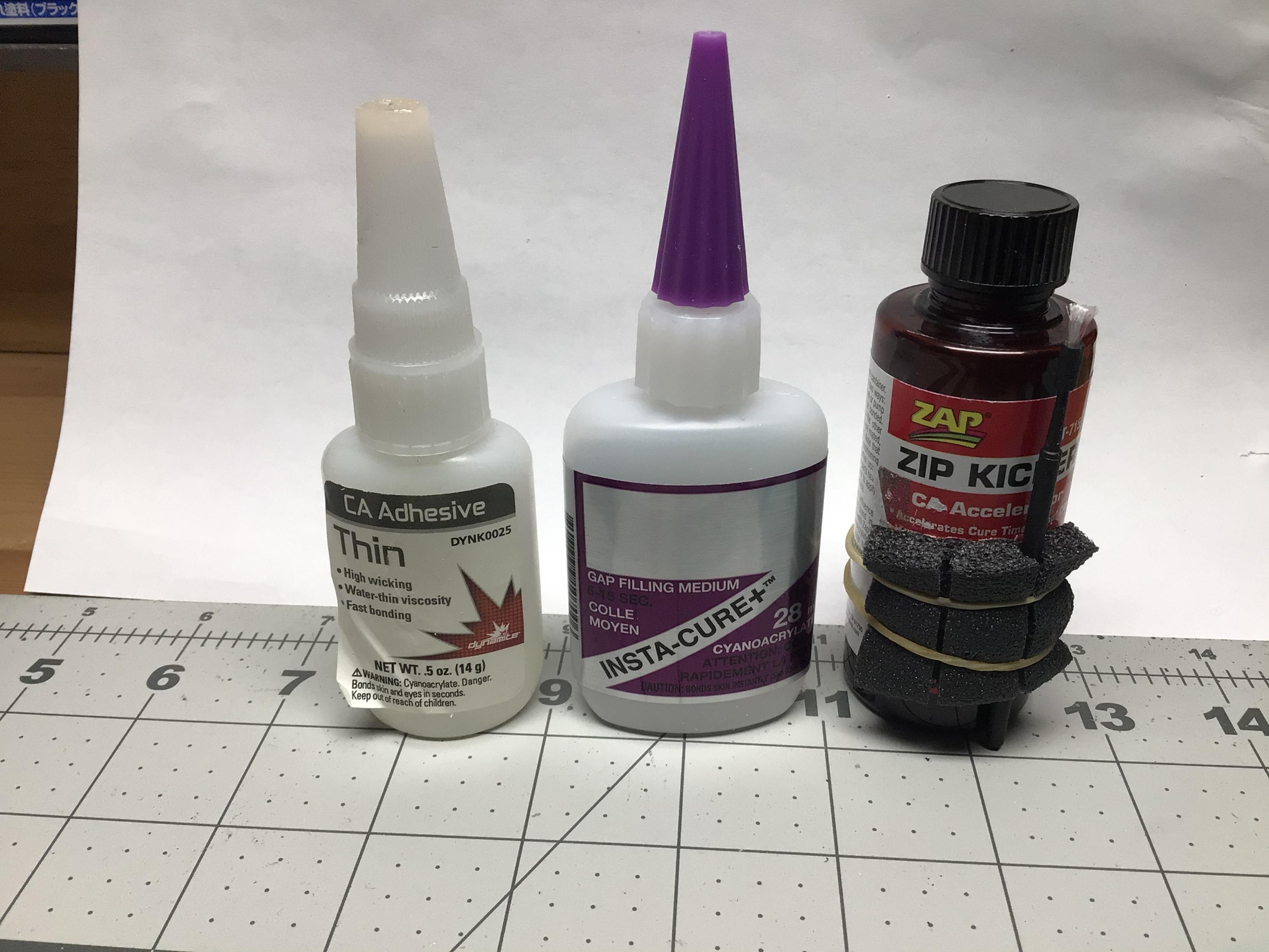

NOBLNG Posted November 17, 2020 Posted November 17, 2020 Does the CA or the accelerator ever go bad? Sometimes even with the kicker things don’t want to stick (mainly when I am glueing sprue onto items to be painted). I am wondering if the stuff I have is light sensitive since it’s in a brown bottle. I would like to transfer it into an empty Tamiya paint jar since I have tipped this bottle over once and nearly done it a couple other times.
peteski Posted November 18, 2020 Posted November 18, 2020 I use the BSI brand accelerator and mine is at least 10 years old - works as well is it did on day one. I prefer that brand because unlike Zip Kicker is not acetone-based, so it does not attack styrene and most paints. You mentioned "sometimes"? Are you sure the parts you are gluing are really clean? Also, the accelerator works the fastest on the thin CA, and slower the thicker the CA is. With extra thick or gel type (slower setting stuff) I have to actually mix the accelerator in to get the CA to fully cure (and it takes some time). But the water-thin CA sets in seconds afteradding just a tiny bit of accelerator.
