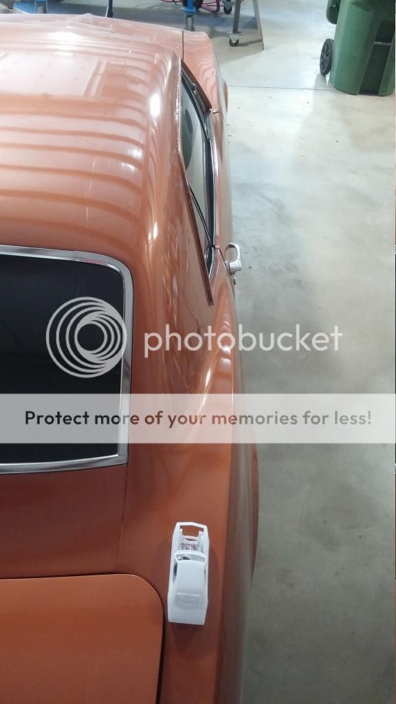

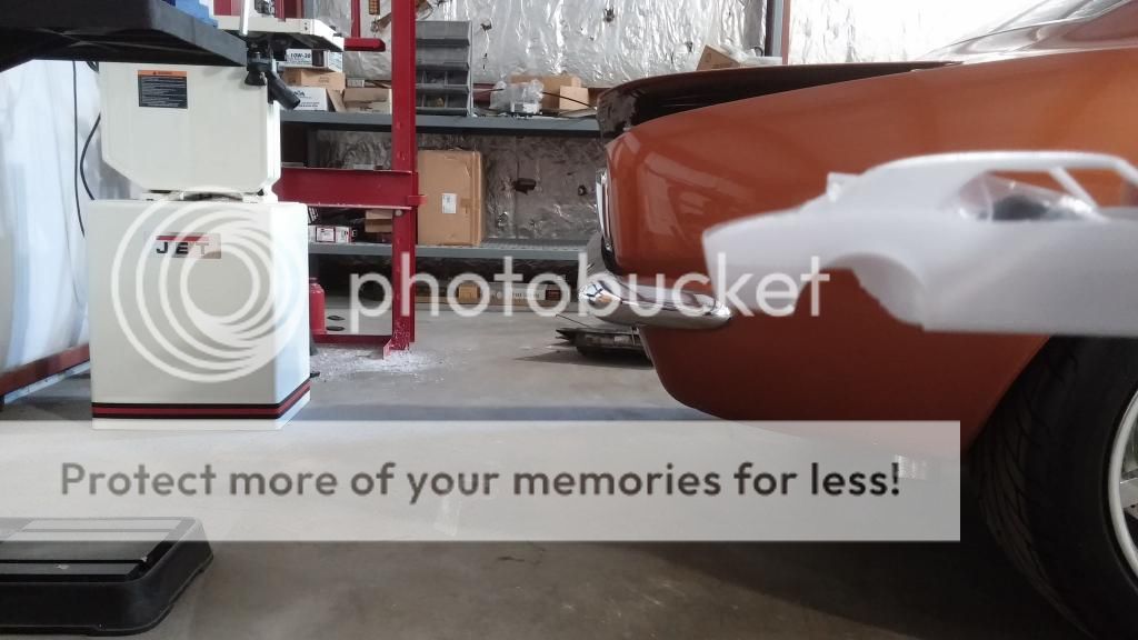

it looks worse in person, the side shape is wrong to, the quarters dont bulge enough in front of the wheel well they just seem to taper in hard on the kit. camaro's make up a LARGE portion of my business, I am very disappointed in this kit. hers a shot of the side profile. yes I know I suck as a camara man and I only use my phone but I think the detail gets through.

your spot on about the nova tail, and the tail lights are to big in every direction on the camaro by the eyeball test, I believe the quarters taper in to much as well making that problem look worse than it is. I love this country but I really wish revell of germany or tamiya would do some old muscle.

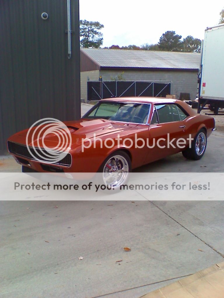

BTW, Turbo, what's the color on that real '67 in your photos? I don't think it's a factory color, is it? Whatever it is, it's pretty.

yep most firechicken parts are identical, I have one of them in the shop as well an I agree that kit is pretty decent. the camaro is a late model corvette burn orange, did it a few years ago, it's back to get a new clutch. pic of car then. imagejpeg_2_zps8ff4677d.jpg
lol most of the cars I build have brakes that big in the front now, that one has 18's to clear 13" brakes. the pro touring thing is 90% of work anymore, pays the bills. combo is a Dart based 540 with a 5 speed.
