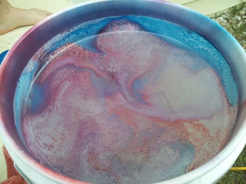

Andy, I think what you're referring to is what Hank Borger called "swirladelic". Basically, it involved a container of water that was deep enough to submerge the body of a car model and at least two colors of spray paint. You paint the body with a base color and allow it to dry. Then, you immerse the body, which should be mounted on a wire hanger or something similar, rocker panels down (but there's another school of thought here). Spray the paint from the other can onto the surface of the water. It will float and make some interesting patterns. I don't remember how to judge when to do so, but at some point after spraying the paitn, you slowly raise the body and lift it out of the water. When that application dries, hit it with a coat of clear. Please keep in mind that I'm writing this from memory of an article that I first read about 44 years ago, so it might not be exactly correct.
That's pretty much it. You can spray one or two colors on the surface of the water, but obviously this is a completely hit-or-miss process... there's no way to really control what you get. Even if you see a cool looking swirl pattern in the paint, when that paint transfers to the 3-dimensional body, it will change. In most cases what you get is just a drab, dull mess. But you can get lucky and get some cool effects. Just not usually...

I used that system back 1971 or so. The model mags of the time called it 'Psycho Swirl'. We applied a semi flat white base coat....then submerged the model in a bucket of water.....sprayed the colors wanted in the water surface.....make a pattern or not......pull the model, nose first, up through the paint. It does go on like a decal....as you may need to blot out some trapped water. Fun....but hard to maintain control or scale.
What your talking about Dave, is not the Hydragraphifics shown in the two videos above. Your back to what Harry was talking about. This Hydrographifics is not what I saw in magazines back in the early 70's. Never tried the 'Psyco Swirl'/"swiradelic" thing you, Harry, and Andy were talking about. But, I've thought about trying it several times over the years. Hydragraphic is simular and different at same time.
