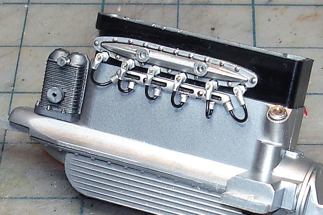

I'm starting the engine detailing. Block was sprayed silver, then Testors Transparent Black Window Tint, cylinder head brush painted satin black. The intake manifold was sprayed silver and then blackwashed with my Future/black acrylic wash. Spark plugs are scratchbuilt... the hex nut part is slices of hex-shaped styrene rod painted silver, the insulator is aluminum tube painted white, and the electrode is brass wire. The connectors are made by crimping aluminum tube flat and drilling a hole to slip over the electrode, then that flat end filed round, and finally the piece cut off from the aluminum tubing. I'll probably add "rubber" boots over the connectors made out of 5-minute epoxy and painted flat black.
The lower wiring manifold had to have the missing "lugs" added to it (styrene tubing). Wow... it's tough to do this kind of work at such a tiny scale! It's hard enough in 1/8... working with parts only half that size is a challenge.

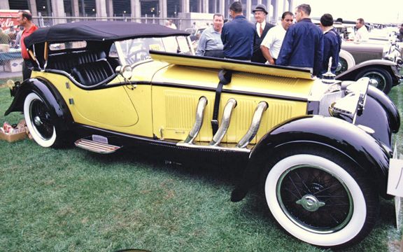

Hey, it's always good to plan ahead! That's pretty sharp... I was thinking maybe a few shades lighter on that green though.
EDIT: Looked at a few cars on the good ol' Google and found these.
These are truly beautiful cars.
You have my undying respect. Those ally tube terminal ends kicked my butt. :angry: But I had to do 12 of 'em. I'm surprised 1/16" tube still looks scale in 1/16 scale. They look tiny in 1/8... :wacko:

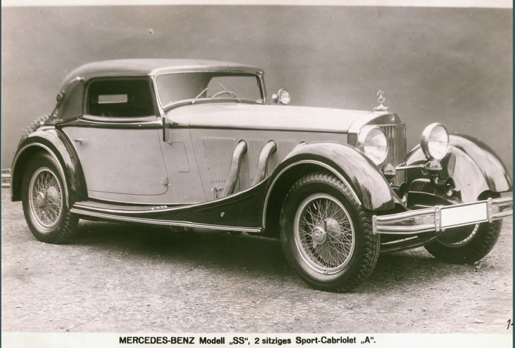

Also in Harry's defense, this factory photo doesn't show those wheel weight thingies either (though the car probably hadn't been driven very far). The details of this shot overall are closer to the kit than any other photo I've found. The kit left out two details that seem common to most SS 2-seat cabriolets, and that is the decorative grille guard and the storage doors on the running boards. Running boards were special order options. Of course, the whole car was usually made to order by the Sonderwagen (Special Vehicles) works at the Sindelfingen plant, though there were standard catalog versions, which this appears to be.

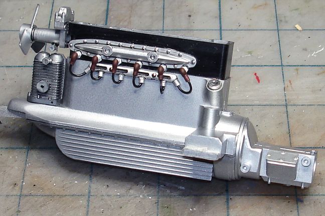

I made the spark plug boots by adding a little blob of 5-minute epoxy onto the connectors to give them a rounded look, then painted them to match reference photos:
So you actually mixed 6 separate 'little blobs' of 5-Minute? Did you thin it with anything?
Edited by Cato
No. Just mixed some up epoxy on a piece of plastic and then applied a little blob to each terminal with a toothpick to give it that "rounded" look. The epoxy forms a perfect little sphere once you touch the tip of the toothpick to the piece and transfer that little blob into place. The trick is to make all six of the blobs the same size!

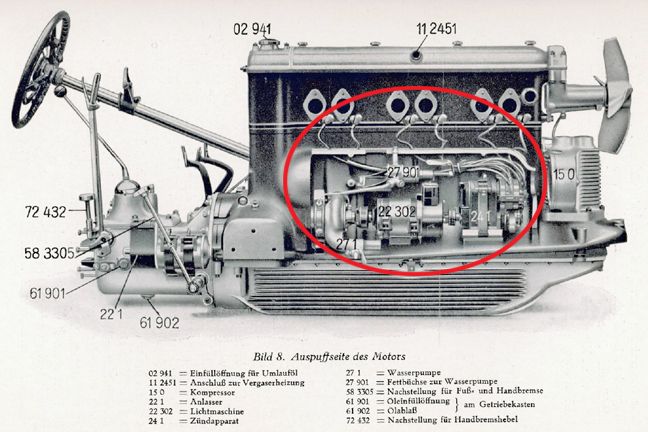

Here's something weird. All of the right side engine details seen here are missing from the kit. The only details included for the right side of the engine are the exhaust manifolds. :blink:
Also, of all the engine photos I have, there are only two that I can find of the right side of the engine. Weird. I guess the intake side was a lot more interesting to everyone! :lol:
Ok, now I see what's going on. Apparently there was some sort of rounded cover that hid all of those components; all that was really visible on the right side were the exhaust manifolds. Great! Less work for me then... :D
The engine block has an outer shell that contains all that stuff you don't have to mess with. However, the kit does not indicate the access doors. You can see that at the Fine Art SS Tourer link.

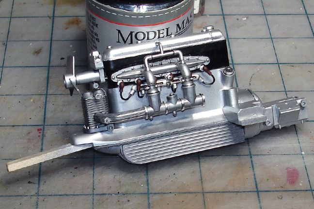

In your earlier post, the tube that connects the intakes to the valve cover should be either black or wrapped in asbestos.
