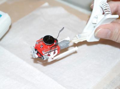

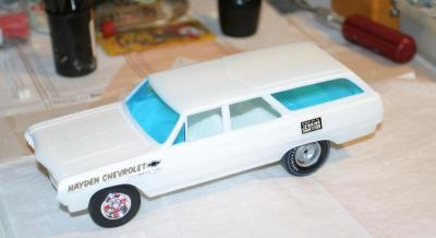

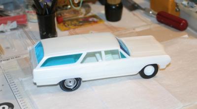

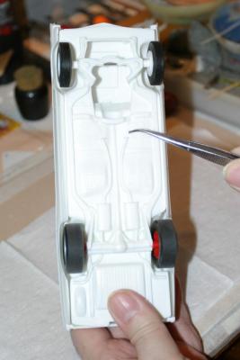

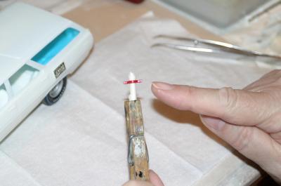

AC Norton Posted January 2, 2015 Posted January 2, 2015 (edited) hello and a happy new year, started the amt 65 chevelle wagon last week. yes, I know,...this old kit has a million pitfalls and problems...the chassis stinks, the axle runs thru the block, the tires are too black, the box is too square....bla bla bla....however it may be fun to have something one has never built before...and if you like junior stockers from the 60s era as I do, maybe a neat little build, even if its a low tech piece by todays standards. anyhow, I posted a few pics of the completed engine, my drive shaft loop, the chassis with the front areas of the pipes removed.....remember, in that era the stock exhaust still had to be present, even though not hooked up. also a mock up of a possible wheel/tire combo....open steel wheels up front...or, the Keystones up front and the silver steel rims on the rears...tell us what you think. be a couple of weeks before this may be done, but I will try to keep anyone interested updated with pics of some progress.....thanks for looking... and any input from our esteemed forum members is certainly welcome.........the ace........ Edited December 6, 2016 by AC Norton pics
AC Norton Posted January 2, 2015 Author Posted January 2, 2015 ....forgot to mention one thing...the blue tinted glass is shown for mock up only...the clear glass is more typical for this piece, and will appear in the completion of this car...thanks, the ace...
fun9c1 Posted January 2, 2015 Posted January 2, 2015 Cool. I'll be watching. I have this kit- haven't opened it yet. On the wheels- I'm a big fan of steelies. I have them on two of my 1:1 cars, body color. I wish they came in every kit. I also like steelies on back with mags on front for cars that see a bit of 1/4 mile action.

Snake45 Posted January 2, 2015 Posted January 2, 2015 Great project! Last year I finished up one of these (started several years ago) as a lower Modified Production, which isn't really all that far from your Junior Stocker. (I think you saw it and commented on it.) All things considered, it was a really fun build. Have you tried putting the engine in the chassis with those headers attached? I found I had to file MAJOR clearance notches in the A-arms to get the engine in (the kit instructions would have you add the headers after the engine is in the chassis). If you want a better chassis, you could use one from the Revell '65 Chevelle or their '66 Chevelle wagon. (You'd have to add the inner fenders if you did this.) Have fun with this and keep us posted on progress! I LOVE projects of this type!

Tom Geiger Posted January 2, 2015 Posted January 2, 2015 The other direction would be to buy a Revell 1966 Chevelle wagon kit and use the more modern chassis and bits on your '65. Many years ago I started one of these wagons and used a Revell Chevelle coupe chassis under it to add full detail.
AC Norton Posted January 2, 2015 Author Posted January 2, 2015 a couple of you mention the chassis swap idea... I am well aware that this can be built with upgraded items from another kit, however, at 25-30 bucks a pop to buy a donor model, detailing mine with paint and such will be just fine for a shelf model. the exhaust system , as I mentioned in my text, will be detailed by painting, as stockers and super stockers up to and including the 1970 season, had to have that factory equipment present, though not functional, so using the kit chassis works for me.....the ace........
AC Norton Posted January 2, 2015 Author Posted January 2, 2015 ....just read your question re. the headers, Snake. I installed flanges on the headers for better appearance and better, tighter attachment to the heads. once installed, the complete engine assembly slips nicely into place with the minimum of adjustment . I only had to slightly sand the A arms inside with some 600 grit dry paper to achieve final fit. good question posed by you, as I think that without a little dipsy doodling in this regard, those headers would be a nightmare to fit in correctly.......the ace.....
dragcarz Posted January 5, 2015 Posted January 5, 2015 Love it so far . I'm a fan of junior stockers myself, I'm a proponent of mag wheels on front and stealies on the rear. If I remember corectly( I'm old) a fad in the 60s was blue tinted windows.
AC Norton Posted January 5, 2015 Author Posted January 5, 2015 true enough, roger, the blue tinted glass, as well as other colors seemed to be popular in the 60s era, but I think mostly in the gasser and altered classes. as tempting as the blue tint in this kit is to use, I will go with the clear in this build, to show the interior, and, it seems more common in the stocker classes. thanks for your comments...the ace...
