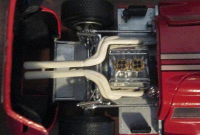

Cato Posted January 24, 2015 Posted January 24, 2015 All of the small scale 427's are junk. They are blobs and lumps of cheesy old tooling with poor proportions. If accuracy is important to you, you need good photos easily available on the web so you can modify what you have. It will show in the back of a GT. The best of the poor lot is Trumpeter's 1/12 from their MK II - and only because it's bigger and more easily corrected. You'll need good accurate pics of the distributor, water pump, fuel pump, coil and intake. Here's my Sideoiler; pay attention to the distinctive exposed exhaust ports and the angle of the plugs inserted in each bank. The coil correctly bolts to the left head face - a detail always overlooked but very visible. And the original plug wires were only 7mm - don't put thick wiring on it anywhere. Fuel line should be 3/8" hardline; braided is only seen on restored cars of today: Finally, here's my Trump MK II's engine; forget everything below the exhaust ports - you won't see it.
