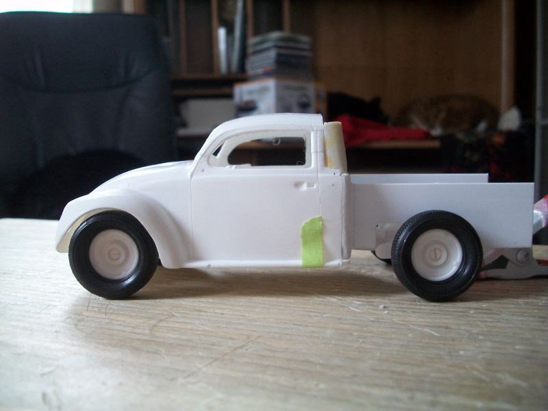

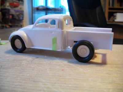

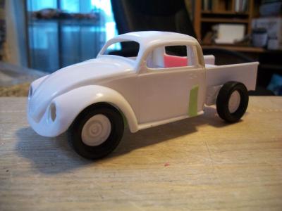

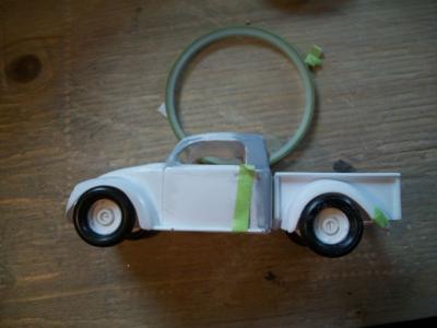

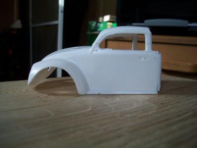

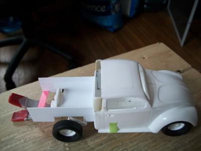

restoman Posted March 1, 2015 Author Posted March 1, 2015 Back at it this morning... Took 6mm out for the chop, not too radical but I like it. Works out to a scale of roughly 2.5 inches. A lot tougher to do the upper cab corners. I thought i had an old truck cab but it's nowhere to be found so I'm piecing it together a bit at a time. Going to take some file and filler work... I'm undecided yet whether or not I'll run a drip rail around the back of the cab or stop it at the door edges and slope the rear roof right into the back panel... depends on what I can come up with out of the parts box. The box is coming along nicely, pretty happy with it so far.

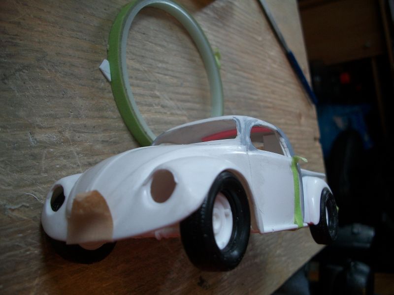

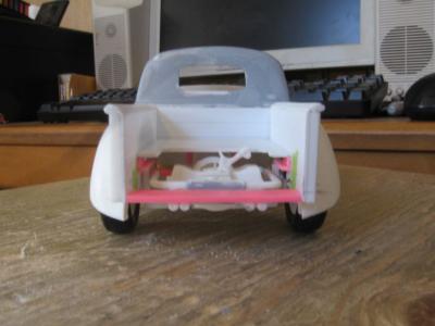

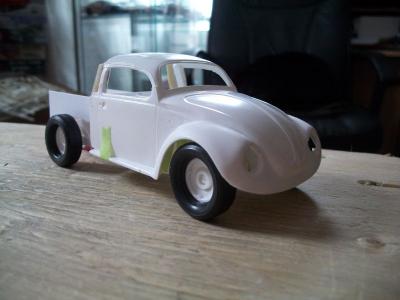

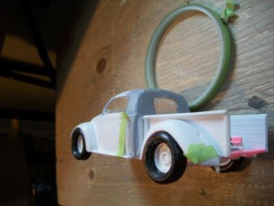

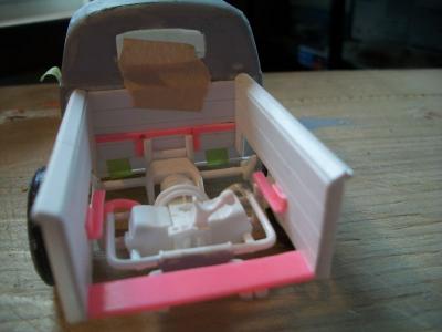

restoman Posted March 3, 2015 Author Posted March 3, 2015 Got the cab roughed in - tricky, finding pieces with the right curves... decided to eliminate the rain gutter completely. I kinda like the rounded-over look. Got the box dry fitted and the mounts in place. That took some fiddling around... now to get the fenders widened and finish off the running boards. Still thinking about the tailgate... Thoughts? Comments?

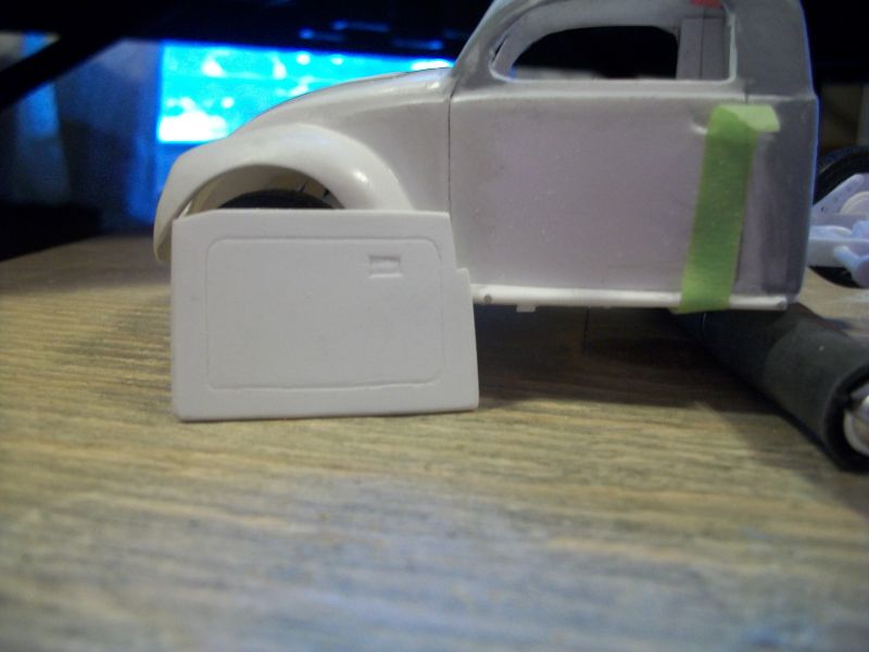

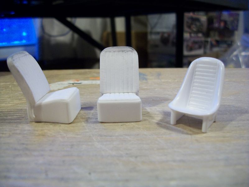

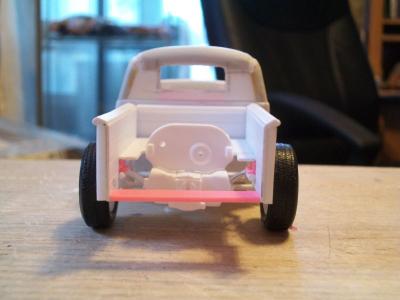

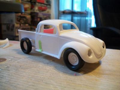

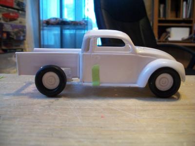

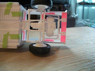

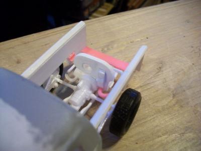

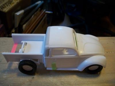

restoman Posted March 10, 2015 Author Posted March 10, 2015 Lots of tiddly-assed stuff... The engine detail is pretty chintzy. Added some plastic to the fan shroud and cut an opening for the fan - it'll be visible now that the back half of the Bug body is gone. Also made an oil cooler and added some front head pipes for the exhaust - some trimming yet to do on the pipes, they look a little too fat. I had to mock up most of the engine to fit the box and mounts in... Decided to use the stock seats instead of those goofy bucket things. Lowered the seat cushion and chopped the high seat back to better fit under the chopped roof. First attempt at a door panel... my eyes aren't near as good as they used to be... Re-did the box mounts, much better this go round... Added a chunk of plastic to the rear fender and put in a flange for mounting. I think I'll have to add some pins so it goes on where it's supposed to go. Mocked up and looks half decent. Not wild about the tire width. I don't have anything narrower so i'll have to modify the inner rims to bring the tires inboard front and rear.
Tom Geiger Posted March 10, 2015 Posted March 10, 2015 I love the work you have into this project. Seat wise, I'd suggest a bench seat with an arm rest? That would be cool since being a pickup instead of a Beetle, there's no need for the seat to fold to let passengers in the back. I used the back seat from the AMT '53 Studebaker as a pickup bench seat once, after making sides and a back for it.
DumpyDan Posted March 10, 2015 Posted March 10, 2015 Very Cool, must be something in the air, I have done 2 VW this year
restoman Posted March 10, 2015 Author Posted March 10, 2015 I love the work you have into this project. Seat wise, I'd suggest a bench seat with an arm rest? That would be cool since being a pickup instead of a Beetle, there's no need for the seat to fold to let passengers in the back. I used the back seat from the AMT '53 Studebaker as a pickup bench seat once, after making sides and a back for it. Thought about that... a bench would look good in there. I didn't have anything I was willing to cut up and the kit seats seemed to be the easiest route. I got lazy...
Tom Geiger Posted March 11, 2015 Posted March 11, 2015 (edited) Thought about that... a bench would look good in there. I didn't have anything I was willing to cut up and the kit seats seemed to be the easiest route. I got lazy... Look through your junk box for car back seats, I've even cut them out of tubs. I have had good luck adding plastic for sides and a back for pickup bench seats. Edited March 11, 2015 by Tom Geiger

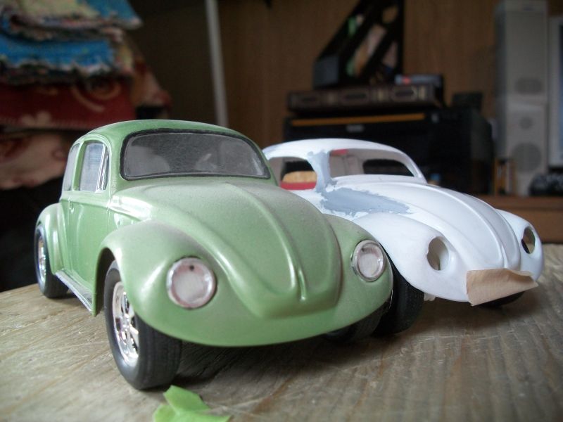

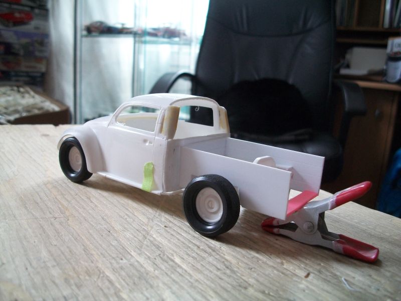

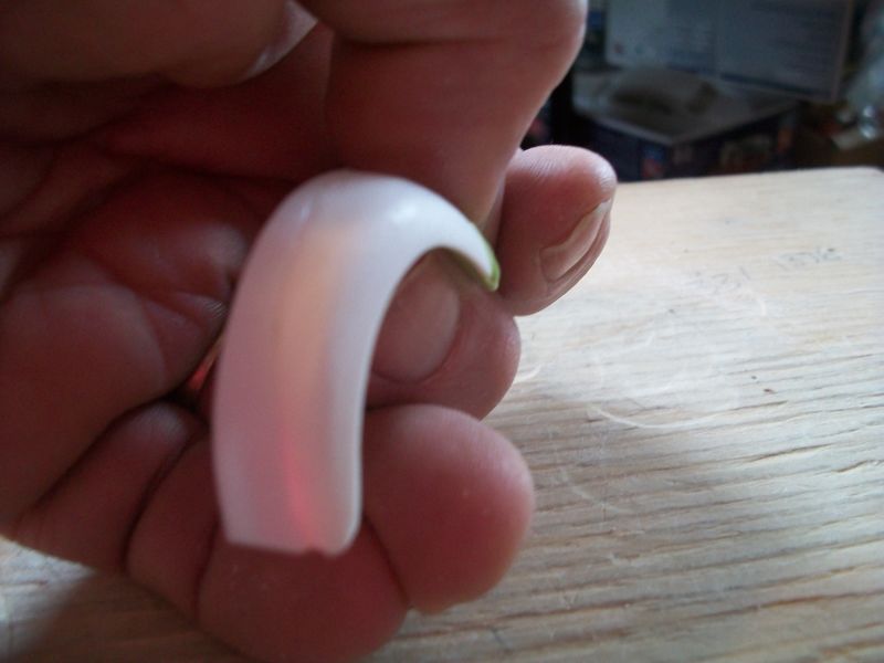

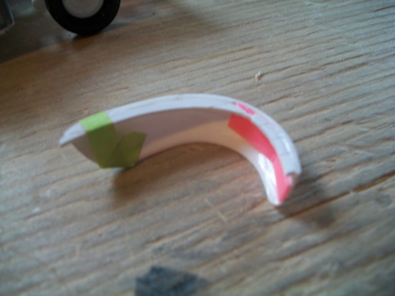

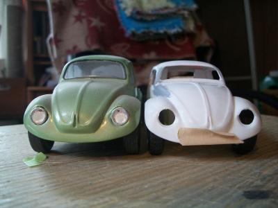

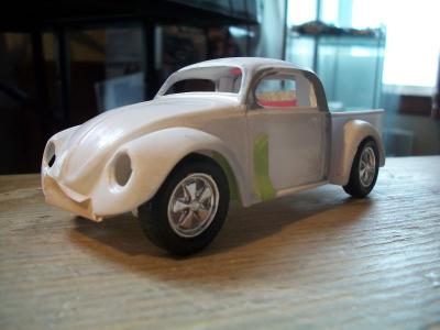

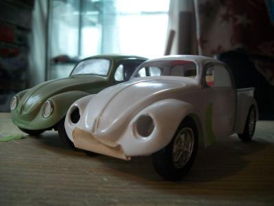

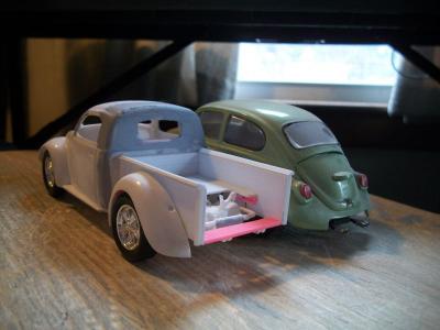

restoman Posted March 16, 2015 Author Posted March 16, 2015 Narrowed the front and rear wheel track a bit, to tuck the tires in a little. Roughed out the rear fender, pinned it so it can come off and on (doing a lot of that on this build...), extended the box side down to the running board, filled in the running board. The trick is to get the running board tight to the fender, as they are not connected. Fab'd a tailgate... drilling it for hinge pins will be fun! I Posed it next to an older build of the same kit to get an idea of how it would look next to a stock car. I like it!
bobthehobbyguy Posted March 16, 2015 Posted March 16, 2015 Nice work. Great job on the conversion to a pickup. Looking forward to see more..
wayne swayze Posted March 16, 2015 Posted March 16, 2015 Looks great! You're doing a fine job on this!

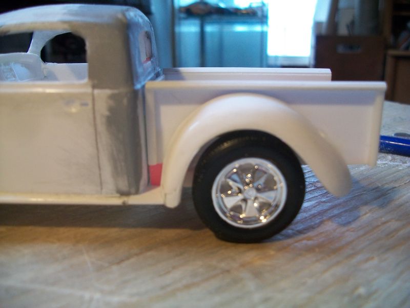

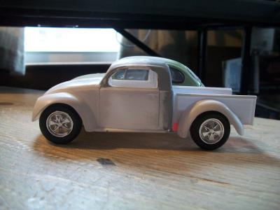

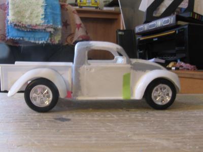

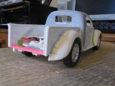

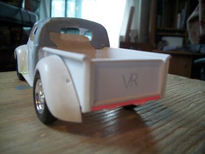

restoman Posted March 19, 2015 Author Posted March 19, 2015 ... and then there were two. Rear fenders, that is.
Snake45 Posted March 20, 2015 Posted March 20, 2015 Very, VERY nice! I like it! If I were doing it, I'd go with some simple semicircular rear fenders, and I'd shorten the bed a bit. But hey, it's your model--and you're inspiring me to finally getting around to building my own.
