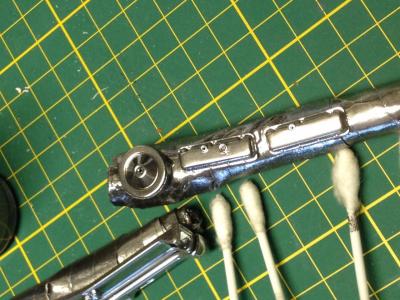

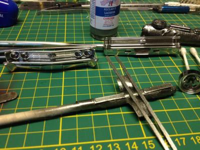

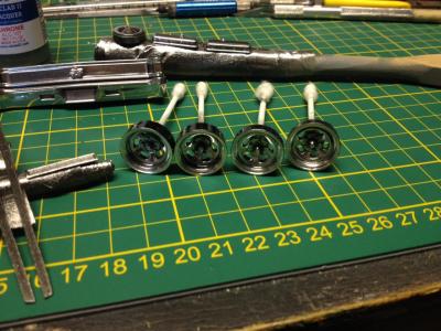

Okay first use of it and I gotta say I am impressed. I think I did get a little much on the front bumper, as I was trying to do a pass from each side and from the bottom then the top to cover all the angles and nooks in the part. But I am pleased with the finish.
post-15265-0-17764900-1425710762_thumb.jpost-15265-0-59261100-1425710831_thumb.jpost-15265-0-29088200-1425710856_thumb.j

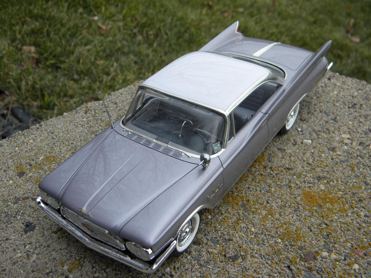

the first two aren't entirely true. You can spray over any color, with or without clear. It's the smoothness that is the most critical. I also spray at a higher psi, like 25is.The more sever of an angle, the better shine you will get. I actually try and spray across the surface as much as possible.
Here is my WIP showing some results

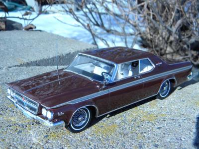

I've tried spraying Alclad over several different kinds of black paint & have just settled on using Duplicolor black in a spray can. I've had a couple of funny reactions with spraying over Testors gloss black & Krylon. Mind you, I'm not spraying bumpers & the like. Mostly just small parts like mirrors, engine parts, etc. so I really don't care if it's perfect. If you're spraying small parts, just a coat of primer, a coat of Duplicolor gloss black & then a light coat of Alclad will give you fine results. The outside & inside mirrors & antennas on both of these Chryslers were done in this way. Works for me. :P
Steve
post-13791-0-96407000-1427764493_thumb.j
post-13791-0-77040300-1427764542_thumb.j
