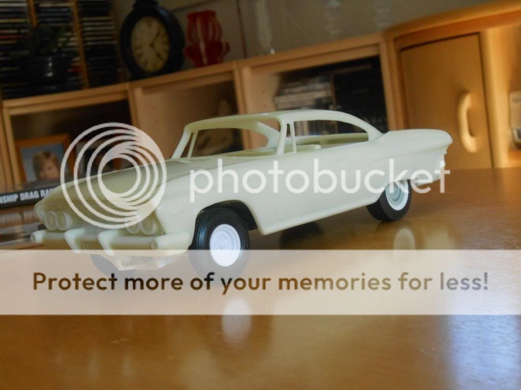

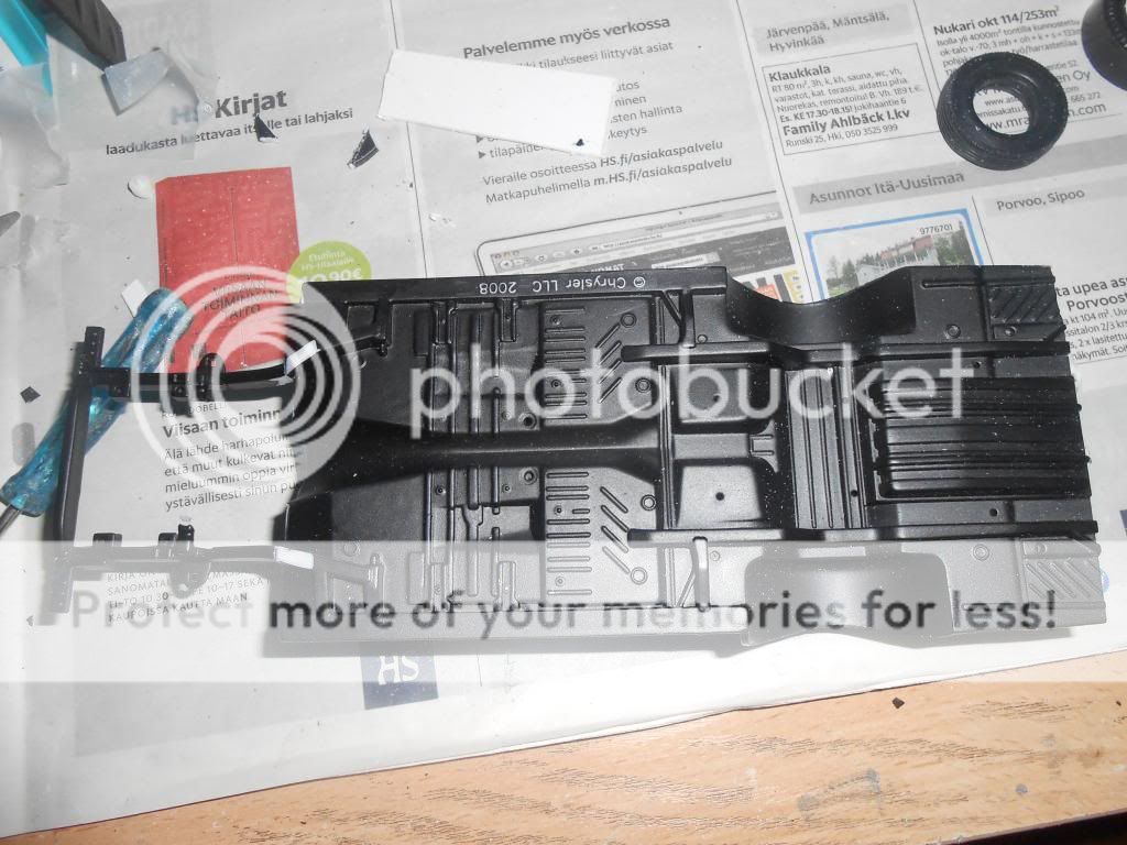

Ace-Garageguy Posted November 18, 2014 Share Posted November 18, 2014 (edited) Either the AMT or the Revell '57 chassis will work fine under your old Ford annuals. I bought several Revell '57s just to do the chassis swaps under AMT's opening-door version of the '57 Ford (doing a gasser and a retractable-hardtop). NOTE: AMT's '57 Ford chassis has the exhausts molded in, which drives me batty. The recent Revell chassis is beautifully detailed and has everything separate. You'll have to do some fitting, but nothing major. NOTE: '57 and '58 Fords used both 116" and 118" wheelbase chassis, depending on model. I don't recall right off hand which used which. so you MAY have to fiddle that a tad....but 2" in 1/25 scale is only .08" (a little more than 1/16"). A Mopar annual Johan '61 Dodge Phoenix got a '64 chassis from Lindberg on my bench. It also takes a little fitting, but it works beautifully. Here's the build thread. http://www.modelcarsmag.com/forums/index.php?showtopic=58538 Edited November 18, 2014 by Ace-Garageguy Quote Link to comment Share on other sites More sharing options...

W-409 Posted November 19, 2014 Share Posted November 19, 2014 A Mopar annual Johan '61 Dodge Phoenix got a '64 chassis from Lindberg on my bench. It also takes a little fitting, but it works beautifully. Here's the build thread. http://www.modelcarsmag.com/forums/index.php?showtopic=58538 I did the same thing on mine and it works great. That chassis fits almost perfectly under Jo-Han's '64 Dodge Polara too. Quote Link to comment Share on other sites More sharing options...

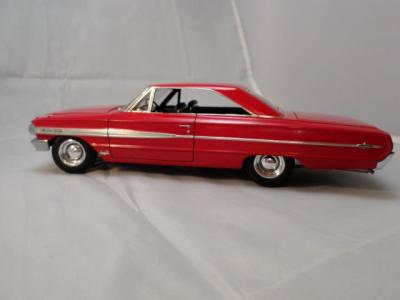

Modelbuilder Mark Posted November 20, 2014 Share Posted November 20, 2014 Not sure if it was officially an annual or not, but I did put a more modern Starliner chassis under a 64 Galaxy. Quote Link to comment Share on other sites More sharing options...
