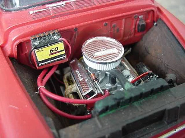

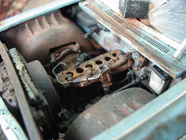

Tom Geiger Posted September 7, 2015 Posted September 7, 2015 Here's two of those diodes used as fuel filters. Preston didn't make those, they merely bought a big bag of diodes and packaged them. I got a bag of 20 or 50 many years ago at Radio Shack, aka a lifetime supply!
disabled modeler Posted September 7, 2015 Posted September 7, 2015 yep that is the ones I use Tom...they work very well.
