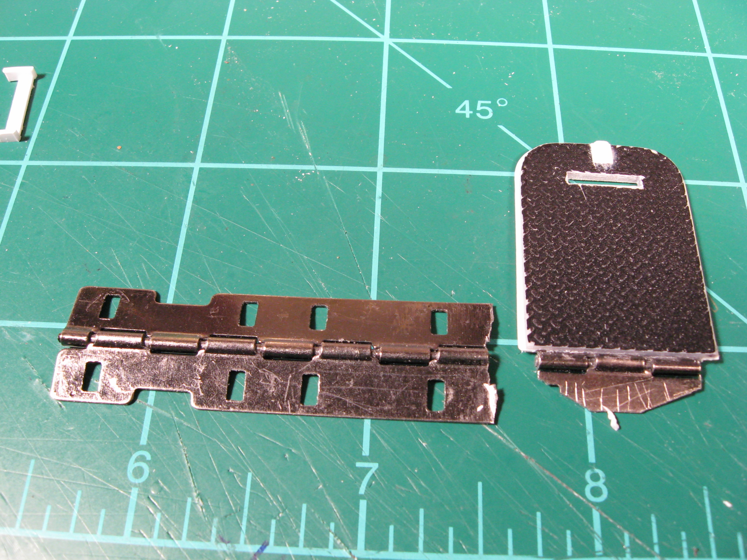

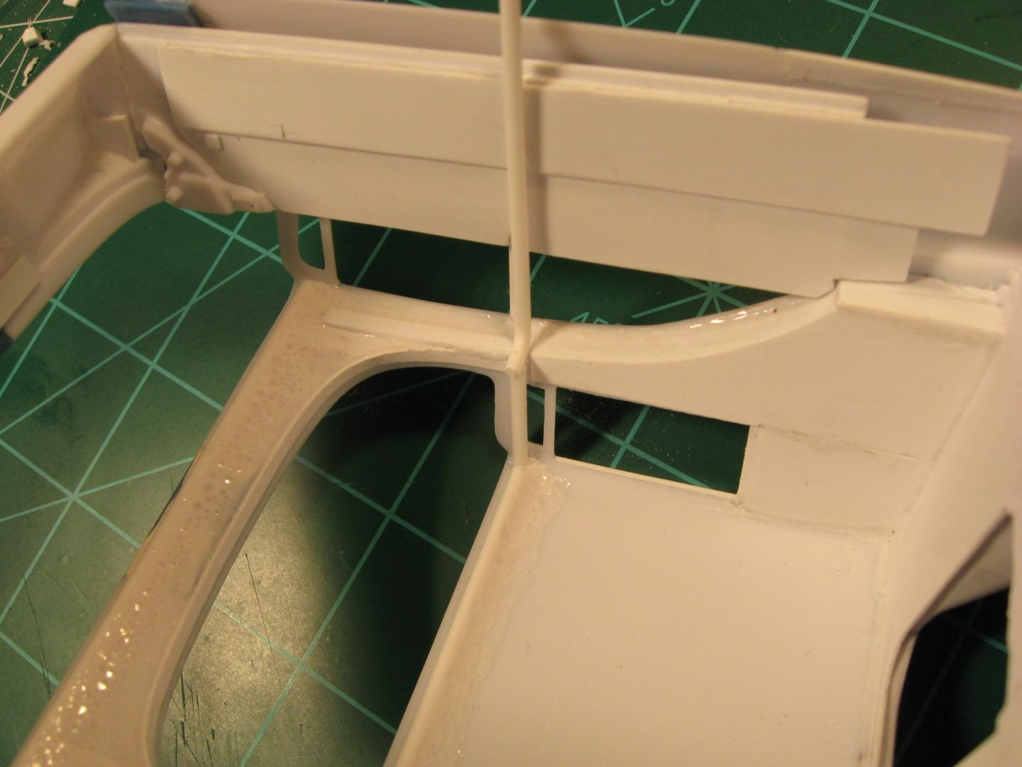

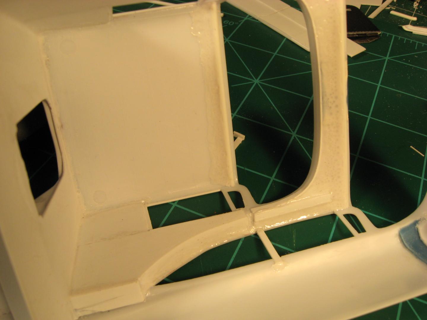

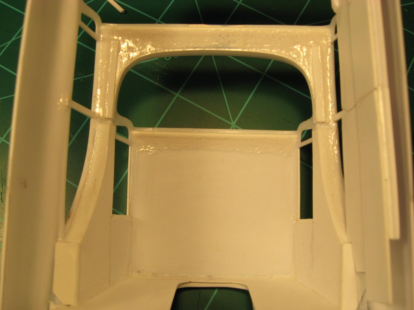

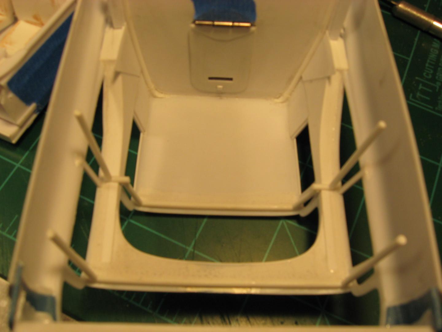

Ridge Rider Posted November 23, 2015 Author Share Posted November 23, 2015 (edited) Thanks guys. I am still building up the interior. The roll bars are incorporated into the ceiling so I started with that first. I also don't see a way of replicating the dash and lower door panels but would be interested in ideas for some kind unique look or finish. and trying to figure out the fit and look of the middle roll bar-still a work in progress. I did liberate a hinge from an old eyeglass case and finished the door. It is getting a little challenging again and I have a feeling I will be finding out what doesn't work much quicker than what does. Thanks for looking. Edited July 11, 2017 by Ridge Rider Quote Link to comment Share on other sites More sharing options...

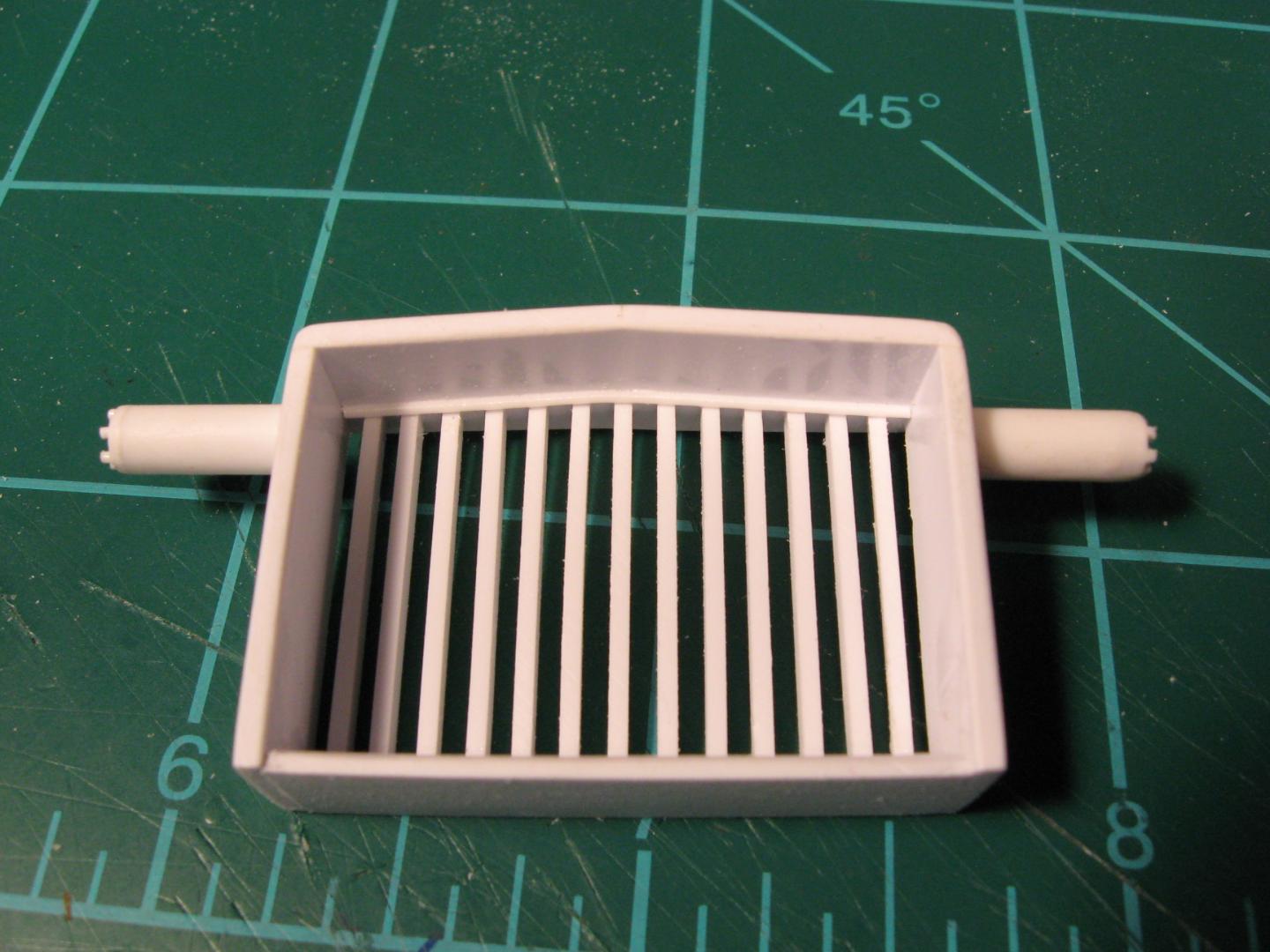

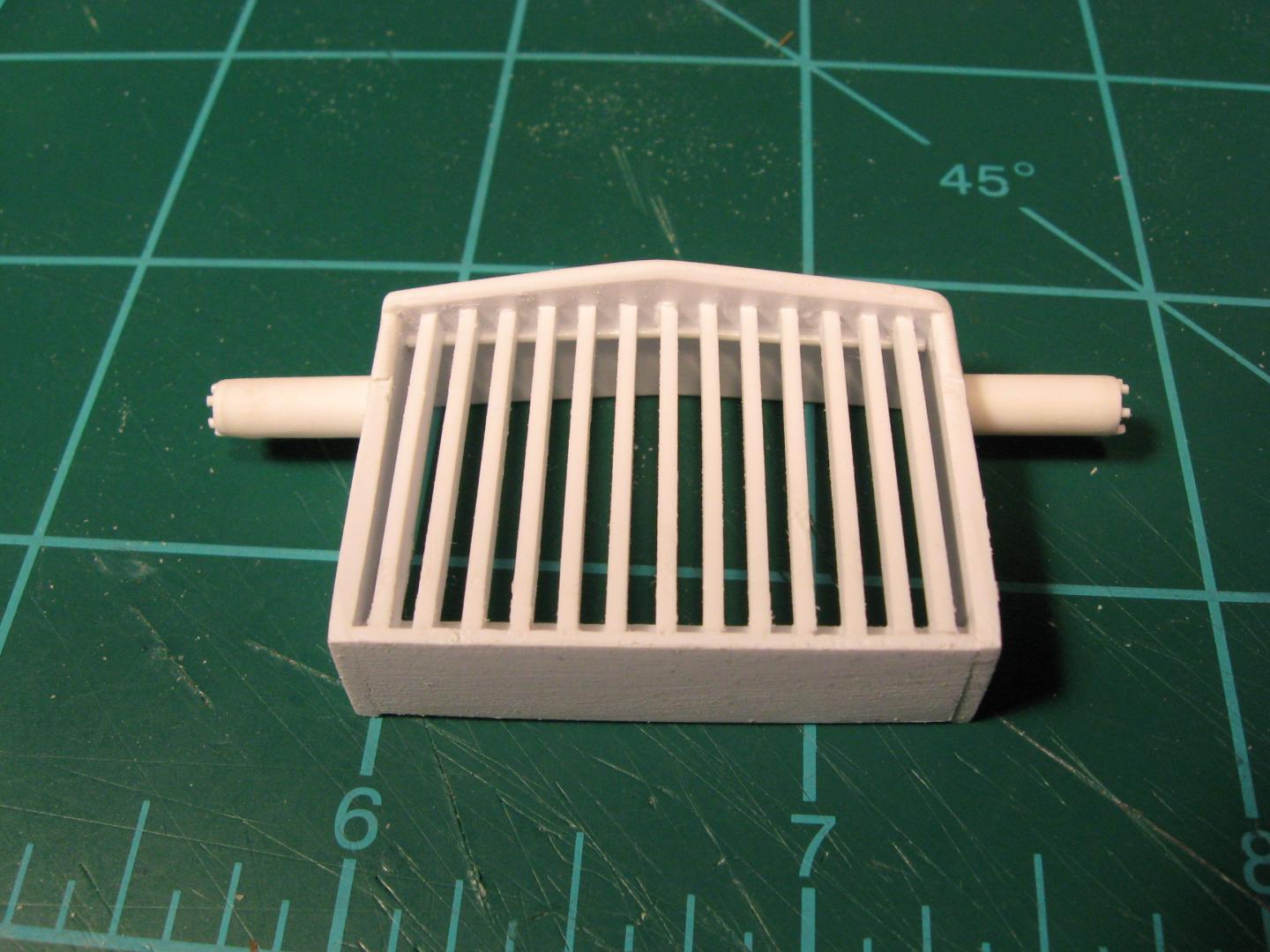

Ridge Rider Posted November 26, 2015 Author Share Posted November 26, 2015 (edited) Thanks for the ideas on the dash. Photo Etch would look the nicest but $ and resin casting emblems would probably age me prematurely and shelve this build. Dave's idea had me do a google search and I found an image to mess around with. It might work. The interior of the Gigahorse is coming along. When the interior was curing I worked on the radiator shroud. The frame is .060" sheet, the vertical bars are .040 x .080" strip spaced .060" with 5/32 tube added to the sides . Thanks for the help and for looking. Have a Happy Thanksgiving. Edited July 11, 2017 by Ridge Rider Quote Link to comment Share on other sites More sharing options...

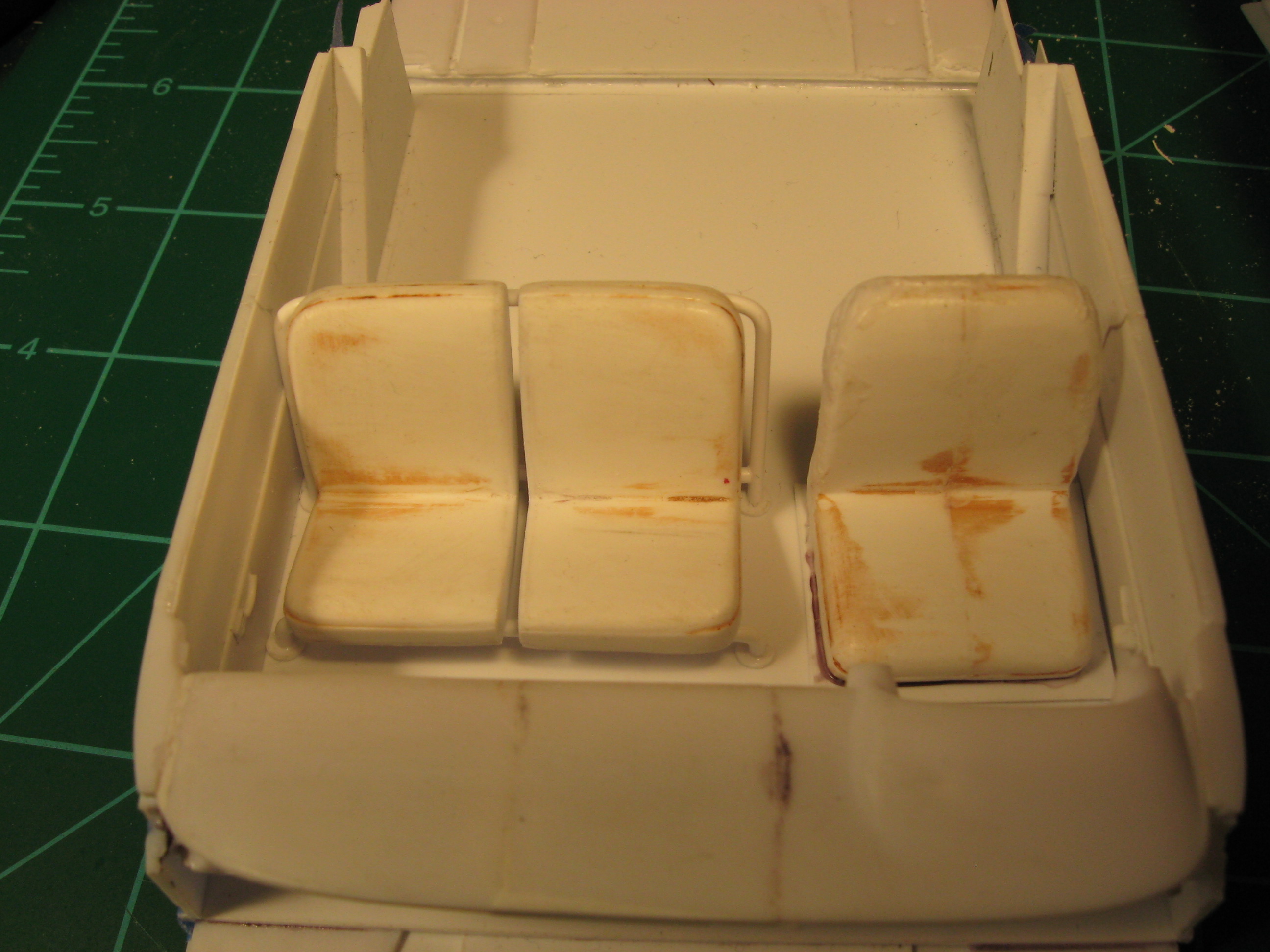

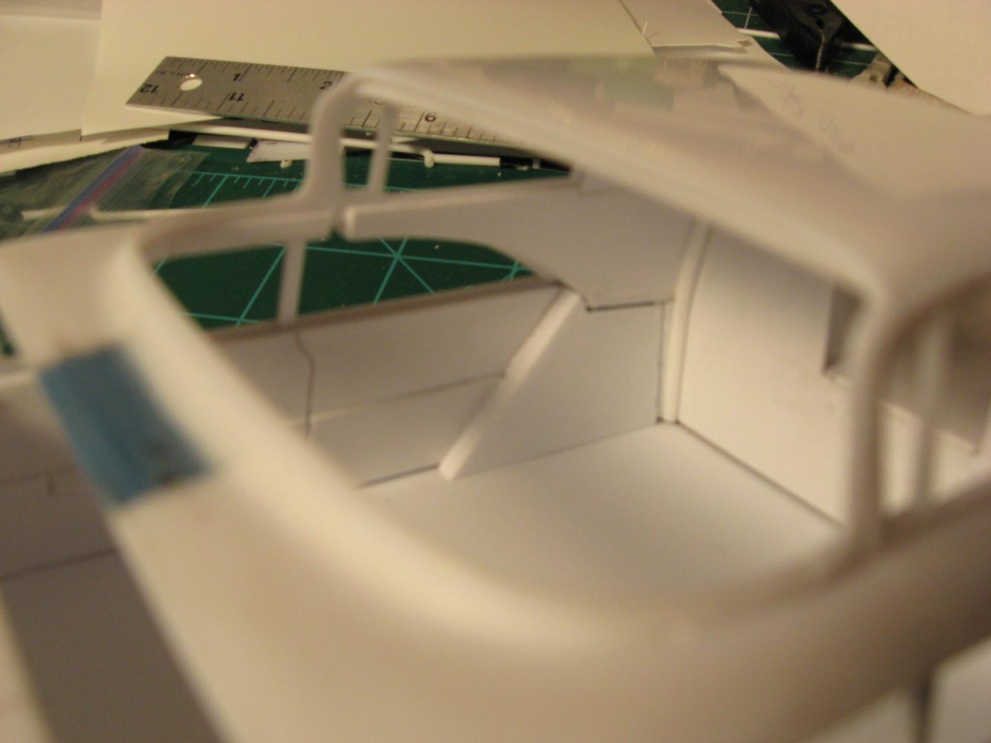

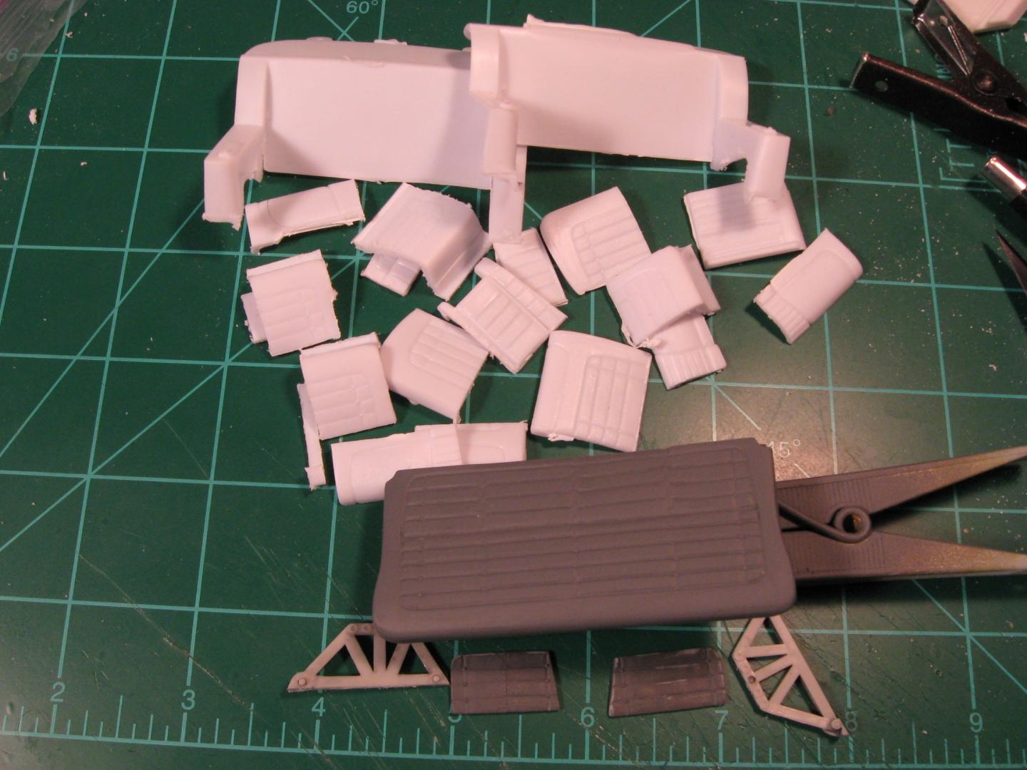

Ridge Rider Posted December 5, 2015 Author Share Posted December 5, 2015 (edited) I have not had much build time but this project is still progressing. The rear seats have different elevations and looks depending on the camera angle/scene. I am going with the natural rear door folding down on the cushion. While not an exact match I am trying to make the stock seat parts work. After sectioning into six parts I have this. It is still rough looking but I hope to salvage it. Anyways I hope to make some more progress this weekend. Thanks for looking. Edited July 11, 2017 by Ridge Rider Quote Link to comment Share on other sites More sharing options...

NeoPrime Posted December 9, 2015 Share Posted December 9, 2015 (edited) Crazy stuff, looks great so far though.What are you using to fill in the gaps around the windows? Looks like some sort of glue or resin?Like in this pic:http://i326.photobucket.com/albums/k411/cqcid/Gigahorse/gigahorse 013_zpsllbtjzgt.jpg Edited December 9, 2015 by NeoPrime Quote Link to comment Share on other sites More sharing options...

Ridge Rider Posted December 10, 2015 Author Share Posted December 10, 2015 Thanks for the interest guys. Bench time has been hard to come by lately. I'm working on the front seats and have been cleaning up and sanding all the fill so not much to share yet. Thomas, I do not like putty so my filler of choice is styrene. I put evergreen scrapes in a paint jar and add some liquid cement like Tamiya extra thin or Testors liquid. I will let the cement melt the plastic. I like to start with a thick sticky base mixture as this seems to be a good plastic/cement ratio. For the picture you referenced I thinned it down with Acetone until it was like slow dripping syrup and dripped it on with a toothpick. As it starts to firm up it can be shaped a little with tools or a finger. This mixture can evaporate quickly even in a sealed paint jar but it will rejuvenate with just some Acetone. An added bonus is this bodywork is unaffected if I need to strip the paint and it's stronger than putty.Allen, I have never heard of a die cutter but will investigate it further. Thanks Steve Quote Link to comment Share on other sites More sharing options...

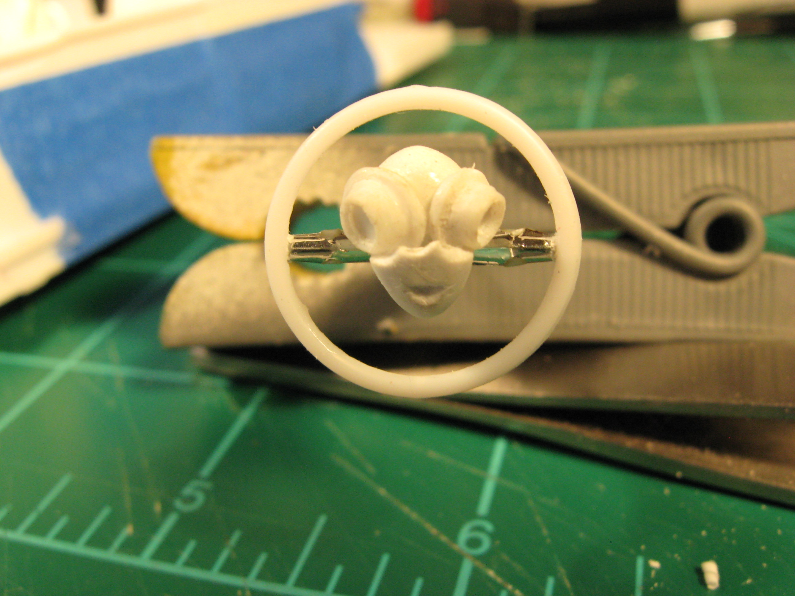

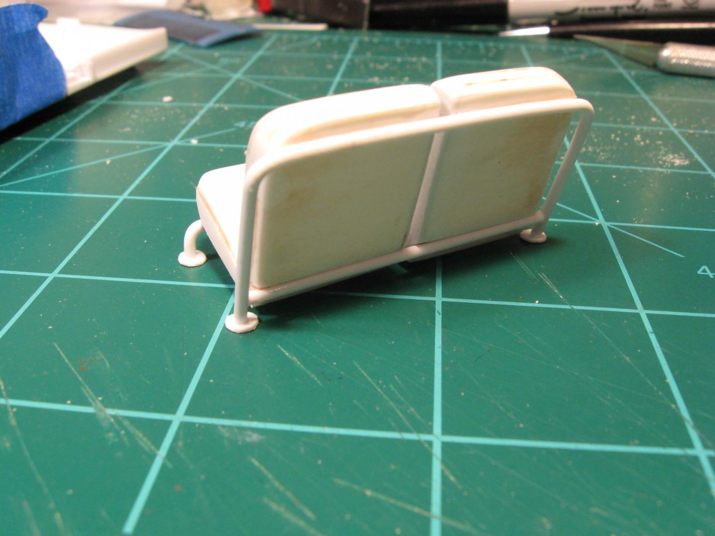

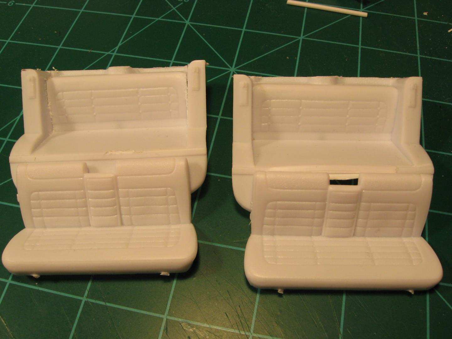

Ridge Rider Posted December 16, 2015 Author Share Posted December 16, 2015 (edited) Thanks for following. Movie magic- in some scenes the passenger seat is solid and others it is split. I started with the first and ended with the latter. The drivers seat is still in progress but they came from a Revell 48 woody. I could not make the stock Cadillac seats work to my liking. While not perfect or an exact match I think I will be able to live with the results. I could not figure an easier way to do the roll bars so I built them into the roof and body assembly. That should be fun to paint/assemble. I am not big on super detail but steering wheels are a status symbol in this movie so my first in progress attempt. While not perfect it may have promise. I want to thank everyone for the help and suggestions and hope you stay along for the ride. Steve Edited July 11, 2017 by Ridge Rider Quote Link to comment Share on other sites More sharing options...
