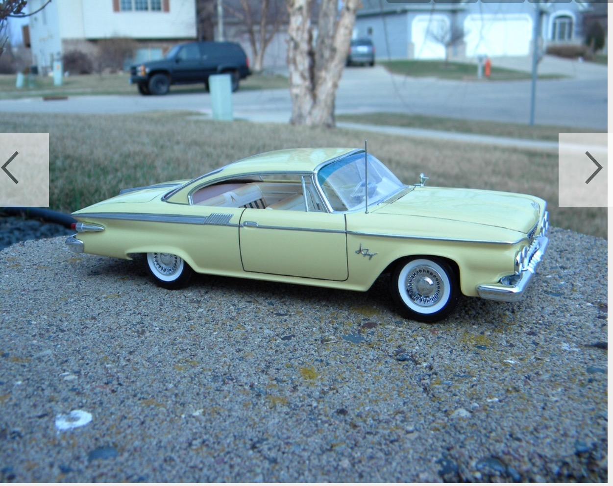

StevenGuthmiller Posted February 10, 2016 Share Posted February 10, 2016 This '61 Plymouth was done this way. It was molded in the yellow & then just polished out with a polishing kit. Steve Quote Link to comment Share on other sites More sharing options...
